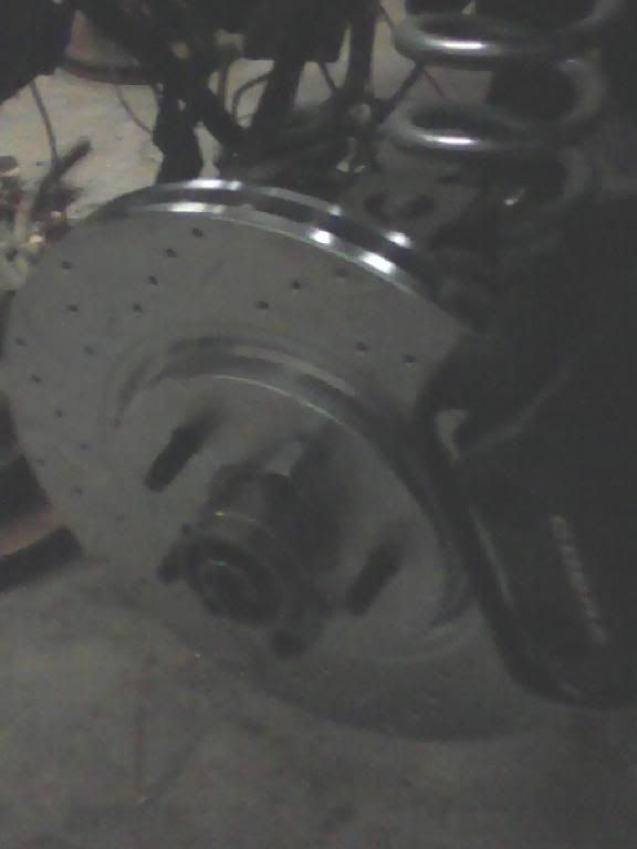

the truck getting new suspension put under it an 13" mustang cobra brakes

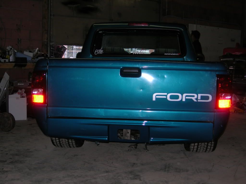

put 06 ranger badges an tail lights on it then a roll pan as well

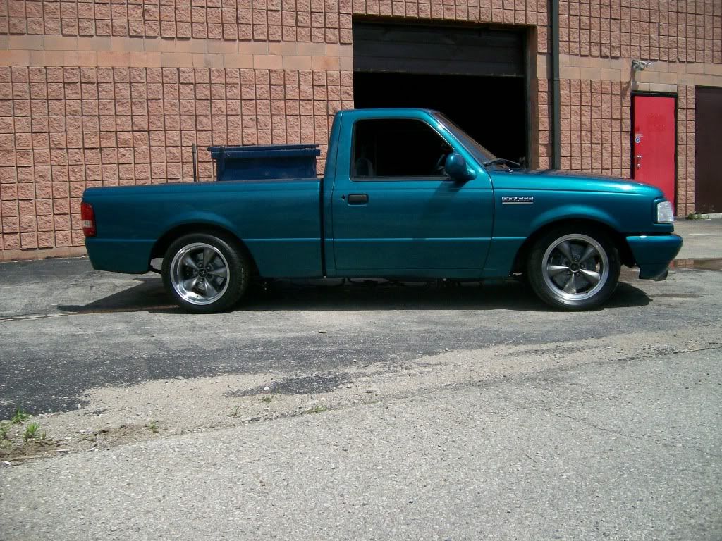

specs on the truck are
306 with trick flow heads ported an polished
cam 7 quart deep sump oil pan edelbrocke intake ported an polished as well under drive pulleys bbk cold air intake for fox body mustang. profisional products fuel rail 24 lbs injectors 70mm edelbrocke maf.
t5 with center force dual friction clutch
13" mustang cobra front brakes 11.5" cobra rear disc brakes crossed an sloted rotors. 4-5 drop 17/9 275/40/17s' bullits up front 315/35/17 deep dish bullits out back 06 ranger emblems an tail lights
