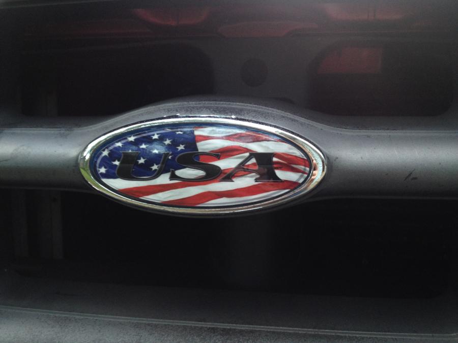

Over the summer I decided to take the pinstripes off because I didn't like the way that they looked. A little over a month ago I also got some decals to cover up the Ford symbols.

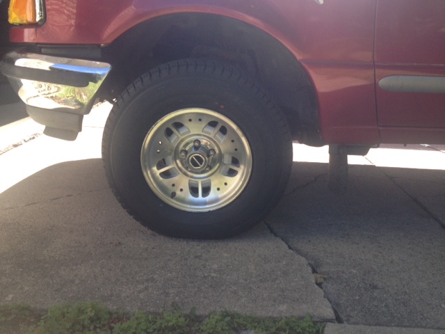

This weekend I decided to lift my truck 2" and get some bigger rim + tires. The truck used to have 205/75R14's on it. I found some used 15" rims that were in good shape and got new 235/75R15 tires. The 2" lift uses Add-A-Leaf springs in the back and coil spacers in the front.

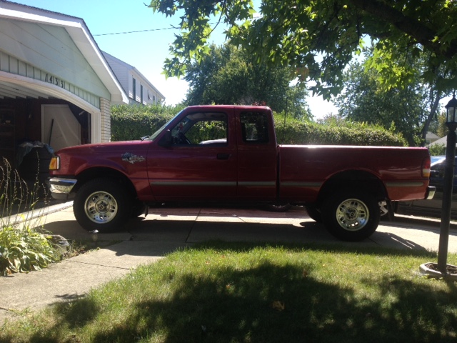

And here are some after pics:
My 94 Ranger 2WD
My 94 Ranger 2WD
My 94 Ranger 2WD
My 94 Ranger 2WD
My 94 Ranger 2WD

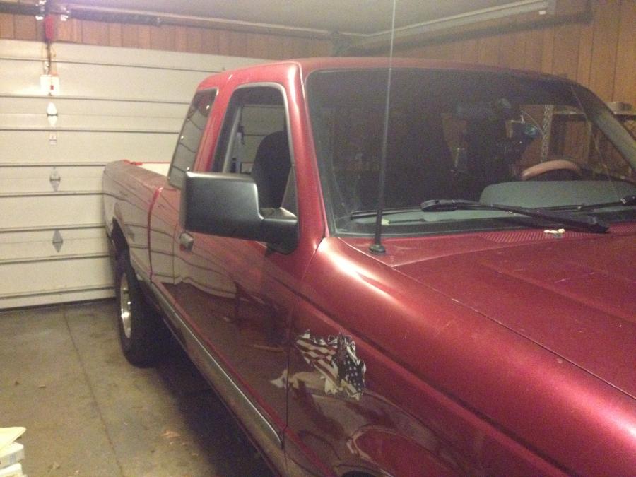

Tonight I did the 06+ mirror swap to my truck. The manual mirrors plus shipping cost me less then $50.
Here are some before pics.
My 94 Ranger 2WD
My 94 Ranger 2WD

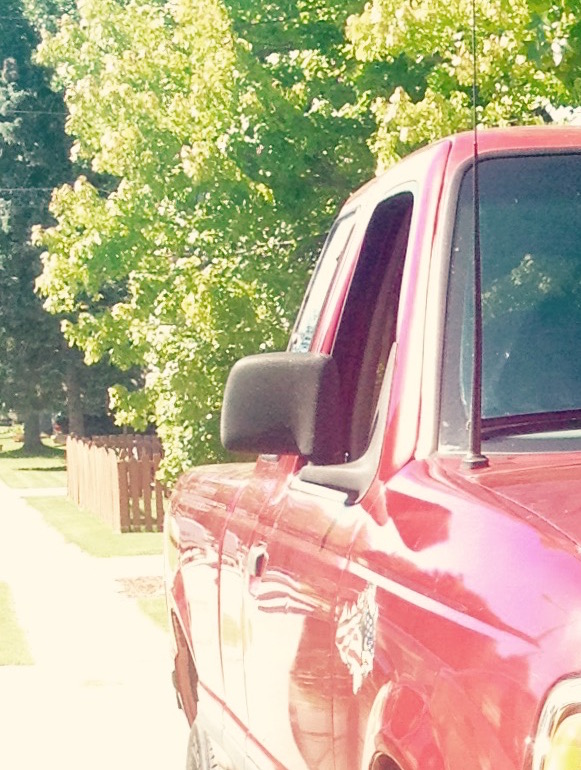

And here are some after pics.
My 94 Ranger 2WD
My 94 Ranger 2WD

Make sure you get adjustable camber eccentrics and get an alignment. The tires cambered in like that will wear the tires/balljoints up quickly
Yeah, those pictures were taken right after we lifted it. I got it aligned properly a couple days after that.

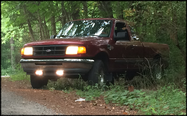

I forgot to update this but a few months ago I added some aftermarket fog lights to my truck. They only cost me $30 and my dad helped me install them.
My 94 Ranger 2WD
