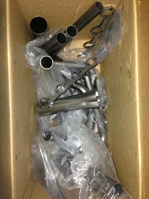

Parts are slowly arriving, here is my small block ford header builders kit. I got 3 inch collectors, a ton of bent up 1 5/8" tubes, header bolts and gaskets for $114. Not bad at all
