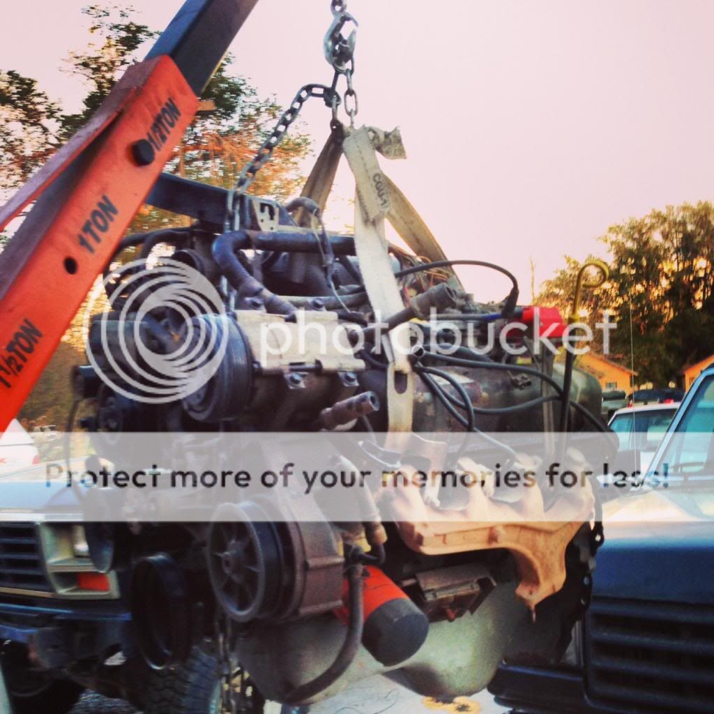

Ok update on the engine swap. I am sourcing the engine from an 89 bronco. A friend called me and asked if I was I was interested in it, body and Interior is crap but my friend said the engine sounded and looked good. So I bought the whole engine, computer and wiring for $500 sight unseen. I get to my friends house where we had it driven and start looking into it more.
A guy on base bought it to restore, but he got orders over seas and can't take it with. It has 49,000 original miles on it and it runs really strong! I was going to do an engine rebuild originally but it still runs great, has low miles and no leaks so I think it's not needed. I am pulling it out next week along with my engine and letting the fun begin.
My doubler will be for sale soon if anyone is interested.
Hit me up when you're ready. I may be interested if the price is right.
Yanked the 351 out today. Tearing it down tomorrow
Got a fist gen lightning upper and lower intake coming, small block ford header building kit, high volume oil pump and gasket set coming. Tomorrow I am going to pull the harness and computer and get the wiring nightmare started.
