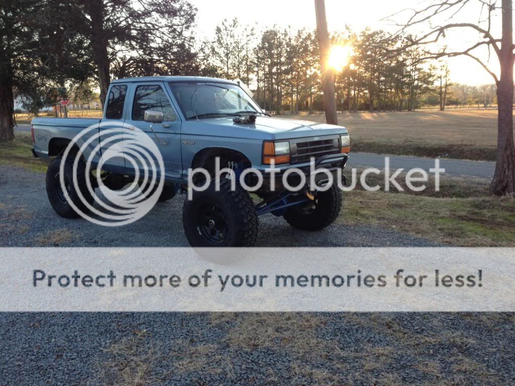

My 91 Ranger the stRanger
Superlift ORV park in Hot Springs AR
I like
That looks like a nice park and the trails look great. My favorite part is the fact that there is hardly anyone esle there :icon_thumby:
Yeah it's a huge park, and Sunday is a slow day and usually only about 10 rigs. On a Saturday there's about 50 rigs usually

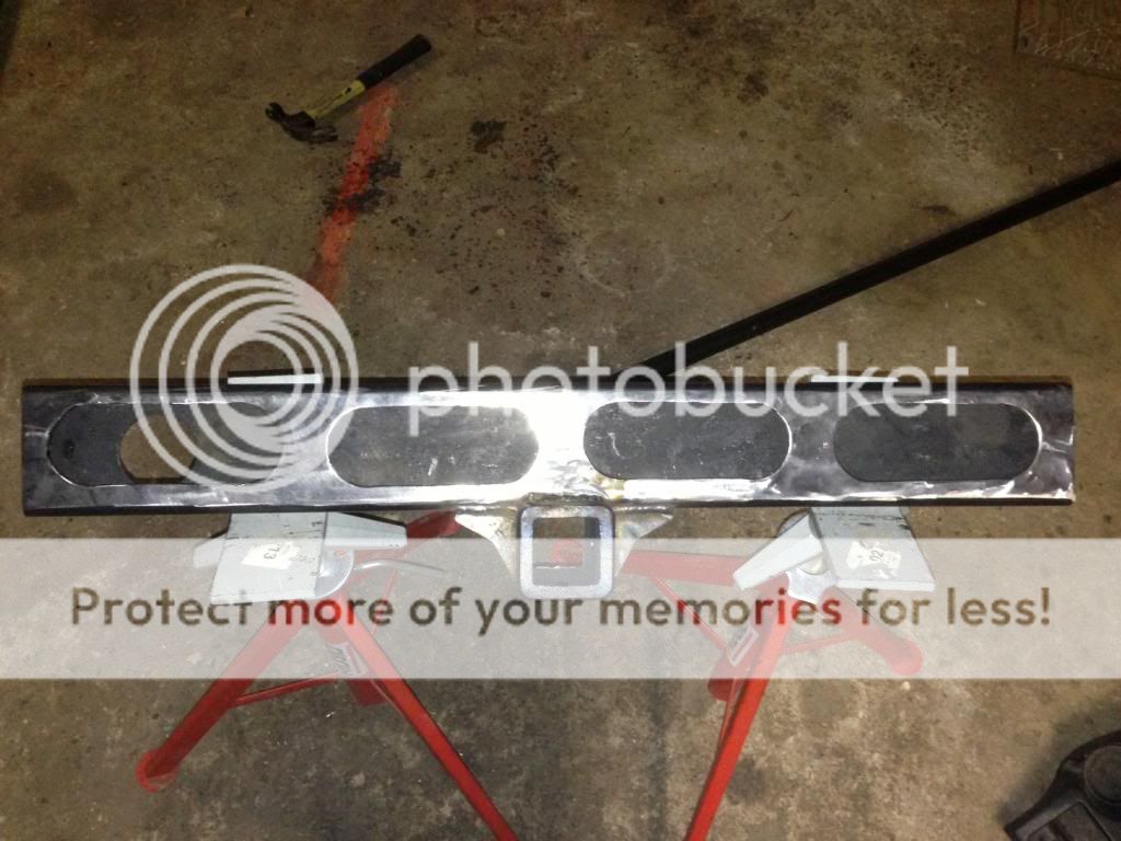

And I built my rear cross member for the tube bed

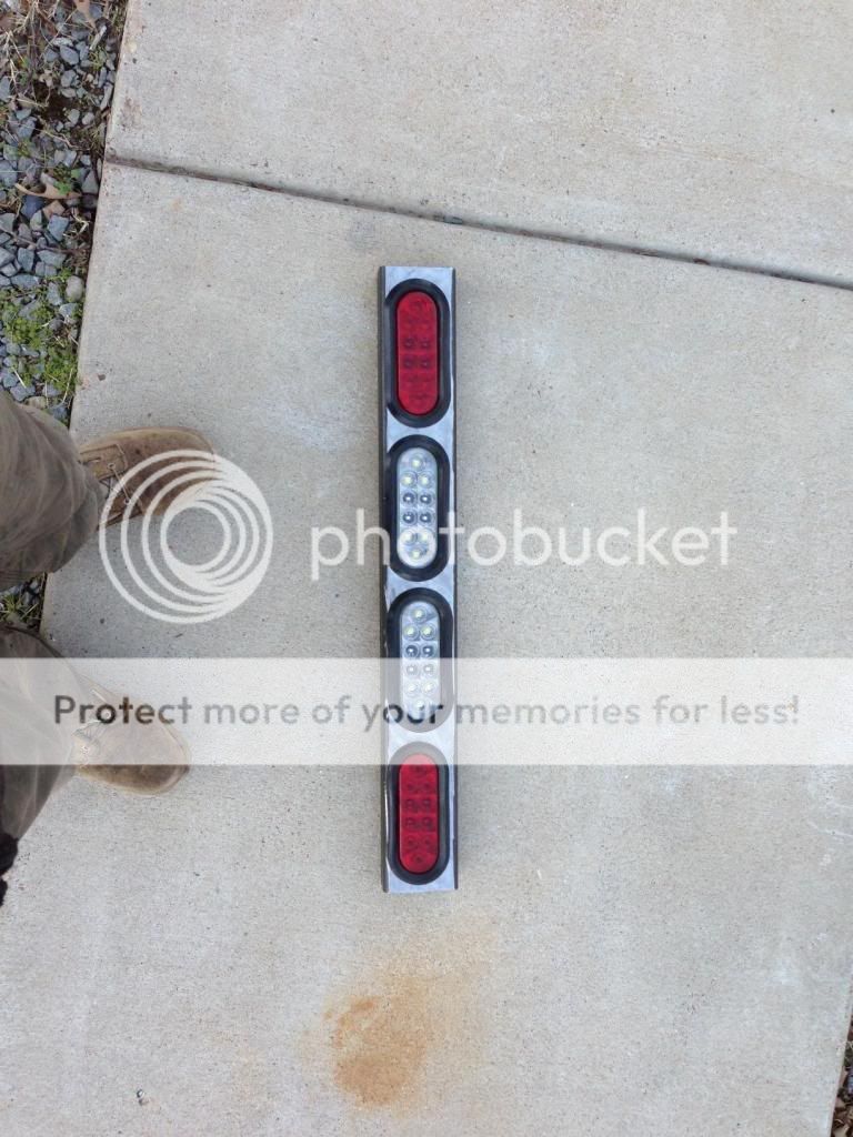

The lights are led lights from a trailer supply store. I should have the fuel pickups for the cell next week.

Today I cut a hole on the backside of the crossmember for wiring. I also welded on a receiver hitch. I still want to add a couple more gussets on the back side, but I am happy with it.

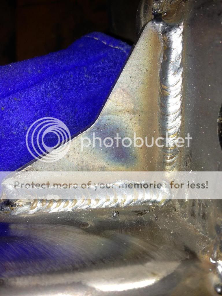

My welding is improving, here is my prettyish weld. Feel free to critique.

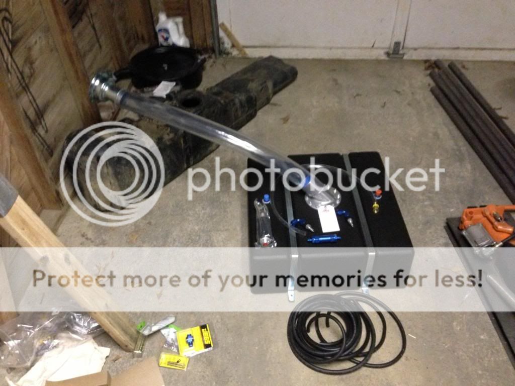

And here is some the parts I am collecting. Jaz 22 gal cell, summit fuel filler kit, holley in-line fuel pump, jegs pre pump filter, various fittings and barbs, and some fuel line. The plan is to mount the cell over/ behind the rear frame rails and have it sit flush with them. It should not raise above the flat deck much, mostly the filler spout.
Sweet kind of wish I would have went with a bigger cell but oh well.
Yeah I have a 16 gallon tank right now and I only get about 230ish miles out of it. I hate it. The added range with this will be nice.
