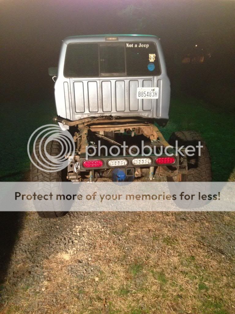

Well I finally got back to work on the truck this weekend. I yanked the bed off, installed the new cross member I built, wired up the lights and I started in the tube bed base and fuel cell mount. I ran out of time and light today so this is the only picture I got. I also picked up a brand new full size spare today. I have a huge laundry list of stuff to get done in the next 5 weeks so the updates should be coming quick.

How are those mtr/k? Everybody seems to be running them. I like the truck man it turned out pretty good. Can't wait to see the tubebed.
Yeah they're the GY mtr kevlars. I've been really happy with them so far on and offroad
