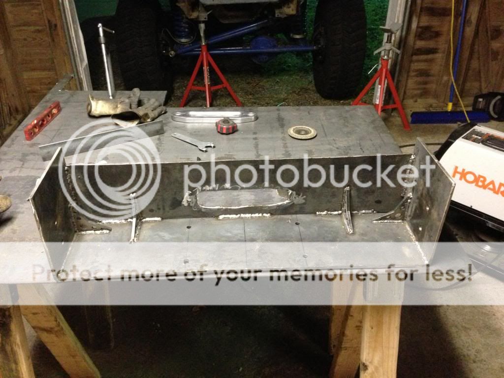

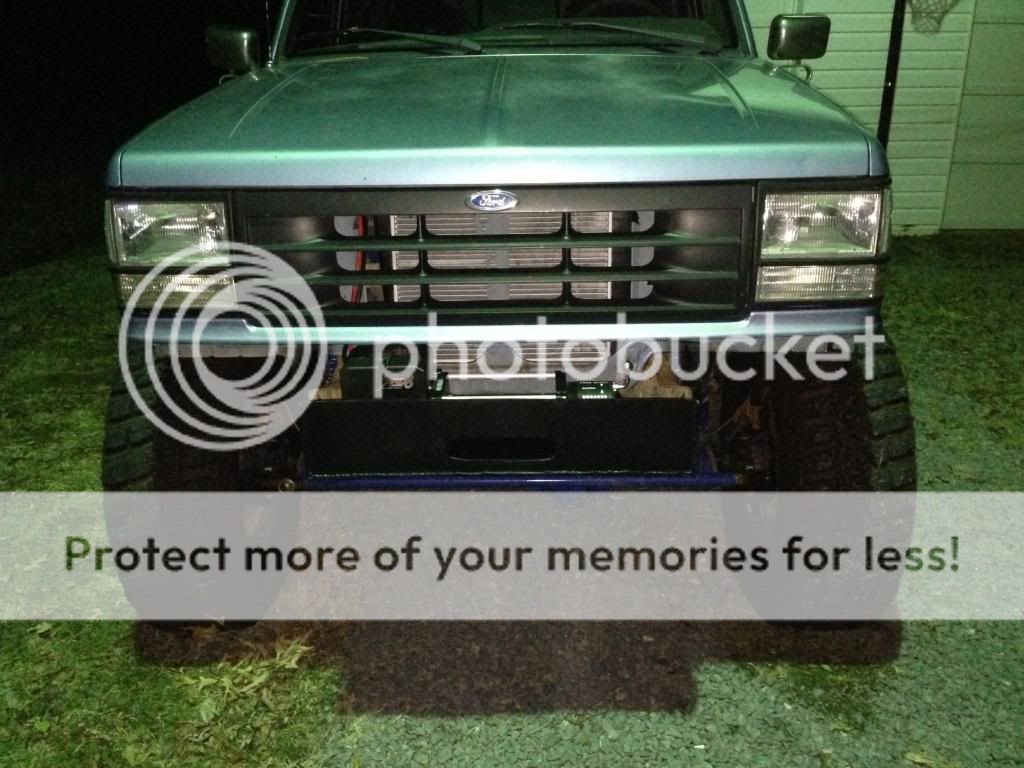

Well this weekend I got a little done. I installed the aerostar speedo cable that finally came, and I started on my new winch bumper. I got the winch cradle done, just need to add the tube this week. The winch is tucked up as far in and back as I could go, I'm pretty happy with it so far.

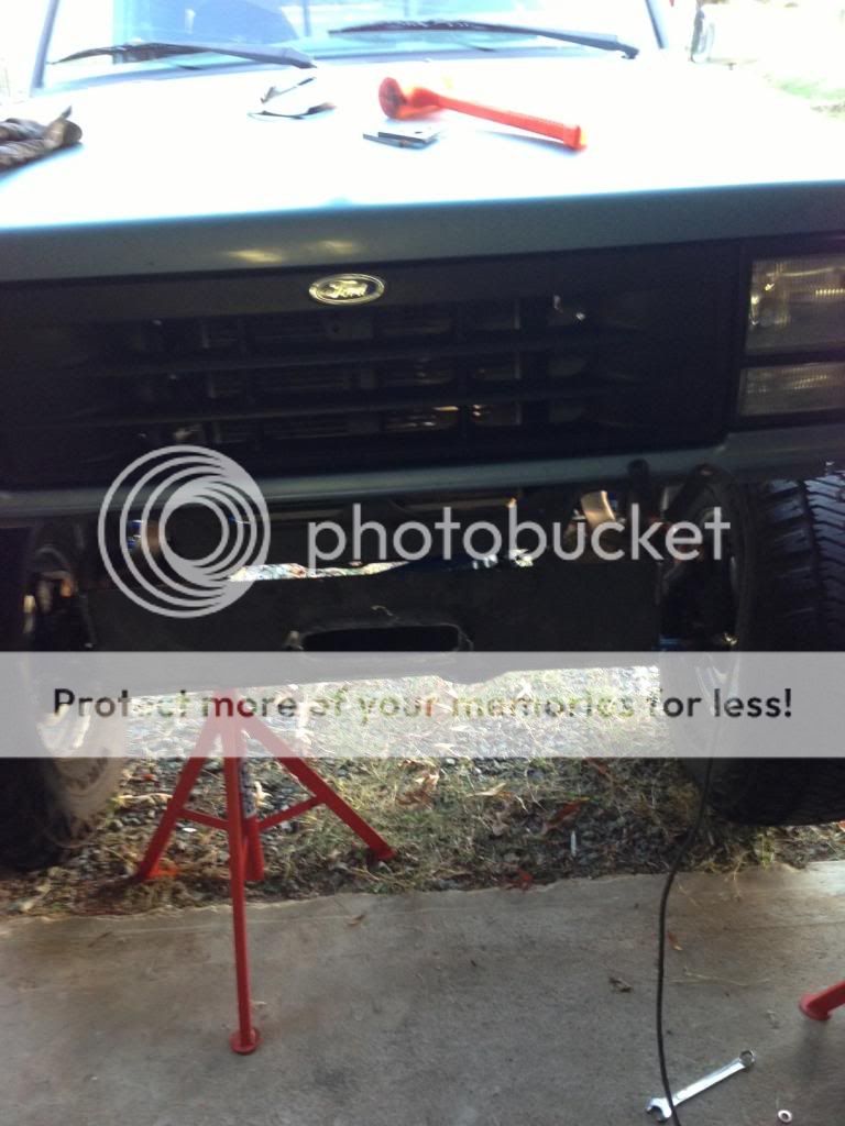

Yeah I already checked, the clearance should be good. I know he hole looks like shit, I cut that with the torch, fawk cutting 1/4 inch with a grinder. I need a plasma!
Who cares. It will be covered up by your roller fairlead. No one will ever know. :D I need a plasma cutter too haha
