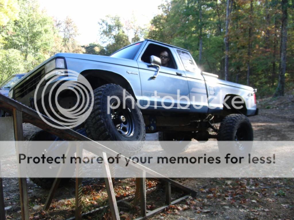

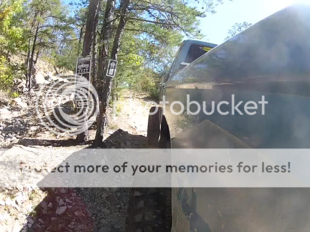

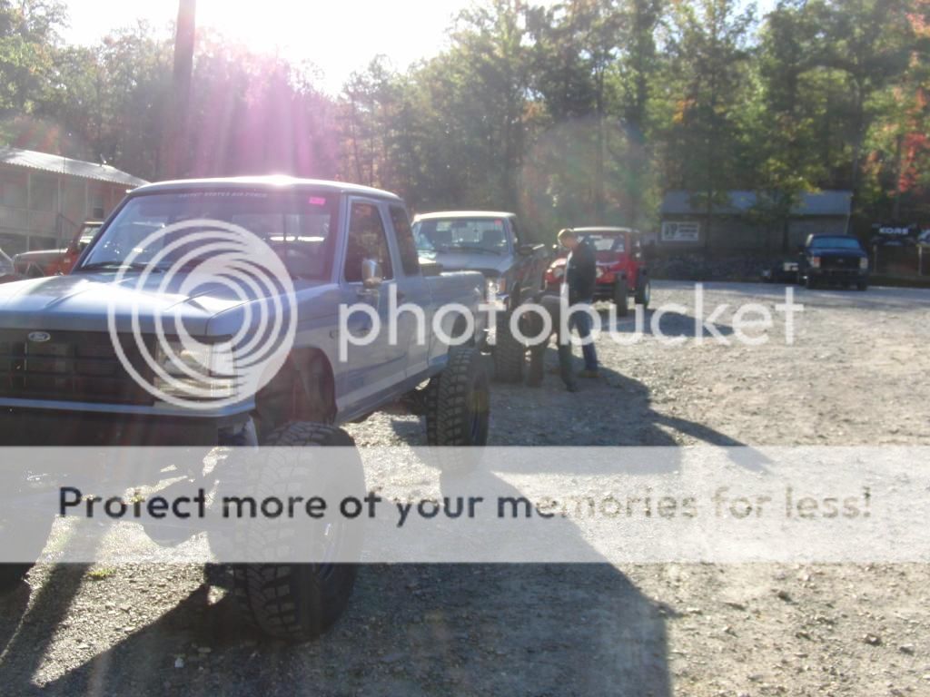

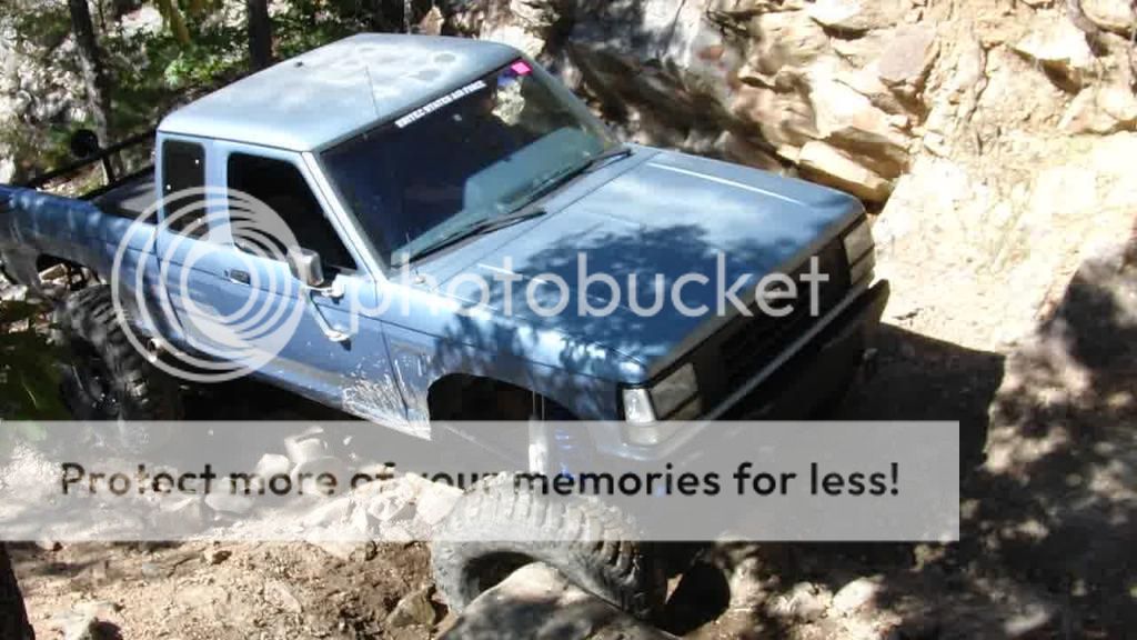

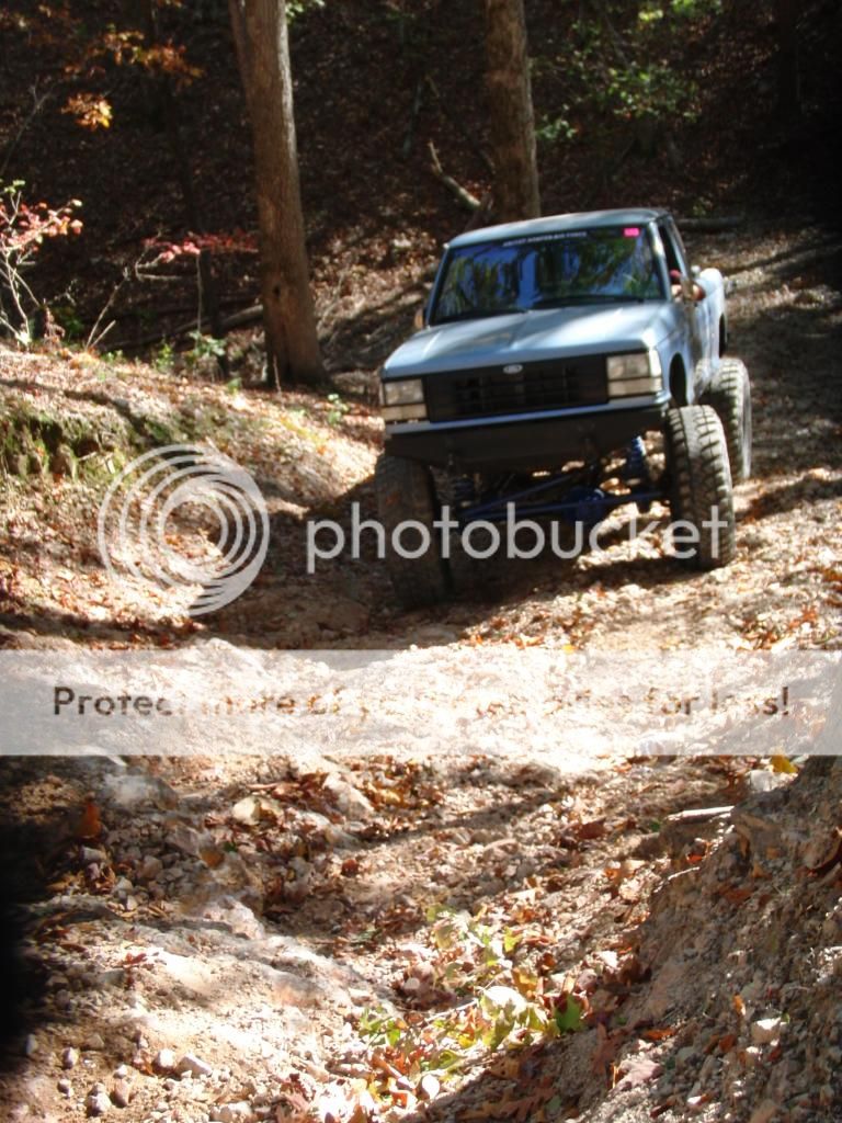

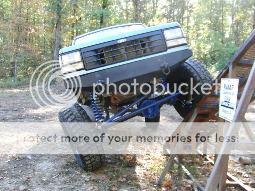

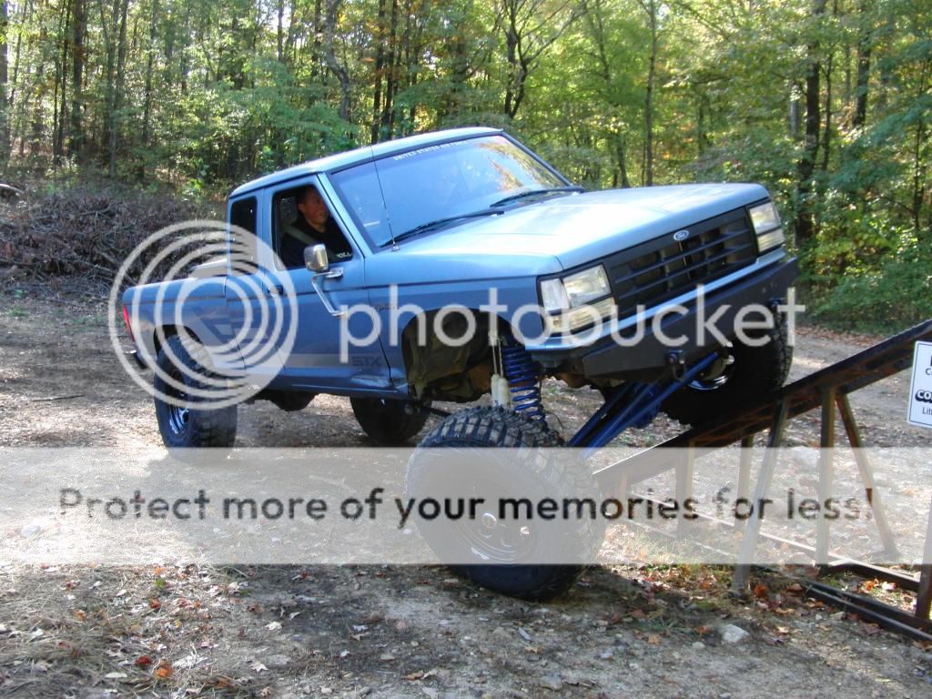

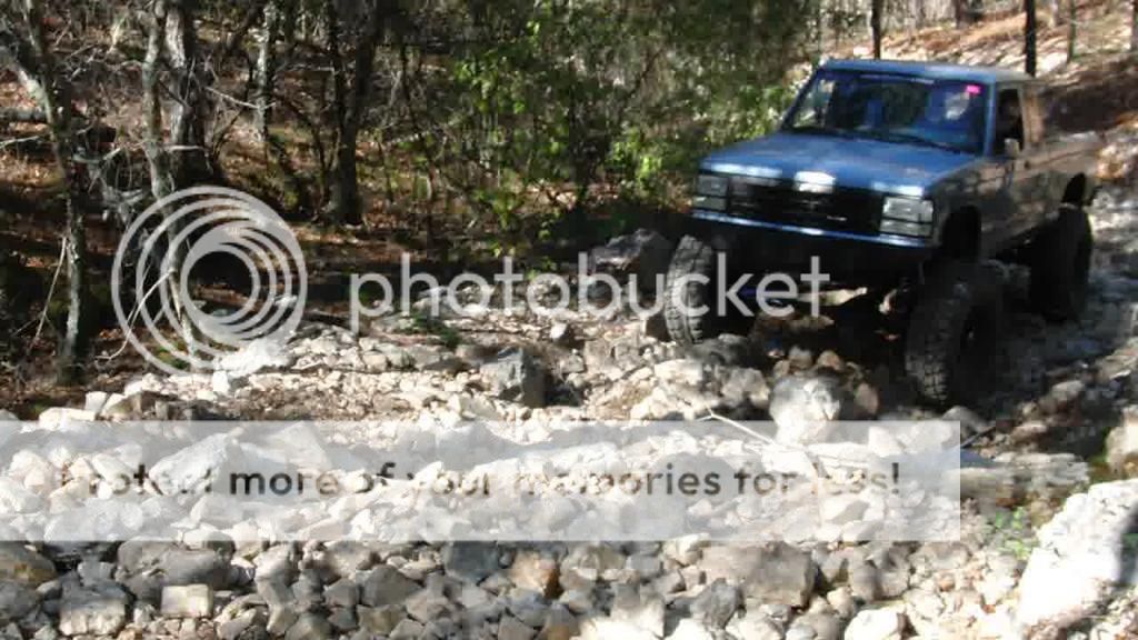

Any way here is some pics. I have a lot of go pro footage and some other stuff I might make into a youtube video.
Early morning air down
