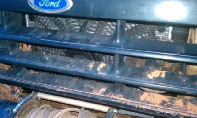

i was reading thru your build page again and i have a couple of questions about your in cab winch controller. is it wired dirtectly into the winch or do you just plug it in when needed? and second if it's wired directly did you wire in an arming of saftey switch so it doesnt get pressed on accident or unknowingly?
the picture in question is from way back in post #19
B.T.W. GREAT BUILD look's like you have put alot of time into it
Yea, its wired directly into the winch and it does have a arming switch also. Flip the arming switch and then just hit the button. Like it a lot better then the stock controller.

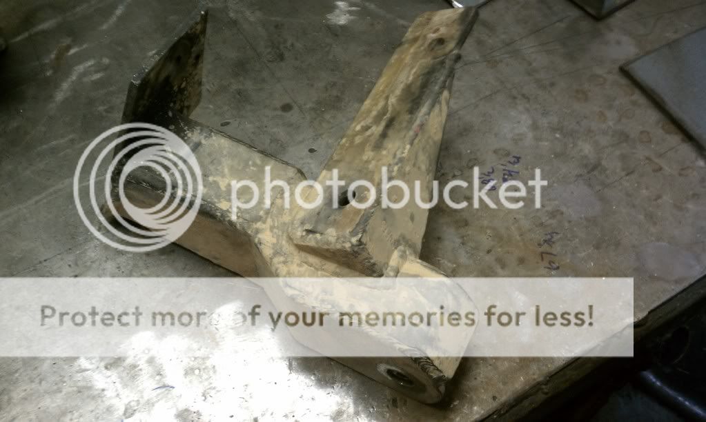

Finally got to start working on something for you. Pulled mine off today, sandblasted and checked it over, then started building a jig for it. I'm going back to work on it tomorrow. I'll keep you updated.
Here's some pics of mine when it came off.

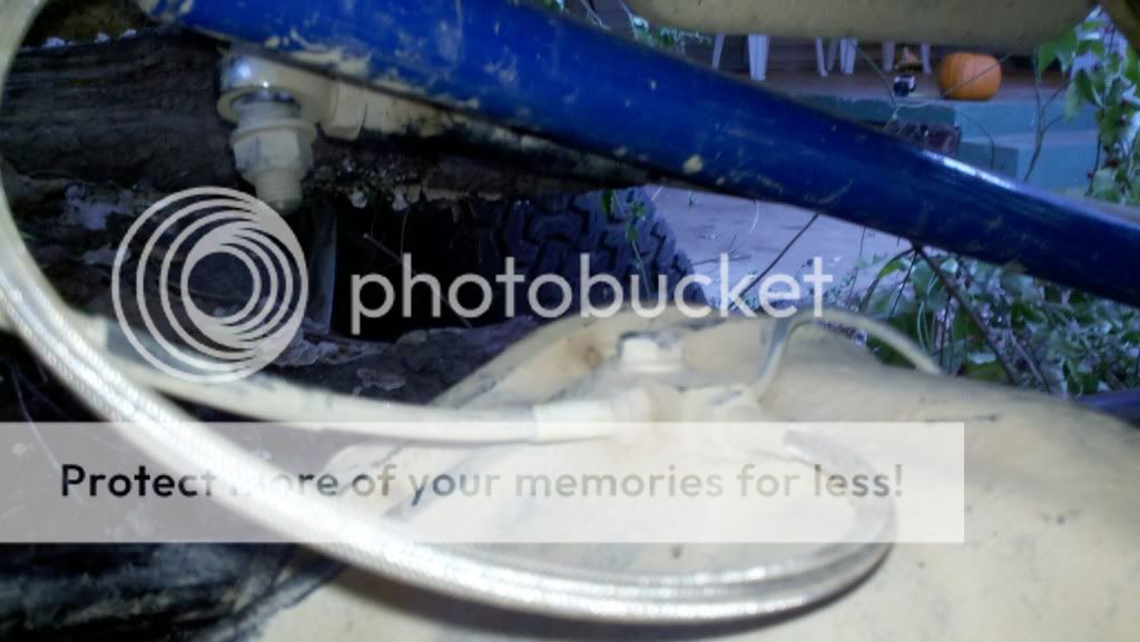

Thought I'd put some pics up of the stuff you were asking about.
Radius arm to center body mount is dead on 6 3/4" to edge of plate.
Where I bent the hard line from master cylinder to engine x-member and drilled a hole to clip it in.
Inside of engine x-member where I connected my braided line to hard line.
