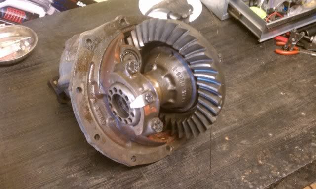

The rear 9" has a 4.88 gear in it and I got a lock right for it also. Got a new set of weld on caliper brackets and gm calipers for disc brakes. Just got to find the right rotors for them.

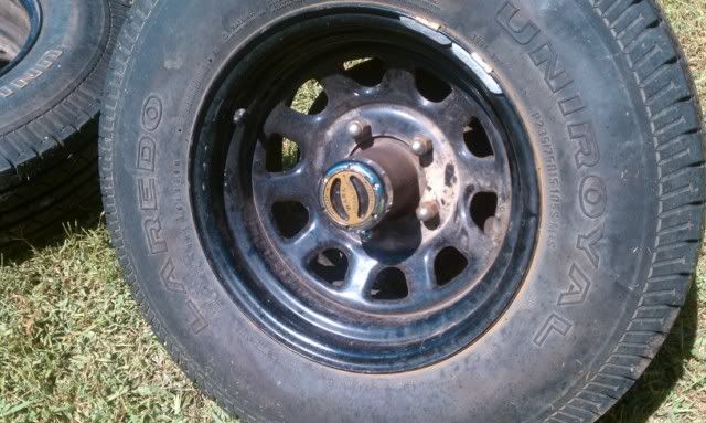

Also got a complete set of black d-window wheels with about a new set of tires on them I can resale.
D44
Hubs/wheels

9" Center section with 4.88 gears.
9" Lockright

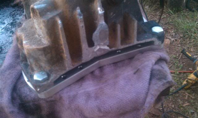

Brakes for the 9"

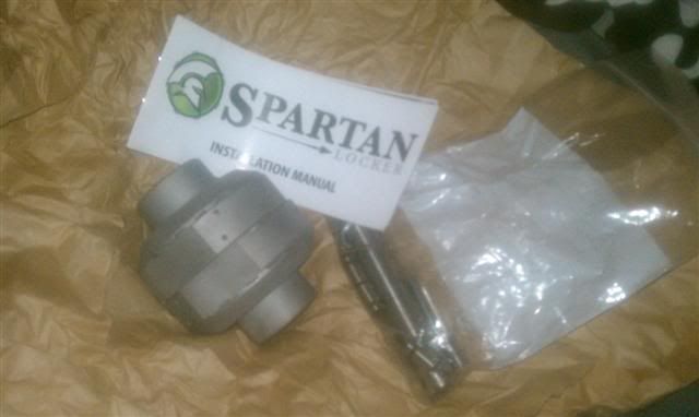

Met up with the guy I got the other set of axles from last night to pick up the front locker he bought since there wasnt one like he said. Atleast he was a stand up guy about it and made it good.
Brand new Spartan locker. Looks like a good locker. Will be a lot easier then other to put it in and take it out. Dont have to mess with the aggravating little springs getting the in and also the pins are about twice as big.

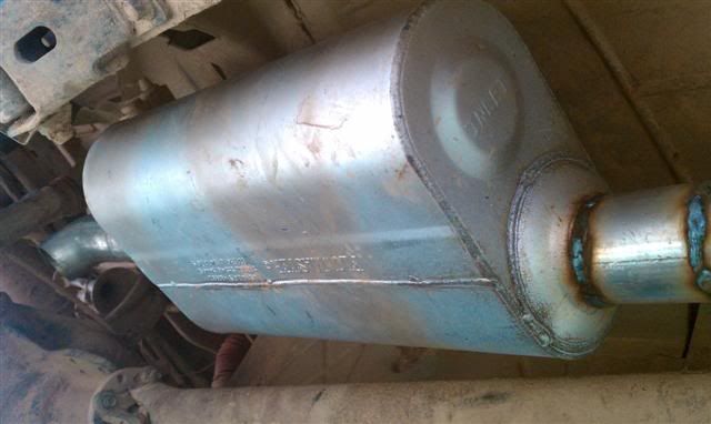

On a good note did get a new muffler today. Got a Flowmaster 50 series to quieten it down a little bit. Going to try to get it put on Friday night.

Also got the Flowmaster 50 series I got from xeek put on. Like it a lot better. Not nearly as loud.
