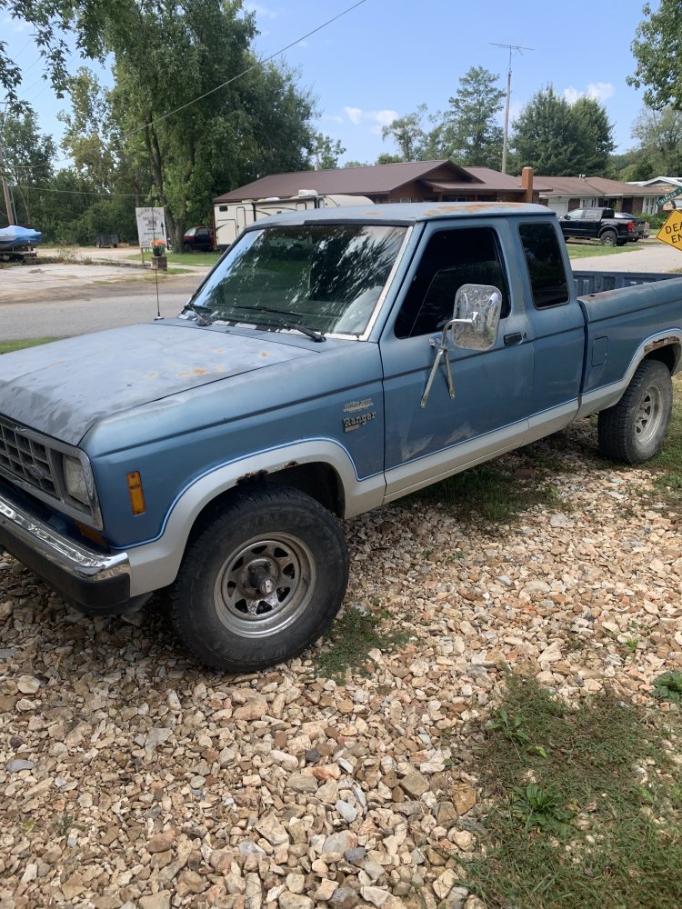

My 87 Ranger I will be restoring soon I want to keep track of my progress and add information as I find it.

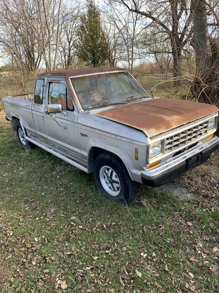

The surface rust on the silver one need to be tended too before it get much worse. It'll be holey soon.
But very straight. That's rare for a first gen.
I am hoping to get back on the 87 soon. That rust is bothering me.
