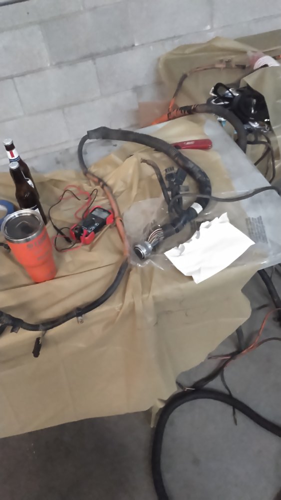

View attachment 72474View attachment 72475View attachment 72476View attachment 72477View attachment 72478View attachment 72479
hmmm. Nice wiring harness. Good luck.

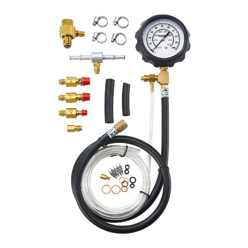

Went to Harbor Freight and picked up a Basic Fuel Injector Service Kit so I could measure the fuel pressure with the key on, and then with the engine running.

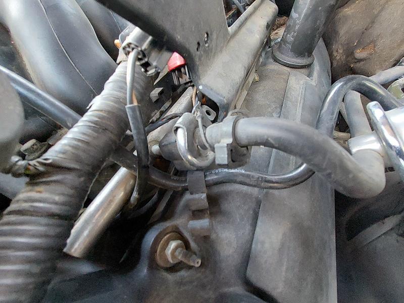

When I got home I discovered that Jaguar apparently did away with the Schrader Valve on the fuel rail after 2003. Sum Bitch!!
72719
So..... not sure how I'm going to check the fuel pressure. My guess would be to disconnect the hose going to the fuel rail in the middle of the photo, and somehow insert the T-fitting that's in the kit in between there to connect the pressure gauge. :icon_confused:
I think that's exactly how you do it.
Looks just like a normal spring lock coupler... there are proper adapters for that very thing. might be able to rent one from the parts store.

When Bobby was here we were looking it over and noticed that the platic fitting for the vacuum line going to the fuel pressure regulator sensor was broke, so I replaced that sensor with a new one.
