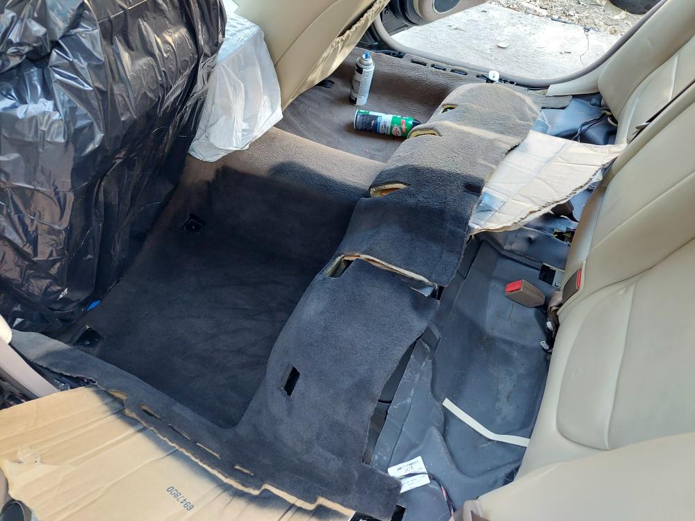

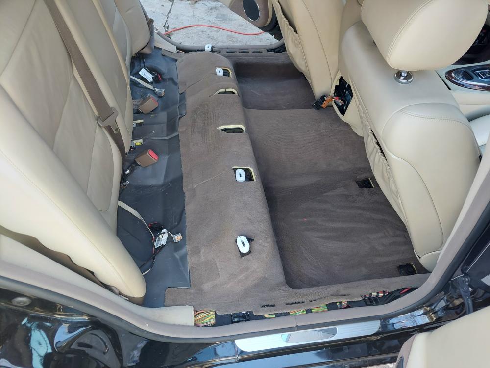

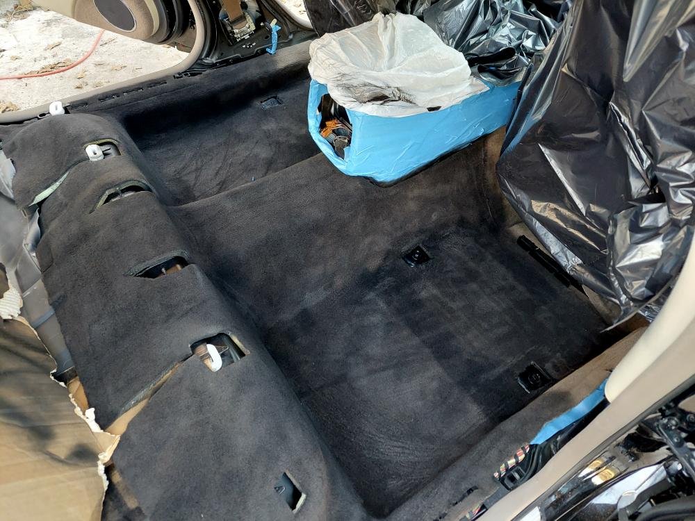

Carpet:
74312
74313
74314
I cleaned the carpet and then sprayed it with black Dupli-Color vinyl & fabric paint. Here's some pics of it during the process. I unbolted the seats but didn't completely remove them because I didn't want to risk damaging the electrical plugs underneath them. I covered the seats and the center console with trash bags to protect them from overspray. It actually came out looking really good. I need to post some completed pics of it. It looks better in person than it does in photos. It definitely looks like a new car with the black carpet. I need to add some black carpet floor mats. The nice thing about the black is that it makes it so much easier to find floor mats. It's pretty difficult to find floor mats to match the original carpet color.
74315

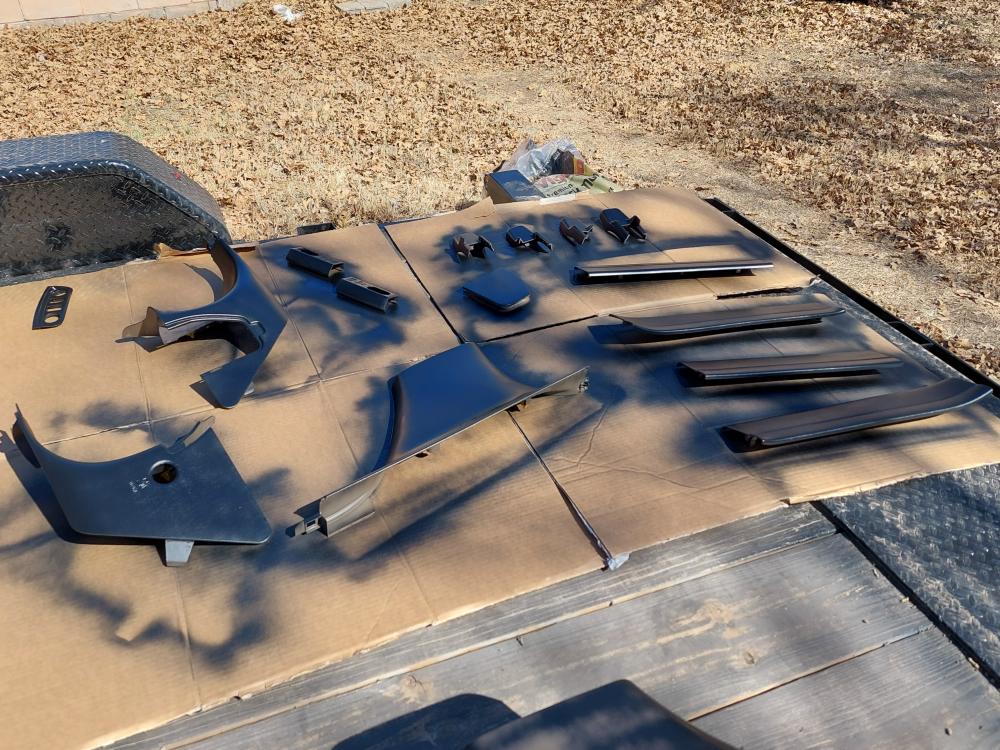

I also painted the plastic trim pieces that make contact with the carpet with some black Krylon Fusion paint.

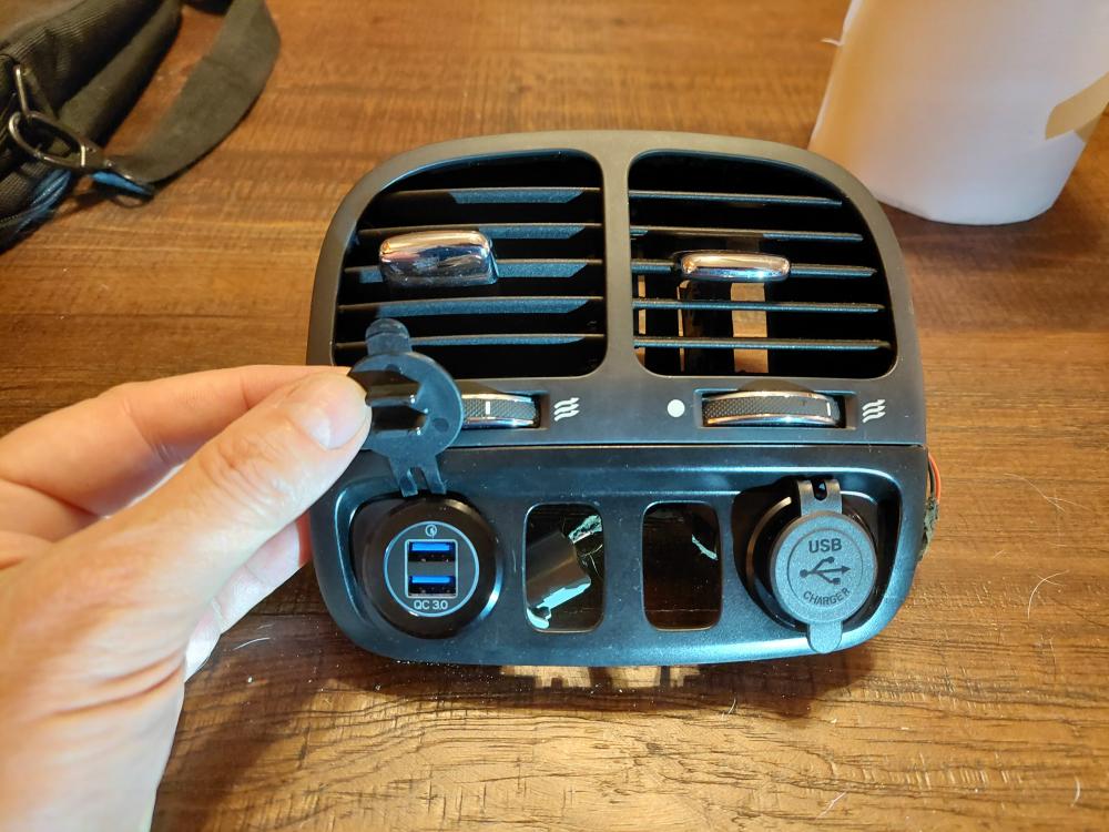

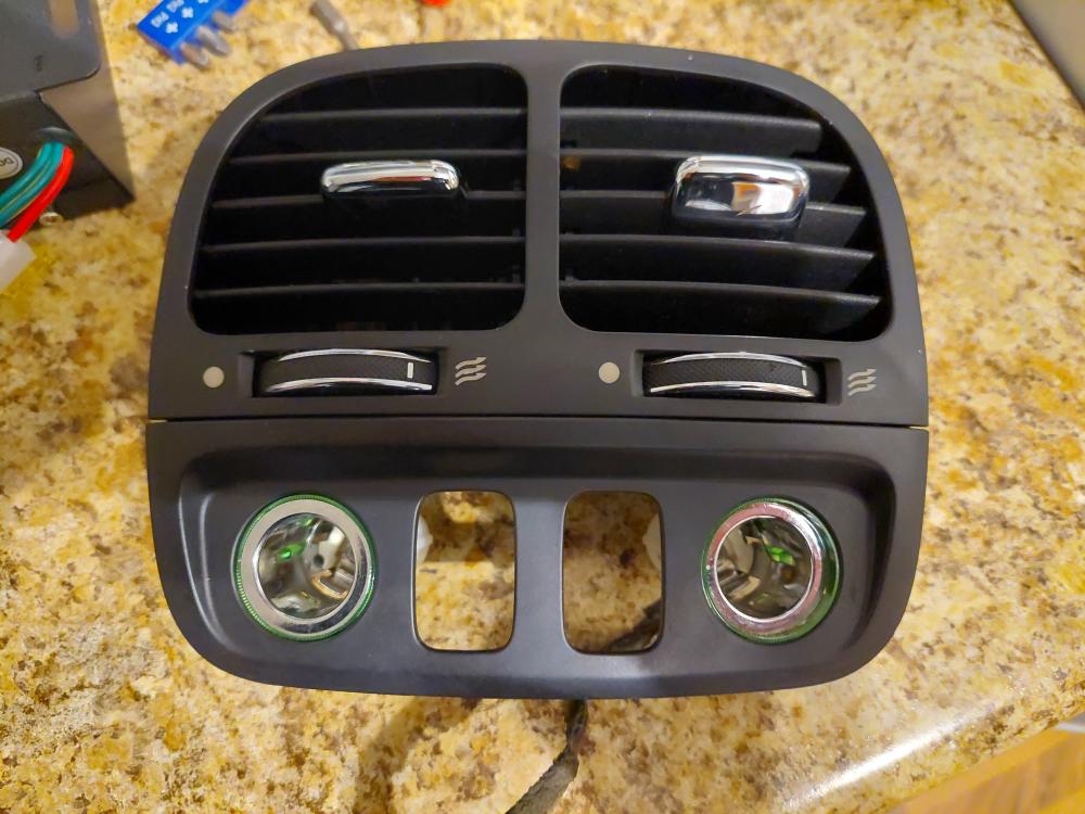

Rear Console Outlets:
74316
74317
I removed the rear outlets (cigarette jacks) and replaced them with USB 3.0 quick charge ports. This makes it way easier for passengers to charge their devices.

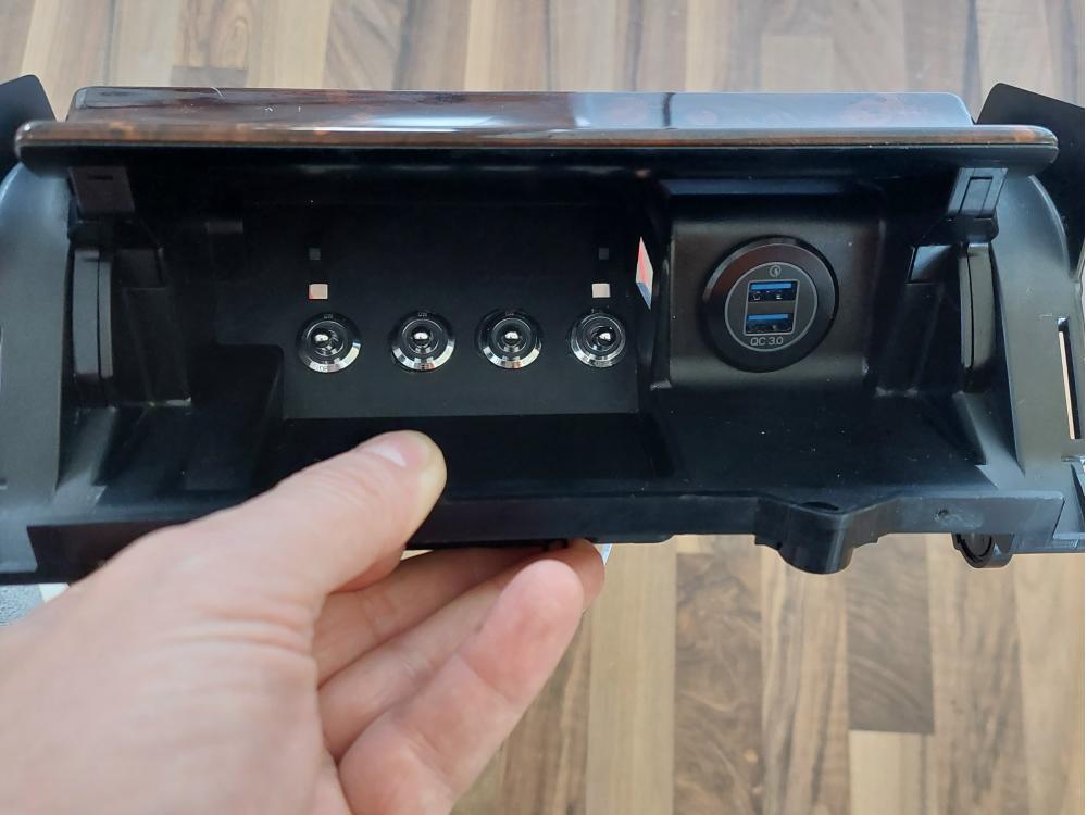

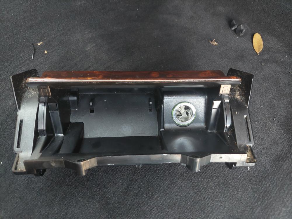

Ash Tray:
74318
74319
I removed the ashtray and ashtray holder. I replaced the outlet with another USB 3.0 quick charger. I also added (4) toggle switches where the ashtray use to sit. The outlet and switches are hidden when the lid is closed.

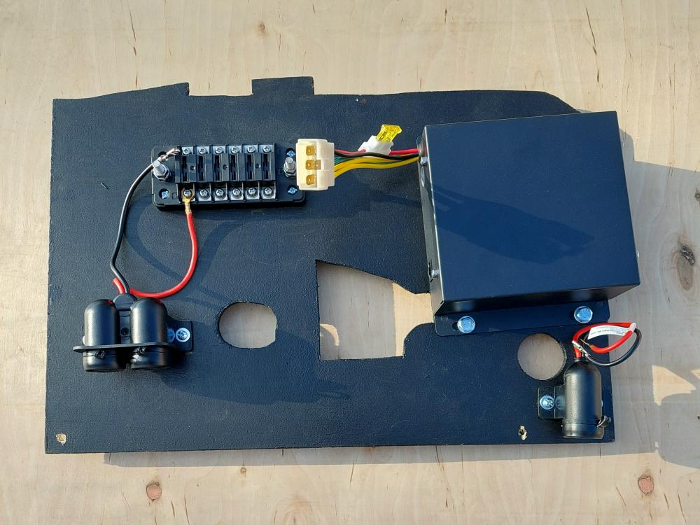

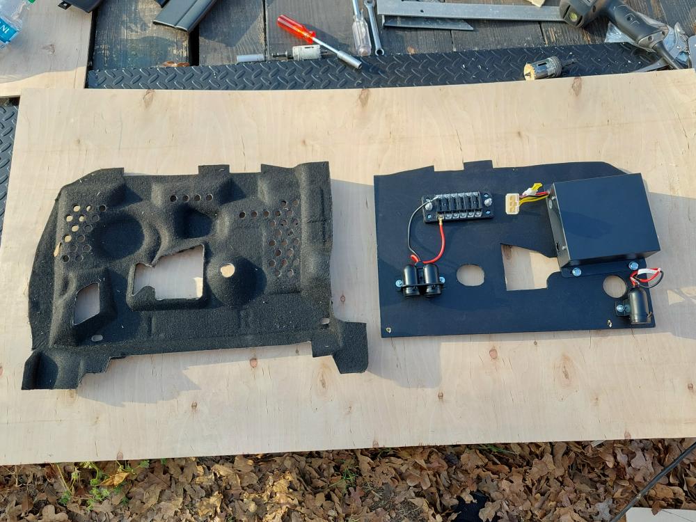

Underdash Tray:
74320
74321
There's a cover under the passenger side of the dash that looks pretty rough and droops down. I wanted to mount a few things under there, so I cut a wood panel to fit and then mounted some outlets, a fuse box, and another electronic box to it.

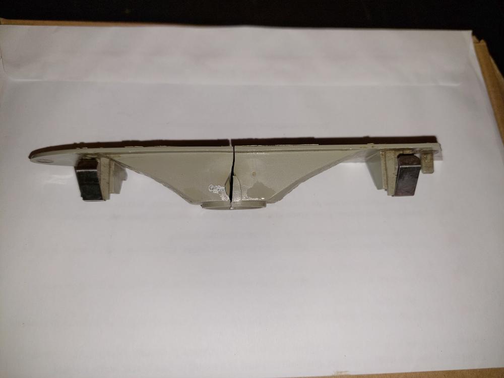

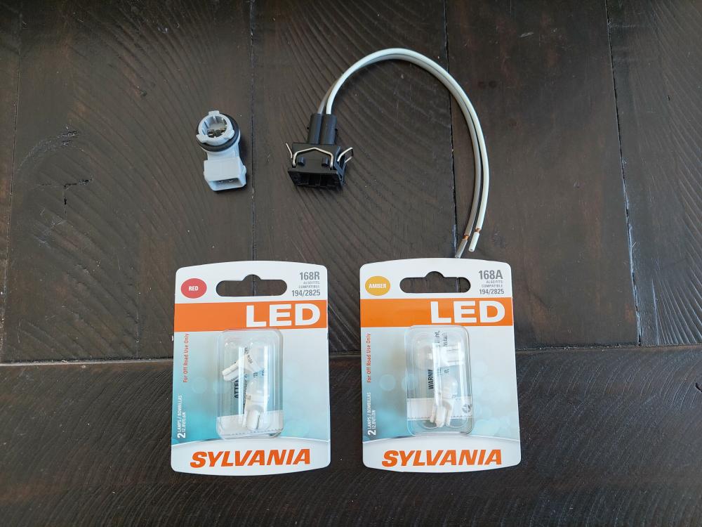

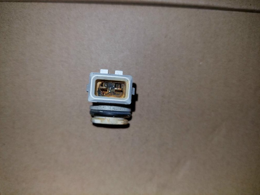

The side marker lights weren't working. When I removed them I found that the light sockets were rusty. Weird considering the car is rust free.
74322

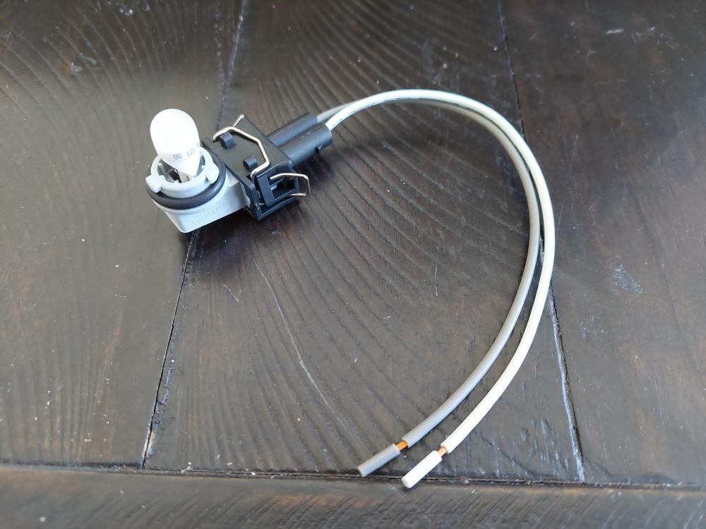

I couldn't find any new replacement Jaguar XJ8 parts to fix it.
Doing some research I found that Audi and VW used the same light socket Part# 1H0949111 and harness connector Part# D067B.
74325
74324

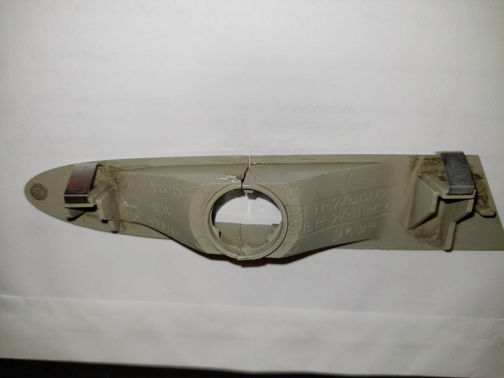

The front marker light housings were damaged from age and the heat of the bulbs.
74326
74327
I replaced one with a NOS one, and the other one I found on ebay.
I replaced the bulbs with LED bulbs so they won't succumb to anymore damage from the bulb heat.

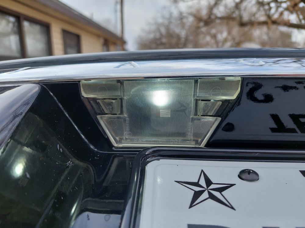

I even cleaned up the light covers for the license plate light and replaced them with LED bulbs.
