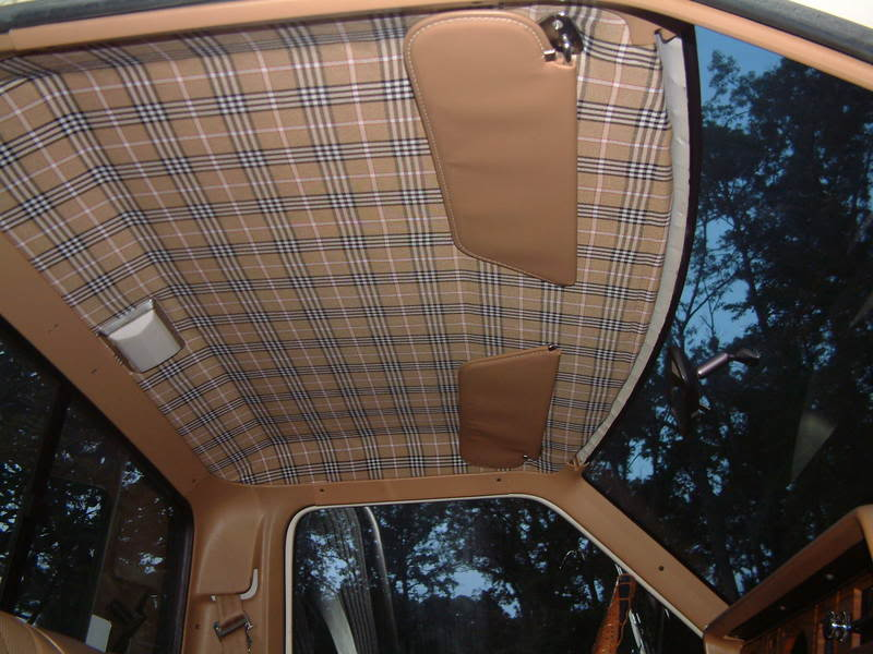

I know how hard it is to keep the lines straight on a contoured surface. That headliner looks exquisite and proper in that Jag. Almost looks like Burberry did the interior.
