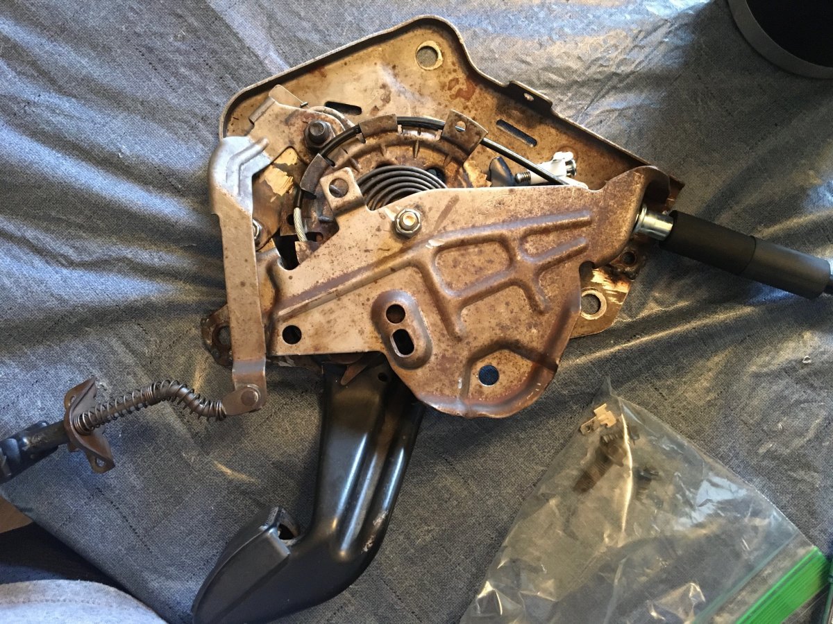

Finally got my parking brake to work! (y)
I took the pedal assembly back out of the truck, replaced the cable and the switch for the dash light as mine was broken. I forgot to document it at the time, but at one point my e brake pedal broke and the teeth got all chewed up on it so it would just skip to the floor and not work at all. I tried to find a replacement pedal but they're not available new so I searched junkyards, and 95-97 Rangers were scarce around me at the time. I did find one junkyard that had a 93, and I had them pull the pedal for me assuming it would be the same... and it wasn't. Why Ford decided to spend the time/money engineering new parking brake pedals in these trucks so often is beyond me. :icon_confused: But anyway, I was able to use the actual foot pedal and ratcheting release mechanism from the 93 pedal on my 97 assembly, with only a few minor modifications needed. I cut all the rivets holding it together to replace the damaged parts, bolted it back together and tack welded the ends as well. I also cut the stopper off that limits the pedal travel so I have a little more travel out of it.
Anyways, after doing some research I found that the front cables are still available to buy from a parts store. The front cables for a 97 are all different lengths based on the wheelbase. According to the measurements, one from an extended cab would probably have been perfect in my case and eliminated the need for the intermediate cable I made. However, the only cable that was readily available was for a regular cab short bed, and it was only about 5-6" shorter than the cable mine originally had. I didn't want to wait about a week to special order one for a long bed or extended cab truck so I just got the short bed one.
44027

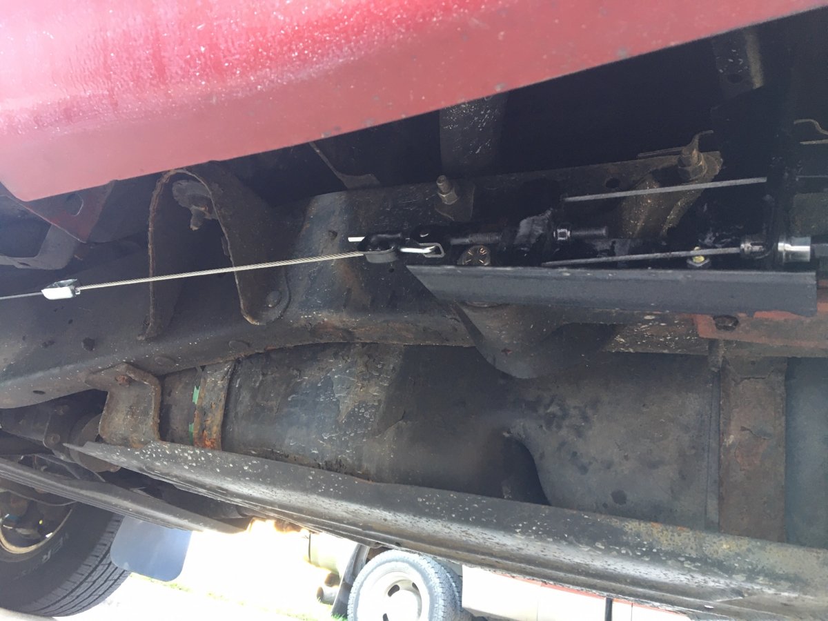

So I installed that back in the truck, and made another slightly longer intermediate cable (good thing I still had leftover cable stops and cable lol). I don't believe my DIY intermediate cable will cause an issue, but if it does at least I know I can probably use an ext cab front cable and eliminate it.
44028
I went back and adjusted the parking brake shoes one more time - this time in a different way. Before when I adjusted them, I followed the directions in my Chilton's service manual - which was to tighten the adjuster until you can't turn the rotor by hand any more, then back it off 8 clicks. Well, I personally think 8 clicks was too loose because it took a lot of pedal travel to barely get any response from the pedal. What I did instead is adjusted them more like regular drum brakes - tighten them until the rotor can't turn by hand, and then back them off just enough that there's still just very slight interference/drag from the shoes. Now with everything solid - the chevy leaf spring swap bracket no longer flexes under cable tension, all of the cables are new, the shoes are adjusted well, and with my new setup utilizing that Grand Cherokee equalizer bracket - it works well!
44029
It's hard to picture the incline here, but last time I tested the parking brake in this spot (before bracing that flex-y bracket), it wouldn't hold. But now it held perfect there, the truck was running in neutral in this pic. I even tried letting the clutch out slowly in reverse to see if it could overcome the parking brake easily, but instead it bogged down and didn't budge. Problem solved! :yahoo:

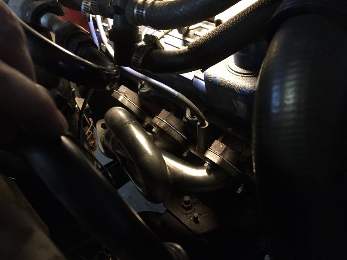

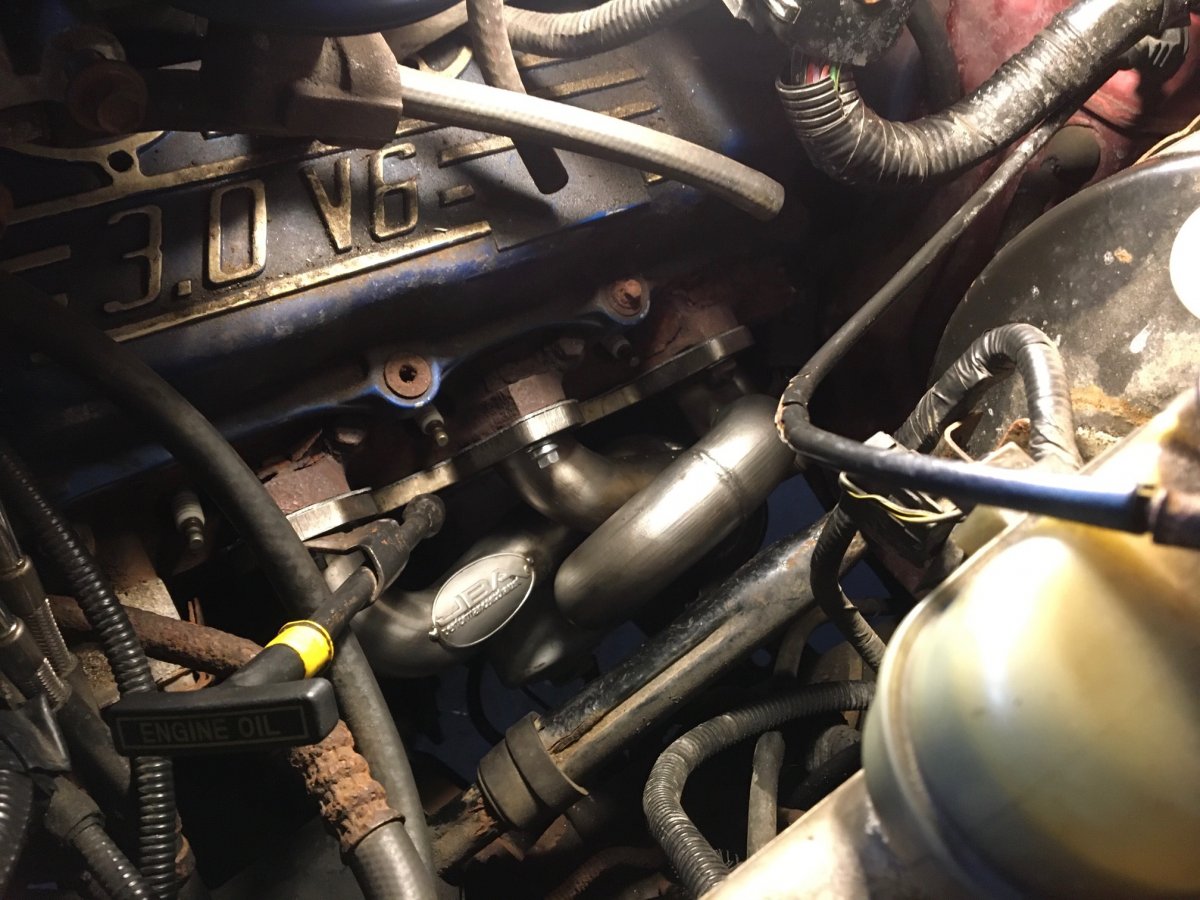

I've really been wanting to get some headers for the truck, but the only ones available are for a 98+ 3.0 Ranger. I did a bit of research and couldn't find any info on whether or not they fit older trucks. So, I decided to just buy a set and see if they fit as a christmas gift to myself lol.
And they do fit :yahoo:
53798
53799
The pictures make it look like the clearance is a lot tighter than it is, both sides fit well with plenty of clearance. Also, I wanted to keep my EGR, so I had to make a custom EGR tube to adapt to these headers. It was a simple task though, just cutting up the original and one for a 98, mating them up and welding it.

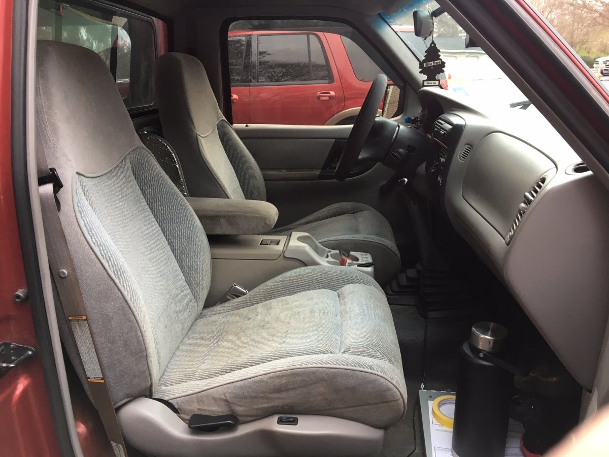

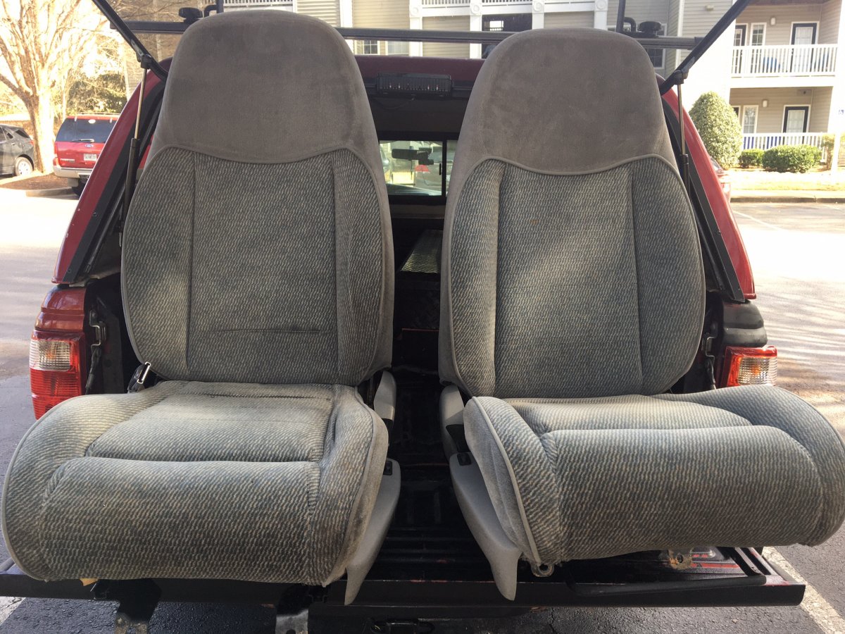

I've been looking to upgrade from these 60/40 seats forever. Every time a nice set of Ranger or Explorer buckets popped up, they were always gone by the time I messaged the person. Not this time! And this is one of the nicest sets I've seen. These were from a 96 ext cab. I found these on craigslist just under an hour away for a fair price including the shorty console. The drivers side is fully power, the passenger side just has power lumbar. I don't think I'm going to retain the power functions, but more on that later.
My 1997 Ranger 3.0 4x4

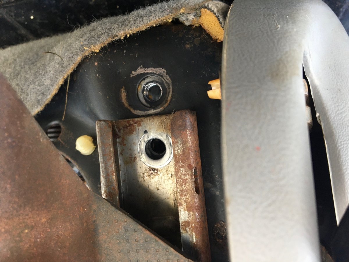

I did the passenger side first because I knew it'd be a little simpler. In this picture you can see that my regular cab brackets used a different hole than the ext cab brackets did. No big deal though since the hole was already there. I just had to tap them out on both sides, I believe the bolts are M8x1.25.
And with that done, I installed it and worked on the driver's side. The drivers side track bolted right on, I didn't have to tap any of the other holes.
At this point I realized I couldn't use the original seat belt brackets because they were in the way for where the console was going to be. I just took the seatbelt brackets off of the ext cab brackets and bolted them right to the seats, again using an existing hole.
I did have to drill it out larger first, then I tapped it to M12x1.75 I believe.
Thanks for all the extra holes Ford (y) it was meant to be!
Next up I started on the console. I got excited when I saw those dimples in the floor thinking they might line up with the bracket holes, but they didn't quite line up and it would've been too far forward for my liking. Instead I pushed it back as far as I could and just used some sheet metal screws to bolt it down.
And the (almost) finished product! The only thing left is to fasten down the front of the console. Unfortunately I didn't realize the guy didn't give me the front bracket, but that's no big deal because I don't think it would've worked with how I pushed the console back anyway. I'm just going to run two sheet metal screws in the front to hold it down, they'll be hidden under the cupholders so I think that'll be just fine.
I'll knock that out tomorrow, and then I plan on pulling the seats back out and giving them a deep clean as well as cleaning up underneath the seats, it's pretty gnarly under there. I didn't want to do all of this first because I needed to have the seats in by the end of the weekend and I wasn't sure how difficult it would be or how many issues I would run into. But that ended up being a super simple swap!

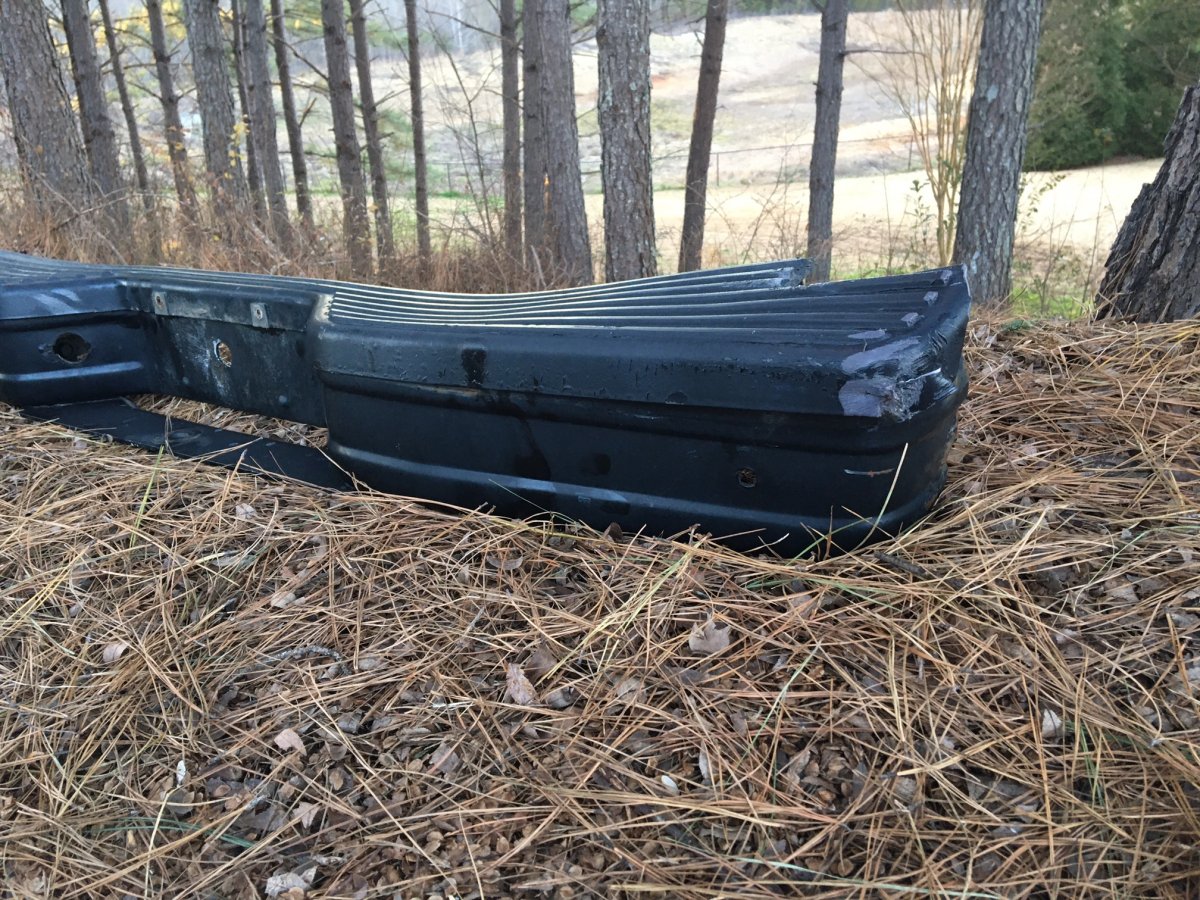

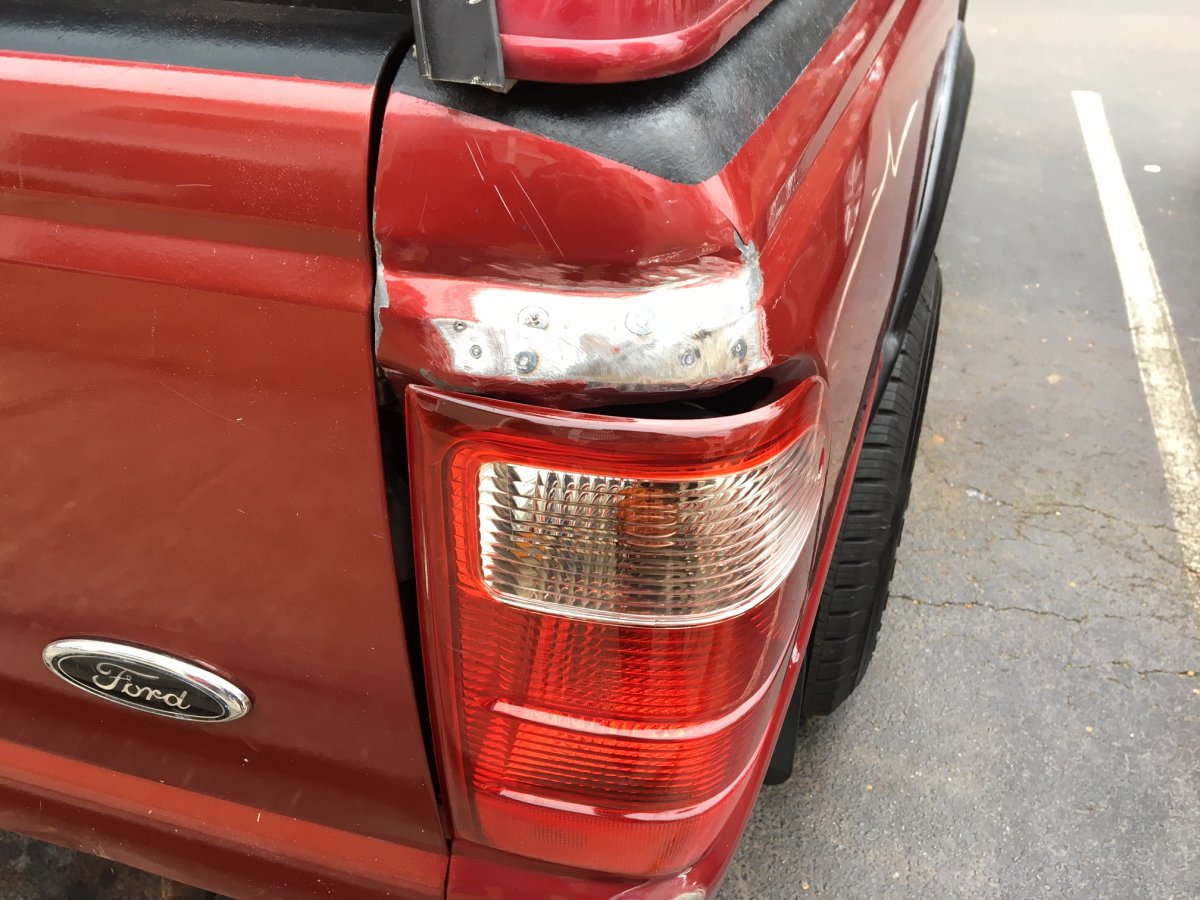

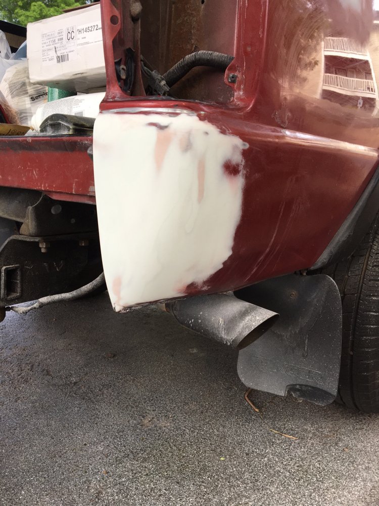

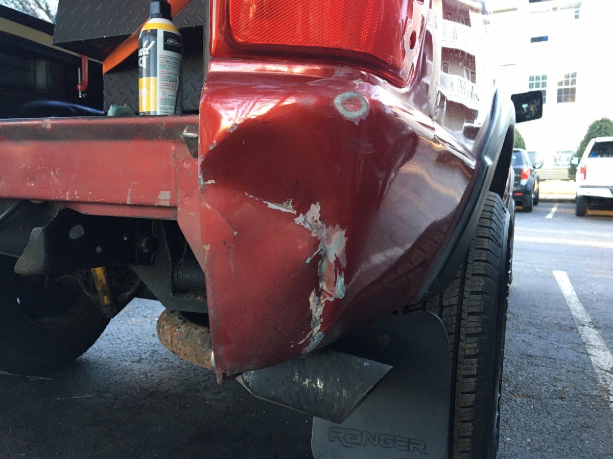

Back in January I accidentally backed into the garage at my parent's house lol... :pissedoff: It left the right bedside pretty messed up. The tail light in these pics was the replacement because obviously the original was smashed up. The bumper got all bent up too.

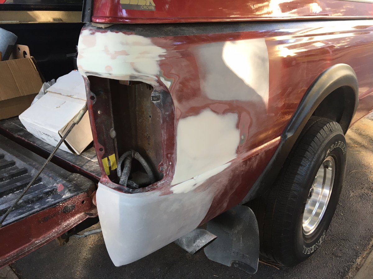

I took some more shots of it when I started repairing it, you can see how messed up it was by looking at the tailgate gap and how the tail light wouldn't sit in all the way.
At first I tried using a stud welder and a slide hammer to try and pull the damage out but there was no way in hell that was going to work. A buddy of mine let me take the truck to his place to use his welder, so we welded on metal tabs and a come-along on the hitch of my friend's Expedition to pull the damage out lol. I wish I took pictures at the time but of course I didn't. Then I used bondo fiberglass filler to build most of the shape first, then regular filler and glaze to finish it off before primer.

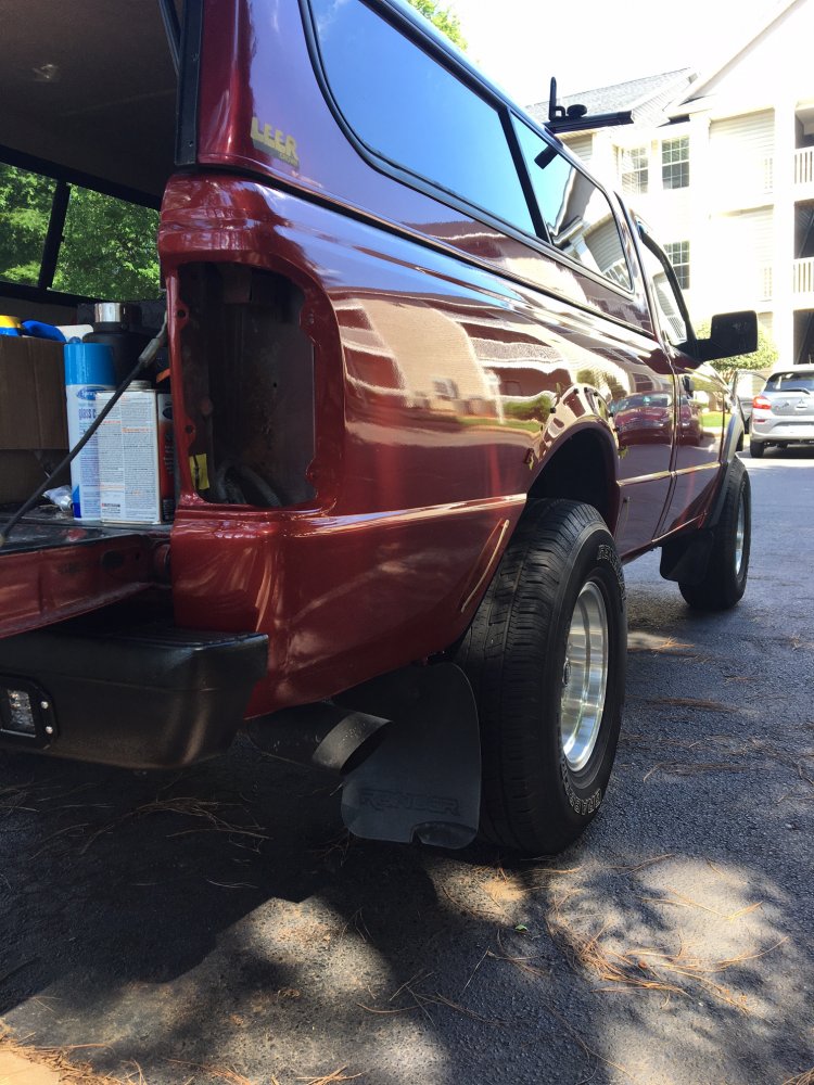

Another friend of mine's brother-in-law owns a body shop and he was nice enough to let me use his paint booth to spray the bedside which was awesome. Also, I got another bumper from a local salvage yard, but for some reason they only had chrome bumpers that were in useable shape. So I scuffed it up and painted it with bedliner and added some reverse lights into it.
And after a few days I put it all back together. It looks pretty good, way better than it was for sure. It's definitely not perfect but I'm happy with it and proud of it, especially for being a parking lot fix (for the most part) lol. The color match is pretty good, it just outshines the rest of the truck right now with that fresh clear coat. I think if I buffed the tailgate it would be a dead match, or at least way less noticeable than it is now.

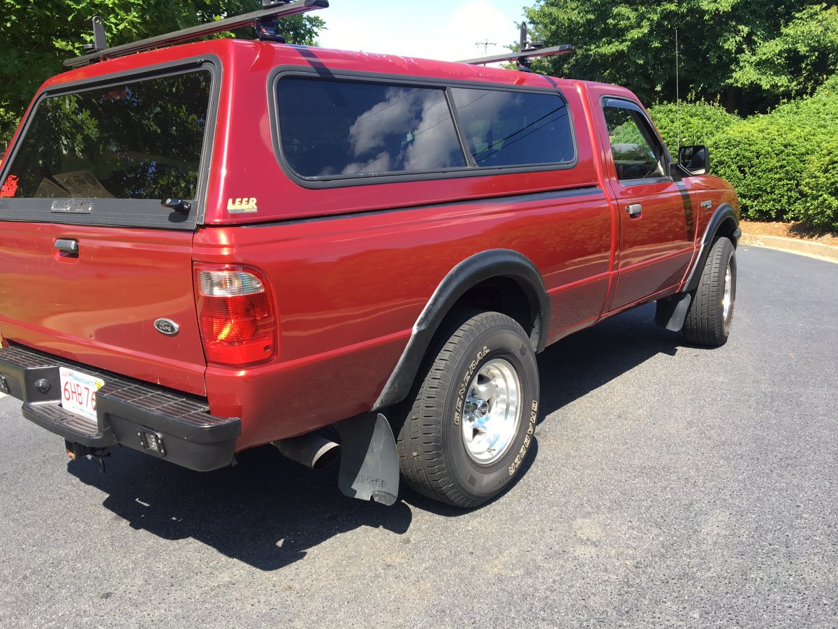

Good as new!
Also I don't think I'd mentioned it before but I got the cap for this truck for real cheap just to have more useable bed space for when I moved recently. At first I wasn't sure I'd keep it, I'm not really a fan of the look of caps on trucks. But it's hard to beat how practical they are so I think I'm going to keep it. The paint color almost matches, and having the roof racks is nice too. I put new struts and locks in it, so it's been pretty useful. Maybe one day I'll repaint it too so it doesn't look as crappy 🤔

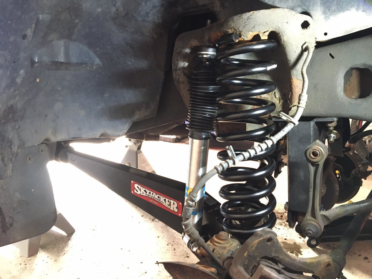

Got a new 4" lift installed the past couple days. I've been wanting to do this for a while. Along with the lift, I also brought the axles to a local shop (thanks @ericbphoto for the recommendation!) to get re-geared to 4.88, and I plan on getting 33" tires soon. I didn't take many pictures during the process, but here was the passenger side completed.

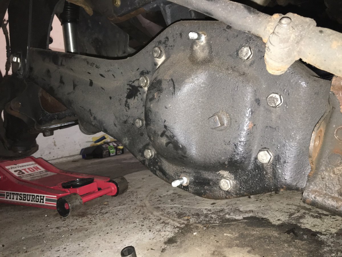

And I thought I'd share this in case it helps someone. Installing one of these front differentials onto the axle beam by yourself is a bit of a pain in the ass to say the least. Something I thought of when swapping mine out was to get some studs to use as alignment pins. The thread is M10x1.5.

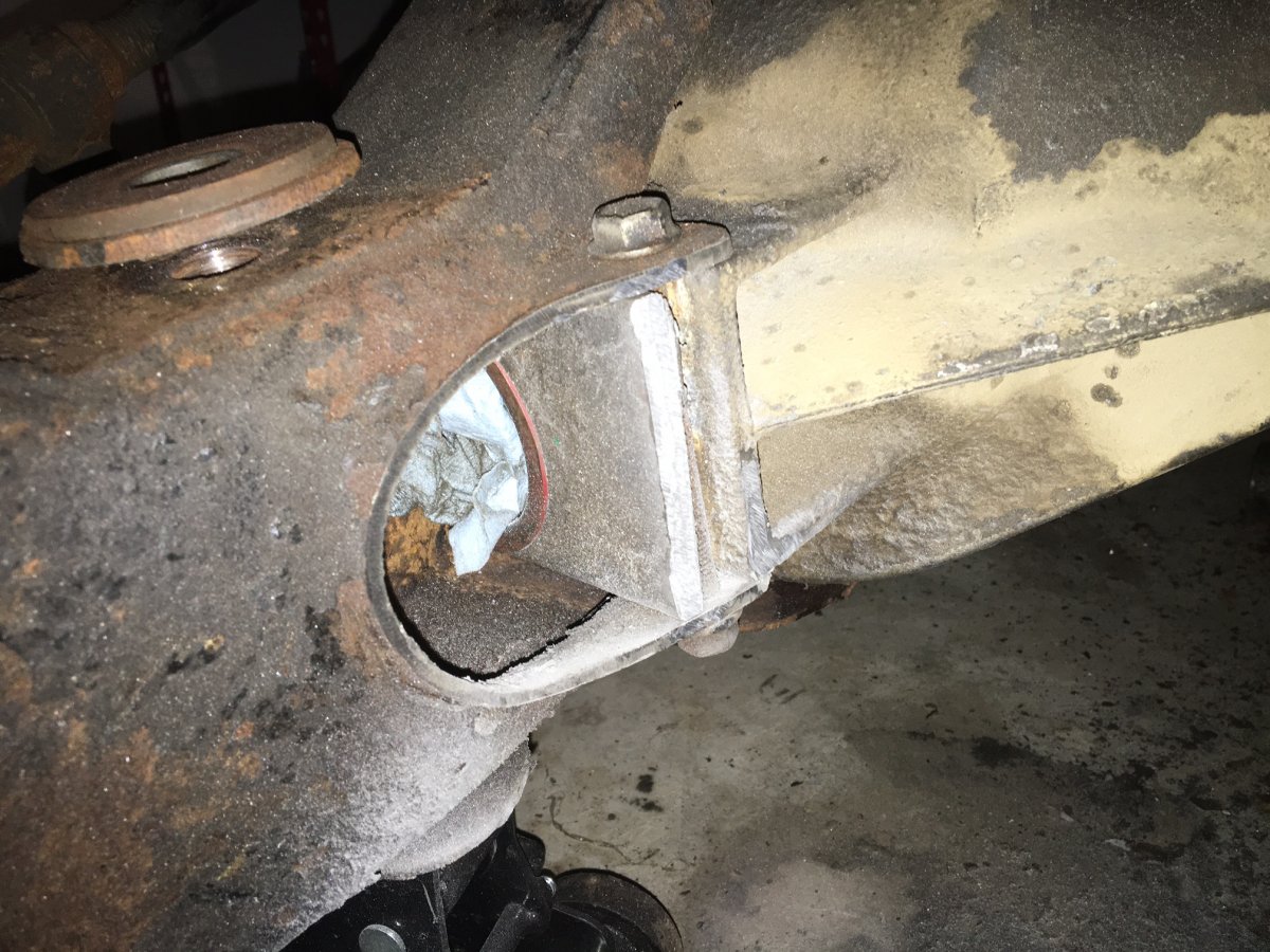

I was surprised how much grinding was required on the drivers side beam and part of the differential for the skyjacker radius arm to fit.
And here's the finished (for now) product!
I definitely need longer brake lines now before I drive it too much, I wasn't sure if a 4" lift would require longer ones or if just a 6" would require it, but they do not have much slack at ride height, so I'll have to address that before I get to really drive this thing.

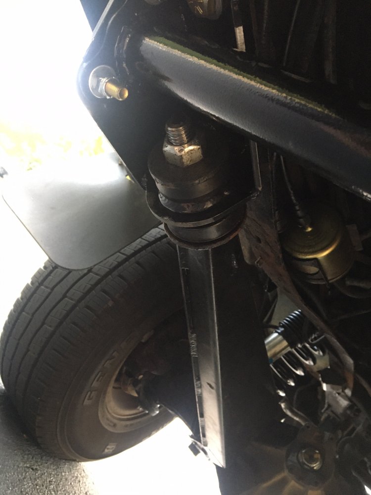

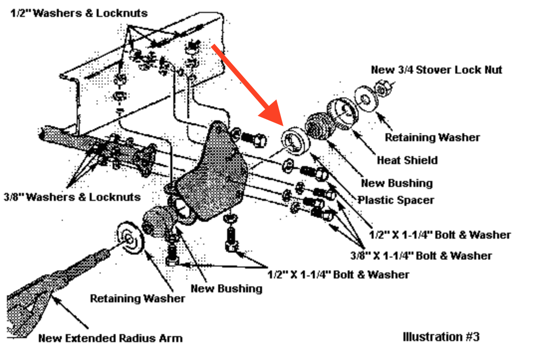

Also, question for those of you also running skyjacker radius arms. In the instructions, it shows setting up the radius arm bushings identical to the original. However, when I tried to do this, it seemed like if I used the OE plastic spacer that there would be little thread engagement for the nut on the radius arm. It also seemed like it spaced the bushings too far apart from each other, which didn't seem right to me. So I put mine together just using the bushings, without that little plastic spacer.
Here's a pic of my setup without that spacer.
My question is, for anyone running these radius arms, did you use the plastic spacer or just set it up the way I did? And would there be any issues not using the spacer?
I took some liberties with that part. It has been a few years and I don't remember if I tried the spacers and they broke. Or if I just didn't trust them. Below, is a picture of what mine looks like right now. No plastic spacer. I did add a metal spacer (looks like a large lock nut, but ID is big, so it's really just a big thick washer) between the arm and the big retaining washer that they provided. Seems to be working OK.
