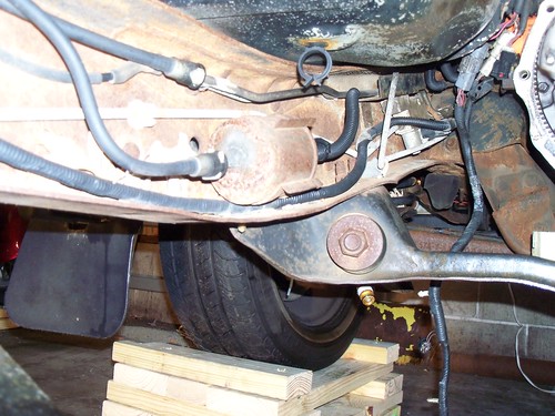

So my current job interview/vetting process had a pause so i decide to make some pizza, crack a beer and start up the clutch replacement
Got the truck up on my brand new custom DIY made "jack stands"
Got the lumber from HD on cull so all four stands cost less than $20 and I have plenty of lumber left over

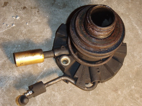

I'm replacing the slave cylinder and it looks a bit different
This is my old one
My 1996 Mazda B2300 2.3L Manual Clutch Adventure!
And this is my new one
Is this a problem or is it just a newer model??
I bench bled my new slave and it works GREAT! and the pedal works just fine too. So here is hoping!

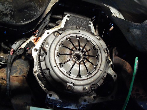

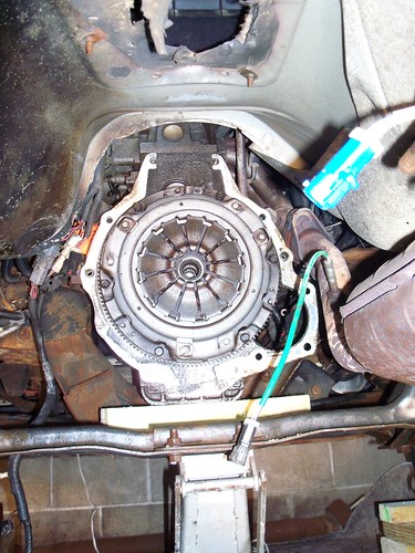

Good shot of the clutch
Another shot of the clutch

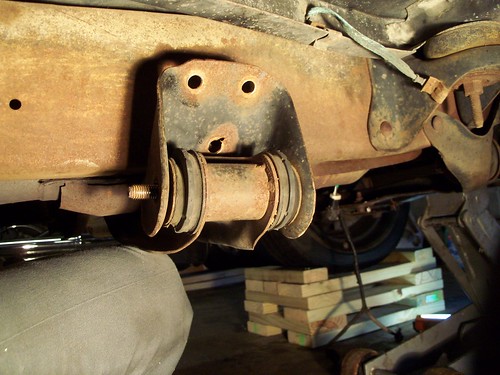

I removed these bolts to take out the crossmember to easily remove the transmission.

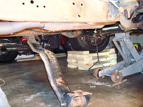

Dropped crossmember

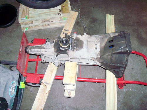

Removed M50D-R1 transmission

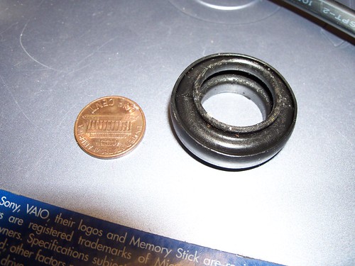

After replacing everything while cleaning up we came across this gasket. Anyone recognize it? A good project always has spare pieces right?
So 2000 miles later the clutch is working great
Heater core valve.
Parts were about $22. I replaced it with the motorcraft from Oreilly and it works great. I didn't even drain the radiator, i just unhooked the bottom two, undid them quickly and tipped the bottom two hoses and the valve upwards so they didn't leak. 10-15 min including cleanup!
That "spare piece" was actually sleeved over your shifter stub on the transmission. It was part of your inner shifter boot. Pull the shifter boot on your truck and look at where the shifter mates to the stub. I recommend replacing your inner shifter boot since it is a high potential for fluid to leak out over time. This can cause transmission failure if you don't check and add fluid every once in a while. I don't stock the parts anymore because it costs me too much to buy in quantity but the whole "shifter repair kit" can be had on ebay for $28 and is a good investment towards the life of your truck.
This part?
Awesome Thanks!
I'll look into the shifter rebuild.
Yeah that's it. It's actually a rubber seal that seals the shifter stub to the transmission and prevents oil from leaking out the top. Although it does take a long time to leak a large amount it's still an oil leak nonetheless.
