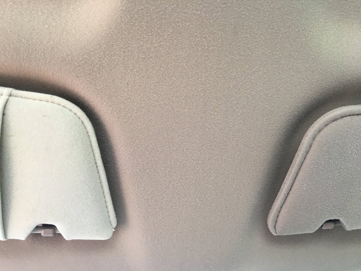

Apparently all Ranger sun visors go "limp" over time, in my case just the Driver Side, thought I had a good junkyard score from a 2001 Exploder Sport-Trac, BUT... not so much.
59441
Oh well, at least I have a makeup mirror on the driver side now... in case I find a GF who lies about "can't drive a stick-shift"... lulz...
Looks more gray to me. But a visor is a visor no matter what color.
No, it's definitely in the bee-ah-zhee (beige) family, but I probably need to tweak da settings on my ageing iPhone 6S.
Wanted to get the dual-flap visors from an up-trim Exploder, but strangely they were trashed on the upper side--which shows when deployed--but pristine on the underside which shows when tucked up... as if the owner pulled them down with dirty/greasy fingers, but tucked them back up with clean knuckles...? U-pick yards... ya gets what ya gets.
You almost need to pull parts from the same year vehicle if you want the same color...and pray it's been sun bleached at the same level as yours!

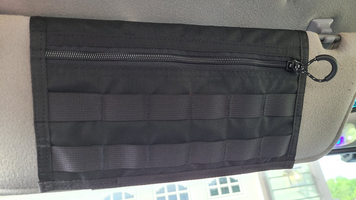

I need new visors. I have an extra pair that are black. But I fear they are in bad shape, too.
Recently bought some cool visor covers from Blueridge Overland Gear. They have velcro for velcro patches to stick to, plus Molle loops and a zippered pocket. Pretty cool. They cover most of the rips on my visors.
LOVE practical high-IQ accessories, esp. for pickups and sporty chariots, and that thar's a winner, BUT... my original issue wasn't tears, or even filth, but just that the inner "cardboard" became so limp and floppy that it requires TWO hands to maneuver it, and even then it can barely hold a sun-shade in place... maybe tomorrow I'll take the scissors to that tired discarded visor, and see what penny-saving material they used in there... will post mah findings...
