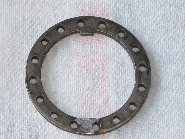

Welding of the tab on a washer that doesn't fit within the groove well is mentioned in the link BlackBII posted above, but I'll mention a slight variation on it here:
Add a small speck of weld material to the inner edge of the washer opposite the tab with your welder. Grind it down on both sides (if needed) so that the washer lays flat, then grind the weld down just enough so that the washer fits over the spindle and the tab into the spindle groove. Doing it this way I feel better avoids losing the heat temper on the tab, making it less likely to deform while you're tightening it.
If you don't have a welder, another way to do this is to bend the washer into a very slight oval using a vise so that the tab reaches further down into the groove. A caveat: I have seen an instance where the washer broke while trying to do this (apparently they are somewhat brittle). Do this at your own risk.
Pic showing the washer I did on a friend's '91 after welding & grinding it:
