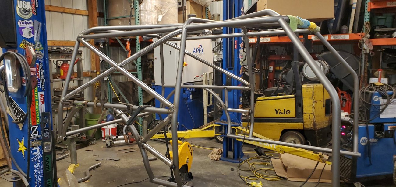

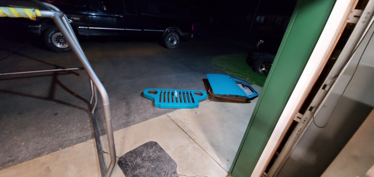

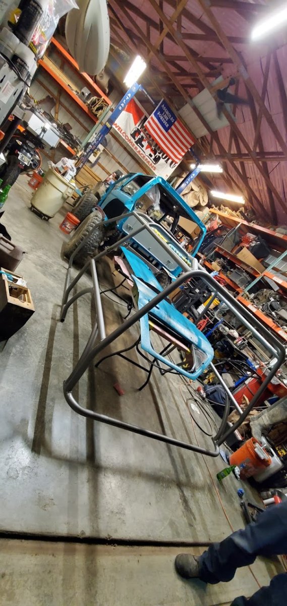

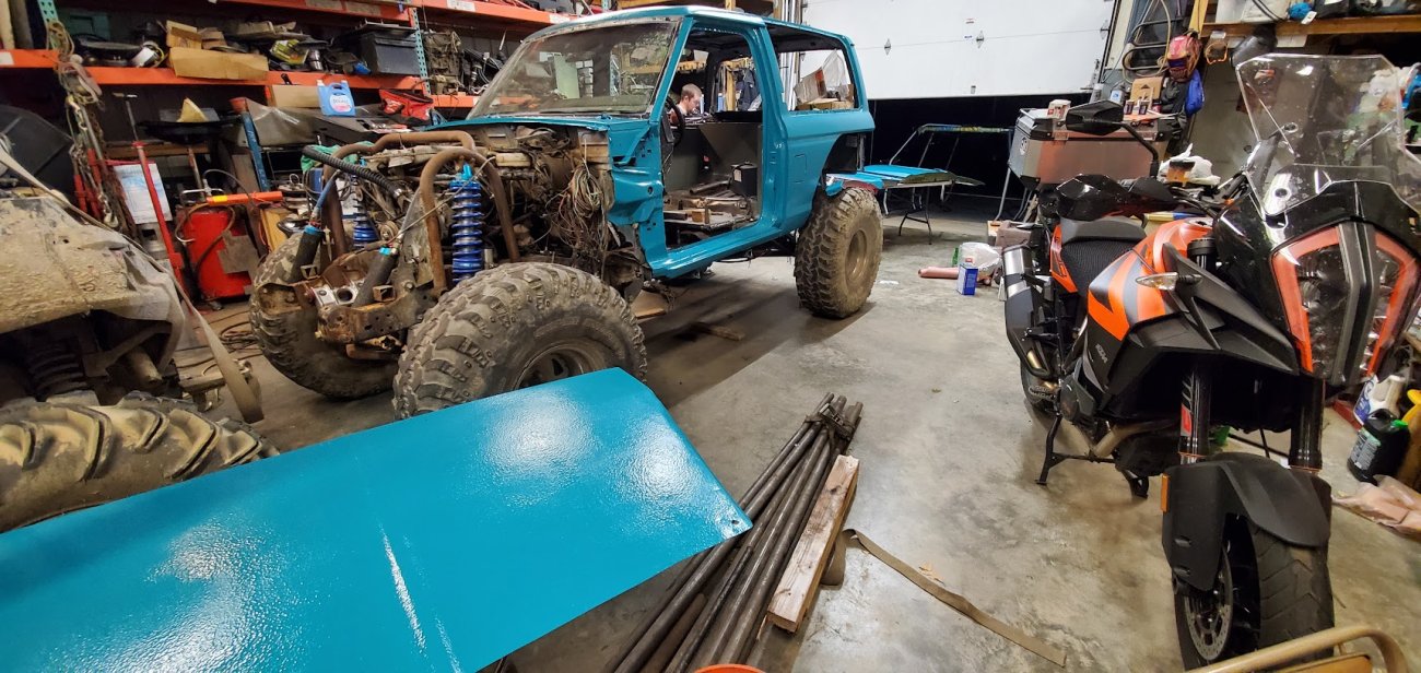

Coated the exo in STEELIT, weldable paint.

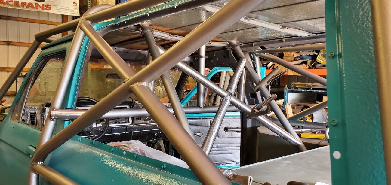

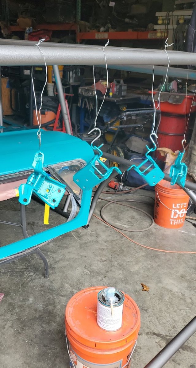

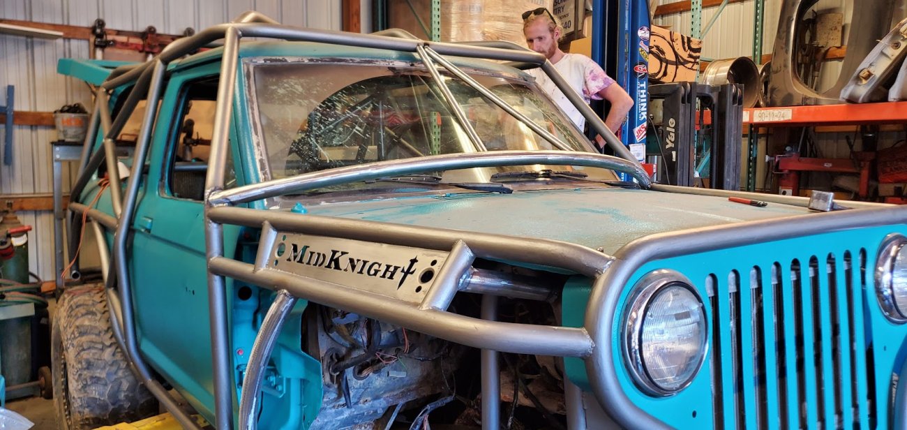

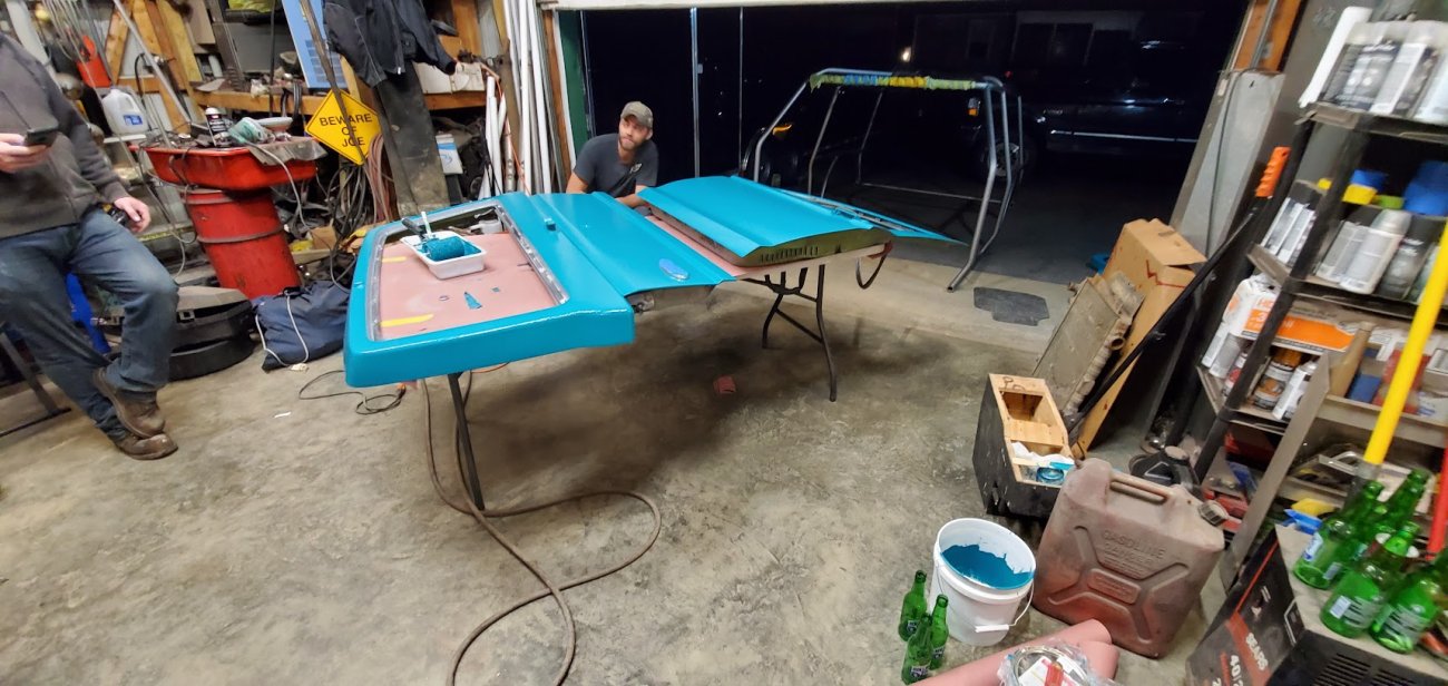

Started painting the jambs with my final color. Turquila Monstaliner.

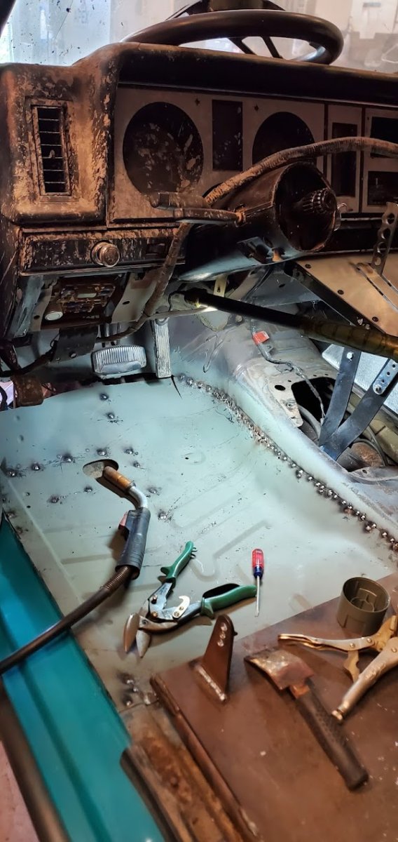

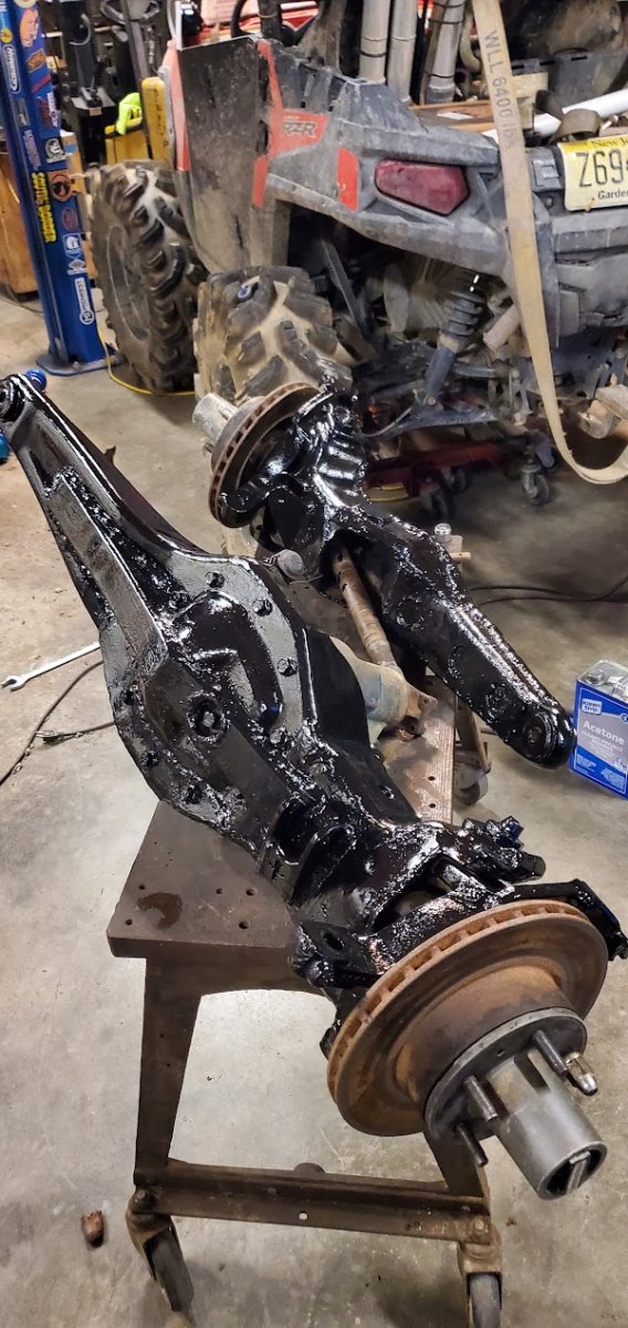

Sanded and coated chassis in STEELIT.

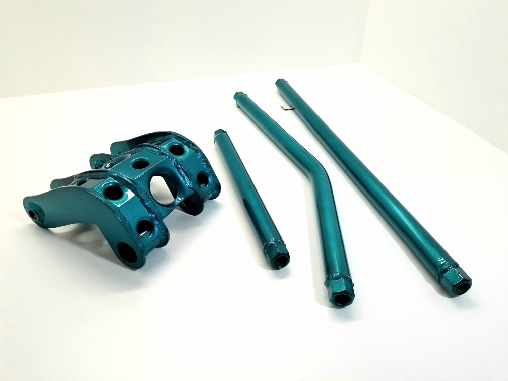

Got swing steering powdercoated.

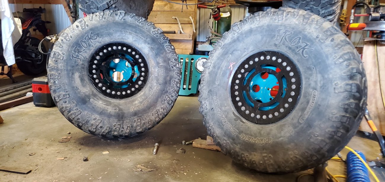

New beadlocks.

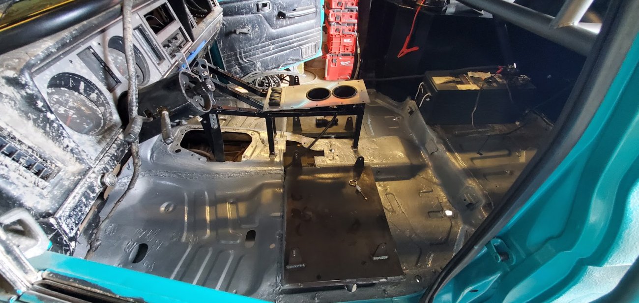

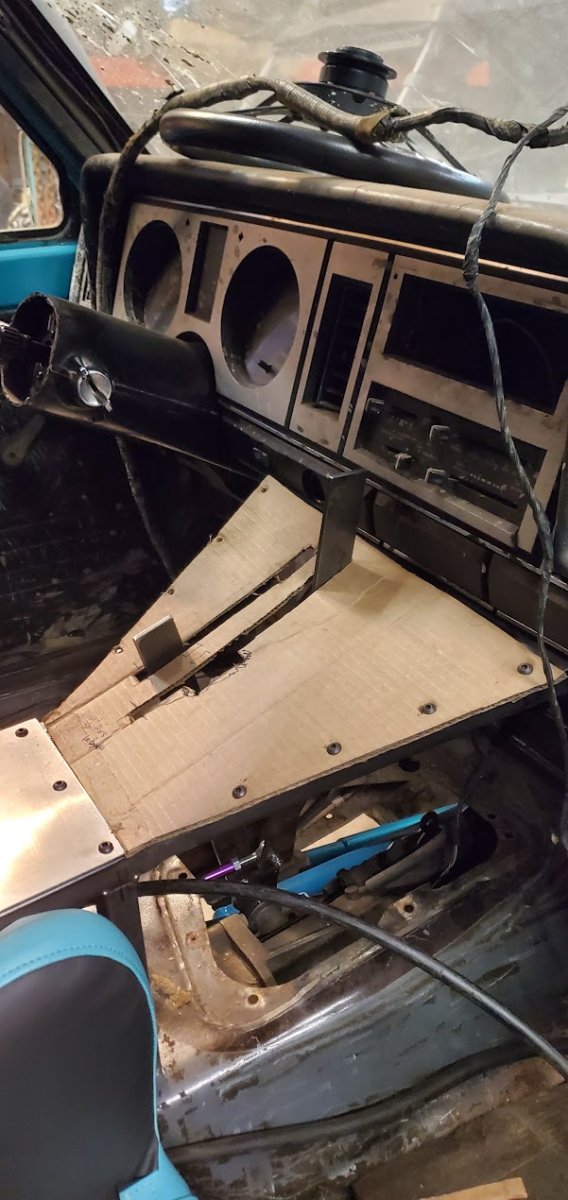

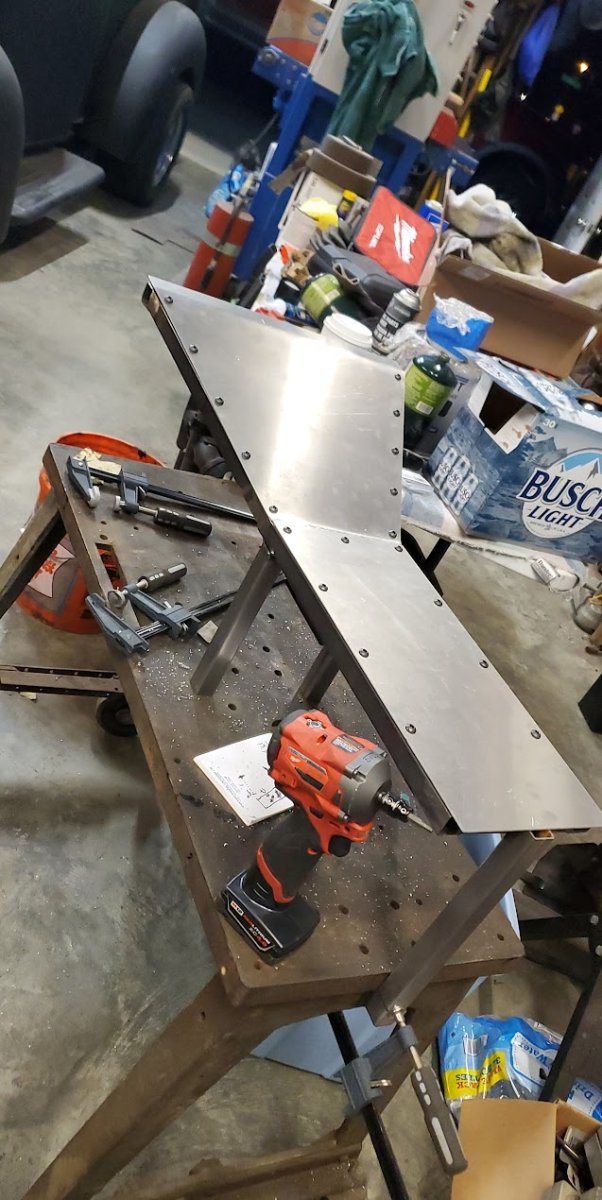

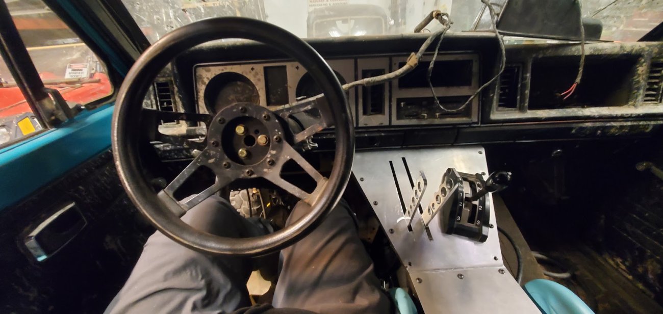

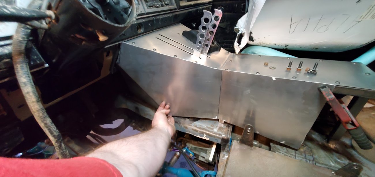

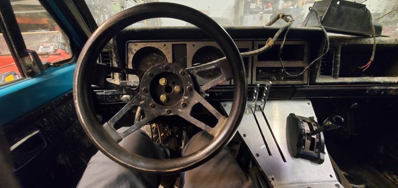

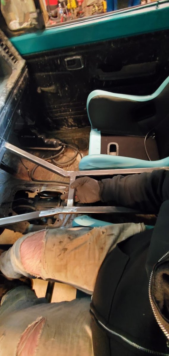

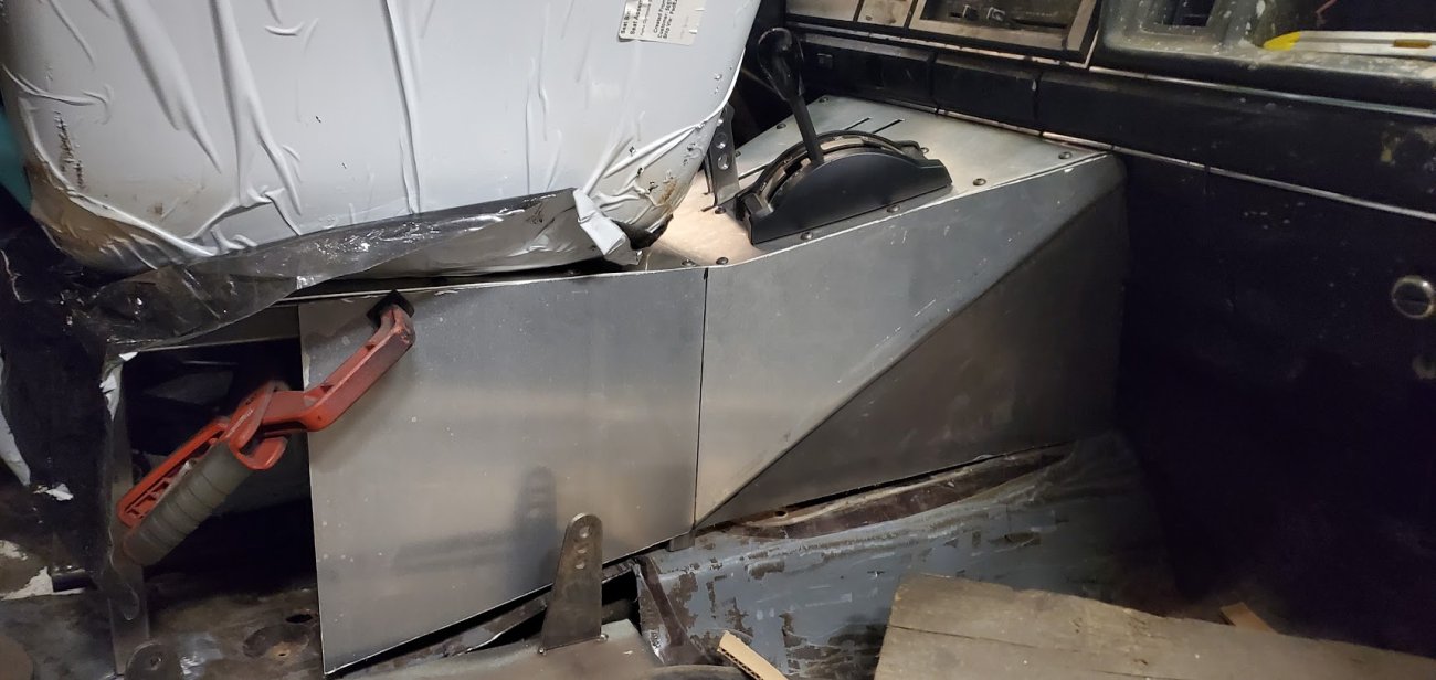

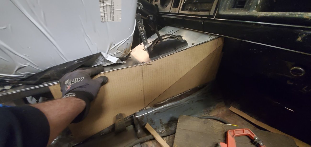

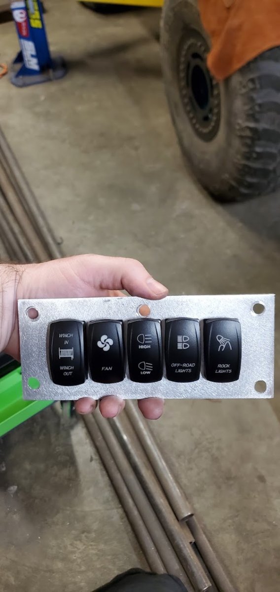

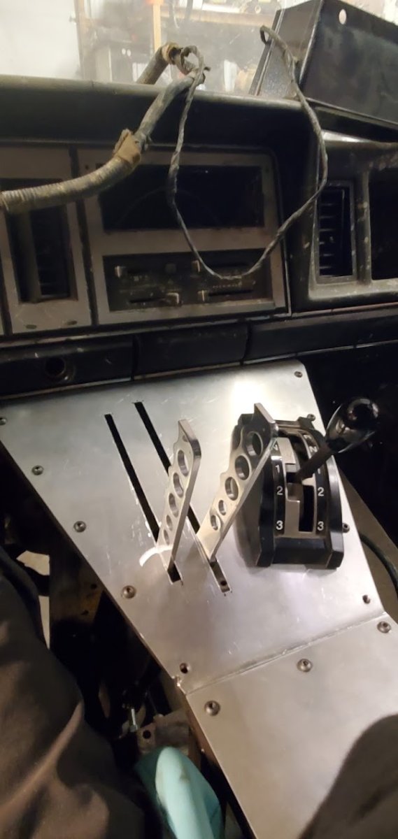

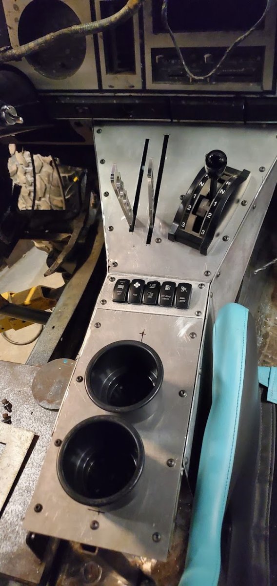

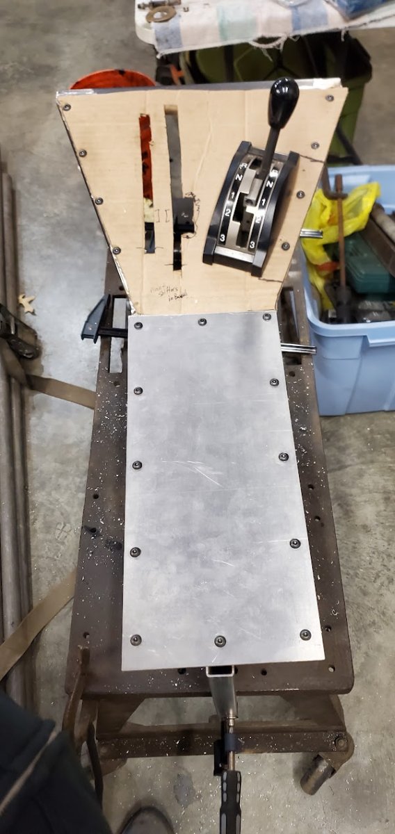

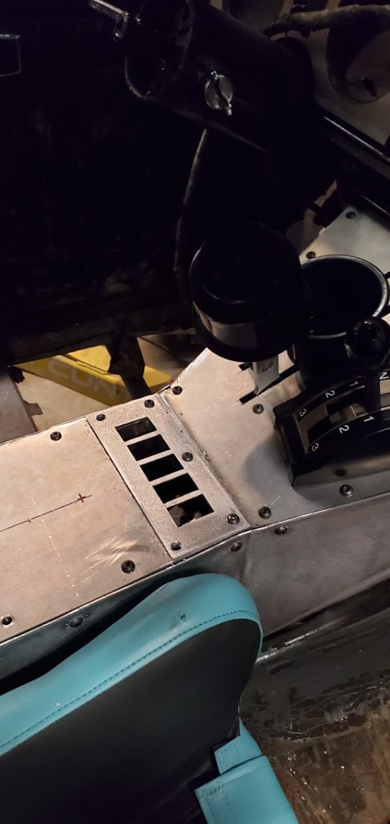

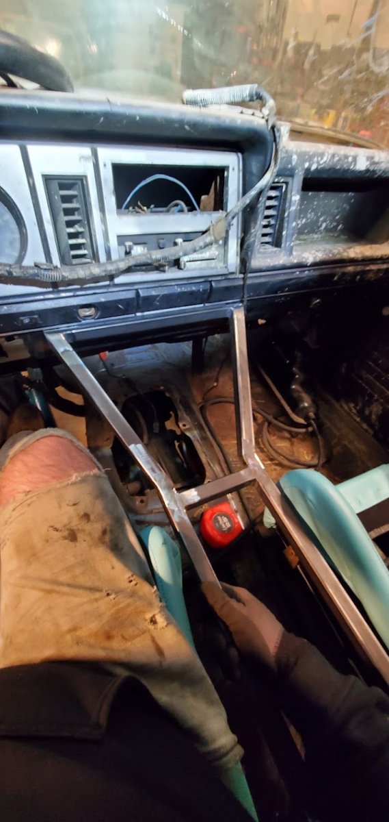

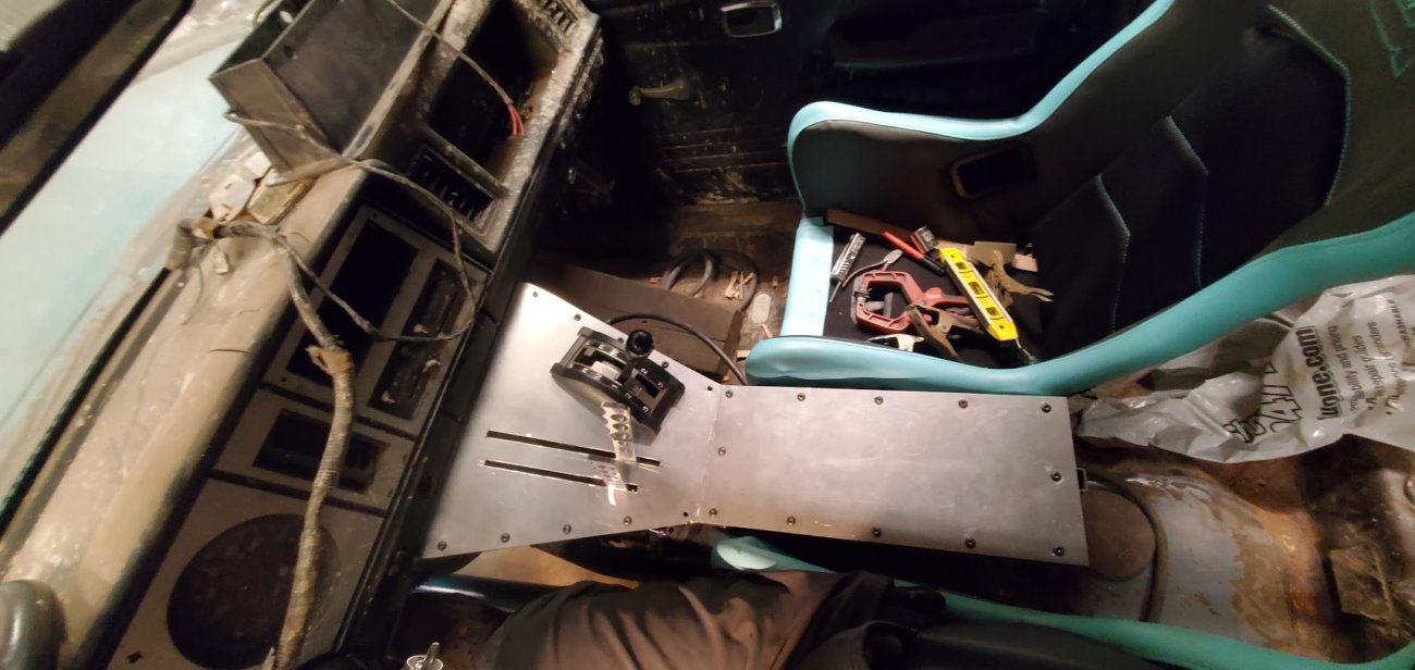

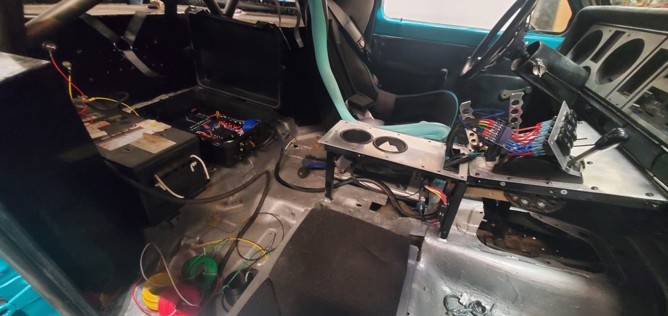

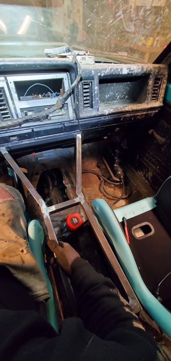

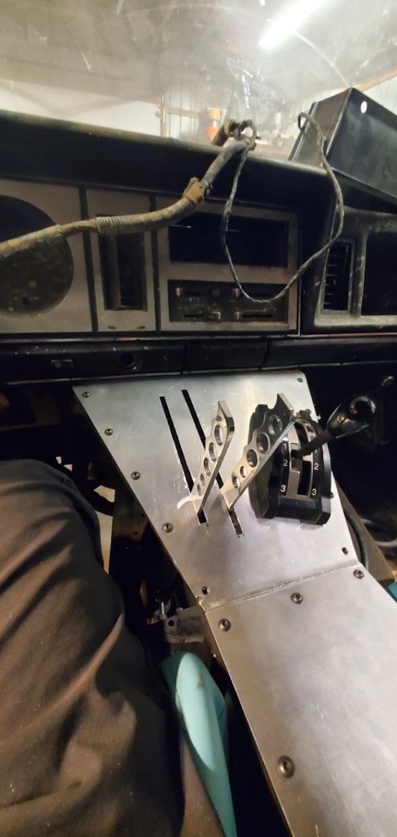

Center console time.

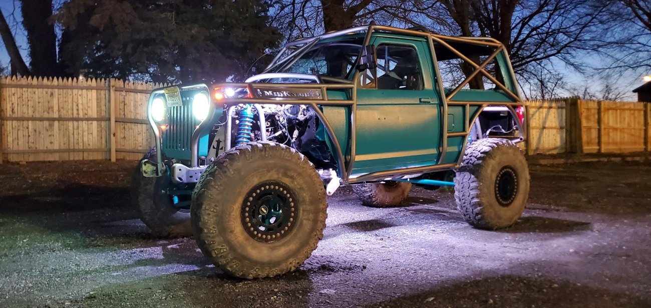

Hell of a lot of work there!

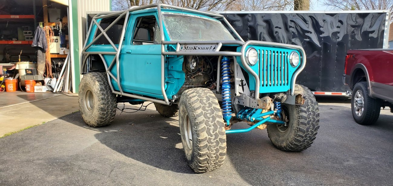

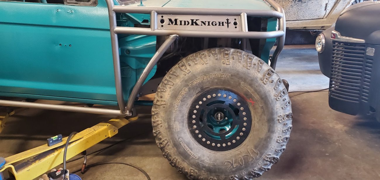

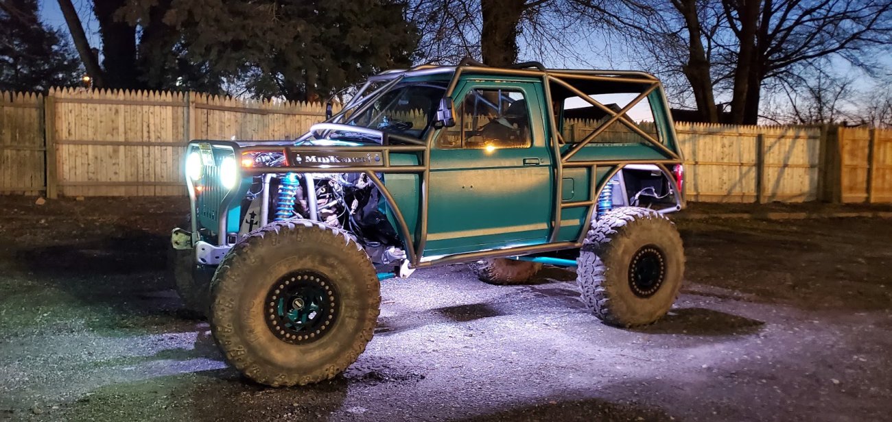

First

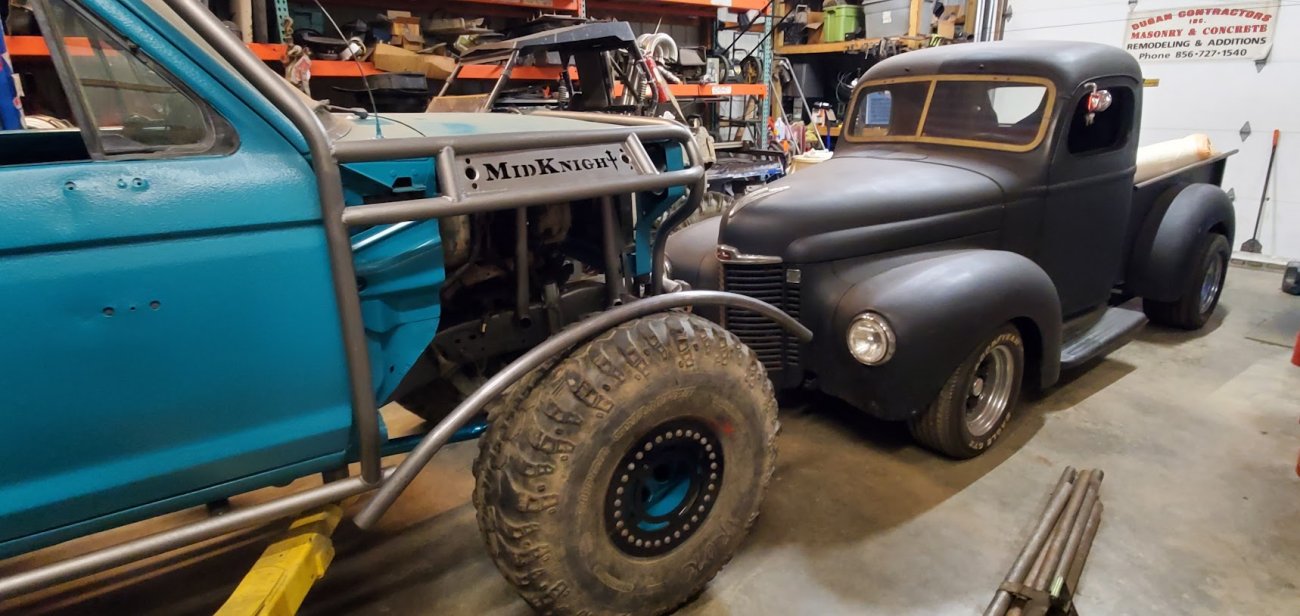

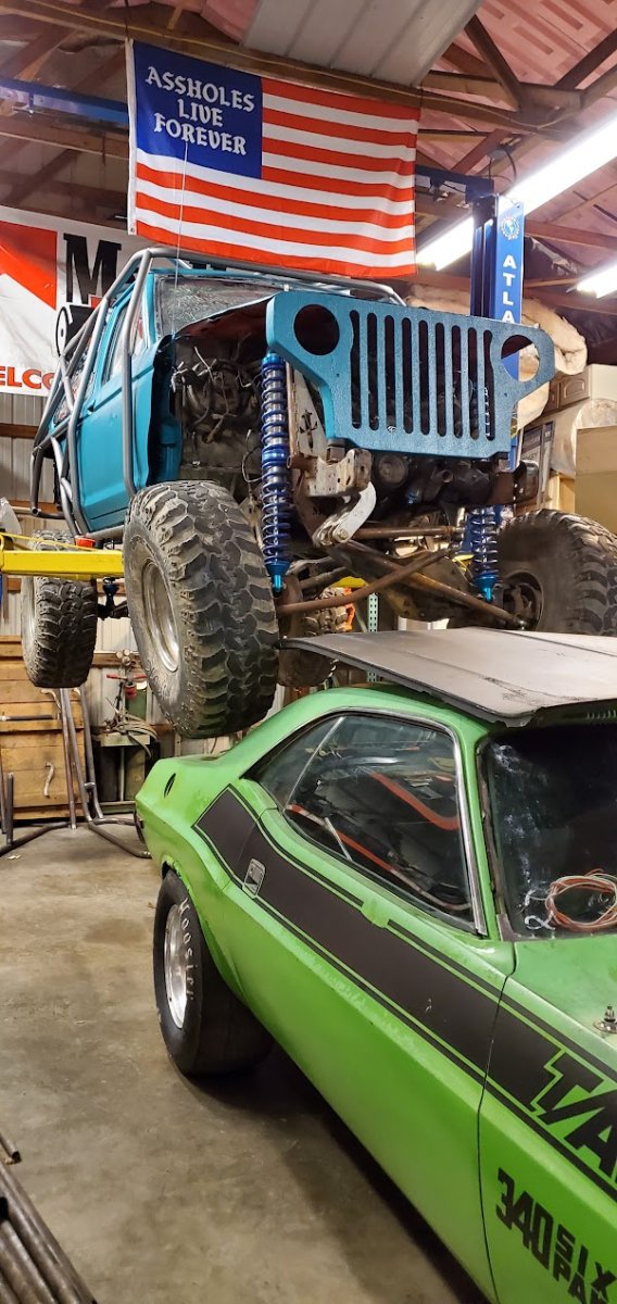

I expect that challenger back home in MY garage by midnight young man.
Have no idea why you think it should be out there....

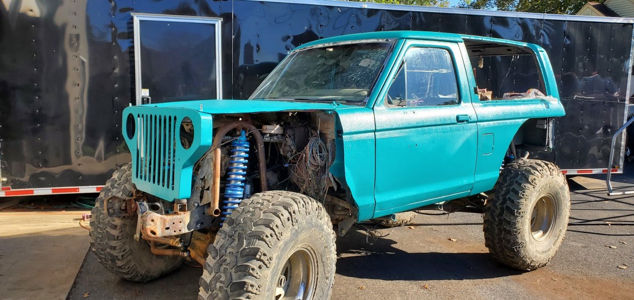

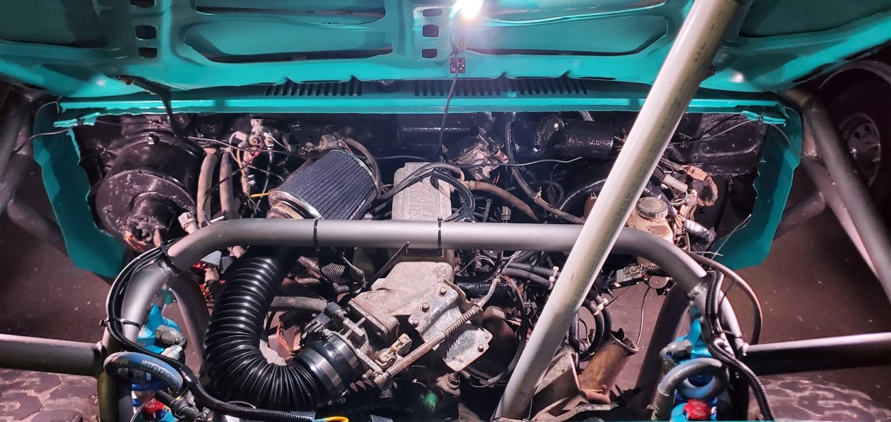

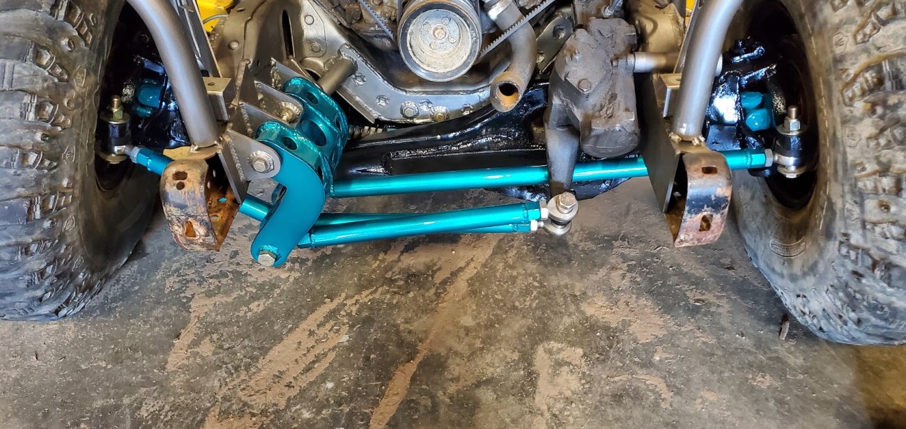

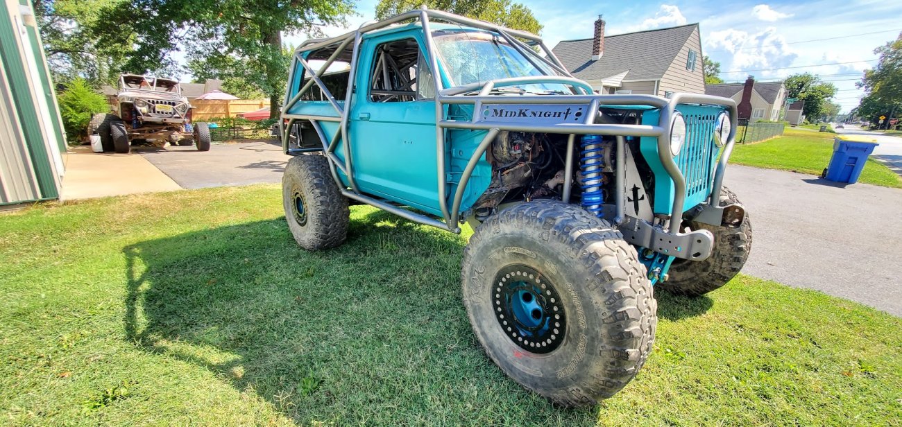

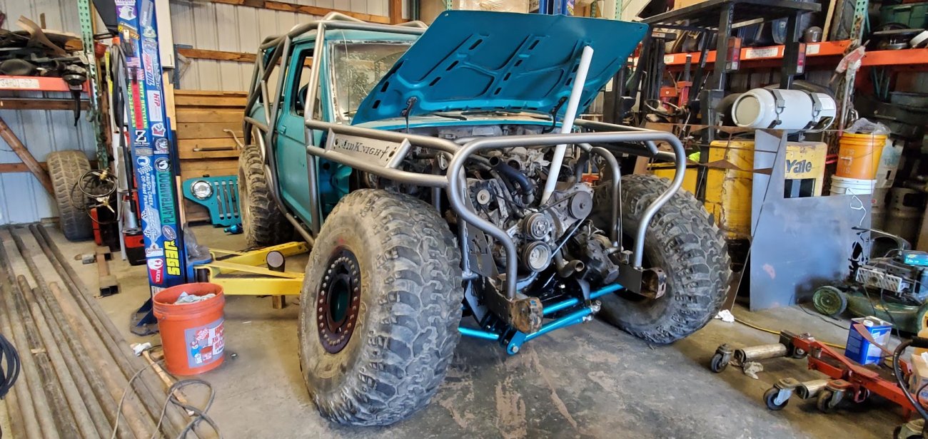

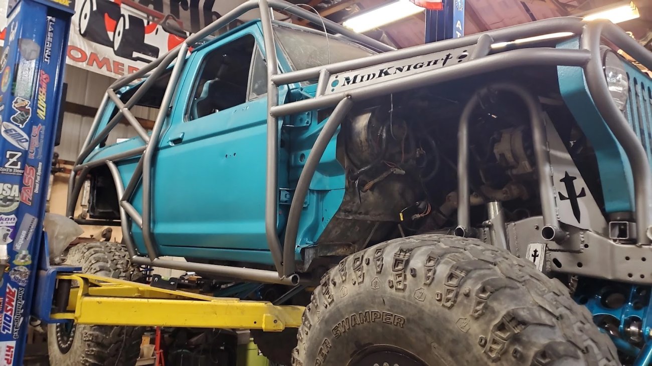

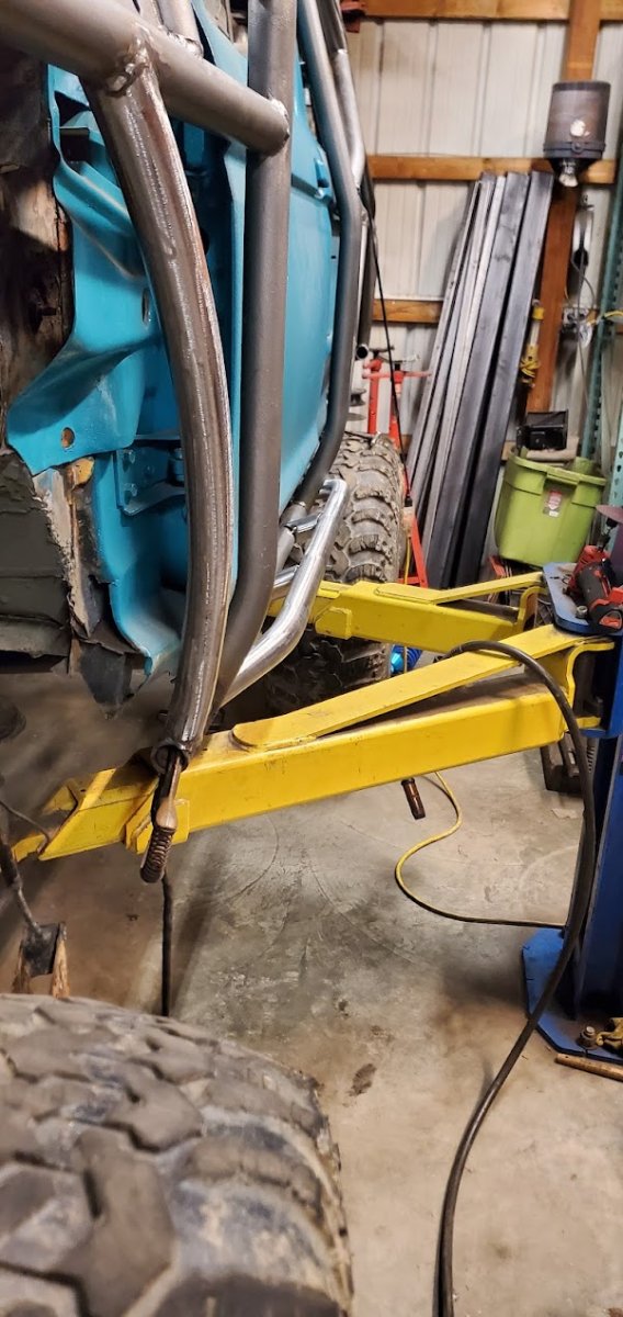

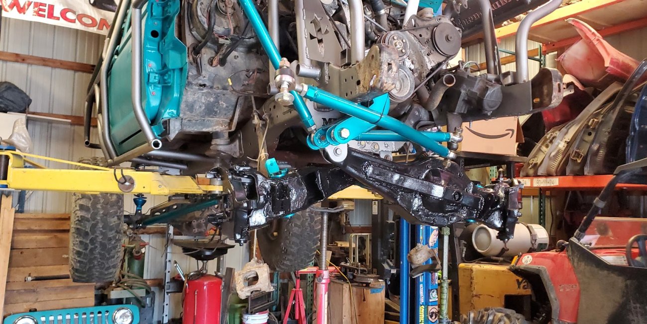

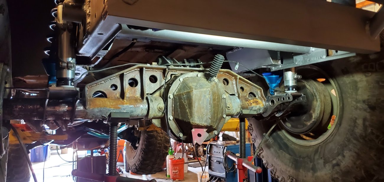

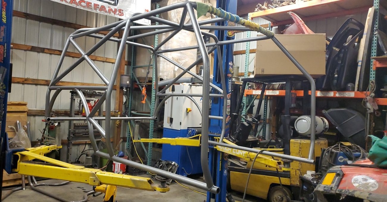

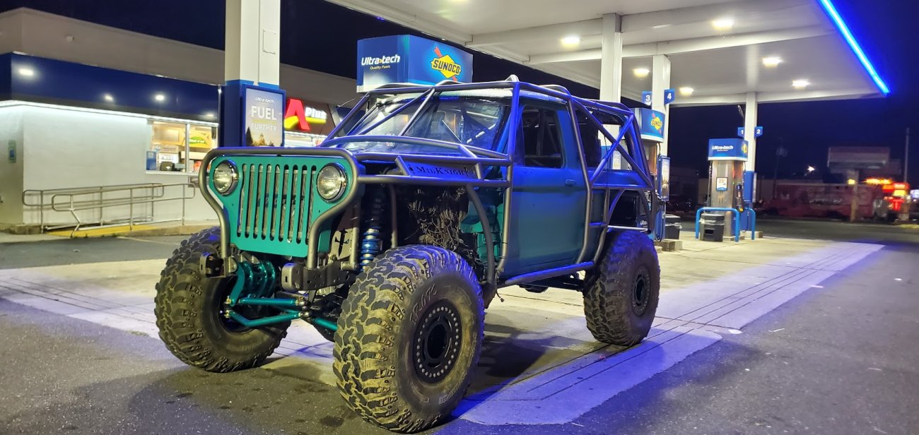

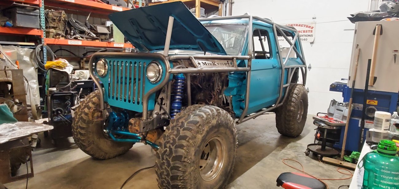

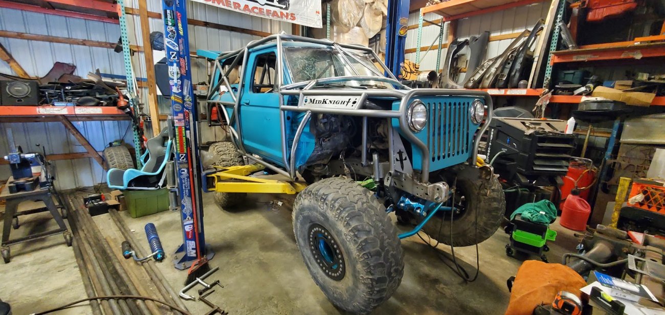

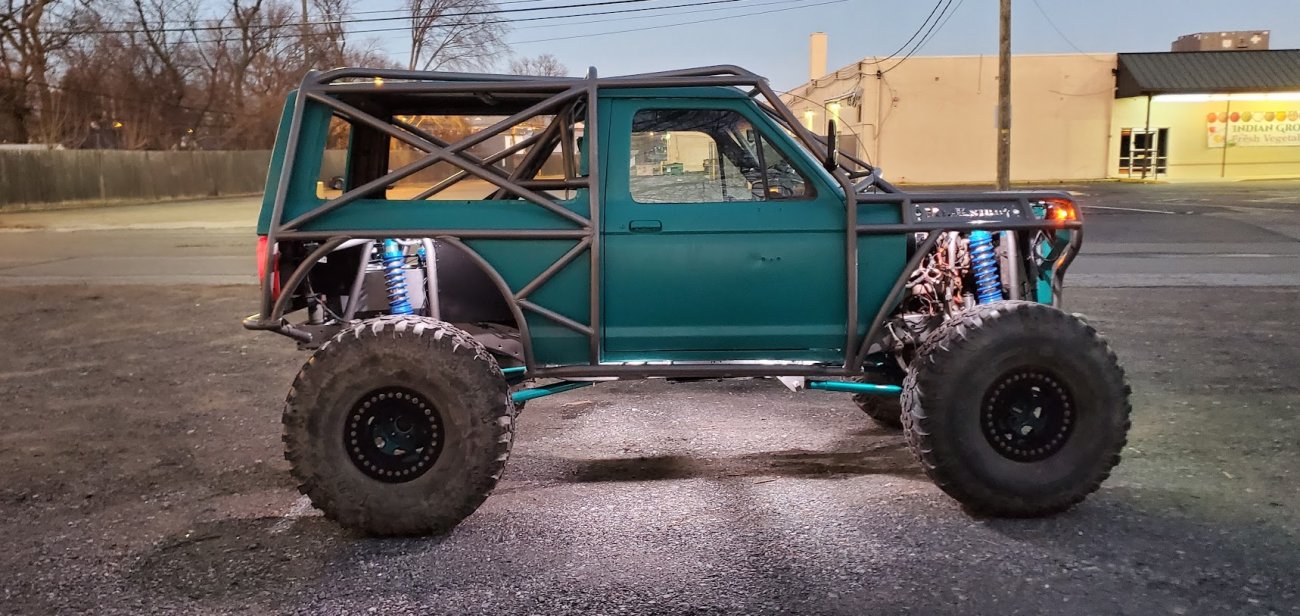

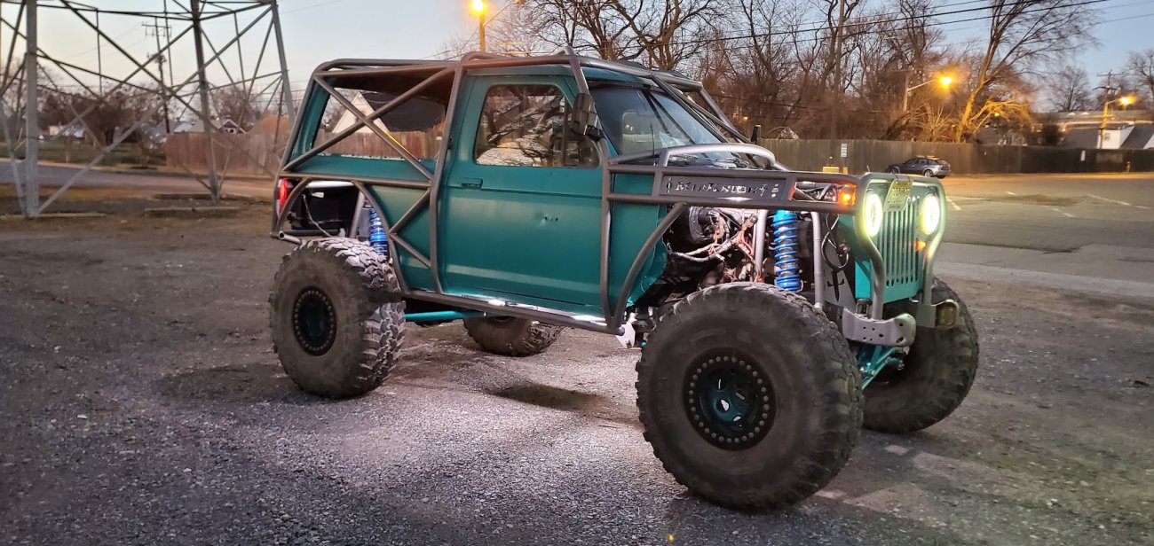

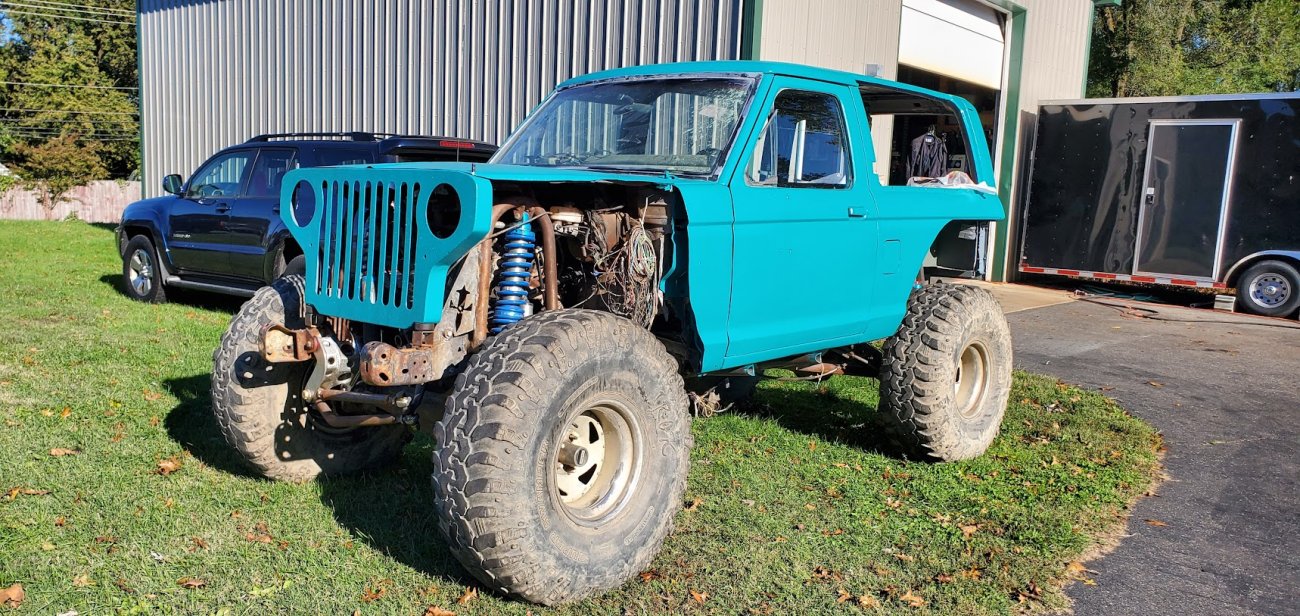

I definitely would have used a rear 60 and a front ttb 44 to avoid notching the frame.

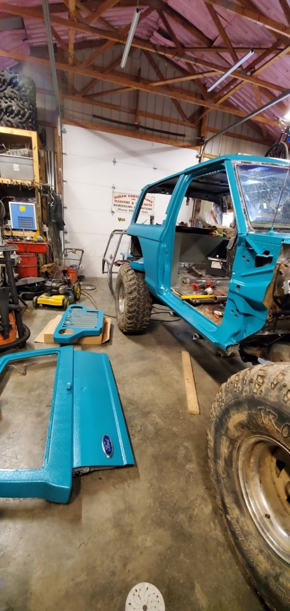

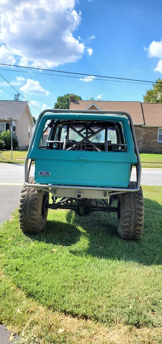

The exo being removable is superb! Wow.
I would have put it in the fenders.... But that's some good work.
Yup need more tube over the forward roof though and some sheet

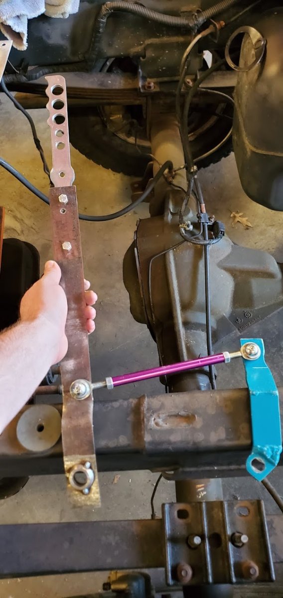

You can use a 31 spline slip yoke from a 2wd trans for the passenger side.
Cut and sleeve to extend.... Or if you went to a 50 pig or 44...with the 50 yoke...it can be a 1350 joint.
"Mini Me" Low COG B2 Crawler/Jumper Build
First

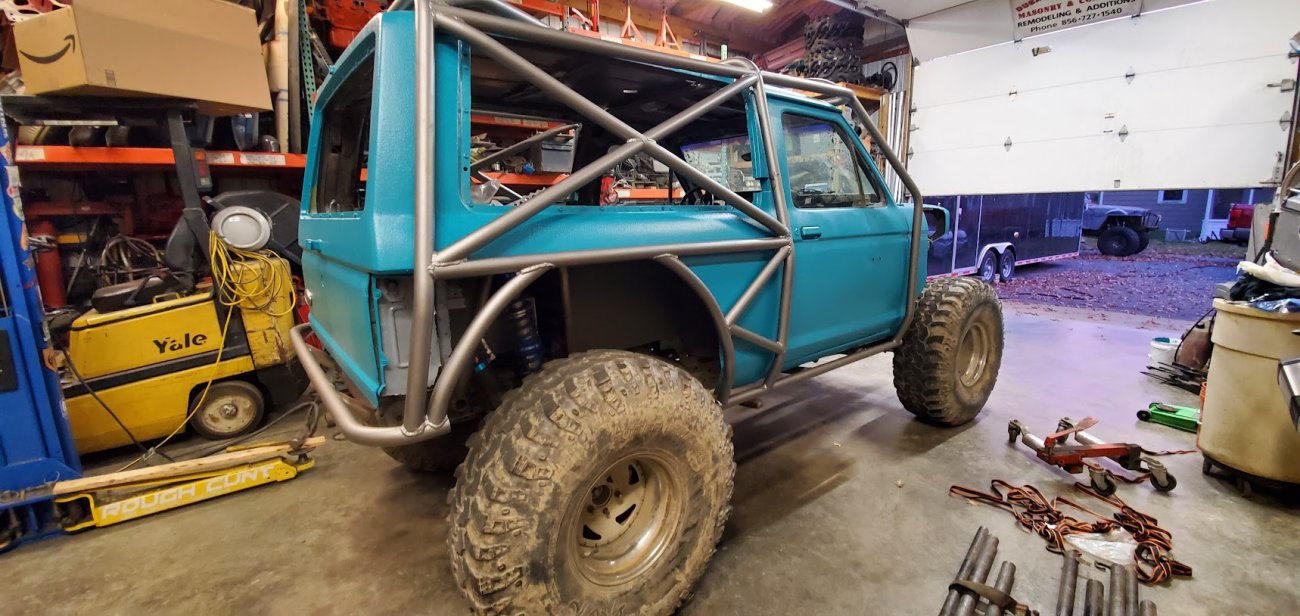

Challenger is my buddies. I was fabbing up some stuff for his hellcat swap haha
I had these axles mostly already setup snd i wanted a small track width
Im gonna do a bar across the lower Windshield snd then windshield bars.
Exo was removable only till it wasnt haha.

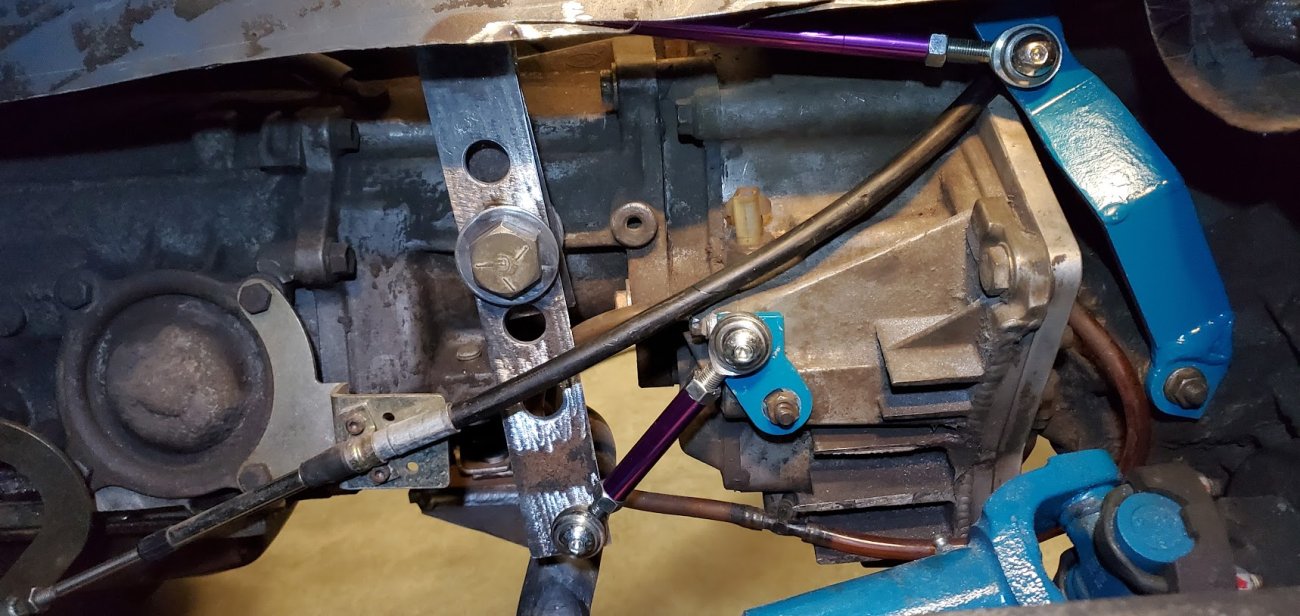

I modified the width of the axles and trimmed the splines. It fits just perfect at full droop and at full bump. No binds and no chance of coming apart. Took a little bit. But ill add your info to my notes for next time
