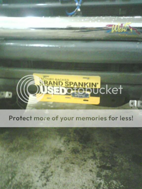

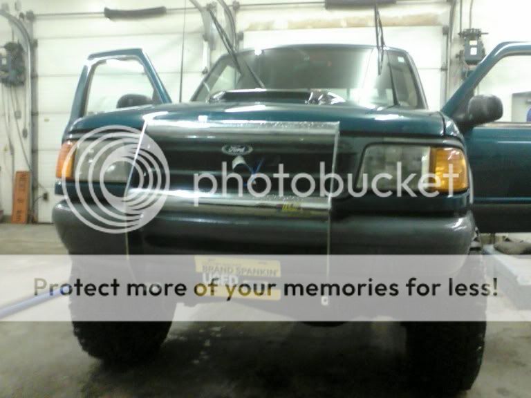

I also washed my truck for only the third time since I bought it and I took the chance to mount the plate multi sent me the way I wanted.

Today was a pretty successful day for Jammer.
Nice Plate:icon_thumby::icon_thumby::icon_thumby:
l8r, John
Thanks boys, but the credit does have to go to Mr. multiranger for sending it up to me all the way from Georgia.
