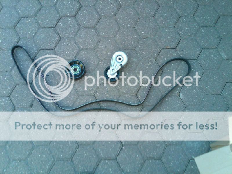

Mike while you are in there doing the waterpump check the idler pulleys to make sure the bearings are good... Mine went south and seen another Ranger this week with the same issue... It could save you some time!!
Thanks multi, that completely skipped my mind. Pulley + tensioner check.
Hey buddy, I just got done doing my idler pulley and tensioner, and a new gator back belt....order it through rockauto.com, i got mine for CHEAP.

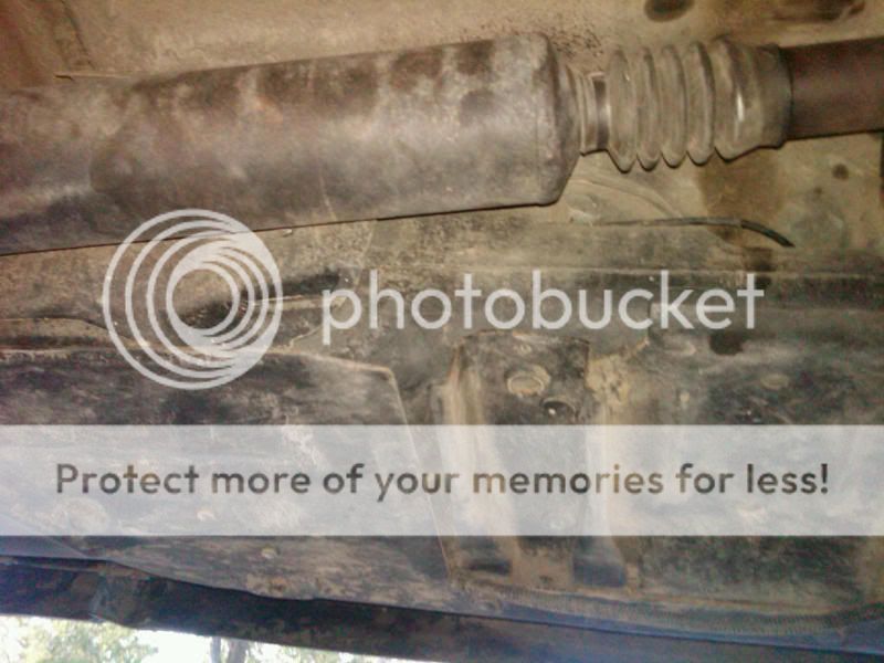

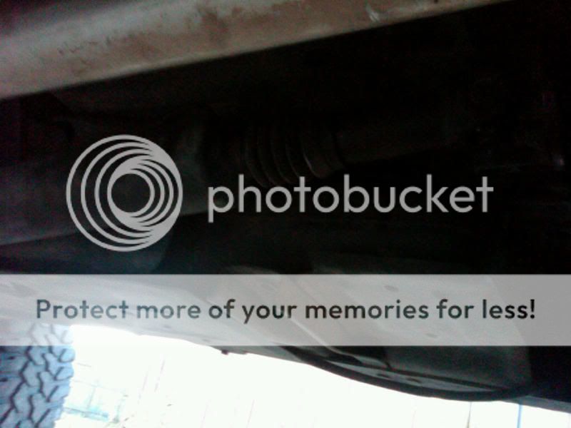

I couldn't get the stock steel 98 shaft to quit rubbing on the tank....but mine was hitting the brackets that hold the skid plate itself. I ran it like that till I mangled the shaft in a rocky creek one weekend. I got a custom shaft built out of the ends of my old 2 piece shaft. That was it was smaller tube, but I went with a very heavy wall. I've got 3 of them 1 Piece shafts in my shop tho....collected them from work for spares.

That's not what I wanted to hear Ryan:dunno:
I guess I'll see in a hurry, if it looks like it's not going to work I'll just put in a new carrier bearing and live with it.

Hey buddy, here ya go, sorry the trucks a little dirty. Make sure you trim the CRAP out of your gas tank skid. I just made sure to round stuff off and paint it.
