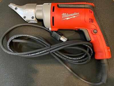

I’ve found it’s less about the height and more about the inside RUBBING!!!! :D
