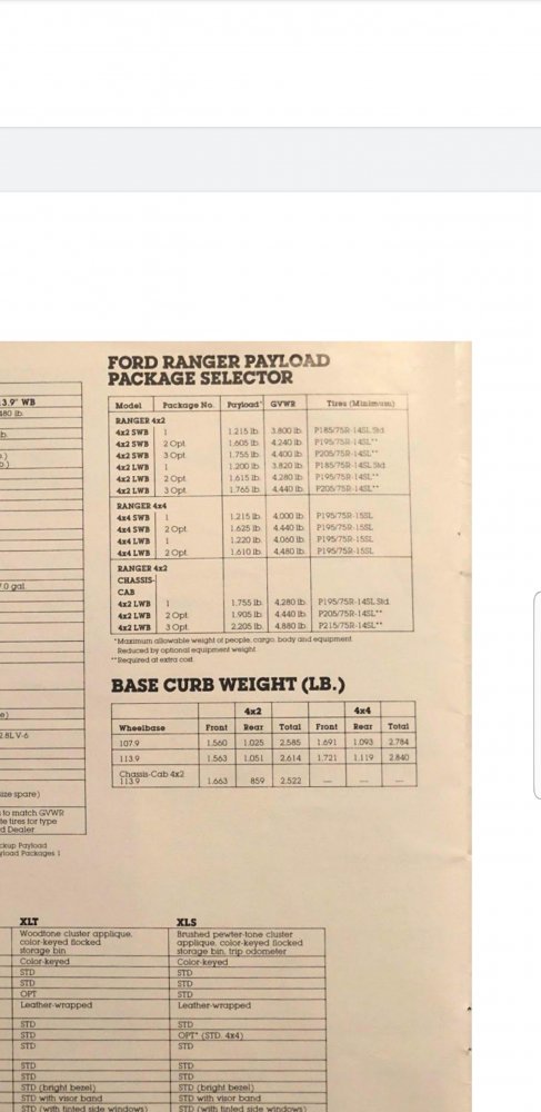

No one tell rusty that the maverick is more capable than his ranger by any metric, other than maybe trailer weight. And the numbers on those old rangers were never realistic anyway for safely hauling a load.
Are they making service bodies for these things? That's the market for these. I think you'll see a lot as fleet vehicles to go along with the Transit - OEMs are dropping out of that market like crazy and there are a lot of places that need trucks but don't need something the size of an f150.
Ranger blows it away for bed length, no way around that.
For payload the maverick suffers from the same issue many crew cabs, the axle is clear ahead of the bed. This makes cargo in the bed take weight off the front axle which effects steering and increases stress in the frame, one can find plenty of T6 Rangers (and hilux/70 series/whatever) down under with sprung frames because of this.
Namely it is mainly designed to carry its payload in the cab moreso than in the bed.
For the rear axle, despite being out of a pinto my money is on the one with ball bearings that run in oil and lasts forever over the pos pressed in sealed wheel bearings that last 100k at best.
I think i have replaced 6 of the blessed things jn our edge which hauls/tows nothing.
Cant do a service body when the bed is integral with the body either. Payload is low for one too (they are rarely seen on anything under 3/3 ton)
Not knocking the Maverick, i can see it has a market but for regularly doing truck things a old ranger does hold some merit over it yet depending on what you are doing.
