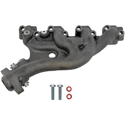

This is my last major problem getting my truck back together. No matter what position I put the manifold and cat flange together at, it leaks. There is no gasket that I know of that goes between the two. any one have any tips on sealing this? The guy at the parts store told me to try copper RTV, but im worried it won't hold up. Anyone know anything to help me out on this? everything I find references a flange gasket that my truck apparently does not have.
There is a gasket. Or at least there should be.
Exactly, I don't see why there wouldn't be one. But even a new manifold has the same lip on the end as my original one with no where to put the "doughnut" gasket like I've been told. This is a Dorman replacement with the same beveled lip as mine.

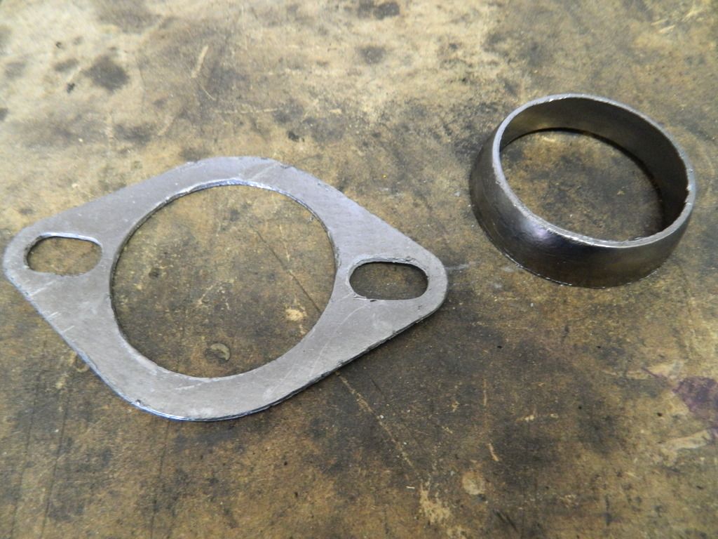

Now that Im home from work, heres some pics to help.
these are the gaskets my new cat came with
manifold/catalytic converter flange seal?
I know the one on the right goes between the intermediate pipe and cat, but have no idea how or where the second goes. Seeing as this is the type of joint thats leaking
And it goes together the same way as the old one did. any tips? Was kind of assuming the flat gasket was thrown in by mistake.
I refer to that as a ball and socket...I don't know if that is the correct term. AFAIK there is NO gasket. Clean both surfaces good and make sure there are no divots. You could try some rtv sealer as suggested, it would at least show where the leak is.
Good luck,
Richard
http://m.summitracing.com/parts/wlk-31360
Is the style i think your looking for but like the parts guy said copper rtv and make sure it lines up straight and hammer it down with the impact and go little by little on each side straight is key to keep them from leaking
If it continues to leak you could also use some muffler patch puddy around the ball and let it setup it should seal it fine.
My old '90 2.3L Mustang had that exact manifold on it and there was no gasket.
Maybe the "socket" on the pipe is too big for the "ball?" Either that or the ball end on the manifold is pitted and allowing it to leak around the outside.
As a desperate measure, I used copper RTV about 3 months ago now. I could not get it to seal in any direction with out it, and so far it has held up. If this fails, I will look at the manifold mating surface and see if its pitted really bad, and replace it.
