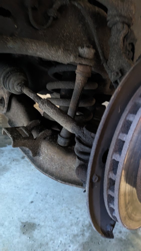

Tierod end look a like it's leaking grease. If it has a zerk fitting you should maybe add some. Check for play as well.
No fitting unfortunately, I checked play when I had it on a jack today and it's not bad, but there is some. I want to refresh the front end sooner rather than later.

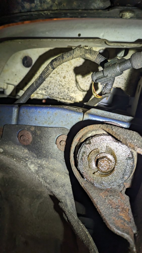

Here's some more evidence of cludgery, looks like the truck's frame originally came from a blue Ranger/B-Series:
MAB3L, the most reasonable truck on the road!
They actually put the body mount bolts the wrong way too. Probably didn't have a decent set of body bushings/hardware and just winged it with what they had.

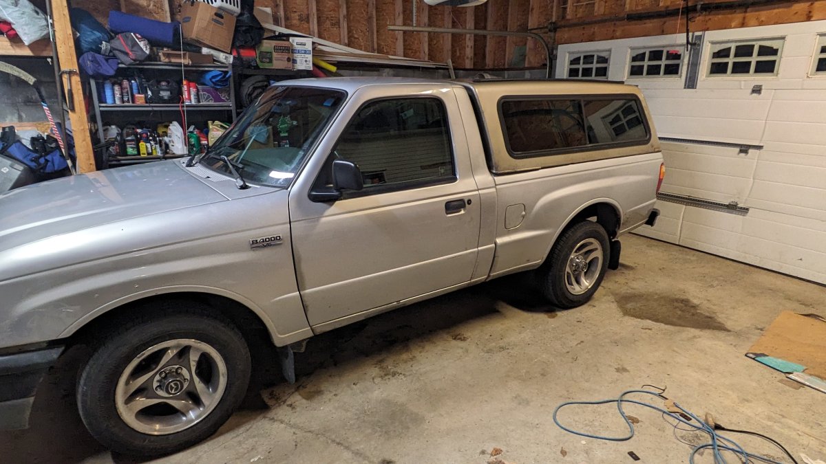

Howdy folks!
Here’s an update on MAB3L
Wheels, Tires, and weight reduction:
Summer tires and wheels are installed, and look sharp! Compared to my OEM steelies with winter tires we’ve saved a massive, immense, whopping, 3.5 lbs a tire… Saving 14 lbs of unsprung, rotating mass is good, but ultimately not quite the savings we were hoping for.
As for the tires, the 205/70R15 Firestone Destination LE3s are a great tire, comfortable, quiet, and surprisingly grippy despite their high treadwear rating! On a warmer day, the truck does actually struggle to break them loose even with 4.10 gears, in 1st gear at a stop. We haven’t driven them on the highway in the rain yet, but around town in the rain I’ve got absolutely no complaints.
We’ve pulled the trailer hitch, and the sidesteps. For the hitch, this was just a matter of 4 bolts, but it did drop the rear bumper which I didn’t quite realize was going to happen, unfortunately that popped out my license plate lights, breaking the bulb in one, and breaking the actual housing of the other. The tow bar itself seems to be a quality unit. I tried fixing the housing with some Gorilla glue, but I’ve been having trouble getting it fit securely in the bumper. I’ll deal with this later. The side steps were pretty easy if just annoying from the sheer amount of dirt that fell into my eyes, and the angle of some of the bolts was annoying to get to with the much needed impact driver. From removing the sidesteps and the hitch we’ve saved just approximately 50 lbs including the fasteners.

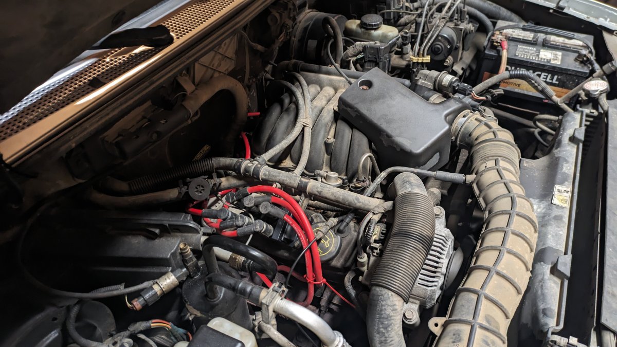

Ignition upgrades:
Now for the fun stuff, we installed some new NGK Iridium IX plugs gapped to 0.065 compared to the stock gap of 0.044, as well as some-semi custom 10.5MM spark plug wires. The resistance on the wires is significantly lower than the original motorcraft wires which were still in the vehicle, and nearly 7-8x times lower than the Standard Motor Product Pro Series wires we had as a backup. The plugs in the engine were a set of NGKs from who knows when, they weren’t bad, but otherwise a little gross.
In order to get the 10.5MM JDMSpeed wires to work, we had to salvage the boots and 90 degree tower connectors from both sets, since I didn’t have all the tools this actually took a while, and getting a secure crimp on all the wires was a bit of a struggle, but alas, it worked and I think they look pretty sick. I did have to create a bit of a zip tie cable holder since they’re too thick, but otherwise no issue getting them in.
The original Motorcraft Tower coil is able to push spark to the plugs no problem, whether that’s due in part to lower resistance wires, or like many others have said due to the fact that the coil Ford installed is overpowered for the application. I really do want to say there was an increase in acceleration, but it’s so slight it could be entirely placebo. It seems to have more power on the low end, which SHOULD in theory help with fuel economy when the truck runs at lower rpms. I drove it last night and for most of today with this setup, the truck seems happy.
Regardless, my MSD Street Fire 5229 Ignition coil came in today. It appears to be well made, but has no markings or branding, and came in basically an entirely plain box. I installed it just a few minutes ago and the truck starts up and drives well. I need more time behind the wheel to see if it does anything over the Motorcraft coil, which I’ll hold onto as a spare for now.
