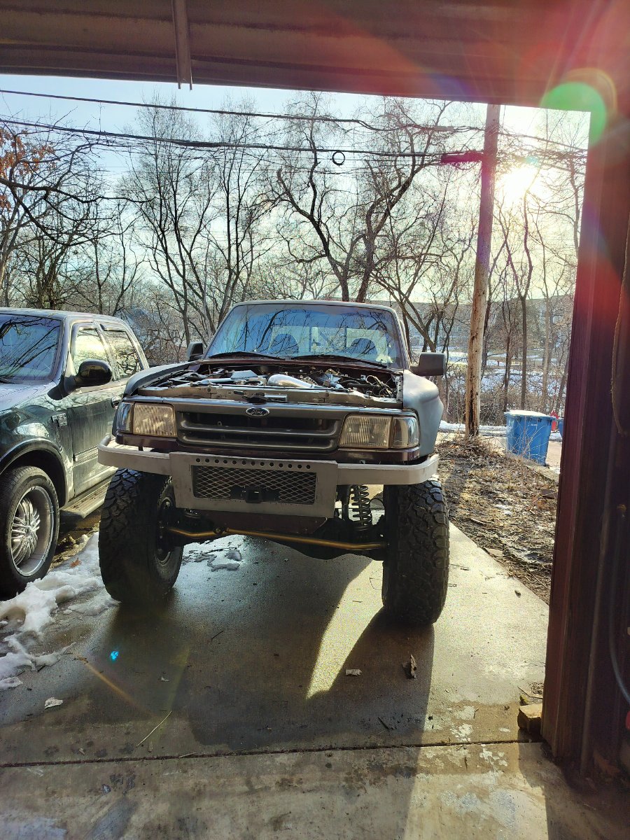

LS swap! finally

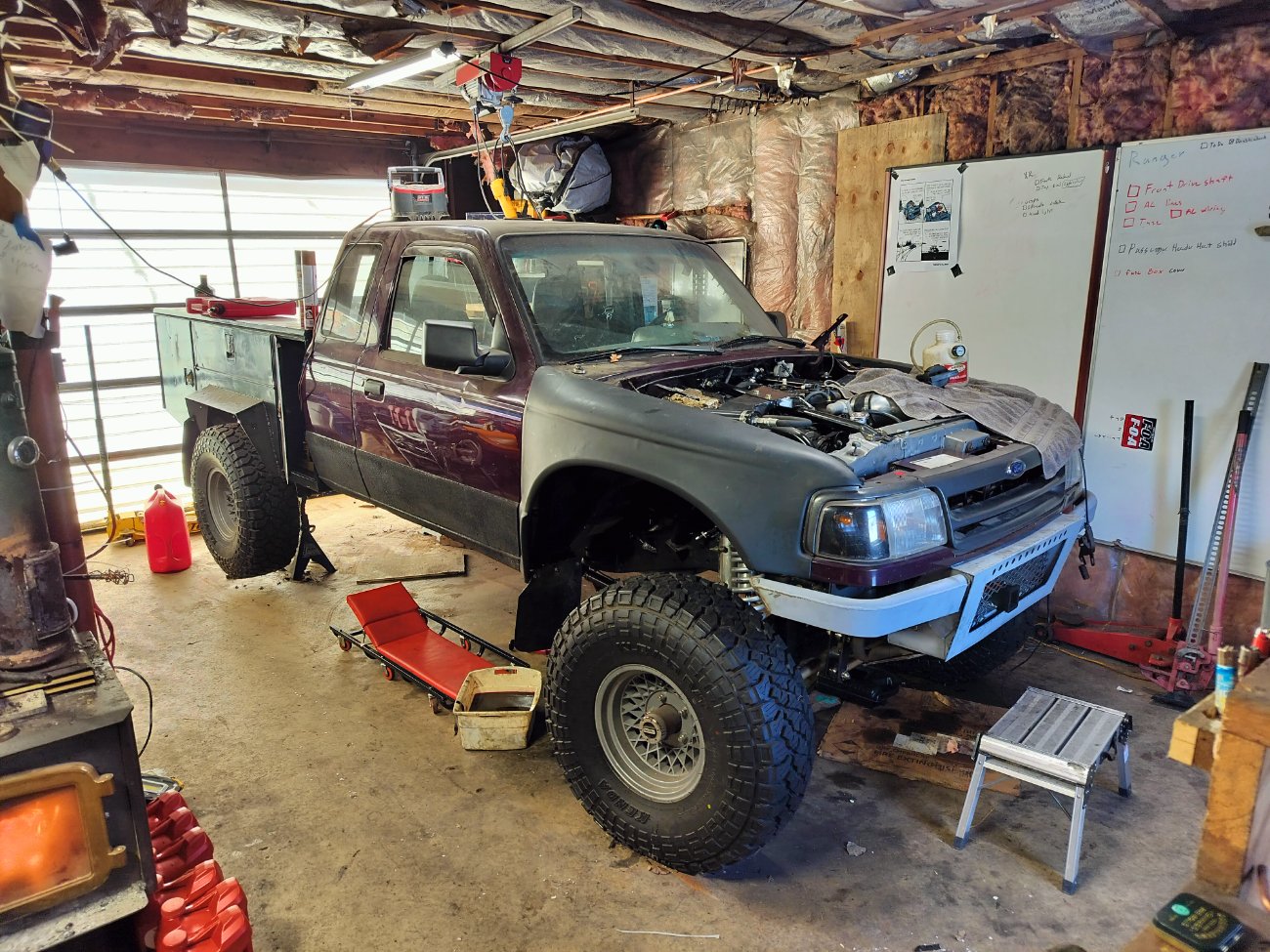

Jealous of you finding that service bed. I've been looking for one for ages now for my 2001 Ranger.
Just keep looking. Found this one in background of a photo on marketplace. Apparently was on an S10

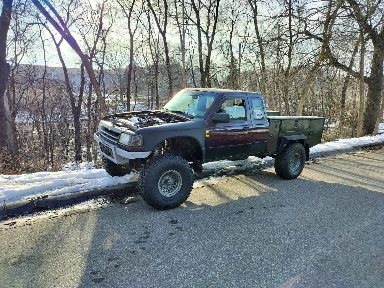

Running! With oil pressure and a working transmission. Waiting on a transfer case seal and its time to drive
You piece together that intake or is it all one? Debating how I want to do mine since I need to put the MAT sensor in it.
3" or 4" aluminum (I can't remember)and a matching rubber coupling with a built in maf sensor location.
Drained 16 gallons of 2.5 year old gas. Stuff was nasty. Hopefully it runs better after fresh
short cycle some cleaner with a seperate container to clean the system and injectors
How much did the engine end up weighing I looked around and I saw that a 6.0 like yours weighs about the same as a new Godzilla somewhere around 540 dressed.
I'm not sure how much the motor is but I think its less than stock. Entire truck weights 4600lb 55/45 split
oh okay, well it looked like it fit pretty good even with the huge 6l80.
an LQ4 will be about that much, the block is something like 225 alone. the aluminum block 6.0s are much lighter
how do you control the transmission? is it a stock setup? or like holley?
Runs and drives. So happy to see the driver side again

running better with fresh gas?
