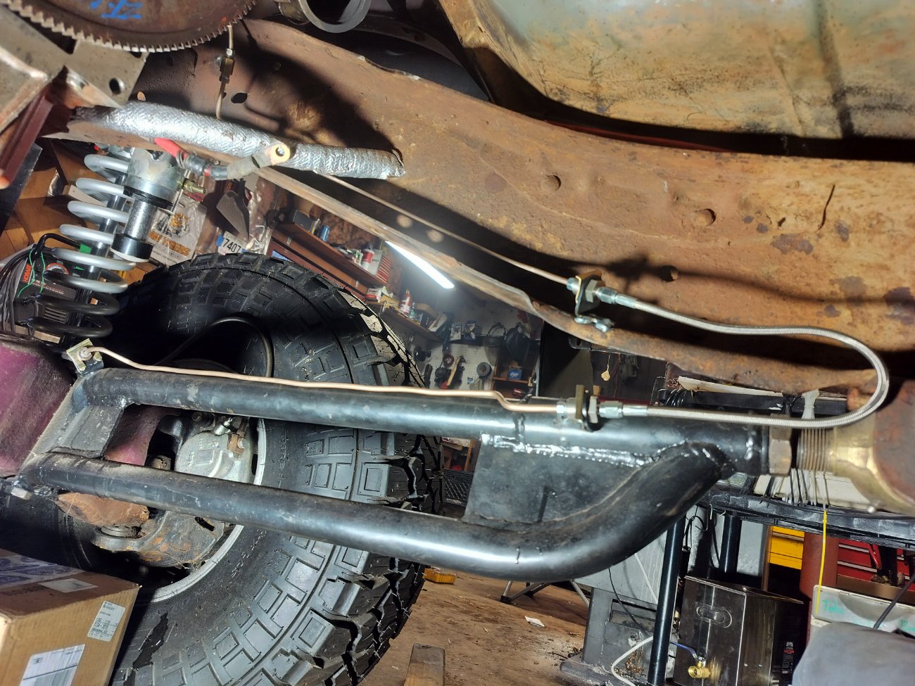

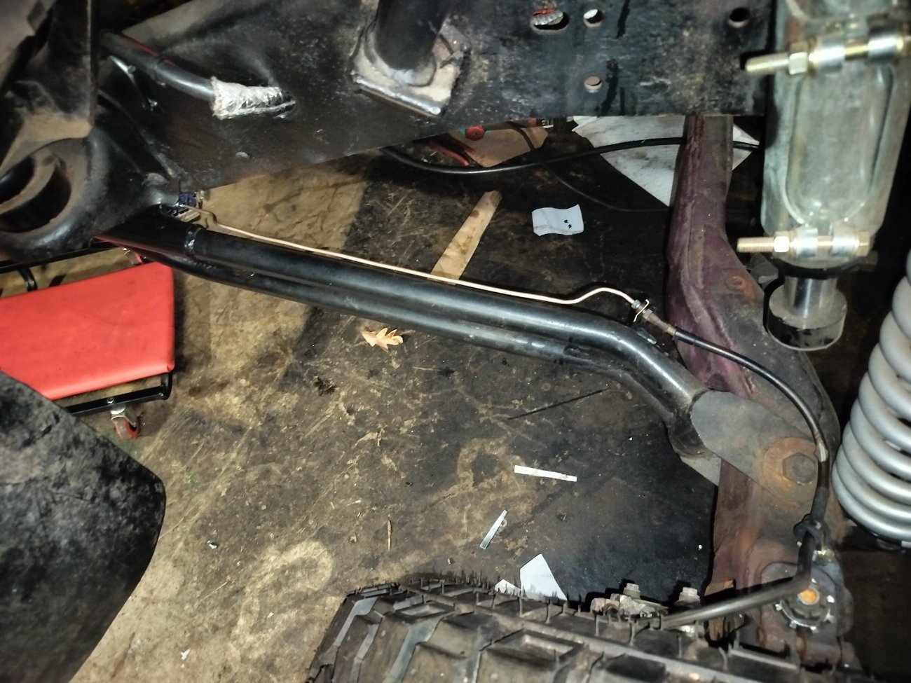

You did a swap on the master cylinder to a Dodge unit?
What other brake upgrades have you done?
Rear brakes are a disc brake conversion kit for a 31 spline 8.8. My axle wasn't complete when i got it. Front are dana 44 TTB stuff. Master cylinder is an explorer if I remember correctly. I had a dodge cylinder. I realized it was oversized after years of battling soft pedal.
Ah, okay. Makes sense.
I know there aren’t many options for Ranger brake upgrades, so I was curious

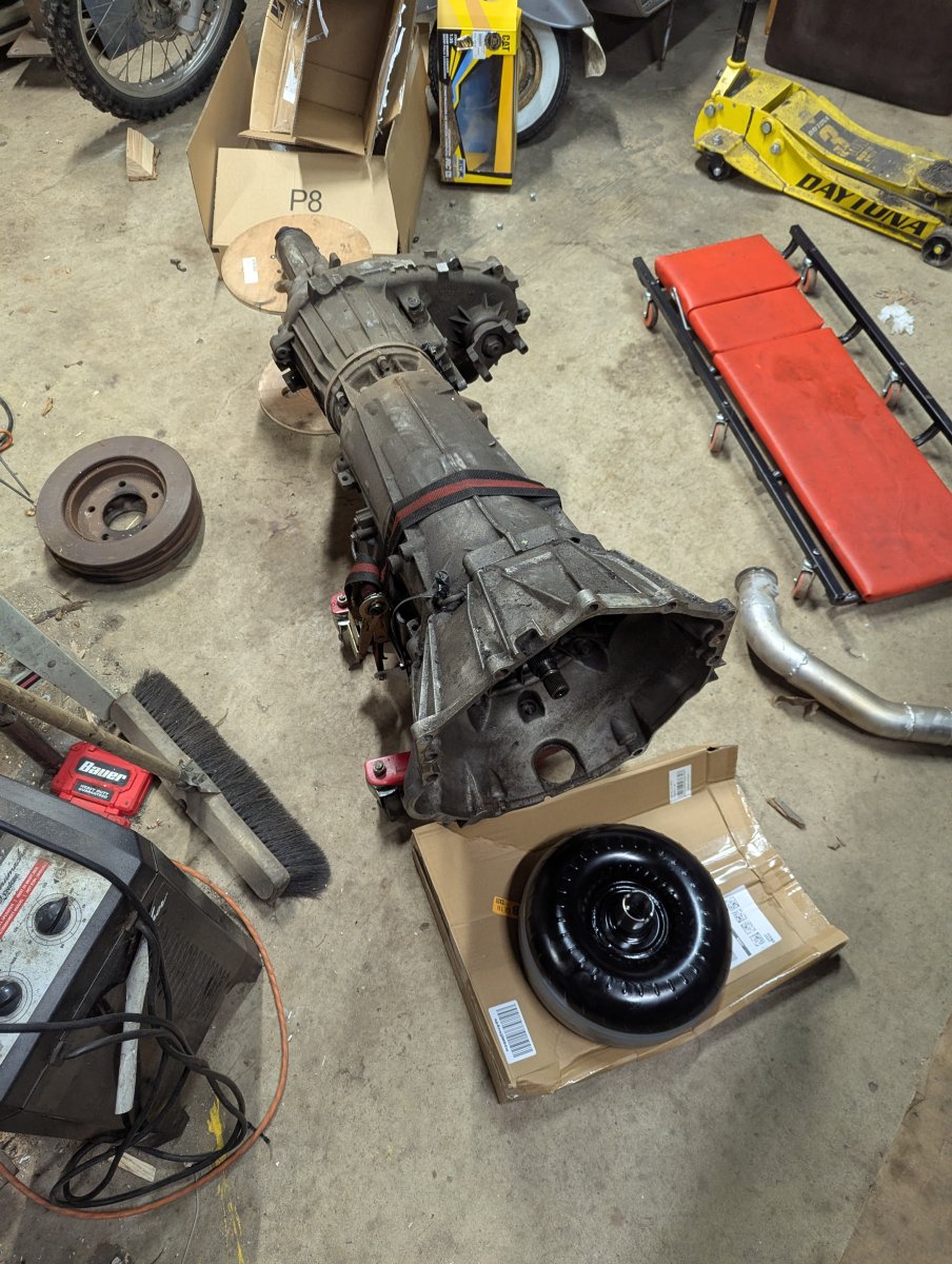

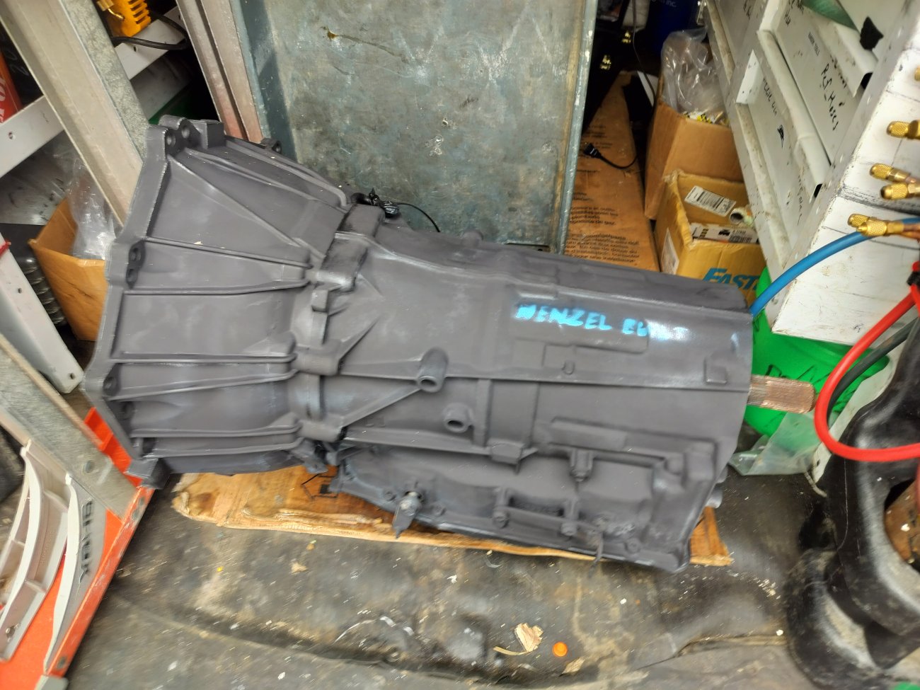

Transmission is out though. Pump is definitely broken. Converter seems okay still but going to email Circle D and see what they say.
LS swap! finally
Slow n stead huh. Definitely been on the slow part. Got a better job, found some motivation. Be back soon with a transmission

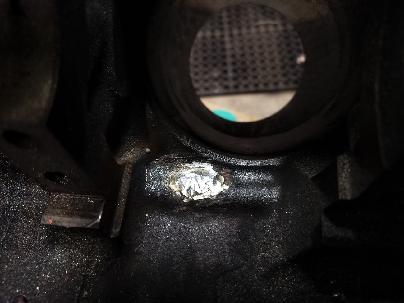

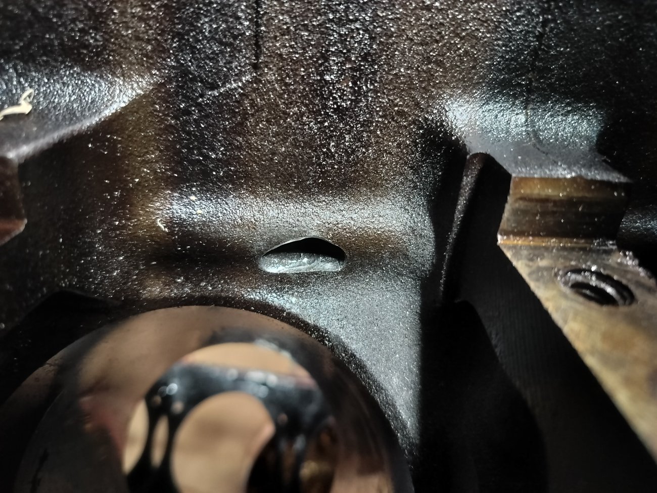

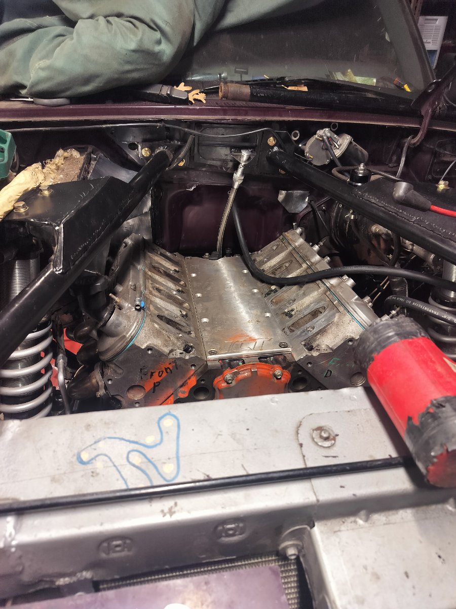

Ooofda. That's a hole in the oil passage. Found my low oil pressure issue

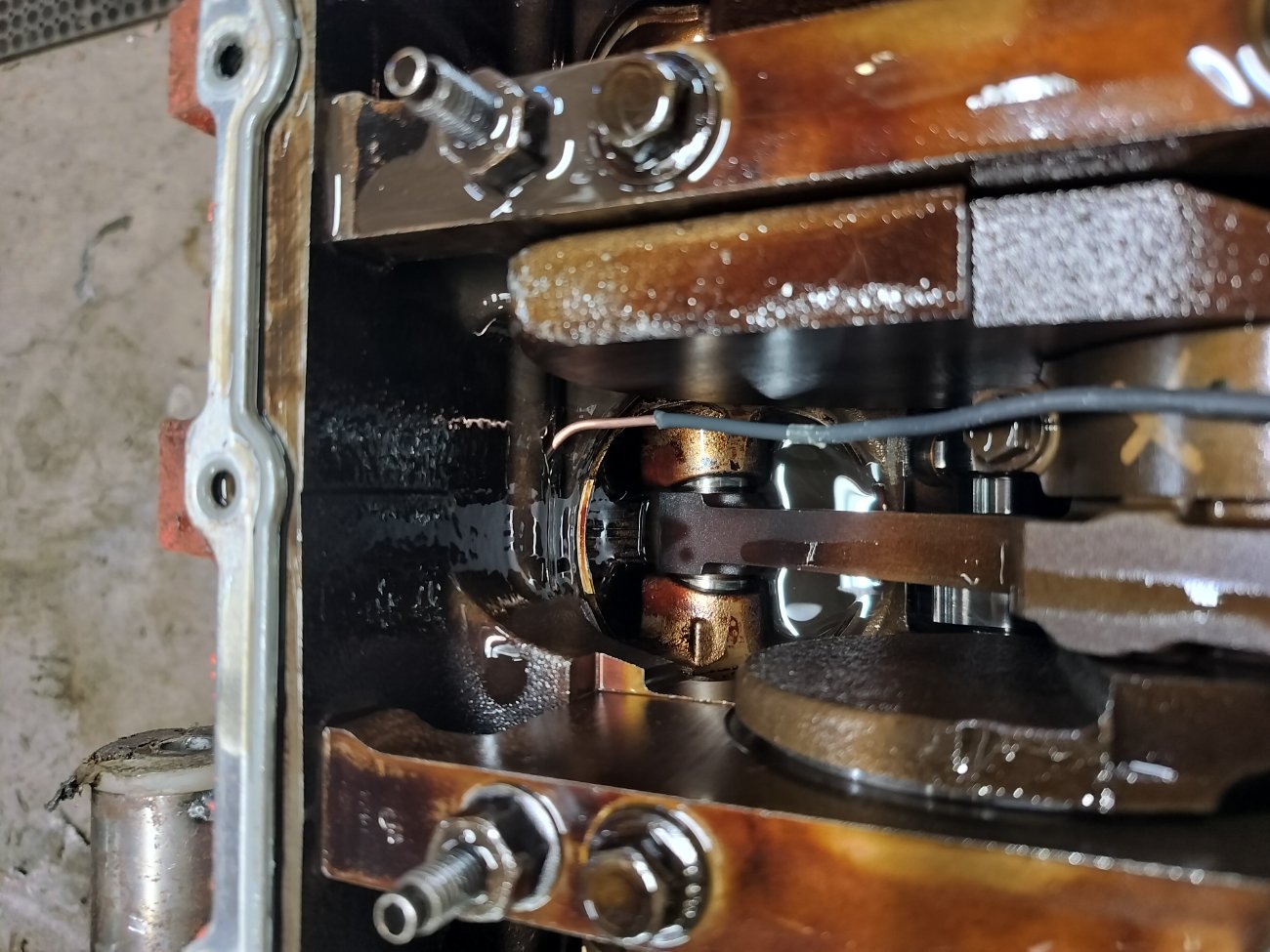

Silve brazed the hole in my block shut with a metal patch. Picked up a new crank from Crankshaft supply here in Minneapolis. The crank in there was scored. Cleaning up the engine bay for final prep and install. Same with the motor, same parts but fresh bearings. Also picked up a 98' vfr800. Should be a fun summer

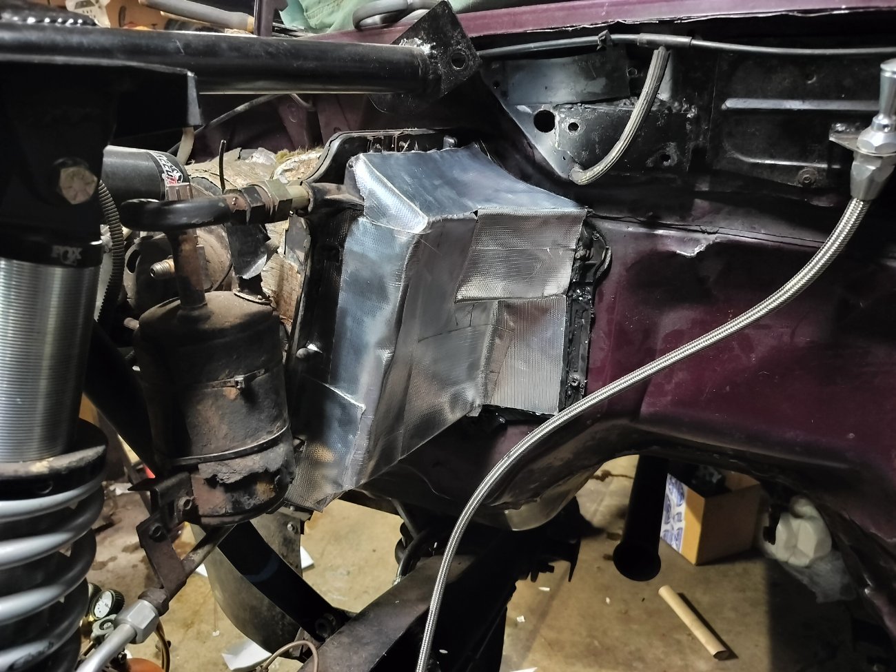

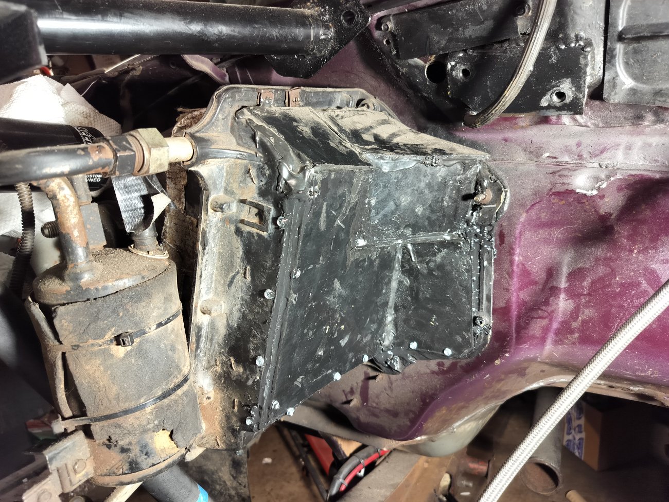

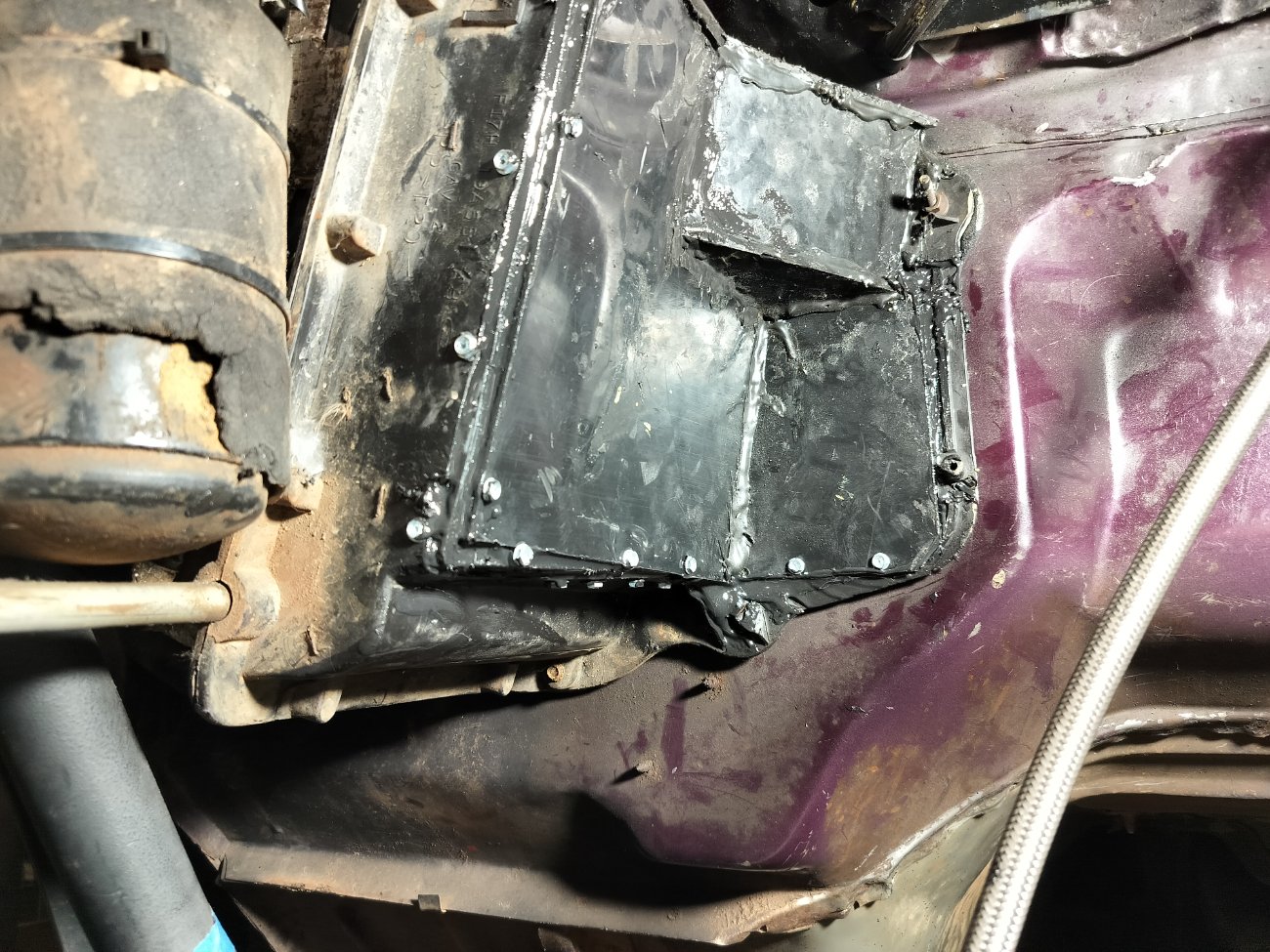

Redid the AC box. More structure to it now and no more air leaks. Need to build a heat shield at minimum for the passenger side. The box got a bit droopy even after 45 minutes of run time

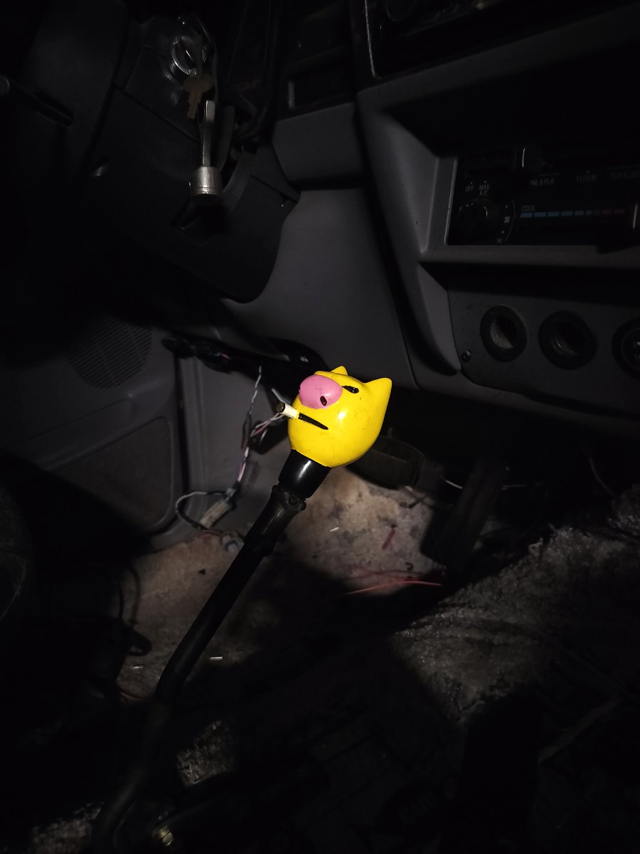

Lots of progress on everything. Transmission is off at the builder now. Also 4x4 shifter turned out sweet.
Dang, ive never seen that failure on an LS before! Glad you got it sorted. Ive done two LS swaps; one in a TJ wrangler and another in a BMW E34 wagon. Really cool to see someone swap a ranger. I certainly considered it for my truck, but am going the 5.0 route to change it up.
