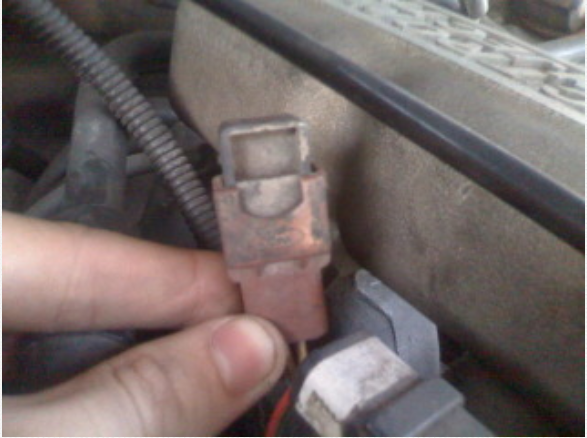

To set Base spark timing you will need a timing light hooked up to #1 wire
Clean off degree plate near main pulley and make sure TDC line on pulley is clean enough to see
To set base timing at 10deg BTDC you need to prevent the computer from running the timing.
So you disconnect the SPOUT(spark out) control, there is a simple connector to do this
Picture of SPOUT connector below
You pull out the insert and that disconnects the computer control.
Loosen distributor bolt just enough to move it.
Start engine
Set timing at 10deg Before TDC(BTDC), some say 12 deg BTDC is better, up to you.
Tighten distributor
Reconnect SPOUT
