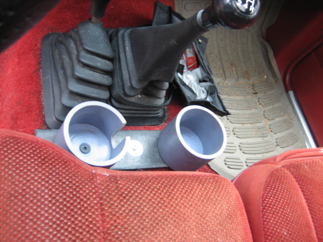

Not sure if this is the same, because is a bench seat, but lack of cup holders is one of my pet peeves in a vehicle so I fabbed this up for my 84. Screwed into the center tranny hump, clear of the shifter with 32 oz drinks and holds my coffee cup with its handle. Set forward enough for seat adjustment etc. FWIW
