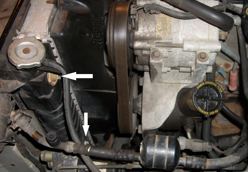

The "good" radiator is the thick one used in the early Explorer automatics. When checking yours, look for unused auto trans cooling line ports as seen here:
43504
On my manual '94 Explorer (pictured), and my manual (former auto) '90 Bronco II, I have both retro-fitted with this radiator. It's a good upgrade.

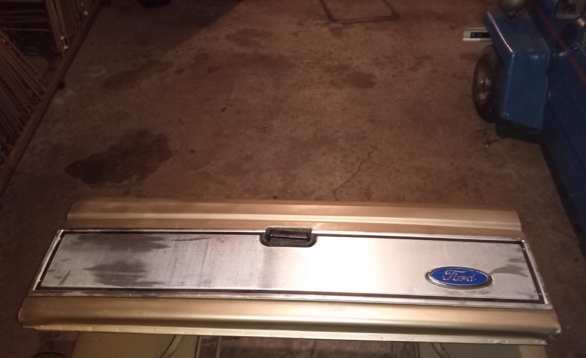

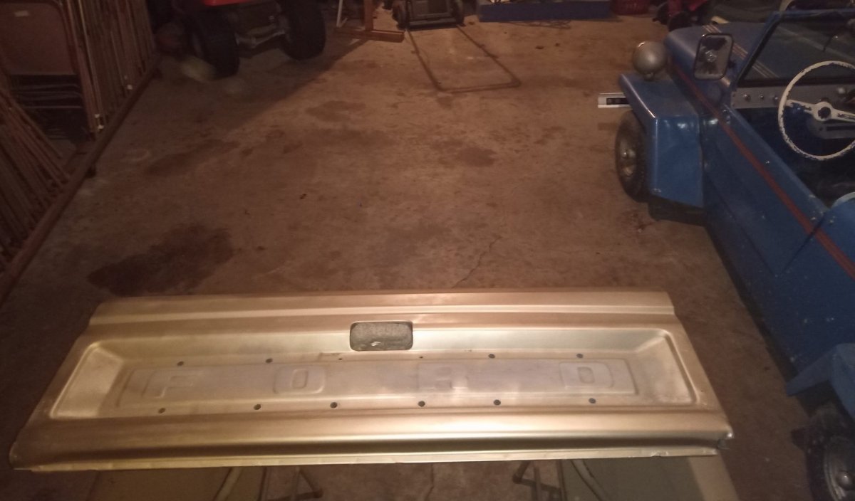

Monday was a busy day. I got the tailgate I needed, and sliding glass for my rear window. I have no idea how to get those glass pieces into the frame. Any advice on this will be greatly appreciated...
The right 1989 tailgate has been taken apart, (brushed chrome insert removed,) sanded, and primed for the Duplicolor paint, which I hope to apply "tomorrow," (actually, later today.) My phone data port decided to malfunction, so uploading the pictures of progress on this Job will have to wait until after I finally get some sleep.

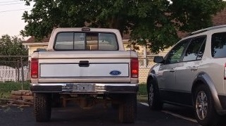

Just to give everyone an idea of the cosmetic stuff I'm working on these last few days. This is just sanded and covered with primer.
I'm not any kind of painter, but I'm being careful as possible.
When this picture was taken, I hadn't applied all the coats of paint or enamel clear gloss top coat yet, but I couldn't wait to get an idea of how things were going to look when I finally get it all put back together.
Anybody know a good way to polish up this Chrome insert?

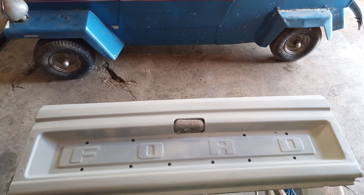

Finally got the salvage yard tailgate painted and reassembled. It looks so much better than the aftermarket one it had when I bought it. I wanted to post before and after photos, and maybe I will later, but I'm proud of how this ultimately turned out. Notice the narrow steel bar bumper in this picture...

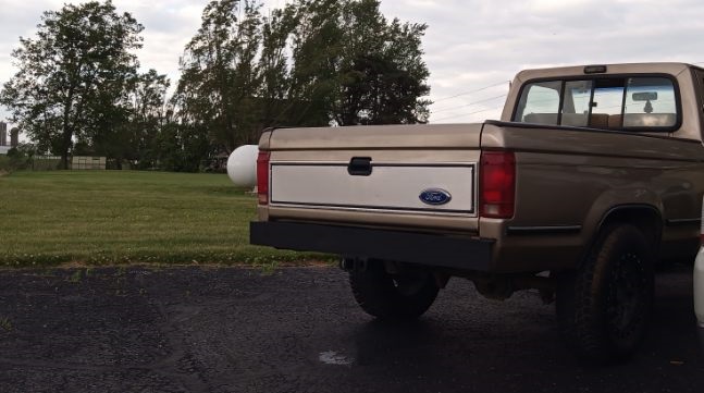

Here's the new bumper I'm installing to bring this Ranger closer to the original look. It's not perfectly straight yet, nor is it permanently attached. This is just a mock-up to get everything lined up correctly. I still haven't figured out how to get the sliding glass rear window pieces I purchased into the track. Maybe someone on here has some experience with that repair?

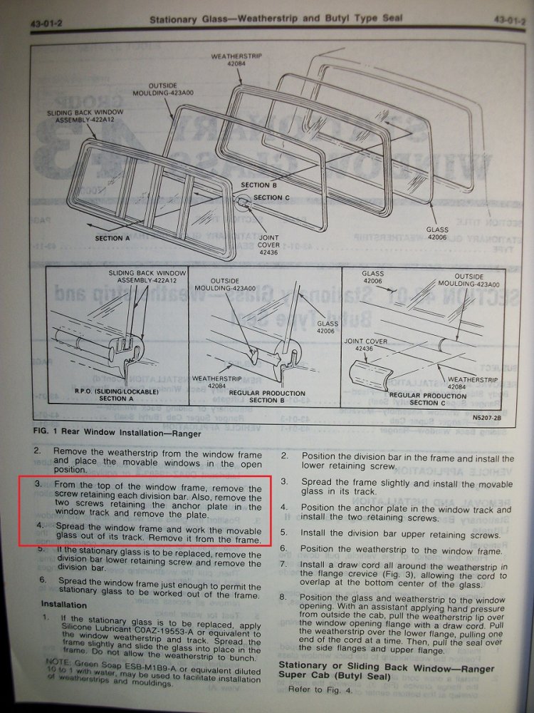

On the rear slider.
I don't recall if I ever replaced individual glass panes (my CRS is really getting bad). The whole slider unit is normally installed, and I did a lot of them "back in the day", mainly aftermarket sliders.
I looked at some Ford shop manuals, and there ARE instructions for replacing individual panels for the OEM unit (included below, see the box).
You'll have to remove and reinstall the window unit; no big deal, and much easier with two people. The rear slider is held in with a rubber gasket. "If it were me" pulling a 31-year old truck rear window, I think I would pre-treat the rubber with a good rubber treatment (like ArmorAll, but I'm not up what's the best these days- suggestions perhaps from peanut gallery?).
I used to start pushing the gasket out in a upper corner. There's a tool called a Cotter Pin Remover (we called it a "nose picker") that works good for GENTLY hooking and pulling, and working the gasket.
Reinstallation, it's easiest to set the bottom in place, work the corners in, push down while you pull the cords, and then it zips right in. I used to use dish washing liquid (like Dawn) to lubricate the rubber; that helps a lot (for removal and reinstallation). Just take your time and go slow. If your gasket is questionable, or if you tear it, I would think that new gaskets should be readily available somewhere.
This is an '88 shop manual. The '89 was word-for-word identicle, but the '88 book was laid out better (on less pages).

On the rear slider.

Thank you for such a detailed reply about the sliding glass. After nearly destroying the window frame on the donor vehicle attempting to retrieve the replacement glass at the salvage yard, I was hoping against hope that there was some 'trick' to it that I had missed...
Apparently it does require removing and reinstalling the entire window.
