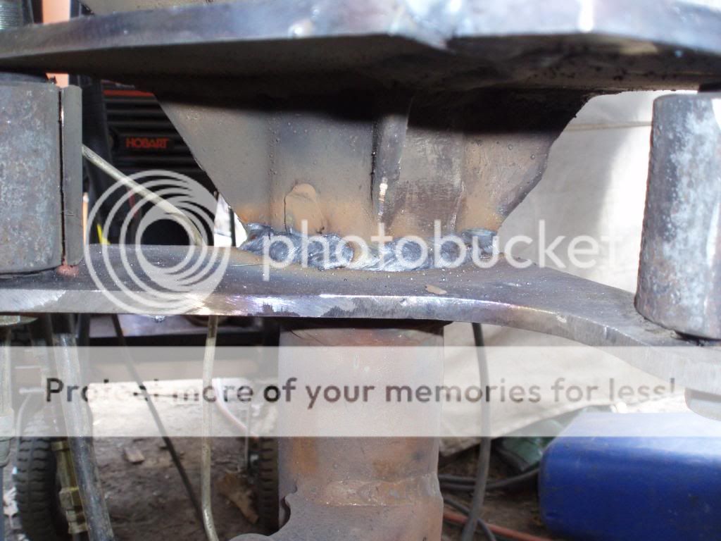

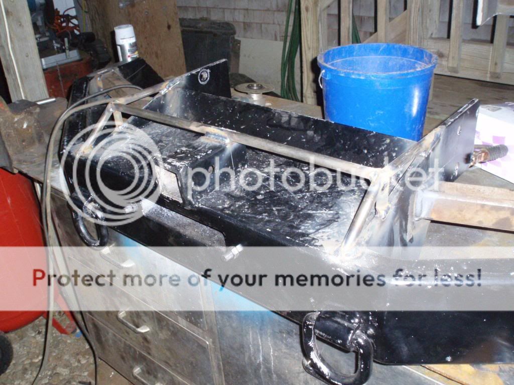

Lookin good Tim. I like the traction bar bracket. Nice work.

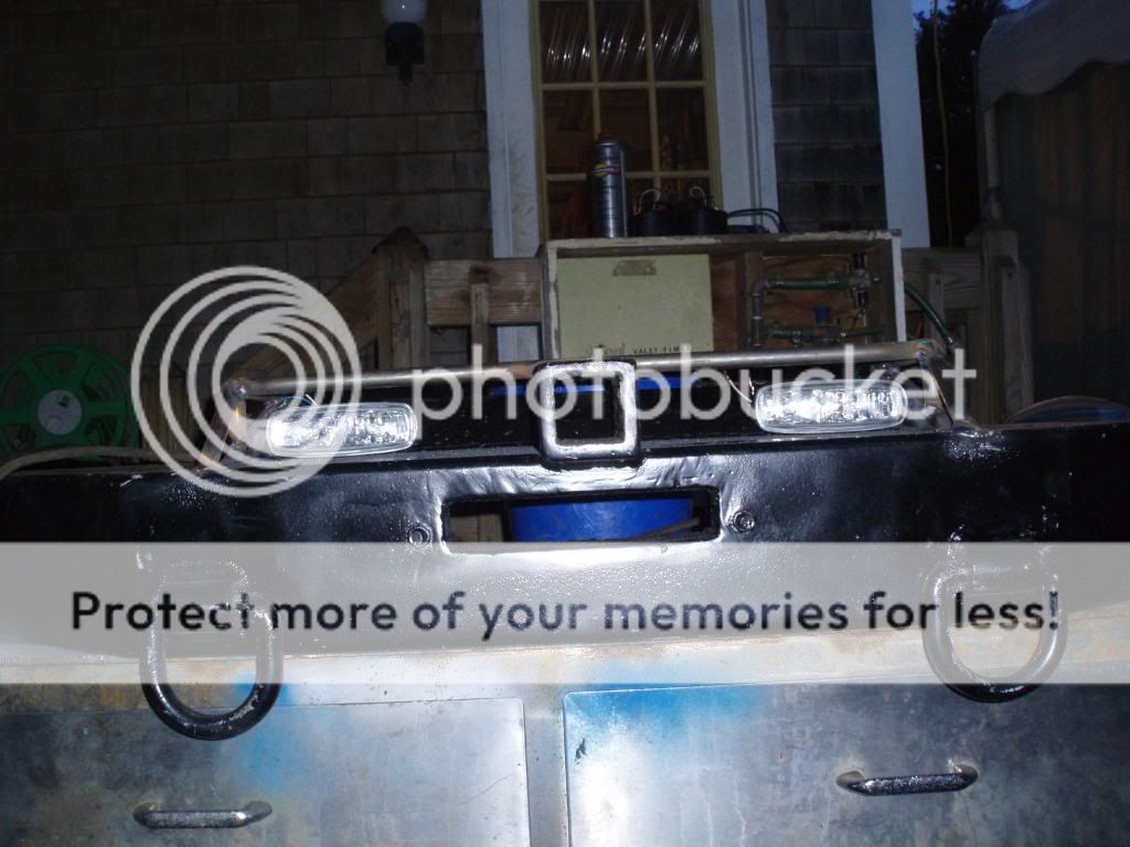

The 55w bulbs will be getting replaced with 130W bulbs. The housings are aluminum, the reflectors are chrome plated die cast, and the lenses are glass so it will be able to take the heat.
I've tried big bulbs in little housings in the past with no success at all. After having multiple 100W bulbs turn all black & blue after even just an hour's use (even expensive high-quality ones), I finally realized the halogen bulbs themselves were overheating and cracking from being confined within such a small housing (there's just no airflow inside there). I had to go back to the 55W ones and no more problems. I ended up getting bigger lights and then 100W bulbs worked fine.

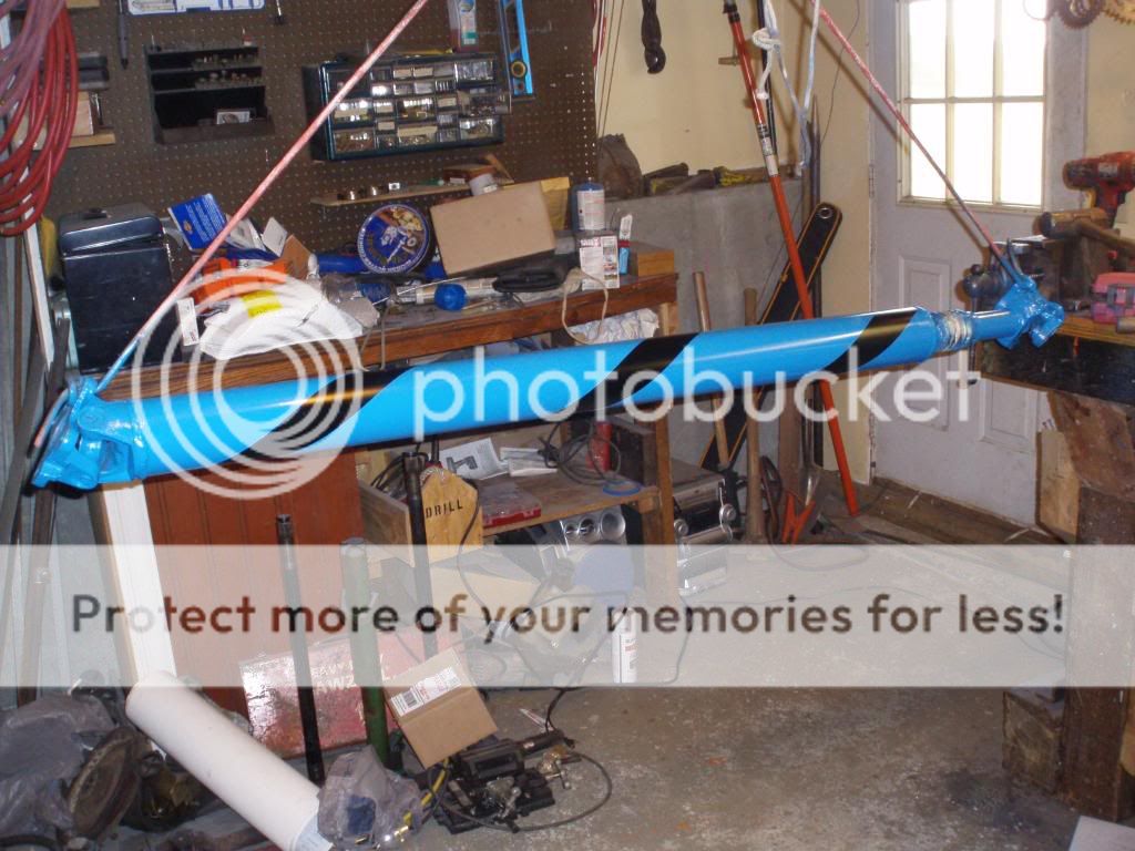

I'm curious to see how the wheelbearing grease fitting works out for you. The driveshaft painted like that I'm not so sure about though :icon_twisted:

after my last two stucks, its pretty much BARE METAL now.. (driveshaft sitting in the dirt)

Thanks Junkie. Since I already bought the 130w bulbs I will give them a try, I will keep the 55s as spares. We will see what happens.
