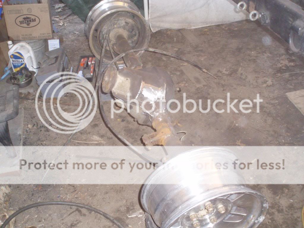

I need a diff cover Tim.....The one that came on my 8.8 is about rusted through. What can you do me for? PM me.

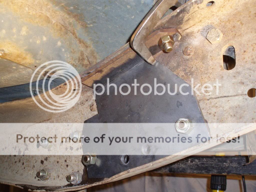

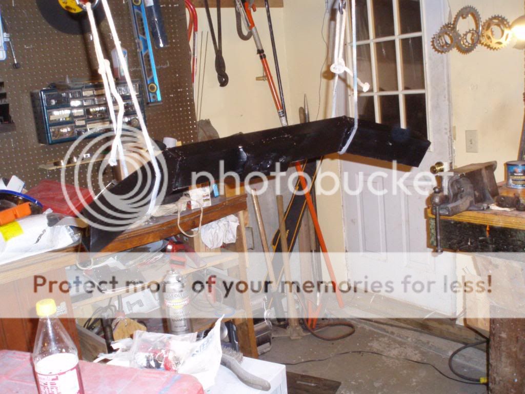

Coming soon: a completely new fabricated crossmember.

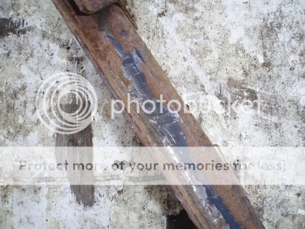

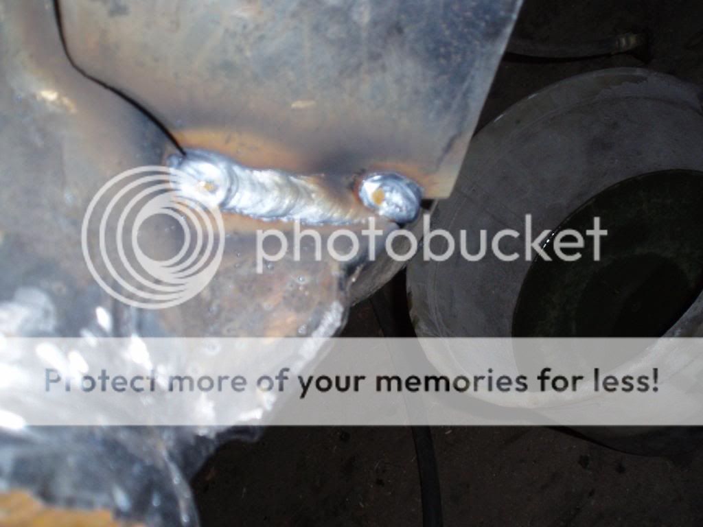

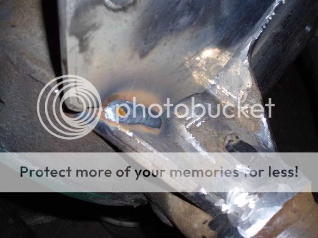

An example of very good penetration.
Yes its supposed to be like that.

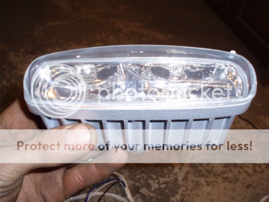

The 55w bulbs will be getting replaced with 130W bulbs. The housings are aluminum, the reflectors are chrome plated die cast, and the lenses are glass so it will be able to take the heat.

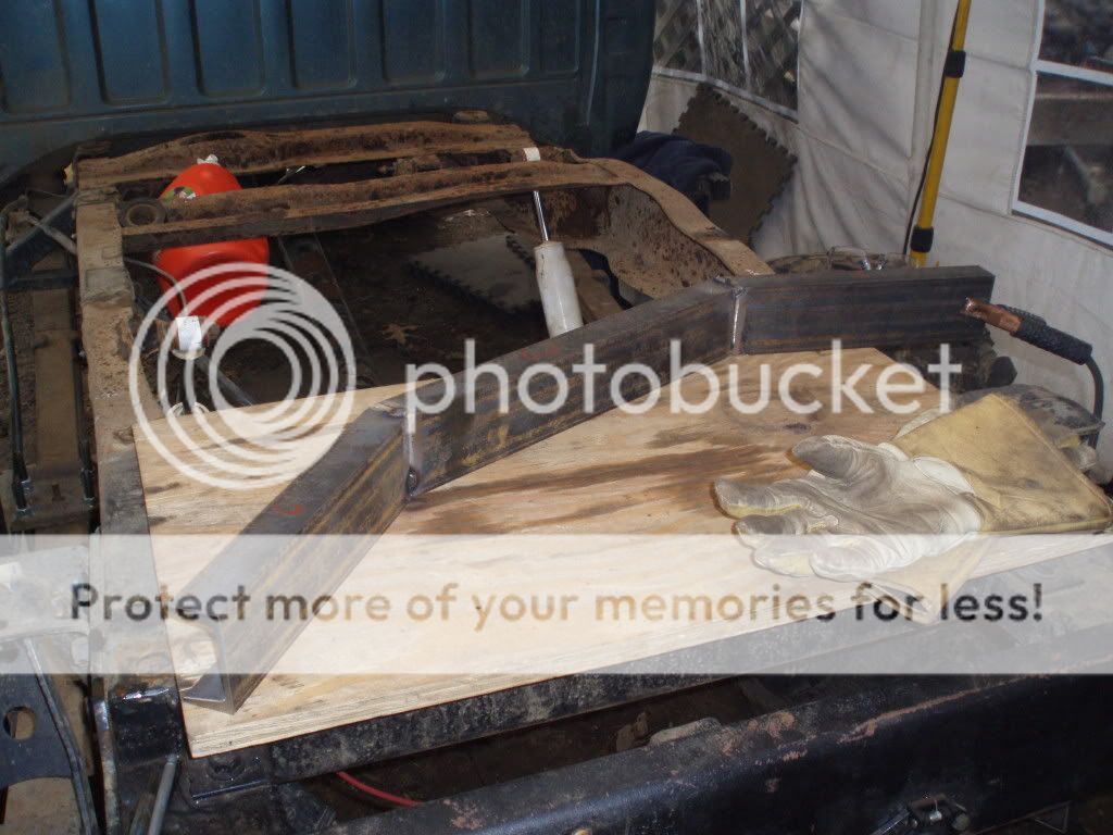

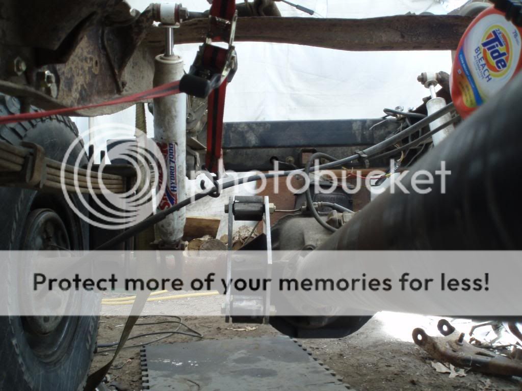

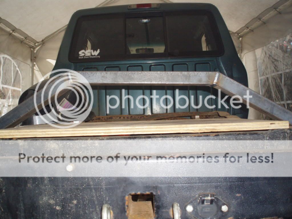

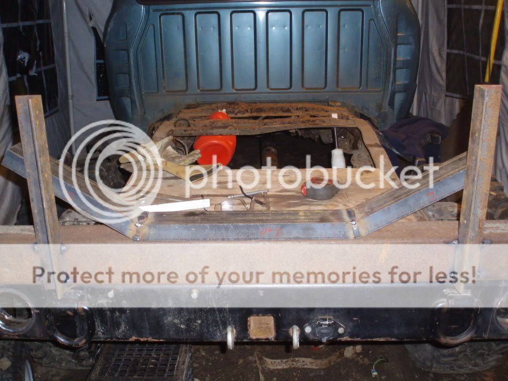

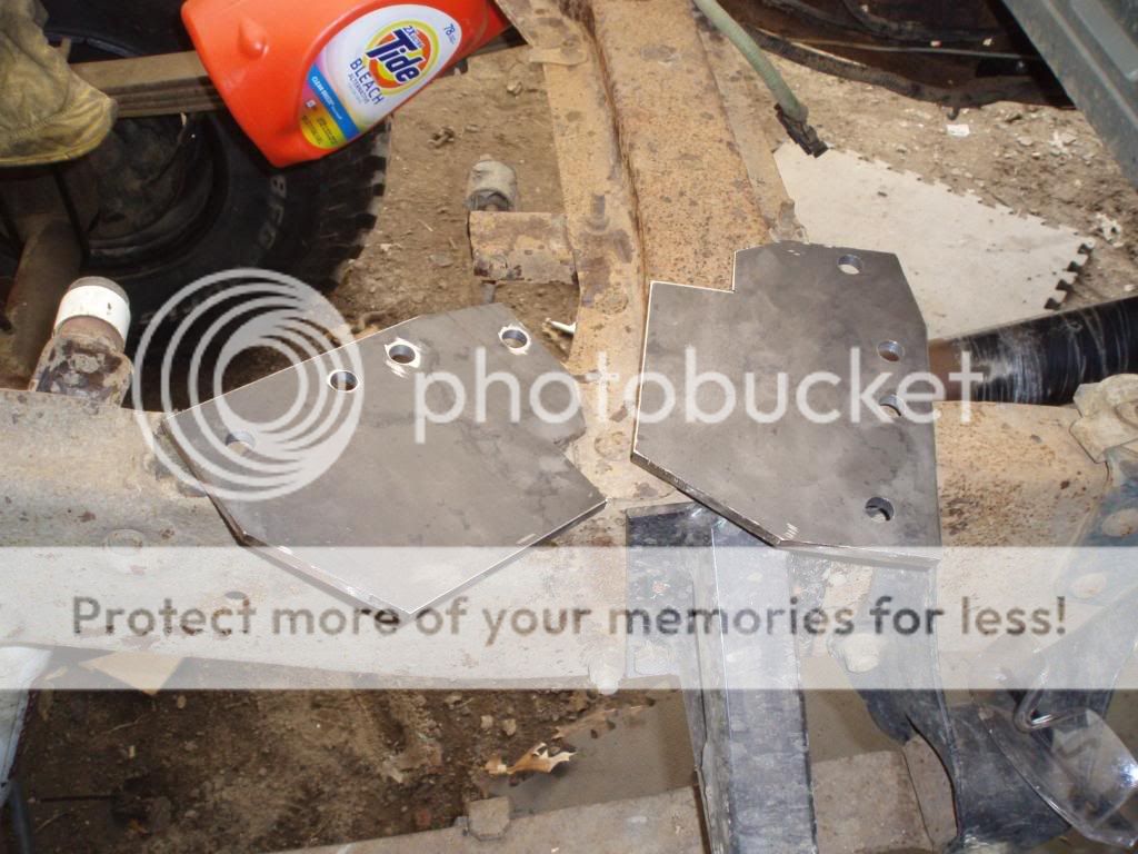

A jig to help set the crossmember up.

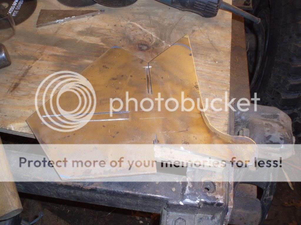

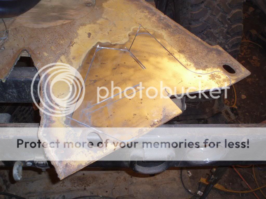

fabing the side plates for the crossmember...

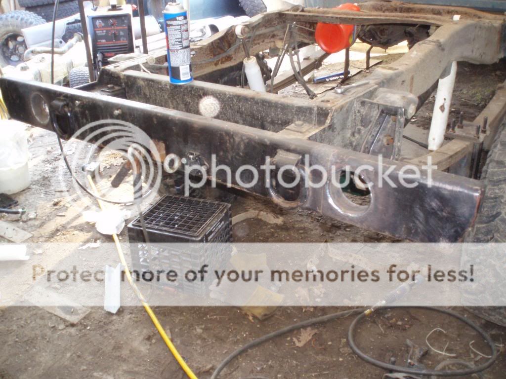

It was really windy out and I tried to fire up the stove..... bad idea.:dunno:

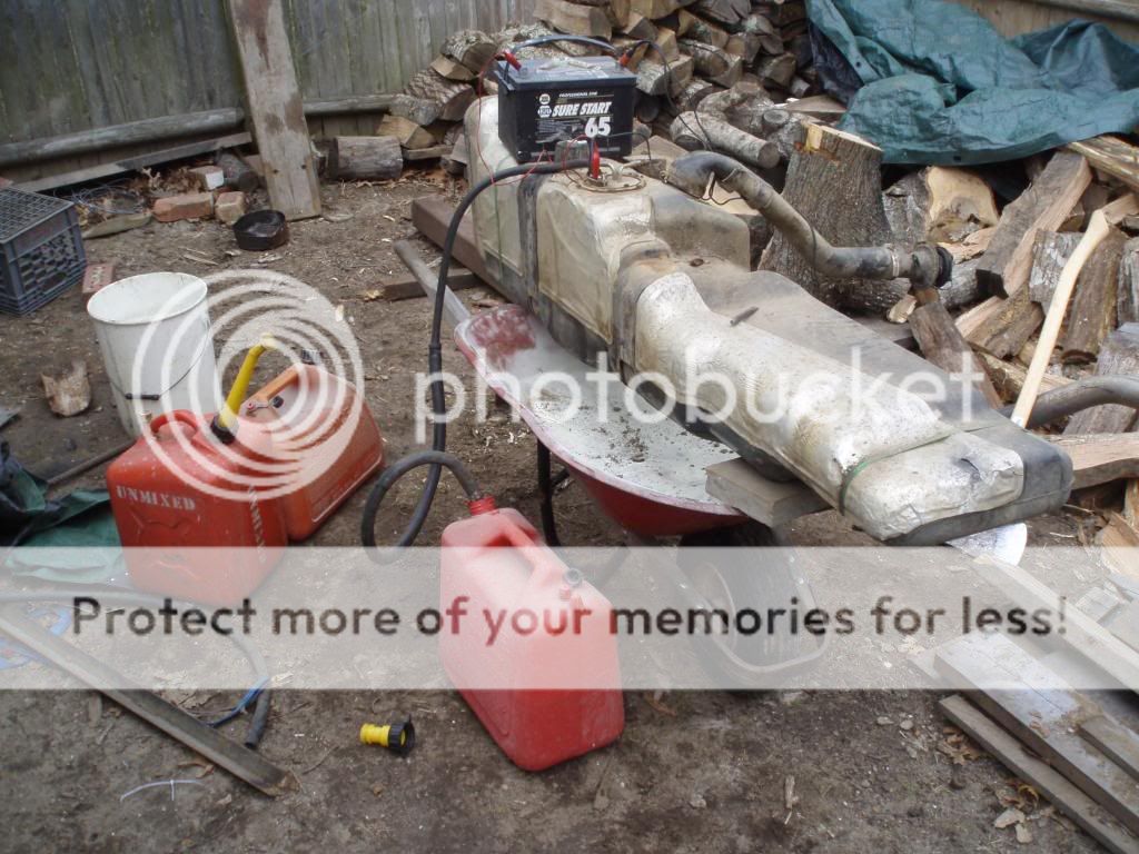

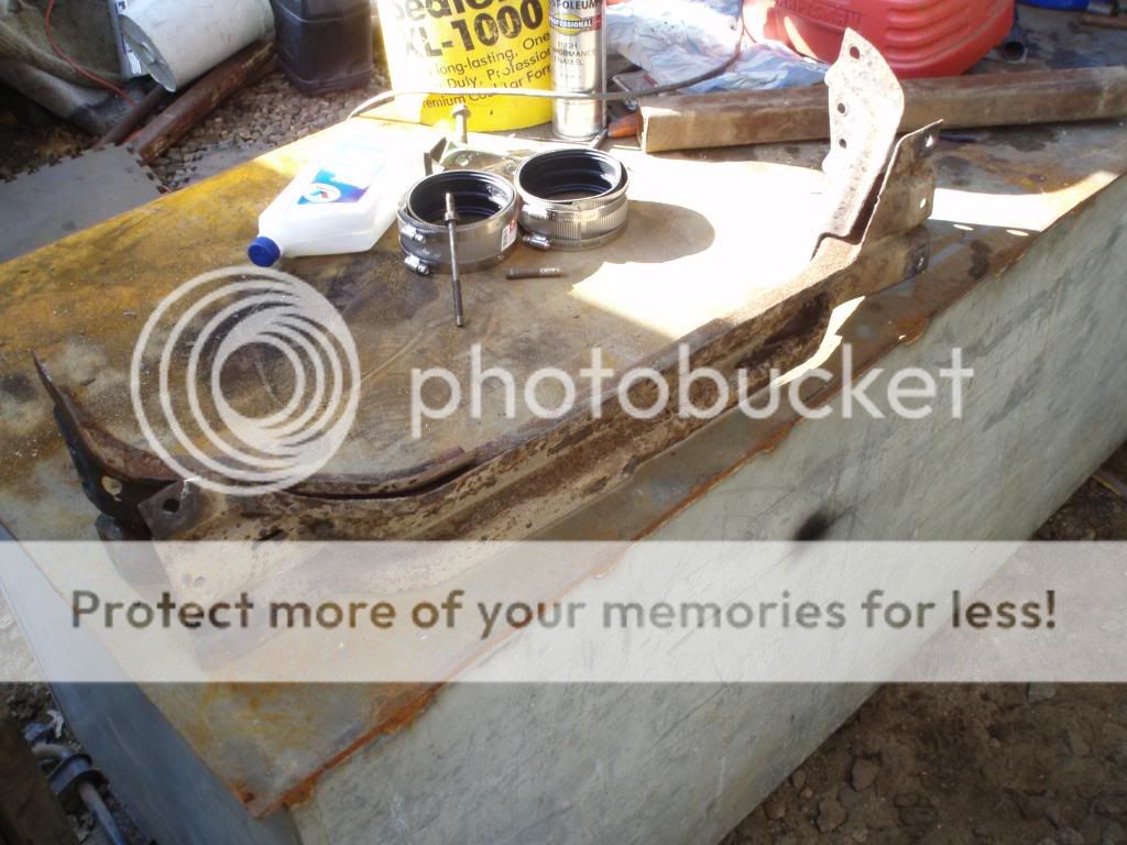

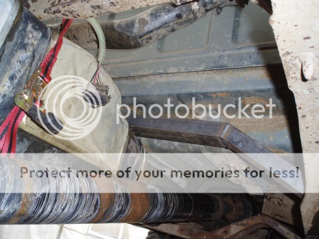

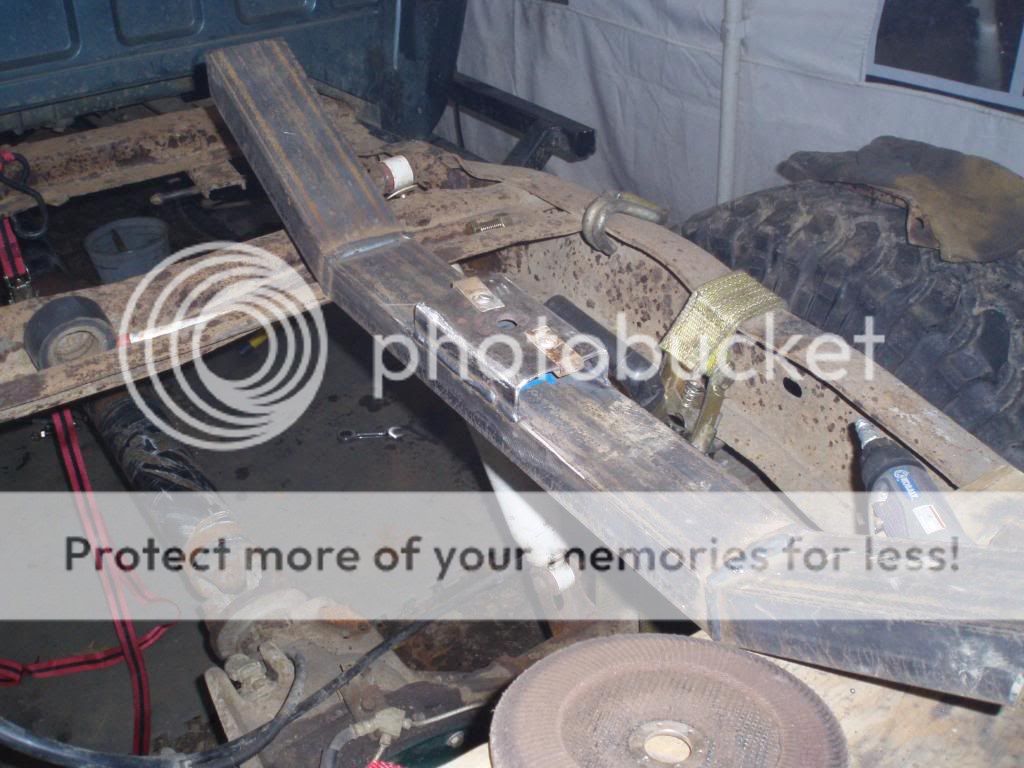

Called it quits for the night and the next morning I started by draining my tank off in to gas cans so I can more easily move it around when fitting the crossmember.

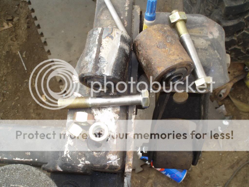

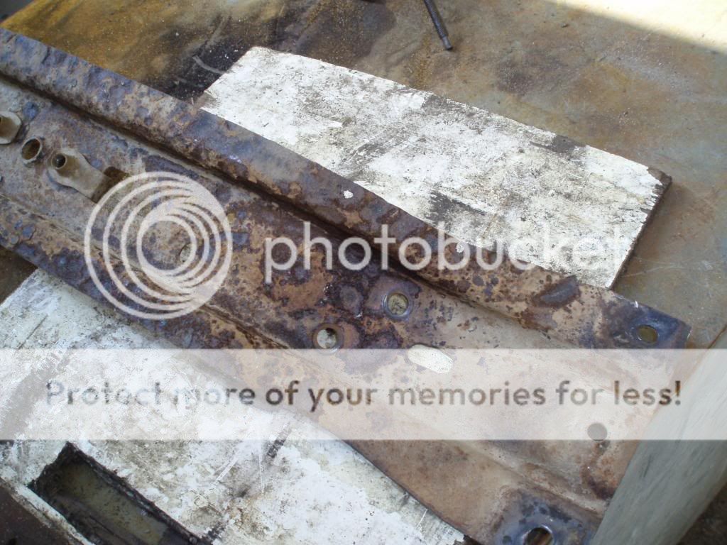

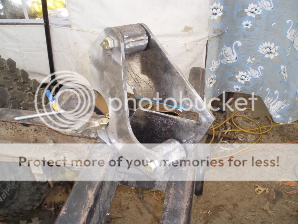

Then I cut the ends of the leaf springs off that I will be using for my traction bar bushings. They are stock toyota leaf springs..... both packs had a couple broken leafs. Got them for free from a friend who is lifting his yota.

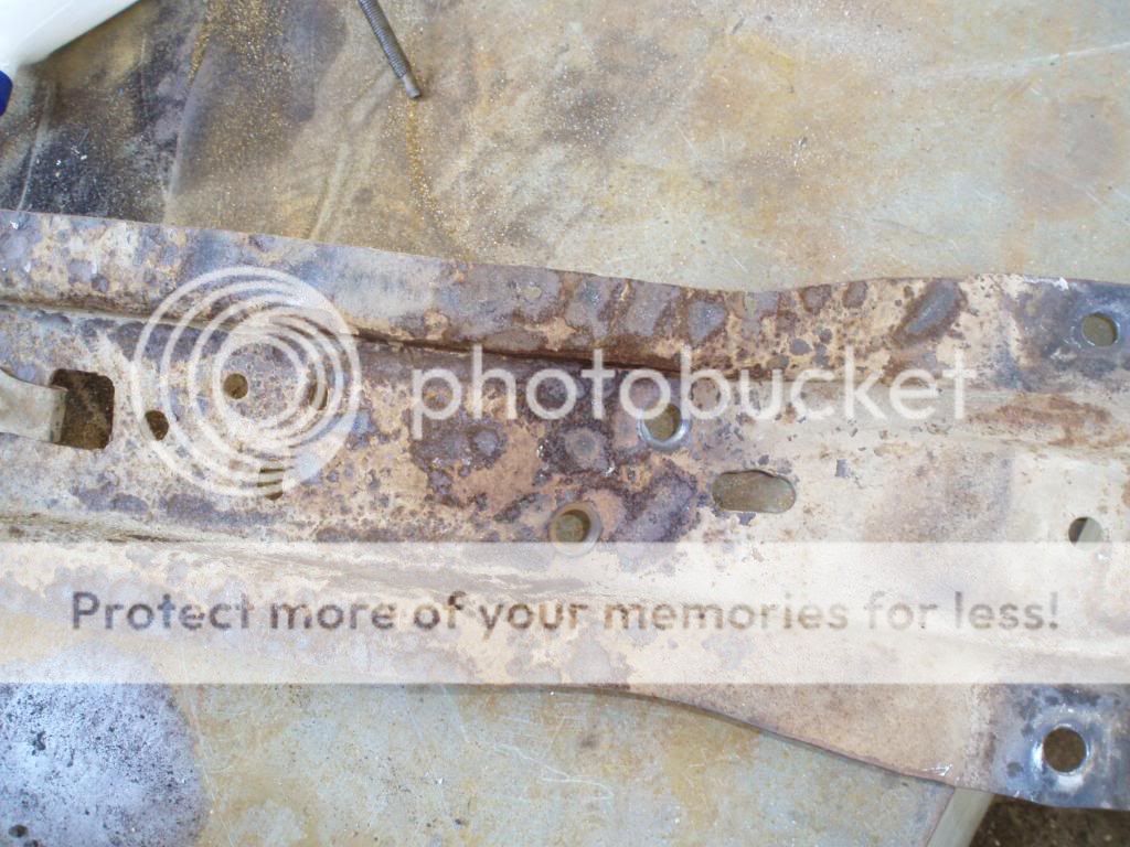

Then I adjusted the gas tank skid plate mounts for the new crossmember.

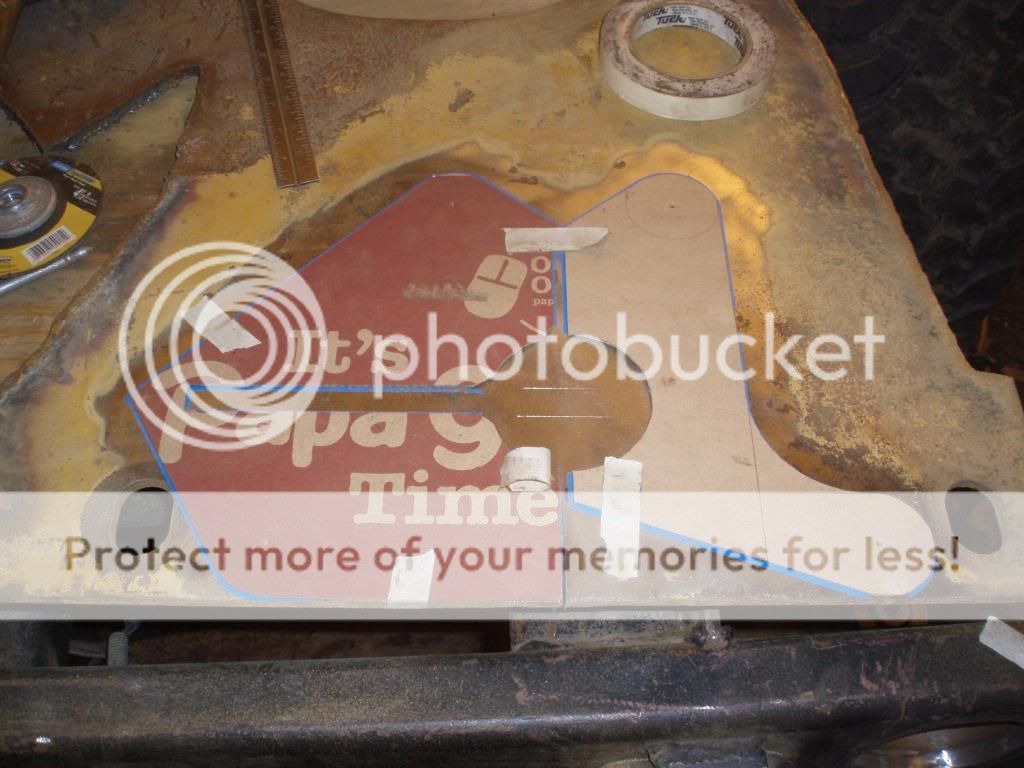

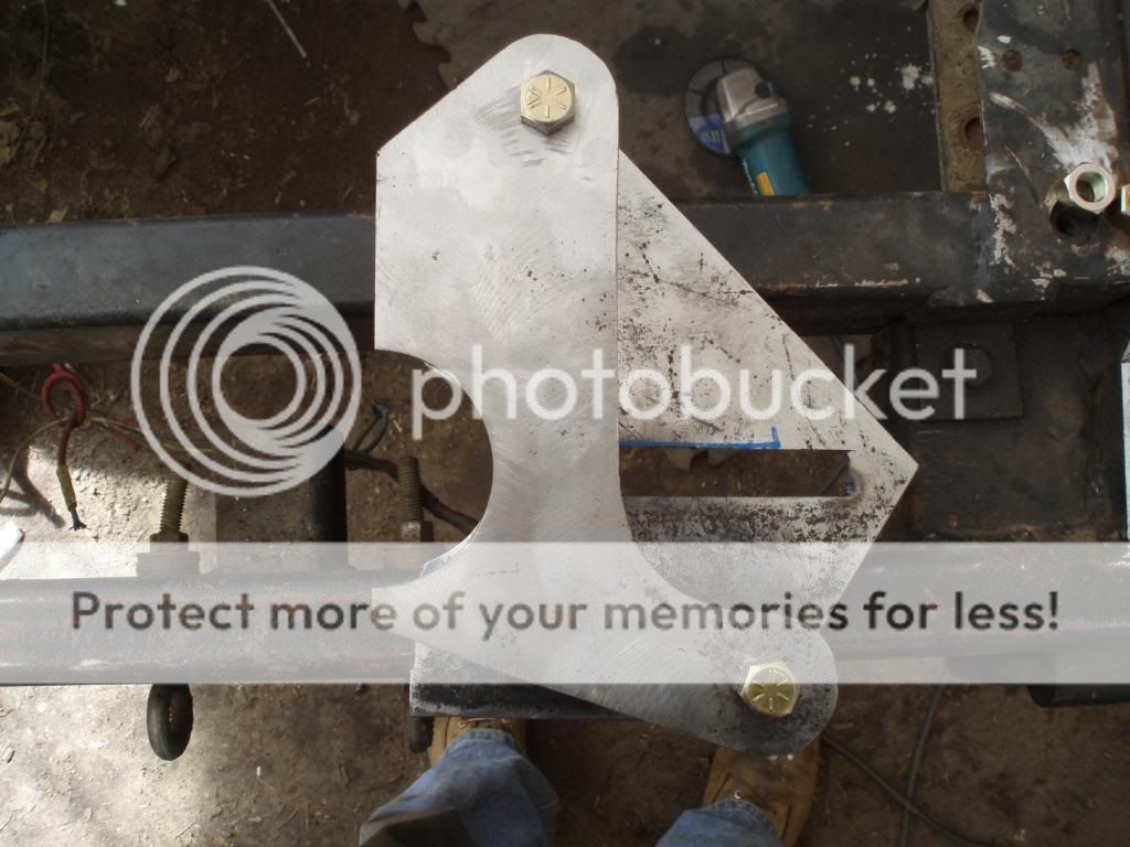

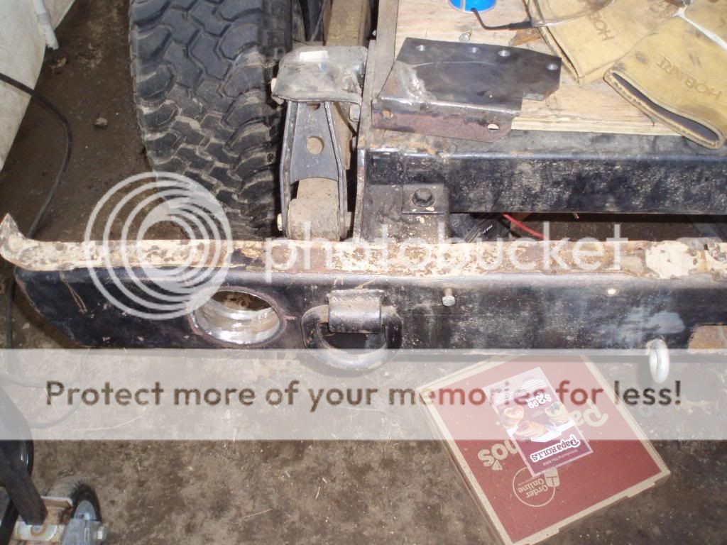

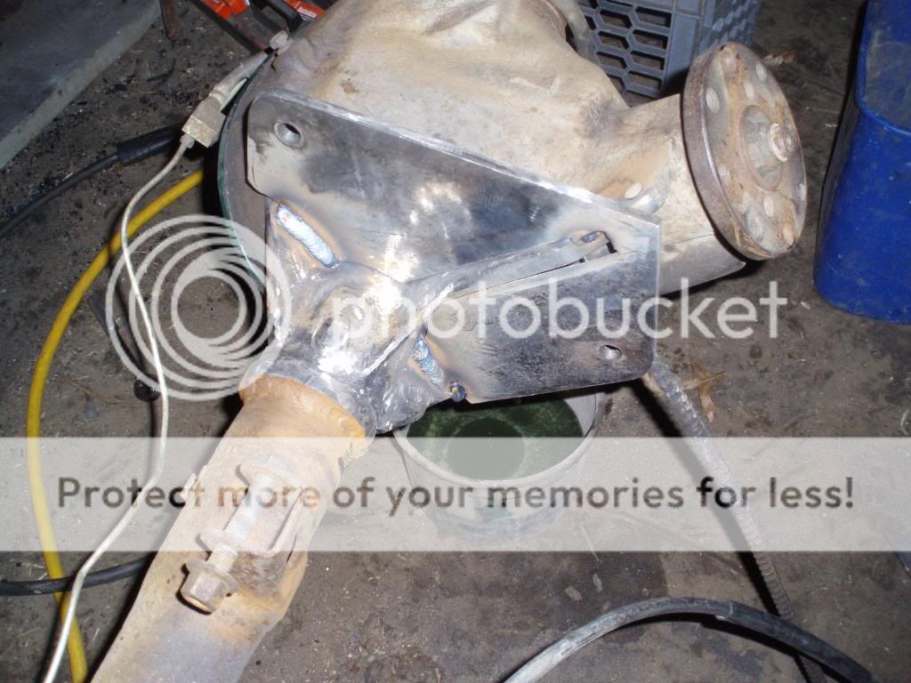

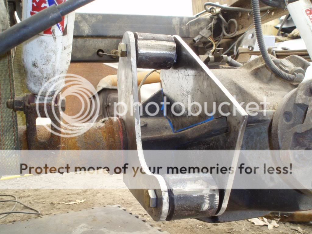

And then I started on the axle brackets for the traction bar.

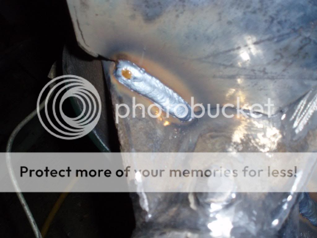

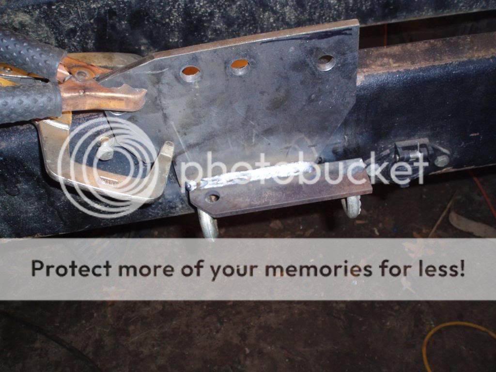

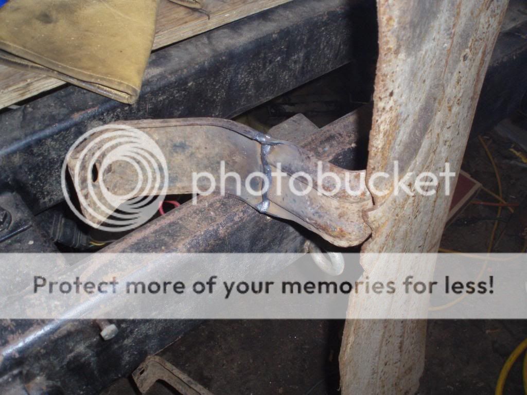

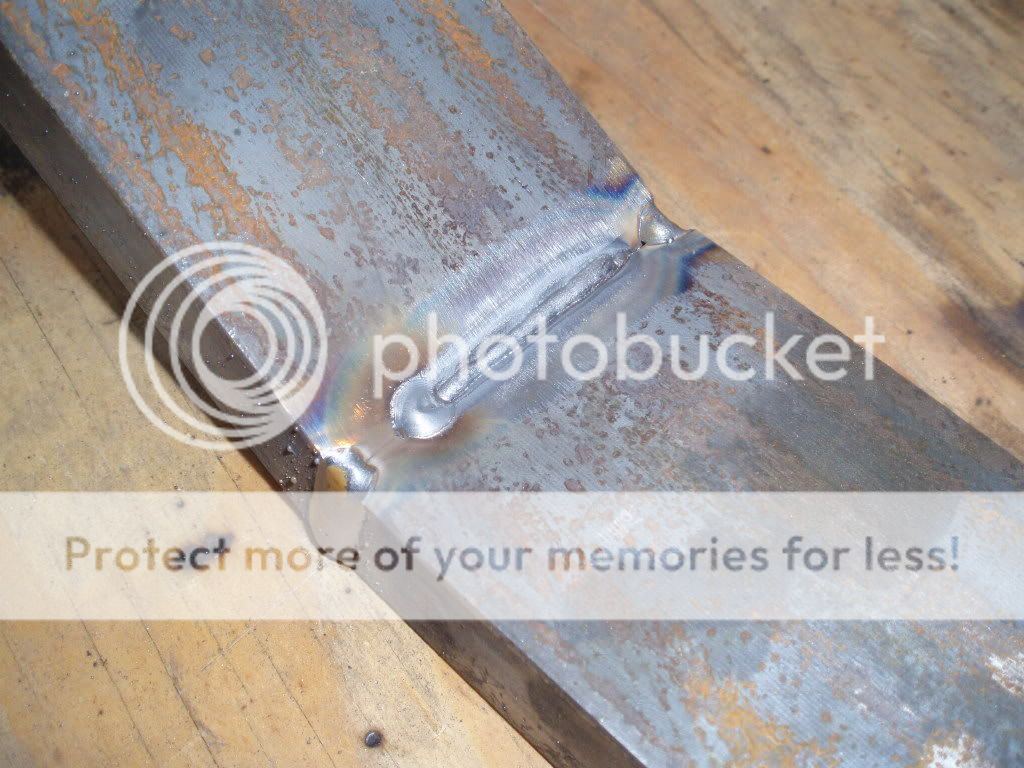

:icon_surprised: Do my eyes deceive me? Is that spray welding!!?
I mean, if it's spray welded, it's indestructible!!!
If it's short arc, man you're good!
short arc.. welded from back side.. damn good penetration..
You cant do that with a 110 welder. 220V FTW:icon_hornsup::icon_welder:

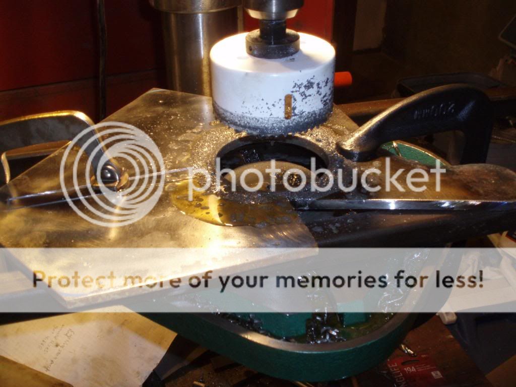

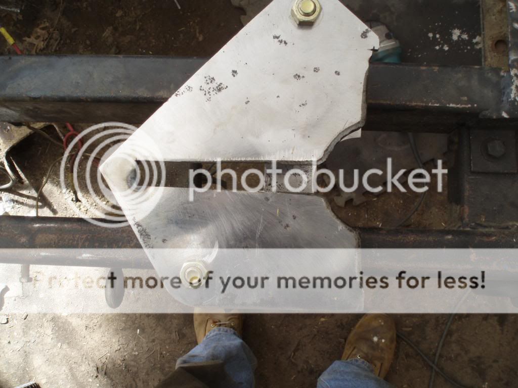

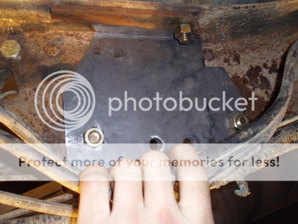

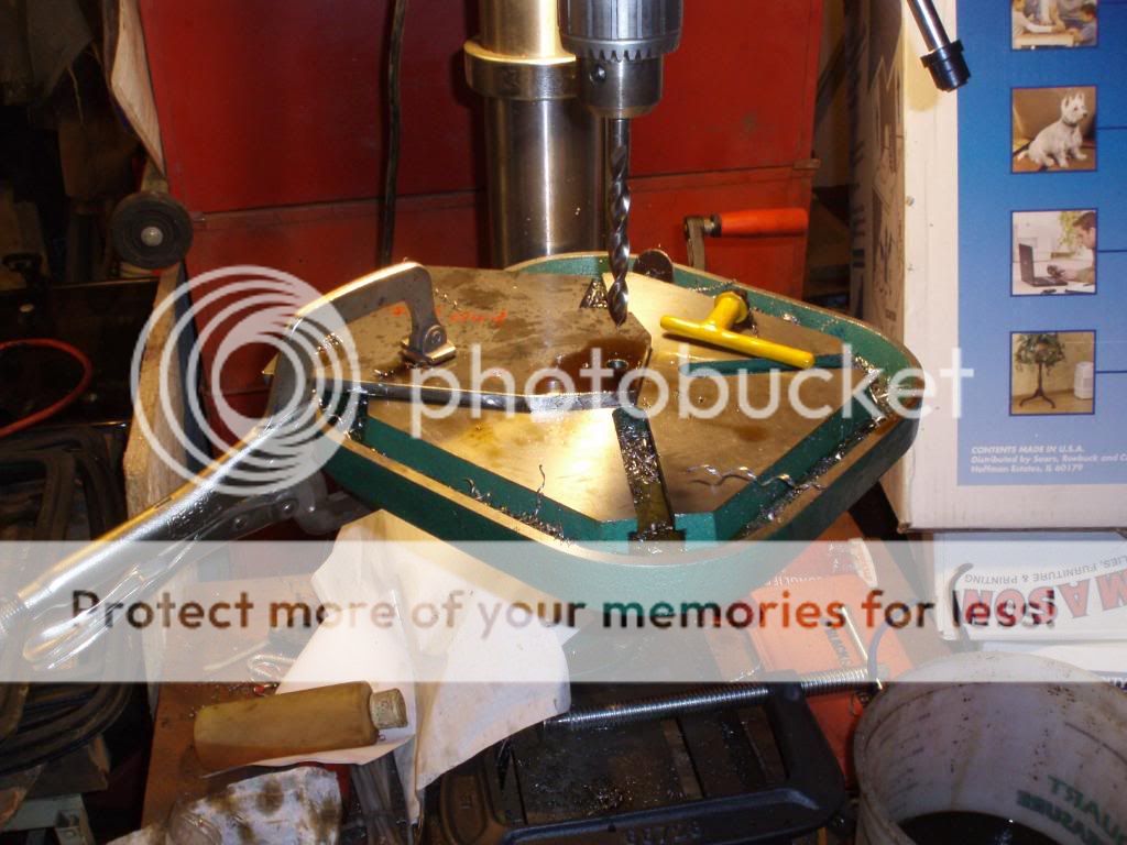

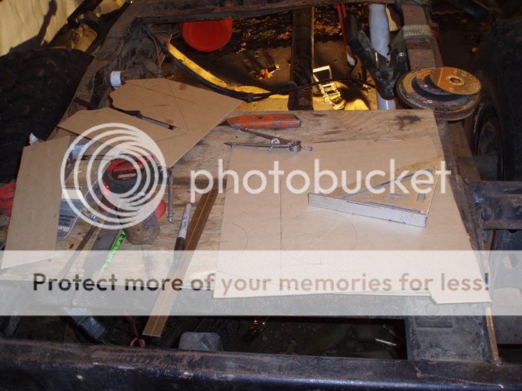

Some good progress today.

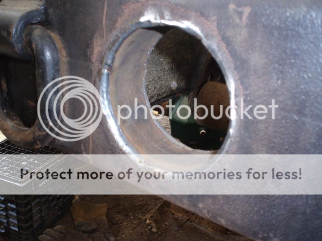

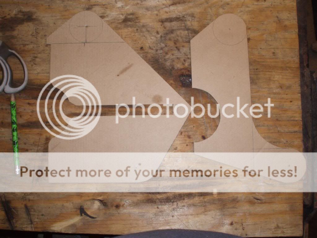

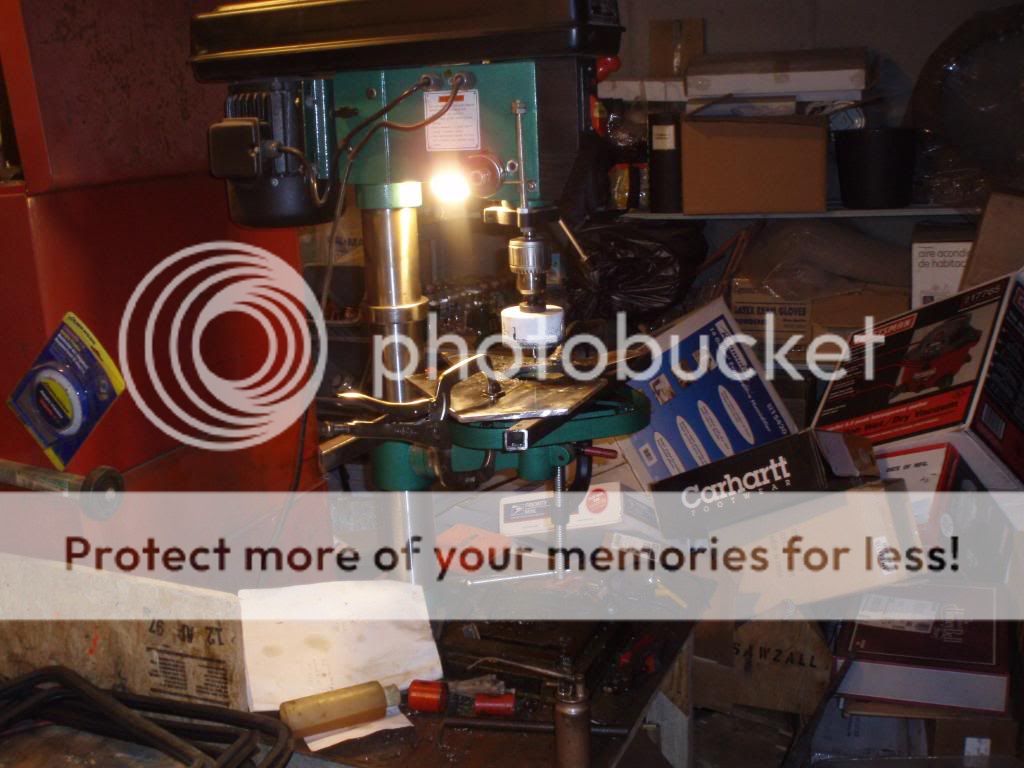

I used a hole saw to cut the circular part of the bracket so it would be as equal as possible.
