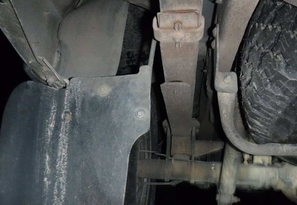

I went and snapped a shot at mine and the block does look a bit shorter. Yours also looks newer than the components around it.

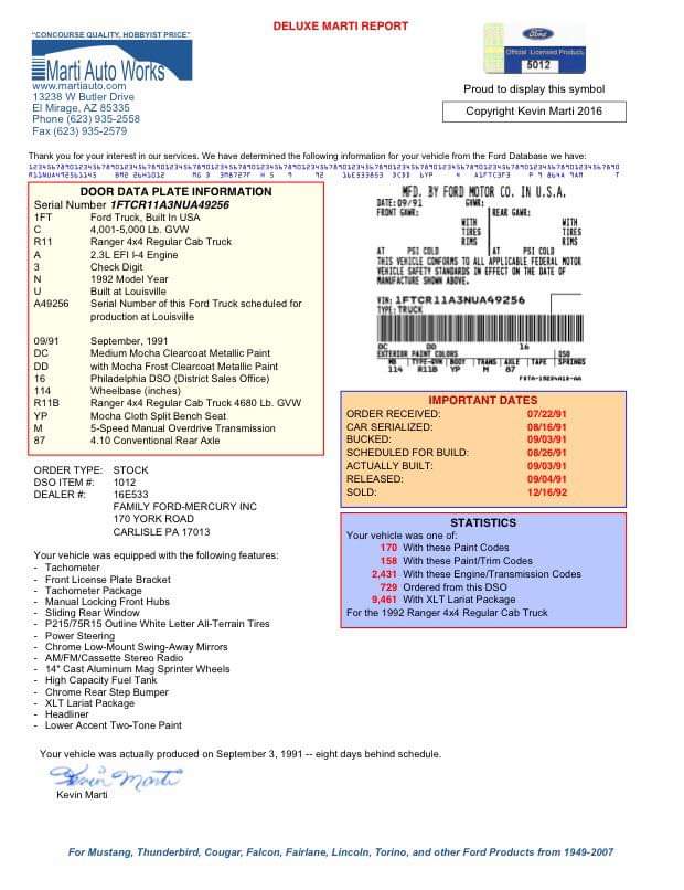

My old '92 was an unusual truck. 2.3 4x4 long bed XLT 2 tone mocha paint with factory 1354 manual transfer case & hubs, the big chrome mirrors, the optional 19.5 gallon gas tank, 10" rear drums on the 7.5, & no AC. I actually ordered a Marti report for it and that does show all that on it.
The OP's block definitely is taller than a standard 4x4 Ranger block (note where the angle of the bump stop arm ends, it comes all the way down to the bottom in Josh's pic).
STX Highrider blocks are my guess also.
If you'd rather lower the rear than raise the front more, I'd say grab some stock Ranger (not '87-'89 STX) blocks from a wrecking yard.

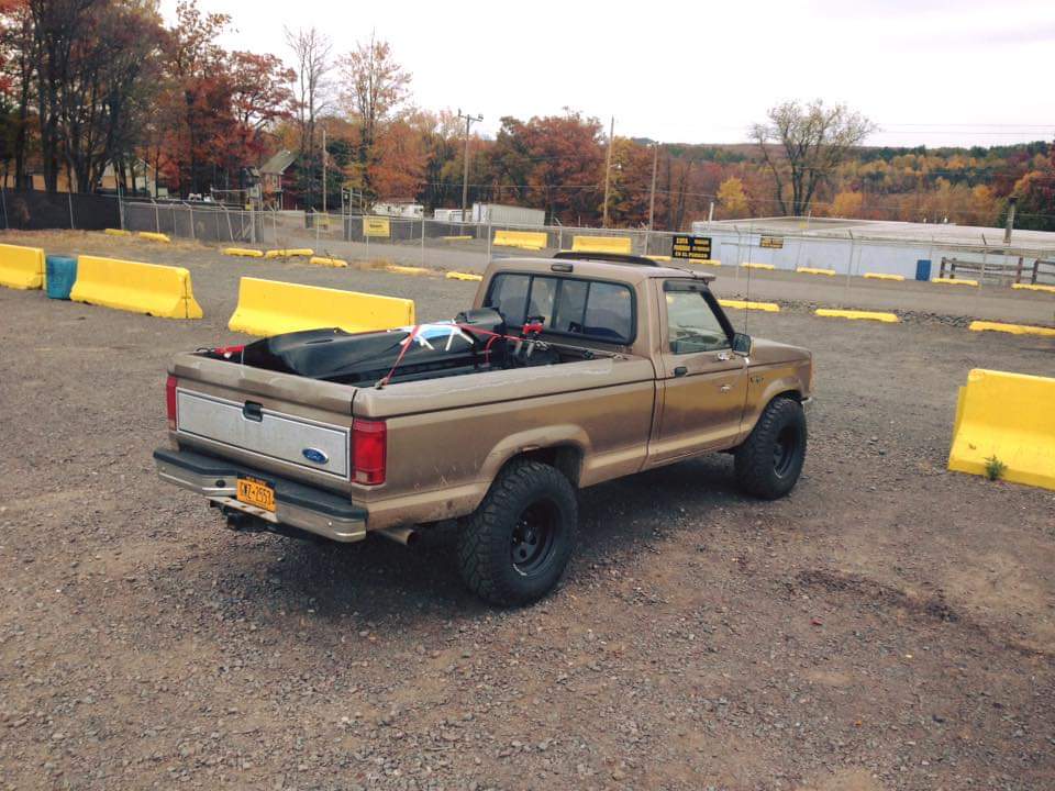

Really like the look of turbos brown 1st picture.
