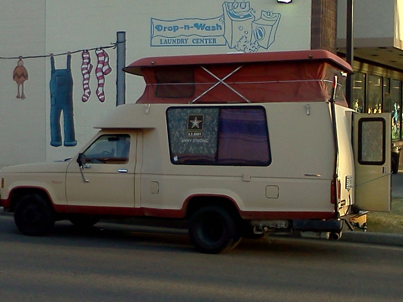

My Ranger Roll A Long - For Sale - Colorado
This is my camper that I'm selling. Listed on Fort Collins, CO craigslist

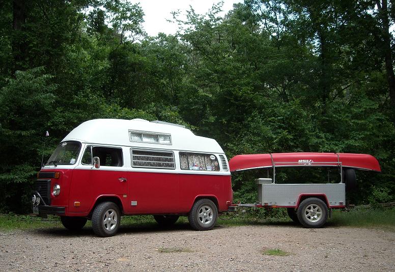

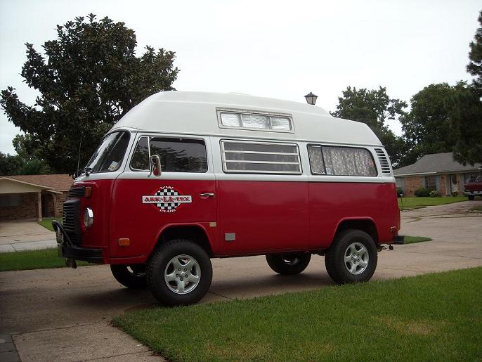

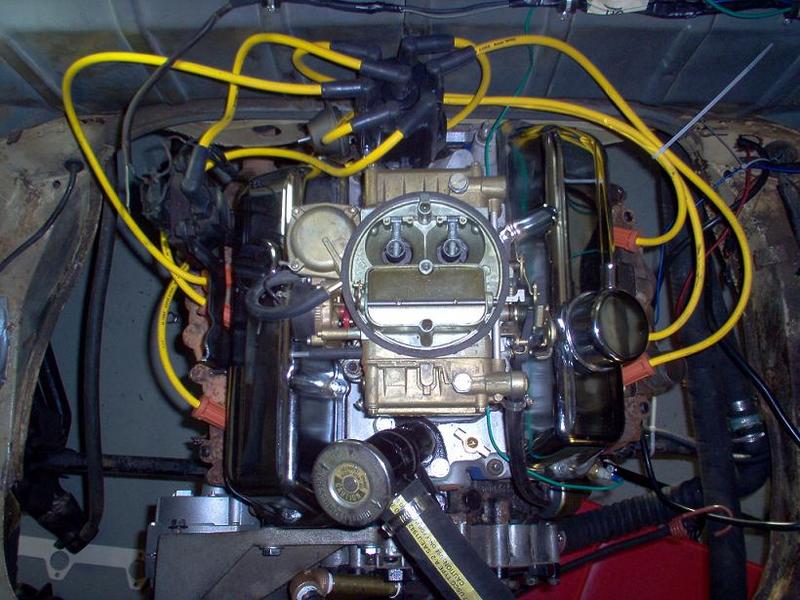

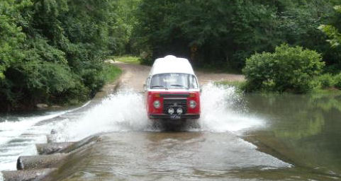

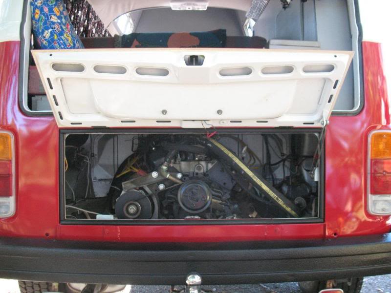

Here is my creation... While not a Ford 2300 it's still a pretty unique approach at offroad camping.... Clyde is a 1973 Vw Adventurewagen.... Powered by 2.8 L Chevy..... I almost went with the Ford 2.8l Cologne V6 but parts were difficult to source on the road.. The V6 is bored .040 over, Torquer Cam, Edelbrock Tunnelram, Holley 4bbl. puts out 200hp and 200Ft. Torque.. The rest is beefed up Vw.
Clyde had a 4" lift kit on him running 32" AT tires rear and 30" up front.. 4:57 R&P with a Overdrive 4th gear installed... drops rpms to 2700 @ 70mph. I've since removed the lift kit but still run the tires..... He just handles better at 75mph..

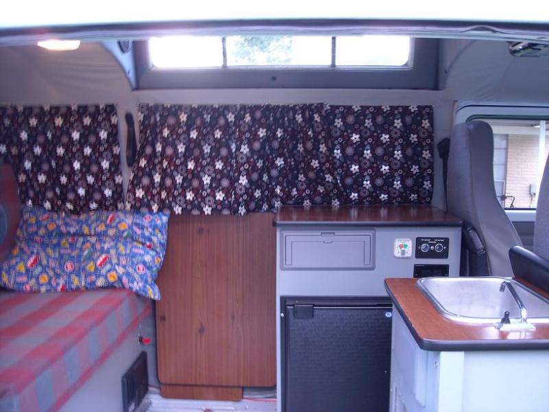

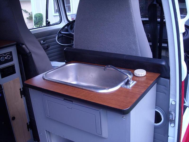

Inside Clyde sleeps 2. It has a 65watt solar panel on top to supply dual batteries with power ... solar powered fridge, running water, DVD/TV with surround sound. LED's throughout.... It's a very fast and fun camper...
I built a custom AT trailer to pull extra camp gear and my canoe/kayak with.
