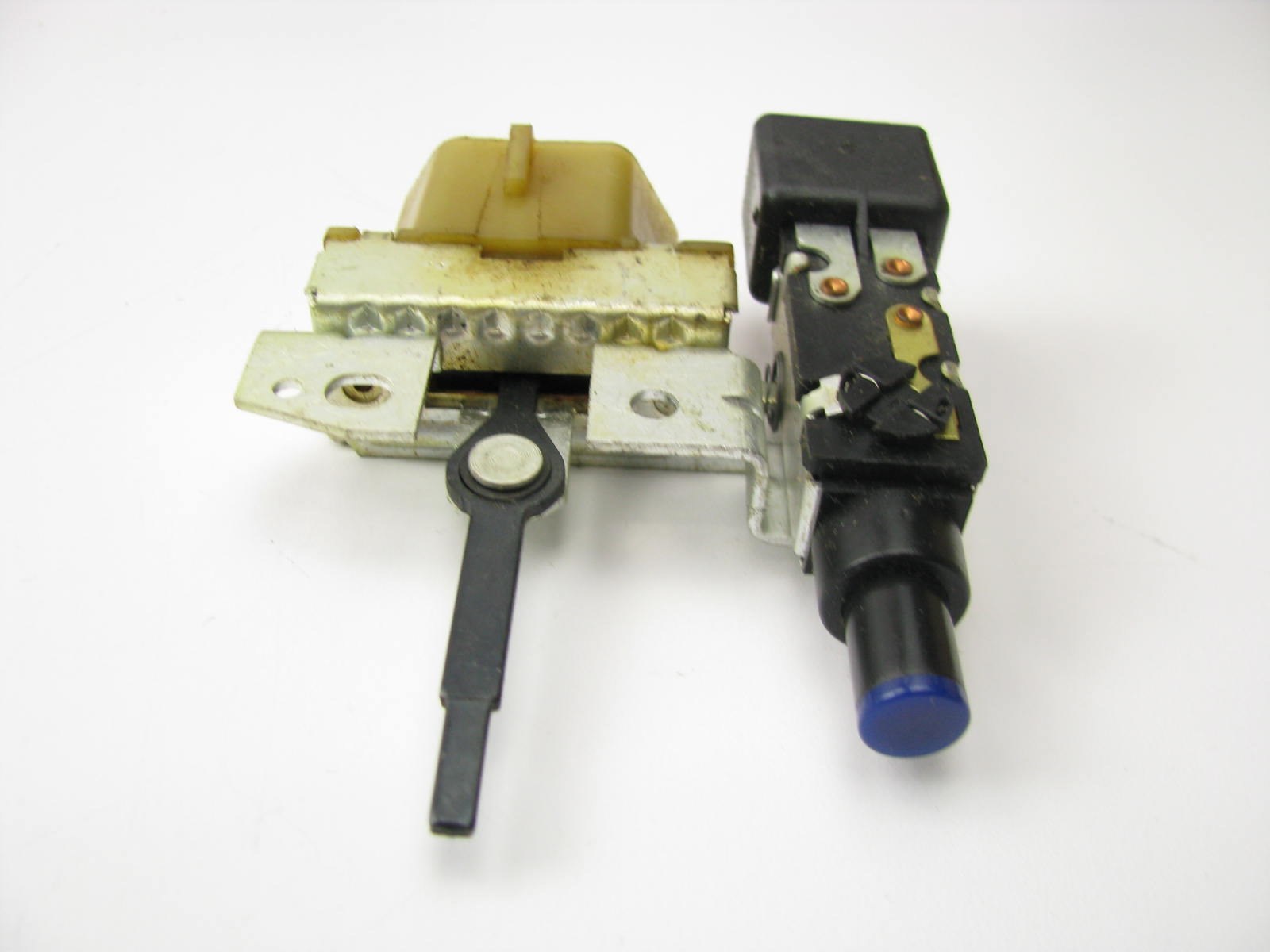

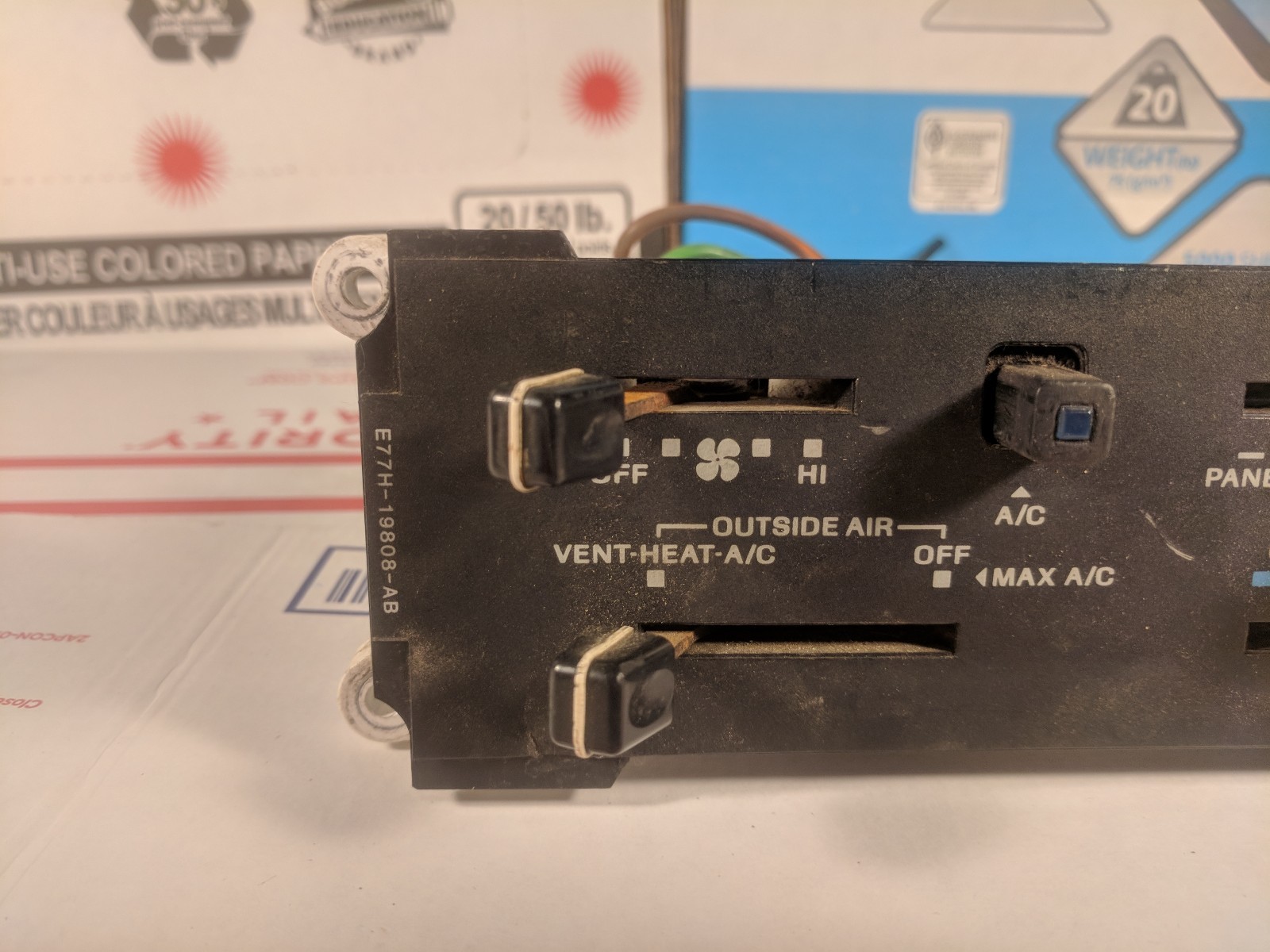

Factory A/C control push-button:
I believe this is the switch typically added when dealers installed A/C, but I've also seen round, translucent red push-buttons in the junkyard:

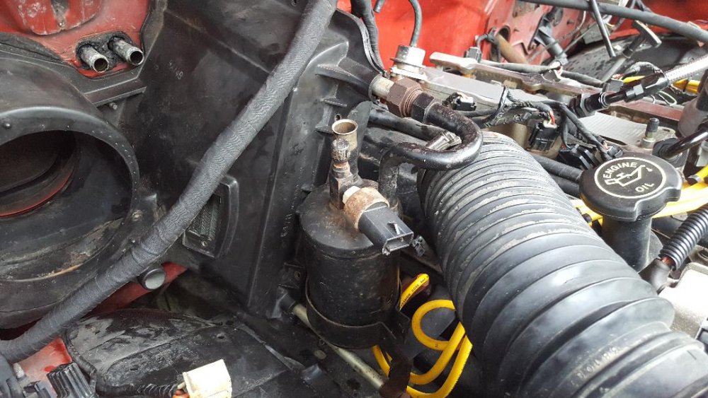

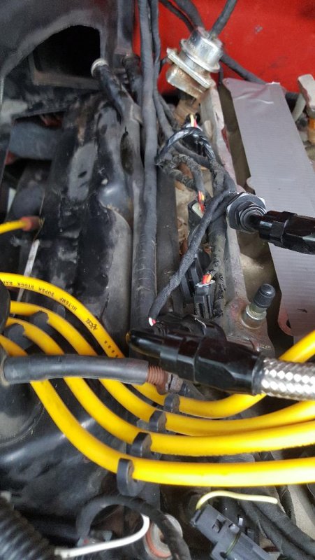

I do notice that the later Rangers added an in-line muffler/filter, with a high pressure switch port on it for even later models, and I "thought" they changed from a cycling switch on the low side, to a low pressure switch. The reason I thought that was due to this video, where he installs all new A/C system parts (except the evap) and there is a cycling switch on the accumulator, and some other type of switch on the filter/muffler:
At 9:11 in this video he removes a "high pressure switch" and at 14:25 he removes the "cycling switch" on a 1994 Ranger:
On Rockauto, this is listed as a "discharge" hose for a 1993 Ranger, but they don't list a high pressure switch for that year. Notice no port for a high pressure switch on the filter/muffler:
Rockauto listed this as a 1994 Ranger "suction and discharge hose" - notice the port for a high pressure switch:
It seems like as Ford went along, they started seeing room for improvement, or perhaps there were customers coming back for repairs and Ford thought they could save some money on warranty claims by using a filter in the system. This would have been back in the days of the "black death" compressor failures, which quickly clogged orifice tubes.

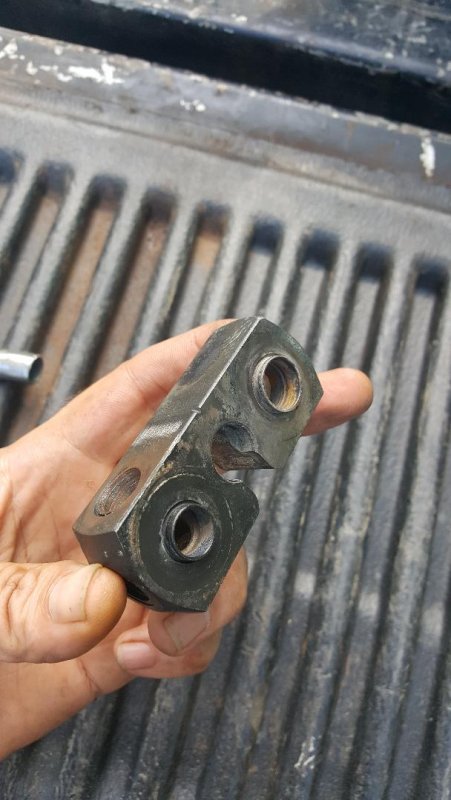

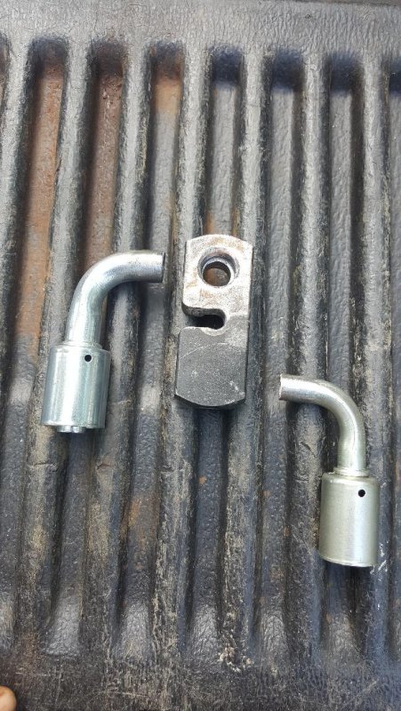

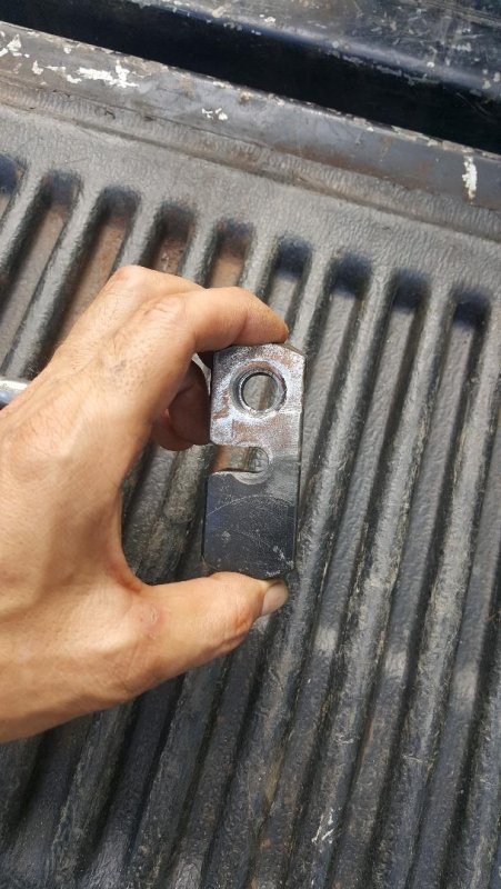

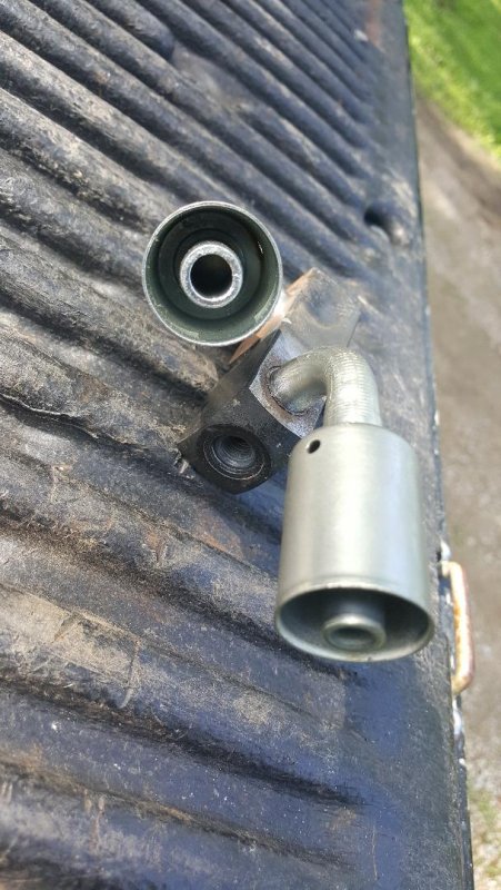

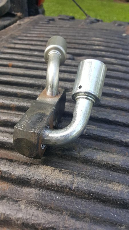

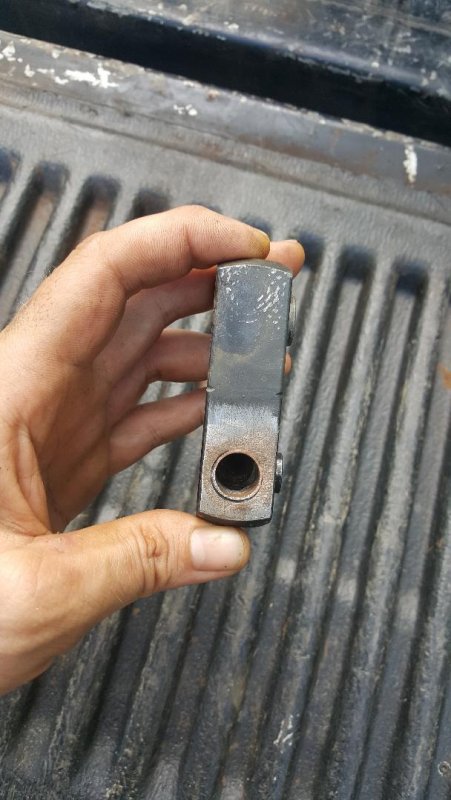

Here's my solution to the tight confines around the back of my compressor. The only downside is that I'll have to have the hoses crimped first, then I plan to silver solder the tubing to the compressor manifold. I'll have to soak a rag in ice water and keep it wrapped around the fittings to avoid overheating the crimped hose connections, but I think it's doable. Silver solder melts at around 450 degrees compared to silver brazing which has a melting point of around 1200 degrees, or having them tig welded at much higher temps. The direction I need the hoses to go, they won't be able to crimp them if I soldered or welded them to the block first..

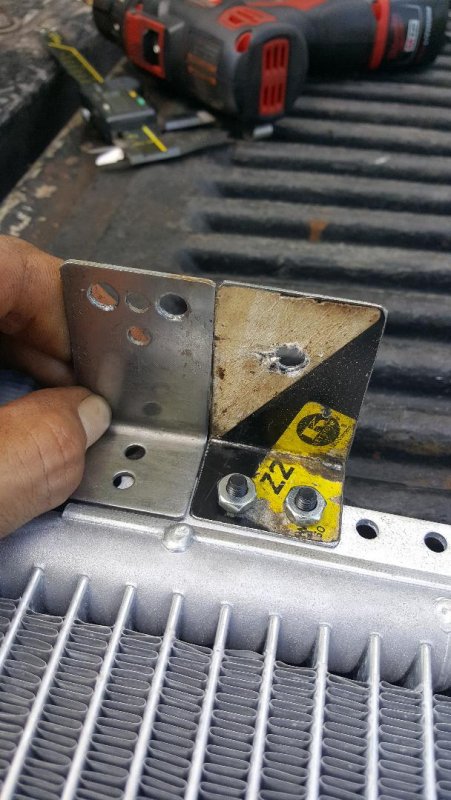

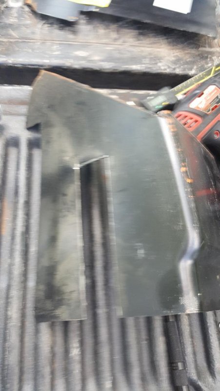

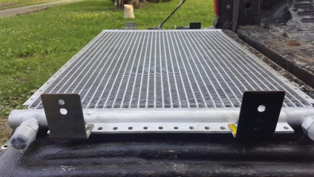

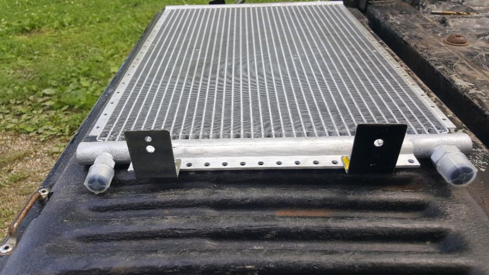

I found a couple stainless brackets in my scrap pile that worked perfectly in the space I have available for my condenser, so I took what was left of my cab corner patch panels and cut some pieces to duplicate the stainless brackets.. Cut, grind, smooth, mark and drill...
Some extra holes in them, but they'll never be seen anyway...
After fitting up the brackets, the spacing couldn't be more perfect. The assembly fits snugly inside my core support and will stay put without bolts. I do have some minor grinding to do on the back side of where the hood latch mounts, on the center piece that comes down in the middle of the core support. The grille attaches to that piece, so cutting it out isn't an option. I'll grind about 1/6" to an 1/8" off in some places to tuck things in tighter to make room for my radiator to fan clearance. I already cut the extra length off of a couple bolts that stuck through too far and would have damaged the new condenser..

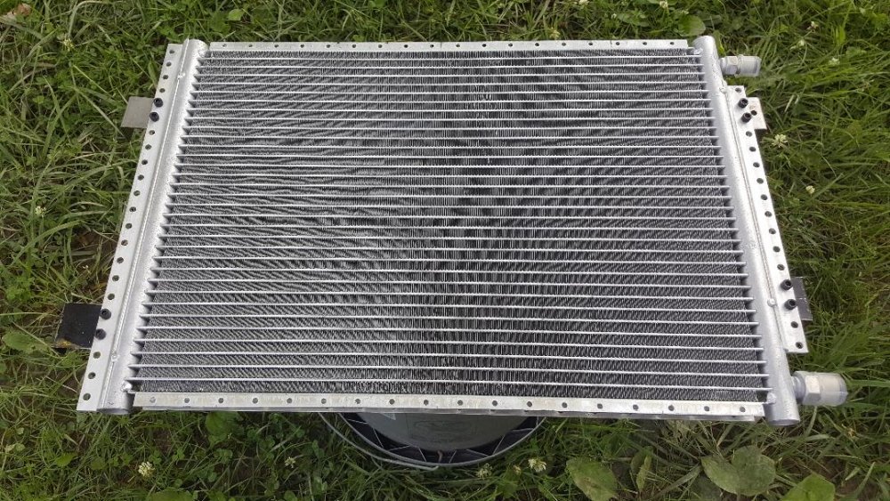

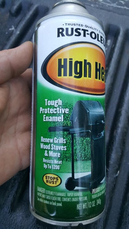

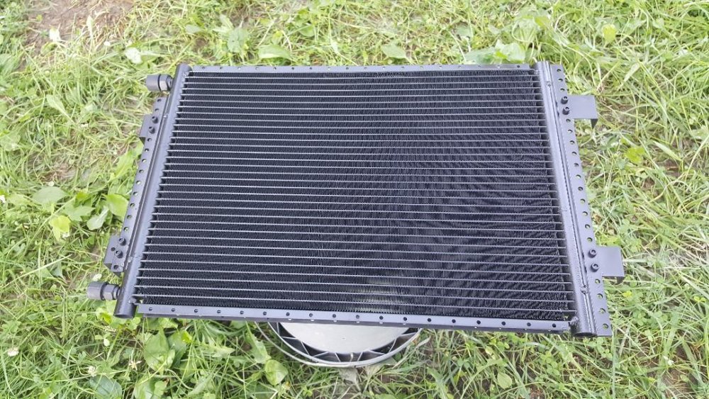

Then it was time for some paint, since it's so easy to see from the front of the truck. I never painted the aluminum radiator core, because it didn't look too bad as it took up the entire empty space in the core support, but this condenser being a bit smaller than the opening in the core support, I just thought it looked terrible in raw aluminum. So I hit it with some high heat paint to hide it a bit better. I don't see it affecting the condenser much, as you can order them with high heat paint as a more expensive option.

To me it looks like the compressor block/fittings/hose connections are going to be your biggest hurdle to leap. I know I would exhaust all resources before I had the fittings crimped prior to being soldered together. Some of those crimping tools look like they will get into some pretty tight spaces.
I've thought about getting some longer pieces of steel tubing and bending them to fit in the tight location I need them to, head the right direction to whatever component they're going to attach to, then weld them to the manifold block. After that, use fittings like this silver soldered or brazed to the tube:
BUT, the problem there is getting the tight 90 bends I need. I've gotten pretty good over the years at filling tubing with sand, then heating it cherry red and bending it to whatever shape I need, but I'm not sure I could get a tight enough 90 bend.. Having tubing bent somewhere will only add more cost.
Another option would be to tig-weld threaded connections on to my manifold block, like this:
Then use expensive, tight clearance 90 degree fittings like these:
But again, I'm not sure of these options fitting in my location due to clearance issues. It's extremely tight behind the compressor.

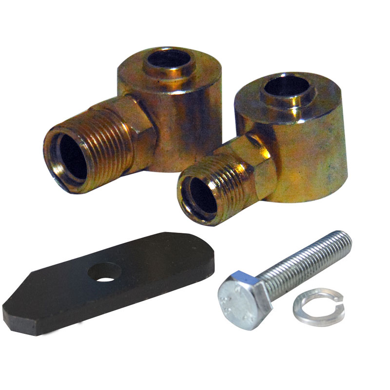

I'd love to go with an option like this, and eliminate the compressor manifold block altogether, but the port sizes on my compressor are different from one another, so fitting like this staying centered could be an issue?
I like the last option you posted... no soldering required. They will give you way more positioning flexibility too... opposed to a crimped on rigid 90 degree fitting. If your 90's don't get crimped exactly how you need them... you will have to "twist" the hose to get them where you need them. This will put some undo stress on your 90's and solder joints.
Again, the problem with the last option, the swivel, is that the low side swivel will fit the opening in the compressor very loosely. If I still had access to a lathe, it would be easy. I'd just turn down a press fit bushing and install it on to the swivel "bung" where it meets/goes in to the compressor. Keeping it centered..
I think I'm going to stay the course on silver soldering my hose ends in to the manifold block. I've already got $25 in those two fittings... I'll have them crimped to the hoses and then silver solder them in to place. If not, back to square one I guess. lol

That's information that's has proven impossible to find. The Ford FS-10 compressor o-rings, i can measure my old ones, but the outside diameter sealing surface of that swivel adapter is unknown.
That style of swivel is meant for a Sanden G or GV head compressor. The port sizes from this manual are listed at 16.7mm and 15mm but they use sealing washers that are metal and rubber that are permanently joined together, and there are seemingly hundreds to choose from. (a ton more research)

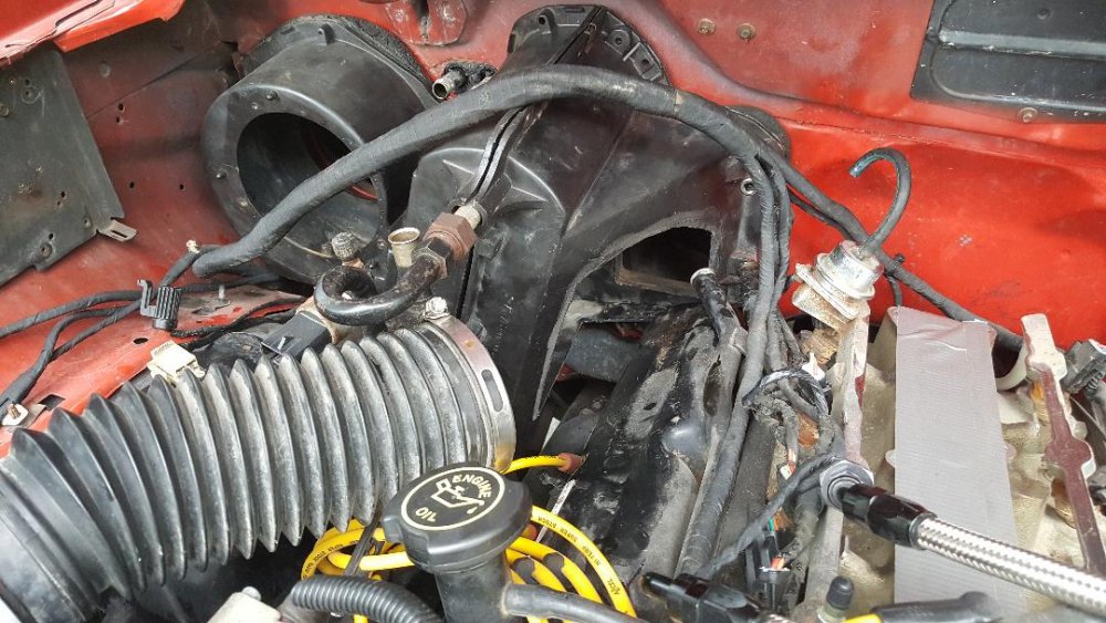

#1 - The condenser will fit in front of the radiator just fine, and I'll have plenty of clearance for the mechanical fan. I test fit all of it and everything should be fine. I do have to cut off my lower radiator mounts, extend them and weld them back on again.
#2 - I'll have to eliminate the coolant crossover tubes that go across the intake to the heater core. They were a pain in the arse to deal with anyway. I originally had to cut them shorter to install heater hoses without them running in to the heater plenum. The A/C plenum leaves even less room, so I have to pick up a fitting that threads in to the lower intake and has a port for the heater hose and another port for the coolant temperature sensor. From a quick Google search, it looks like several are made that should work fine. If not, then brass a "T" with a hose barb and adapter for the sensor will suffice. I'll then use plain old heater hose and run it from the front of the engine to the heater core.
#3 - Adding the A/C plenum without the evaporator was ok to do, but with the evaporator in place, it was impossible to insert the final plastic evaporator cover, and it won't all slide in to place put together as a single unit. So I had to remove the upper intake. It all slides in to place easily now, and it looks to have ample clearances everywhere I need it so far. Fiberglassing the plenum may be tricky to get right to allow enough clearance for installing all of the parts, so I'll have to take care when adding/shaping the fiberglass to make sure it will still slide in to place past the passenger valve cover. I already have some fiberglass mat with heat shielding that I'll stick on to the plenum when finished. It's worked well on my heater plenum after my V8 swap.
