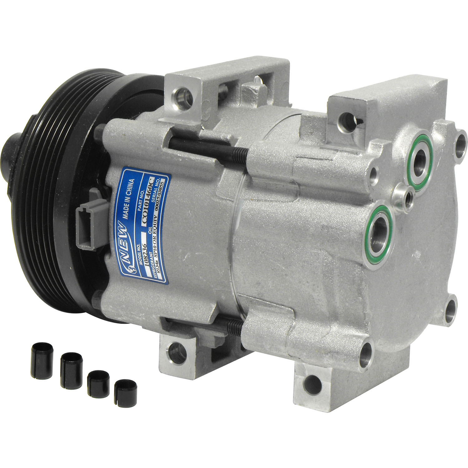

I'm still going back and forth on which compressor to use. My Thunderbird FS-10 compressor has the suction and outlet on the rear endcap, which is a bad spot for me. It's a tight spot with my V8 swap and my engine mounts. I've found one adapter that may work for me. I'm not sure. So I've been looking at other styles of FS series compressors online, but nothing else seems like it'll give me any more advantages when running the lines.
Even though this swivel adapter is commonly listed to fit certain styles of GM compressor, I called 4Seasons and the phone tech told me this one would connect to the Ford FS-10 style of compressor, so we'll see. I'm waiting on the condenser to get here first to see if I can make it fit. I'll have to cut off my lower radiator locating brackets and fab new ones, but that's part of the ballgame..
Four Seasons 12034 swivel
https://www.rockauto.com/en/parts/four+seasons,12034,a/c+compressor+service+valve+/+adapter,6992
I can't find any pictures of the "hold-down" bracket from this adapter that show the backside, so I may have to do some modifying to it, to make it fit over the locating dowel on my compressor. Which would simply be a slightly larger, counter-bored hole of a certain depth. Either that, or shave the locating dowel off of the compressor body, and that depends on how deep the threads go. My main concern is whether the lines are the right size where they meet the compressor body, and the distance between the ports being the same on the adapter and the compressor. If not, I'll have to fab up my own hold-down bracket if the lines fit the compressor body, but the hold-down isn't spaced right.

Just to show my hose connection location and locating dowel between the ports:
