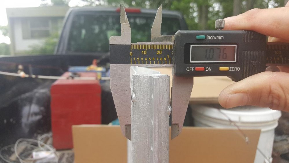

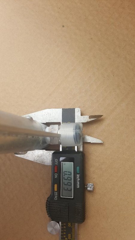

Well, the phone tech at Nostalgic AC Parts flat out lied about measuring the condenser. There's no way he was actually measuring it while on the phone with me like he seemed to be doing. He stated it was 7/8 max thickness on the end "tanks"
Here's the thickness of the "tank" or header, just underneath the fitting:
Here's the max thickness which includes the little spot welds that hold the brackets on:
I could have still used it after test fitting it in the truck, but the lower fitting on the end ran in to a curved section of the core support down low. It would require way too much cutting of the core support, and I'm not comfortable with removing that much metal in that spot.
