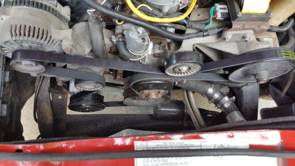

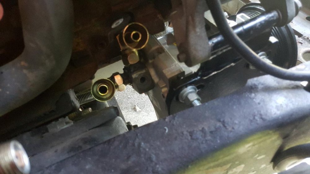

I had to make a new 90 degree bracket for the drivers side of the A/C compressor that was shorter. That allowed me to swing the compressor up a good bit and made a lot more room for the manifold and fittings. I also ground off a small bit off the engine plate (can't see it in this shot but I took one corner off of it) to allow a little more clearance. If the engine moves enough for anything to hit then I've got bigger problems to worry about! Keep in mind that these fittings swivel until fully tightened up, so this isn't their final direction they'll be pointing.
I'll be buying some DEI fire sleeve to install over the hoses behind the compressor. They aren't very close to the headers at all, but it won't hurt to protect them from the radiant heat.. (They look close in this shot, but you know how pictures throw off the scale of things sometimes - the alignment and spacing of things in this picture makes things look closer than they are, but some things are farther away, and some things are closer to the camera, but you can't tell)

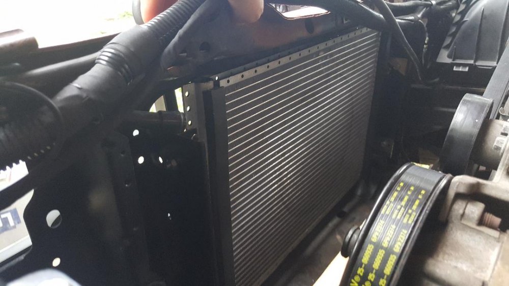

The condenser also needs straightened up a little bit. The bolts were still loose in this photo, so it should straighten right up once tightened down.

Your manifold fittings look like they should work well... it is pretty tight in there.
LOL... that picture sure does make it look like you have a belt alignment issue. But I see your compressor bracket has slots to get the alignment right so I'll trust your perspective.
I can't see all of the compressor bracket/mount... so I have to ask. The compressor plate is bolted to the compressor and that is welded to another plate that runs up to the pivot bolt. Is there another point where the compressor is held stationary? Seems if there isn't... that compressor is going to want to pivot when you kick the system on.

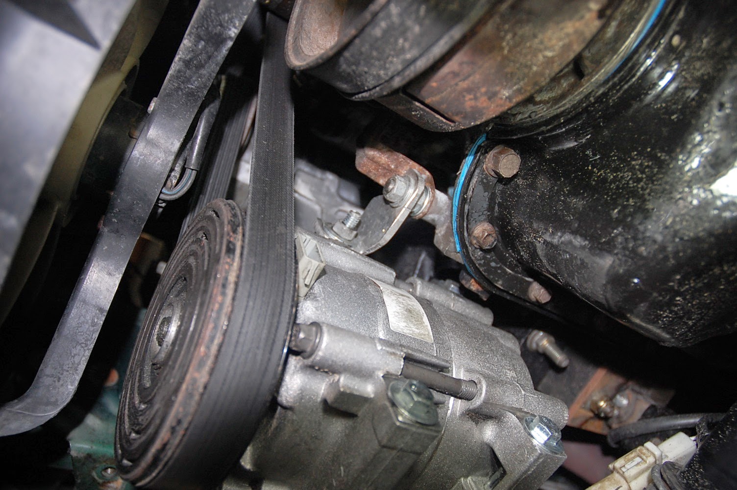

There's another 90 degree bracket that holds it stationary. Much like the one shown here: http://miatav8.blogspot.com/2014/07/ac-conversion-ford-302-passenger-side.html
Here's one on his 302 swapped Miata from that webpage, but mine should be stronger. My 90 degree bracket is thicker.
Let's discuss adding A/C to my 1st gen V8 truck that never had it to begin with..
I've put full belt tension on it and then crawled underneath and hung my body weight on it trying to get it to flex, and it's solid as a rock. I've also confirmed belt alignment by using a straight edge on the front of the crank pulley, and then measuring from it to the first groove in both pulleys.

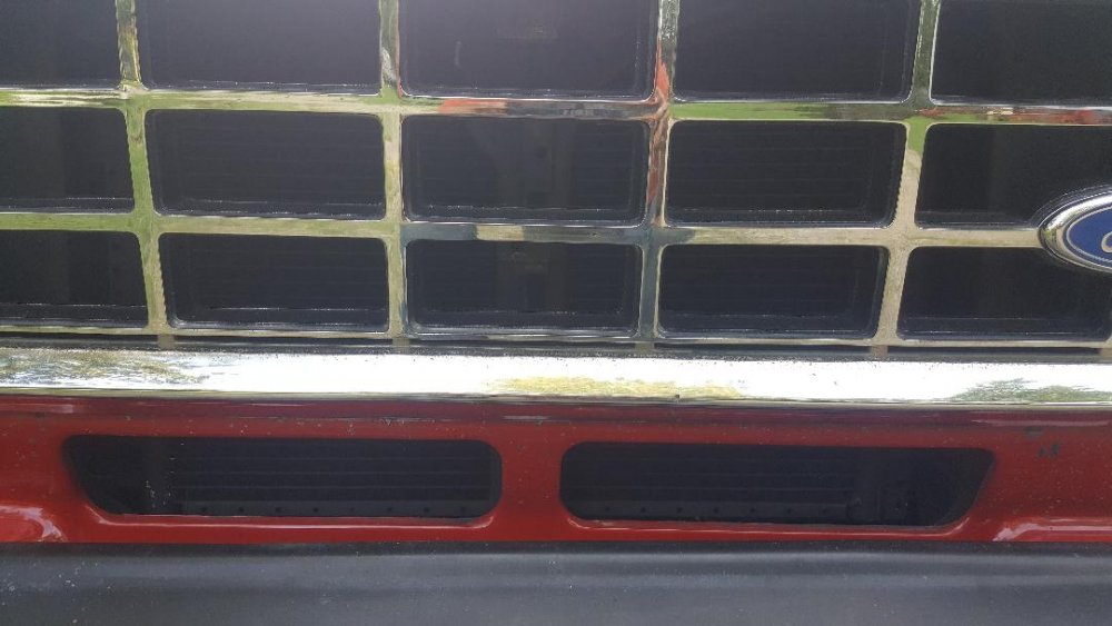

Condenser mounted up and holes drilled (hole saw) for hose fitting access on the passenger side..

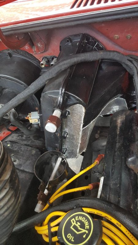

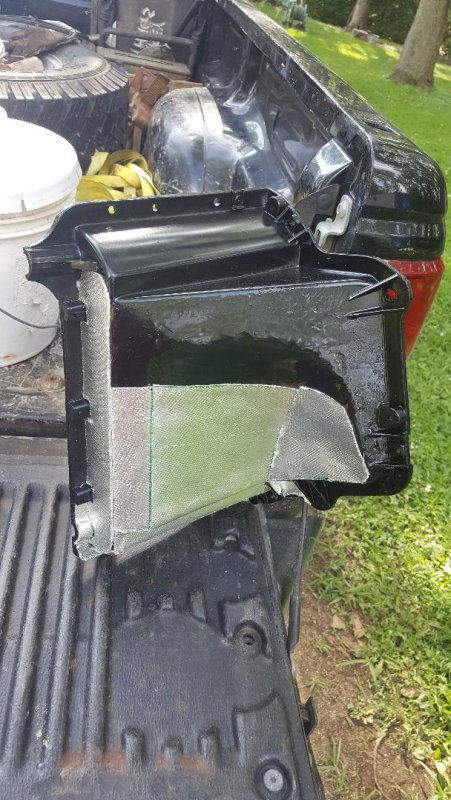

Cut, fiberglassed, painted, and heat shield applied to the plenum... It looks rougher in photos than it does in person.

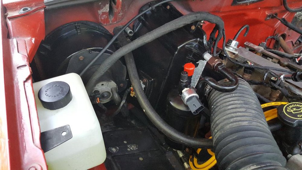

Evaporator installed and plenum assembled. Other than a few small screws. I have to take a walk back to my parts trucks to steal a couple of those little clips that have threads in them..
It's not even remotely close to the header. It sure looks like it in this photo though. It's the angle. In reality it rides much higher than the headers do. My engine is mounted pretty low.
I may still make some more templates to apply some more heat shield material to the side of the plenum in the future.. I might also remove it all one more time to paint the passenger side of the plenum. Since the two parts don't match now. I didn't have enough paint to do it today so I just installed it anyway to make sure it all fit well. Clearance for daaaaaays.
