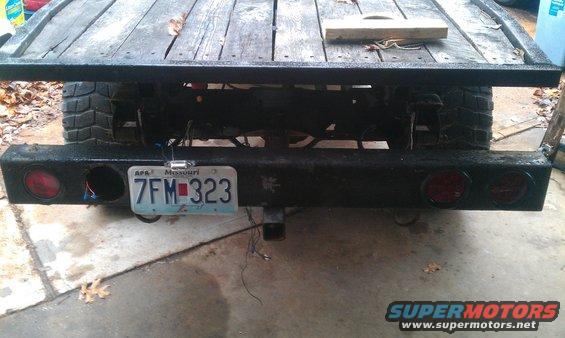

LED trailer light issue
I hooked to a ground, but nothing.....

Mine too is a constant. But with new flasher nothing works...

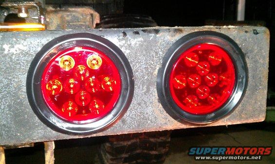

The lead is a ground, the terminals are backwards....
HA! got it! Also tacked in reverse lights!
