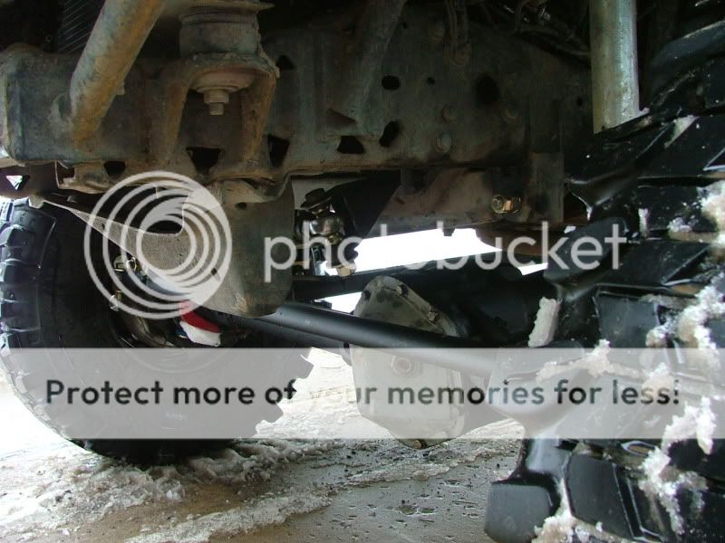

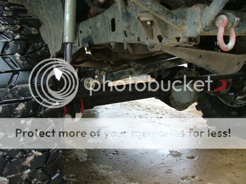

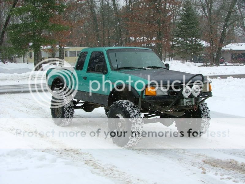

full width...little off center, bout 3/4", shoulda spend more time centering it. I might have the adjustment in my heims, other wise I can shorten my track bar to fix it, O-well, it'll still wheel the same. The front is about 2" wider overall than the rear, I will run it this way for a while.

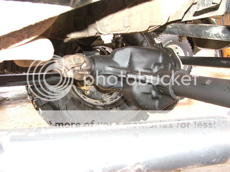

New to me HP

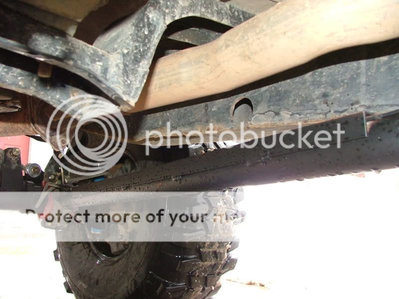

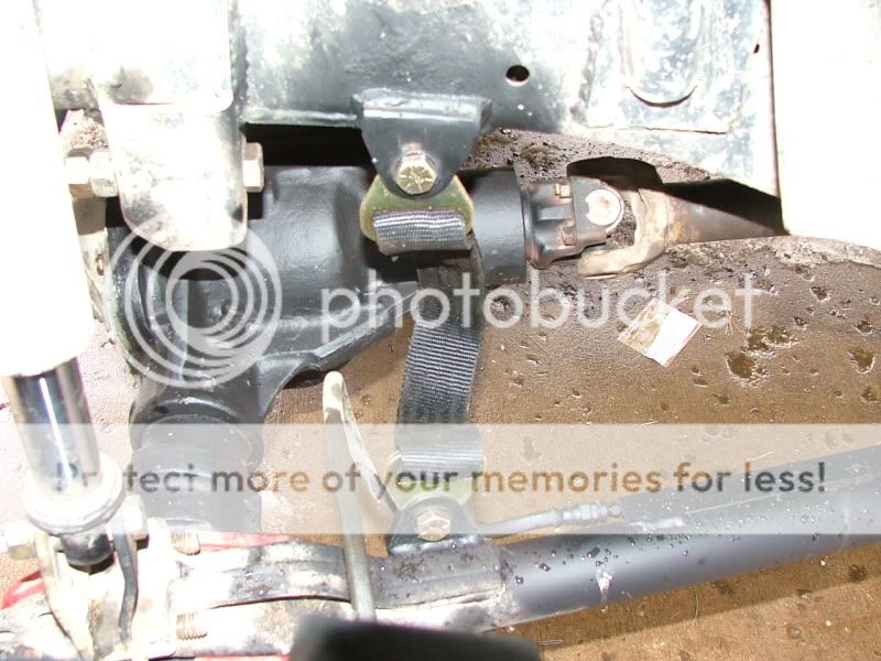

Limit straps I just put on, 18" long

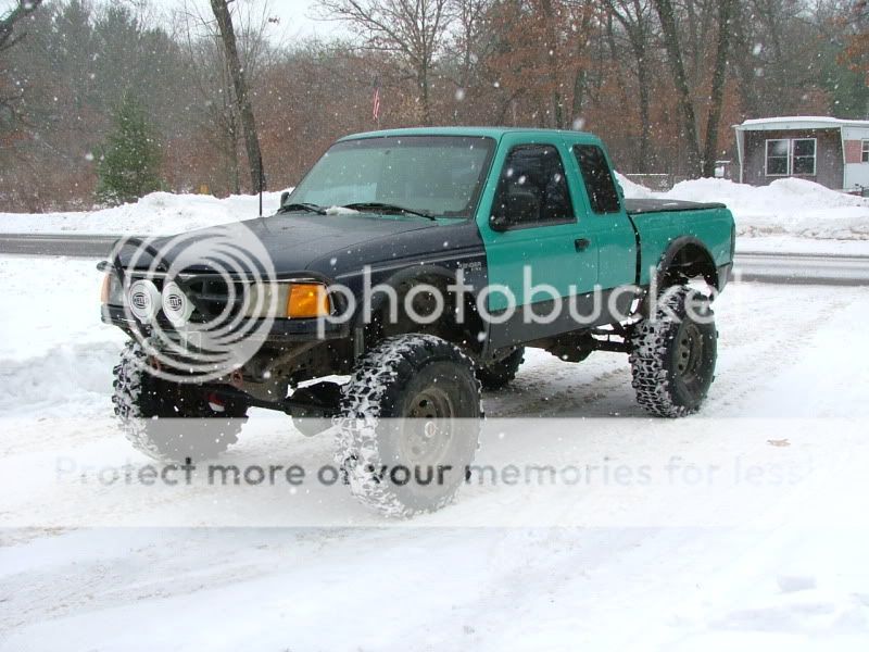

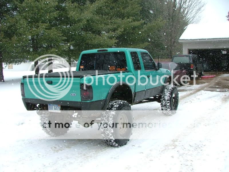

Then just a few so we all remember how it looks....beat and bruised

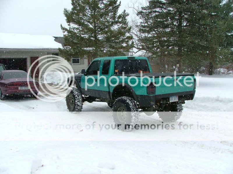

4WD works.....snow was deep!

Next on the todo list is put the explorer axle under it, inboard the springs, lose the blocks. I ordered a 8.8 ruffstuff diff cover and axle swap kit. I am also in process of making some new spring hangers. Gonna start this in a few weeks.

What kind of pitman arm is that and who makes it? Looks like a heim specific, double shear pitman arm.
I like the angle iron over the brake line idea.
Holy crap, what diameter DOM is that? 1.5"?
Looks awesome! :icon_thumby: Keep up the great fabbin'.
Thanks!
I made it out of a stock 4WD arm so I could use the heim and not worry.
The DOM where? The arms are 2" dia, 1/4" wall and the steering and track bar are all 1.5" dia, 1/4" wall:icon_thumby:
