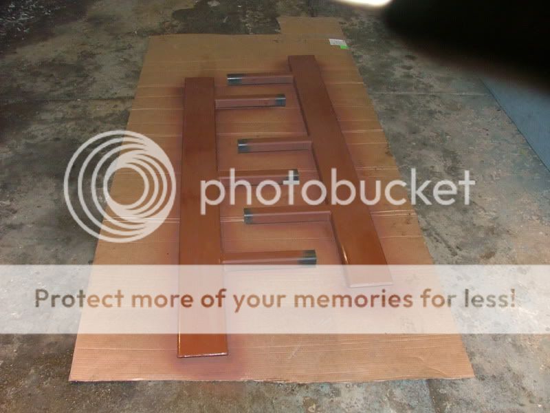

Got a little work done tonight, don't look like much, but they are my new sliders. 2x6 .187 wall and 2x2 .187 wall. I am planning on using all that new found 'space' to hold some compressed air. Think I might skin the bottoms just to be sure I don't mess em up right away.
what was wrong with your old sliders? And do you have any pics from the back tire looking forward so I can see what its like with full width in front and spacers in back?

I am tossing around the idea of an exo cage and I wanted something that would help make a more solid foundation for one. That is the only reason for the change, but this is the style I really wanted from the start. I just made the other ones because I had the material.

I would be about that price or less depending on what material cost, not looking to get rich off it but DOM or HREW is about $75 a stick on the low side and it would take at least one stick, prolly a little more.
You could just make the sliders from 1-1/4" schedule 40. That is a 1.66" OD, with a wall thickness of 0.140". Its really plenty strong esc for just sliders. That is what I have always made my stuff from and has always held up to all the abuse I could give it.
ASTM A500 grade B
Min yield strength is 42,000 psi, tensile strength is 58,000 psi.
food for thought and is usually around $35-40 a 20 ft stick.
Yeah, you are right. I make bumpers out of it, guess I just forgot about it
