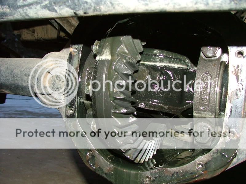

Good news, locker is fine, everything looks to be in place.
Bad news, ring gear is broke.....F'n yukon gold.....
Dana 60 time! :headbang:
As much as I would like to, nope, not on this rig. I am gonna build up my Explorer Sport with 1 tons for my next build. Now I just gotta keep this one together long enough for me to save some money to gather up some parts!
