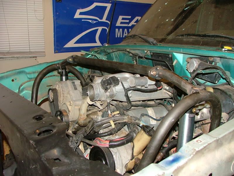

Shock hoops and brace
Close to the master cylinder, but it should work....hope I don't ever have to remove it, should be fun

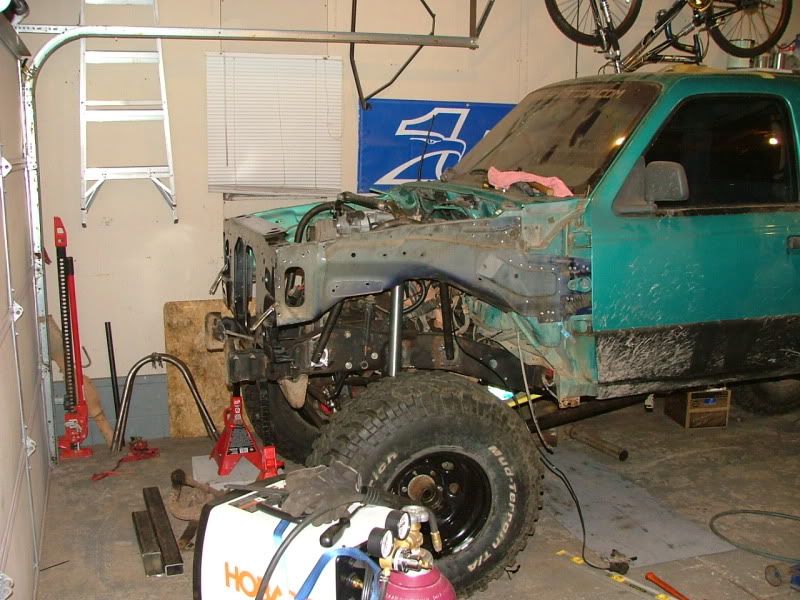

Started placing the front sheetmetal on so I could put the hoot on to check clearance....
Hood is really close, but will be fine

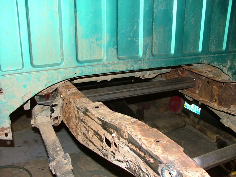

Rear cab mounts and crossmember. 2x3 .250 wall tube. It is one piece, cut holes in the frame and pushed it thru. I will box the frame here for extra support
Took the last stock crossmeber out replaced with some 1.375, .125 wall DOM. Gonna add another crossbar and make some sort of shock mount on it.

That body mount/crossmember deal is awesome!! And with a 1/4" wall, it'll never rust out and probably never bend either.

Here is an over all picture of how it sits now...
I like it Kyle, she's rising from the ashes and be ready to rock and roll again soon. Good work man.:icon_thumby:
LOOKIN GOOD:icon_thumby: I hope you don't EVER have to remove the master cylinder!! That would suck cuttin into that nice shock hoop:icon_hornsup:
