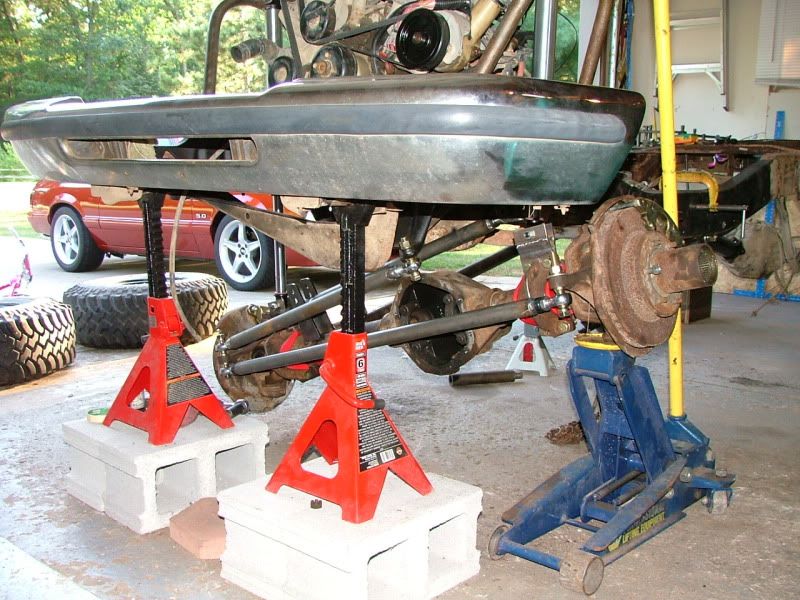

Flexed it on jack stands:icon_twisted:

Got the steering put on, might shorten my drag link and do a double shear mount on the crossover tie rod, then I might flip the crossover to the top of the knuckles too...all depends on my angles of the drag link and track bar.

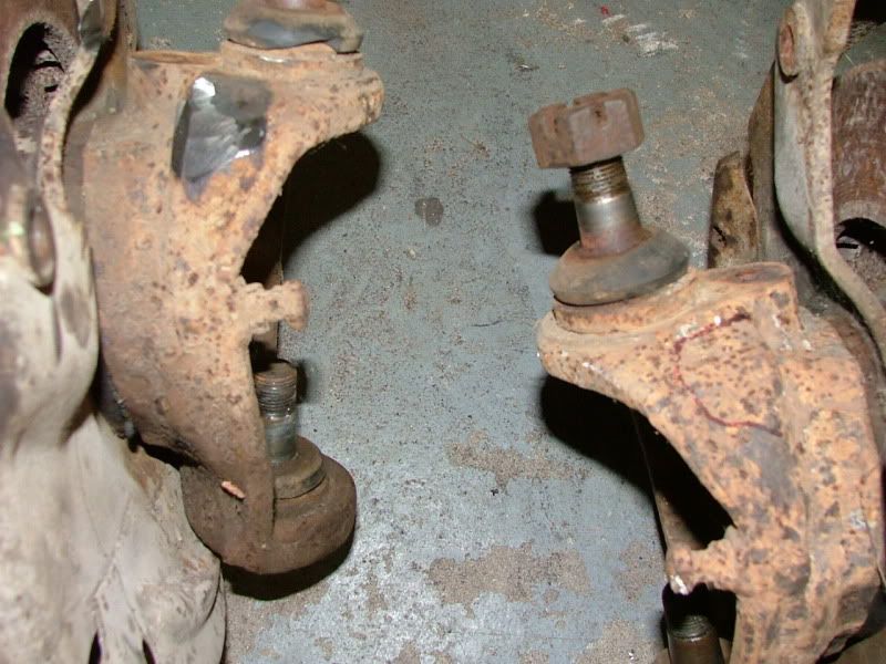

Ran into some issues with putting the brake calipers on the EB drub knuckles, they hit by a little. Figured I would just run the 10 bolt knuckles, but then I would have to remake the tie rod that I made to work on the EB knuckles. SO back to the EB knuckles and I hit them with the grinder....

Not much grinding, run em till they break, I want high steer anyway.
Brakes fit, just now I have to put the caliper on upsidedown....WTF, I don't see even on the other axle how these would work with where the brake lines hook up, they hit the ears on the knuckles, but upsidedown they clear. Maybe I have the wrong calipers or the backers are on opposite sides. Also in the closeup picture where it shows where I ground and it looks like I hit the backer, well I did that on purpose to clear for the caliper, but when I flip the calipers, that clears also///:icon_confused: Might just have to swap backers and see.

That............is.......awesome!! :icon_thumby::icon_surprised:
You got some pretty good articulation out of to, huh?
