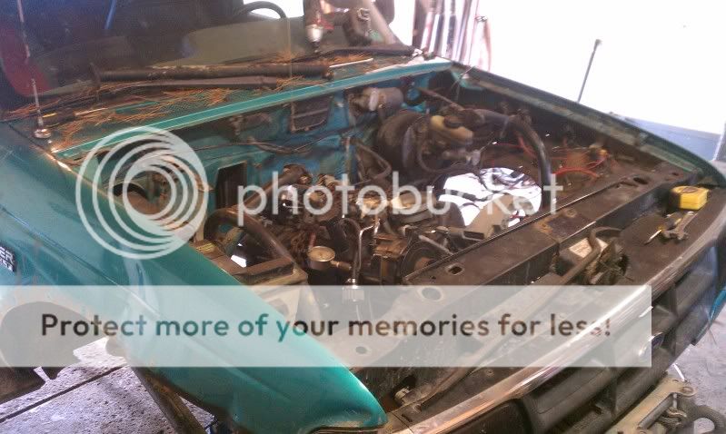

I set the motor down on the frame, but need to remove the headers and modify the heater box before I can bolt it in.
Ready to get moving on this thing.

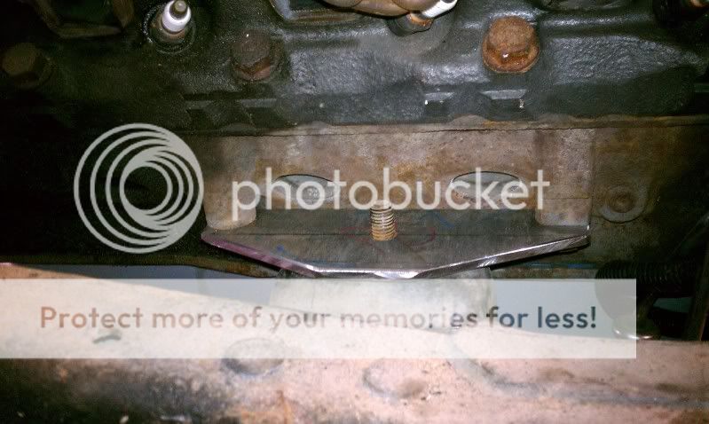

Motor mounts made, engine sitting in its place, soon to be for good

Sitting nice and low. I used the factory 4.0 mounts and made some adaptor plates.

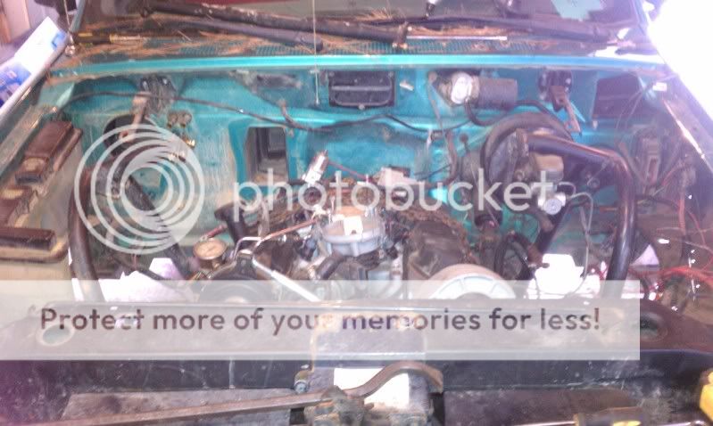

Now to get a radiator that fits or make what I have work.
Kyle, does your motor sit level with the 4.0 mounts and flat plates?? For some reason my motor sits high on the passenger side...I never have fixed it yet....Guess I need to make some plates for mine (I used the explorer plates and ranger mounts)...

It did, It was about and inch higher. I re drilled the frame and lowered it so they both sat level then made my plates to match.
