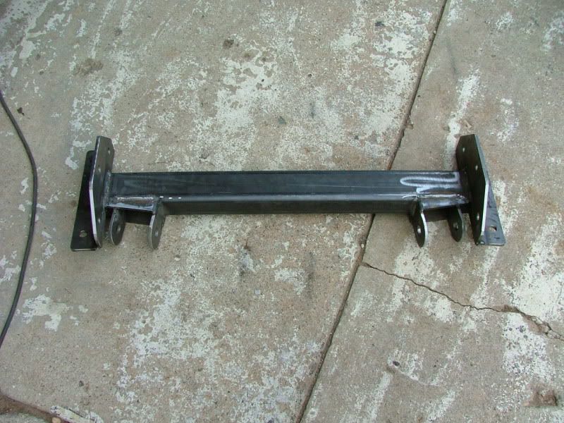

Welp, cross member is done, painted and mounted, all looks good. I also made a tie rod and waiting on making the drag link and track bar till I get my heims, should be next week, then I can place my trackbar mounts. Put the front tires on the new rims, put it together to mock it up and see my wheel base, right at 115 so the axle is pushed just over 1" (stock is 113.9) wich is still way better than my old 125". READY TO GET IT DONE, TIRED OF WAITING FOR THINGS AND MONEY!!! Just another couple hundred bucks and it's done! it is really amazing how quick it all adds up, lot more than I figured I would have into it.

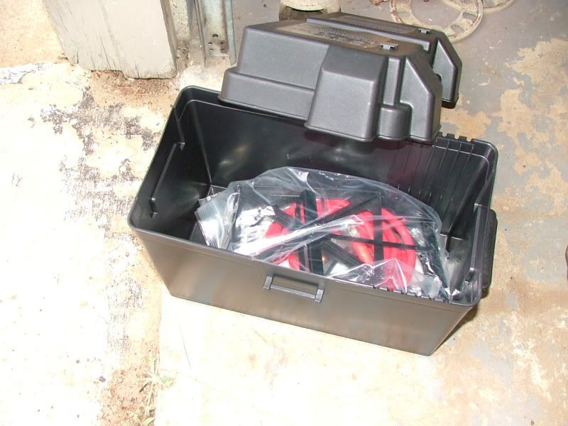

Got my battery relocation kit from summit and my 1.5" 1/4" wall DOM for steering and track bar and my track bar mounts from Ruffstuff

crossmember

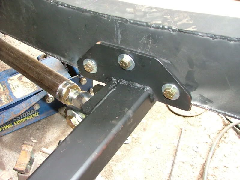

mounted

then I took it off and painted it and reinstalled it for good

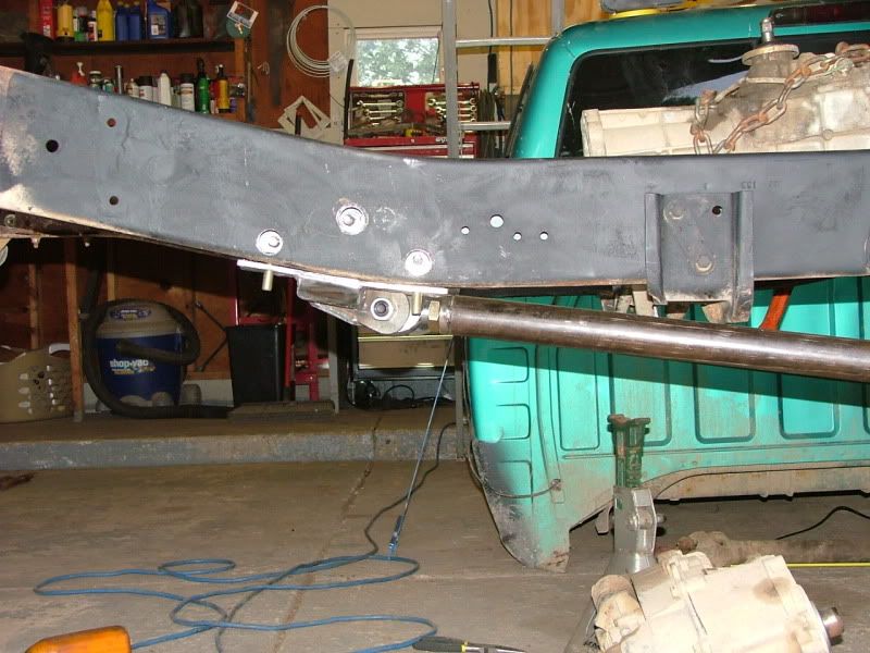

I think you should have lowered the brace a little too give you more up travel, it loooks to me when the wheels come up the bars are going to hit the frame and transcross member.
