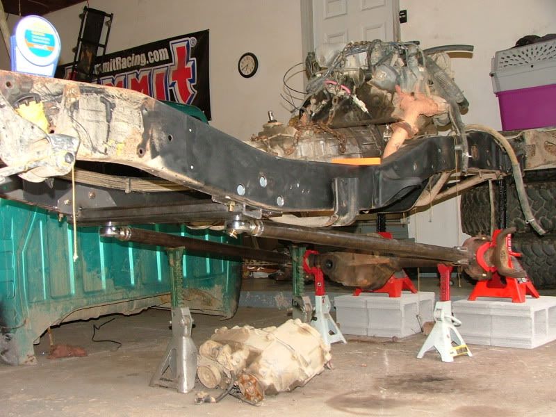

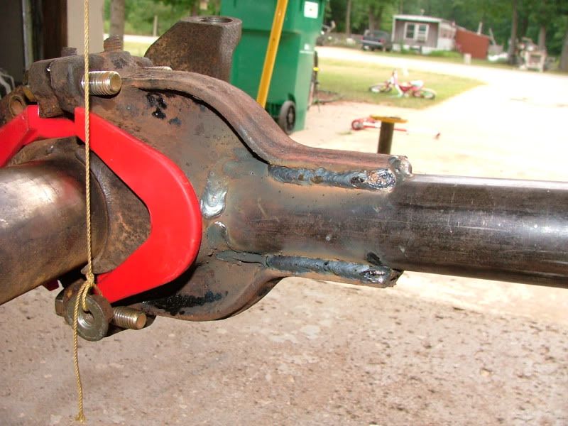

Got my radius arms done and welded, started on the crossmember. Got the axle in position, got the caster (or camber, can't remeber with it is) at about 5*, think that should be good. The arms are pretty long, I wanted the crossmember to not hang down, and the only spot I had to make that work with my long arms is behind the tranny...o-well, see how it works, just worried about ground clearance. Got the crossmember all tacked up, still need to make provisions for the heims.

Think I am gonna pull the motor and modify the engine crossmember, hangs too low

it looks to me that you have no up movement clearance on the right side arm, look like in the picture is really close to the transmission mount.

Good eye, it is pretty much right on it. I am going to modify it more, or remake it all together, we will see.
