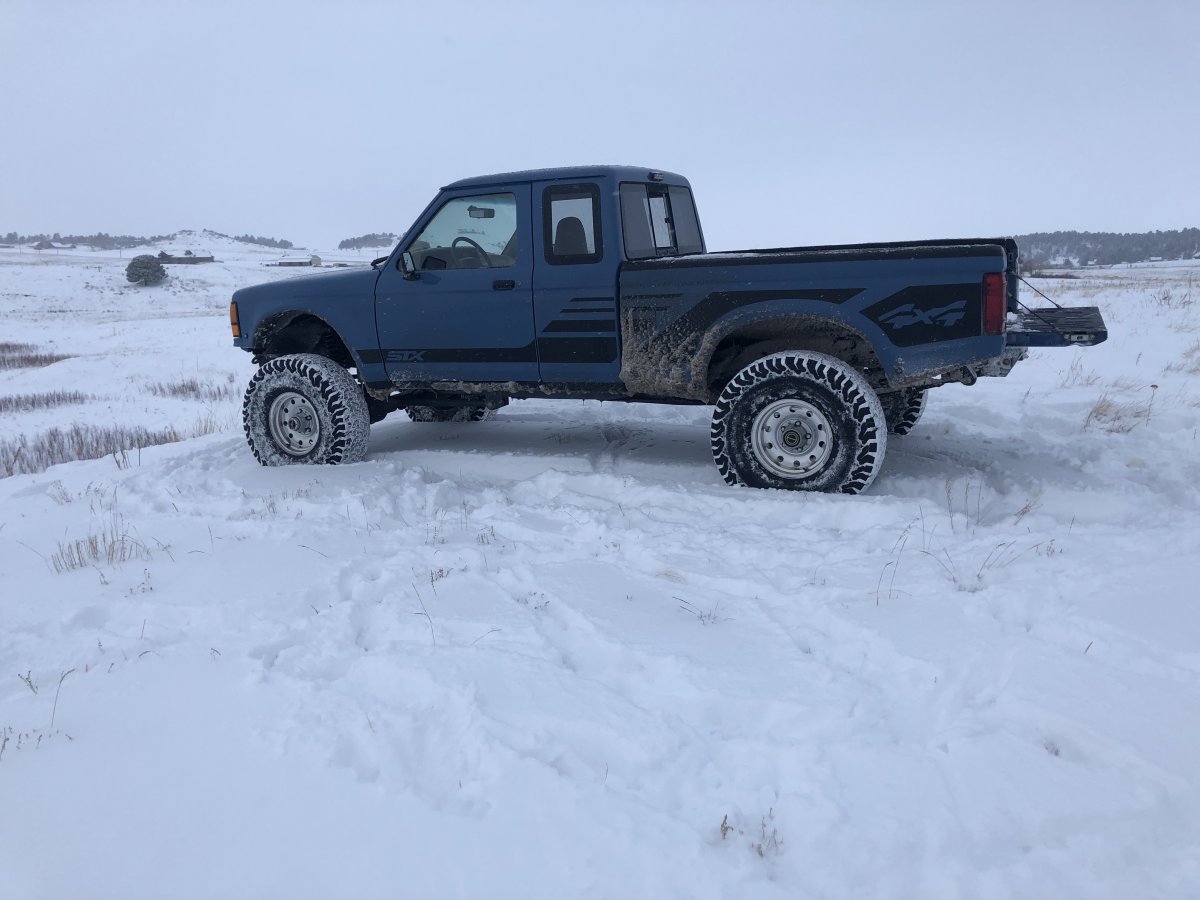

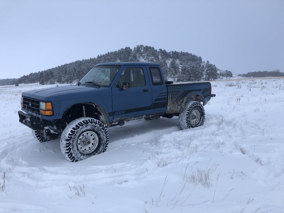

A couple pics of taking my kid snowboarding a couple weeks ago

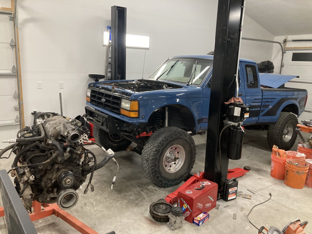

I am working on an engine swap currently. Ranger is down.
What's going in it?

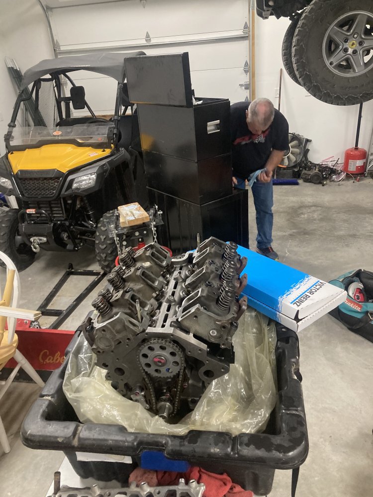

I have a nos motorcraft rebuilt short block 4.0 that I am putting together with as much nos parts as possible. It is a 98 block with 98 pistons. I acquired it about 5 years ago and I have just been waiting for the right time. The current 4.0 has 313k on it, so it is time.

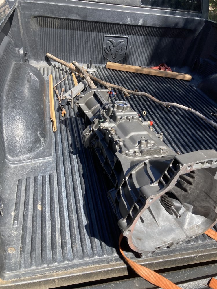

I also acquired a low mile 4 cylinder m5od behind a 2.4liter 1993 ranger in the junk yard and I am having the m5 rebuilt with all the hd parts, new soft parts and the gear set from the 2.4 liter transmission. This will equate to a lower first through third gear.

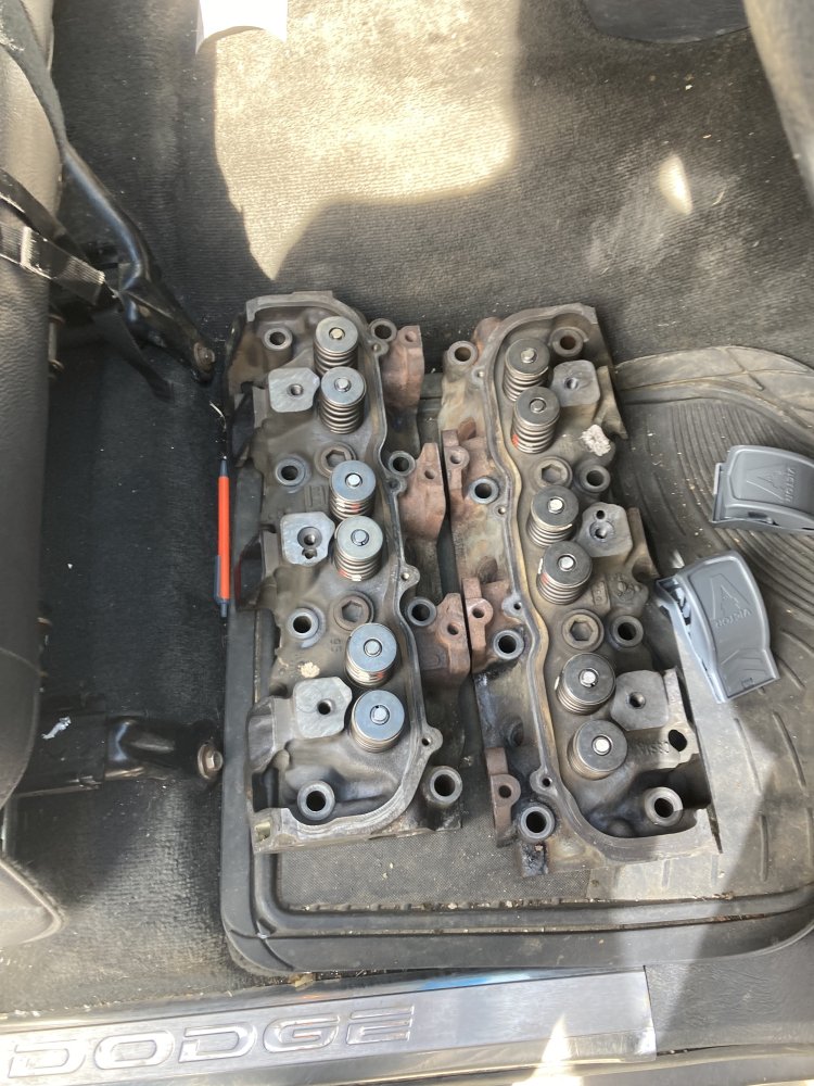

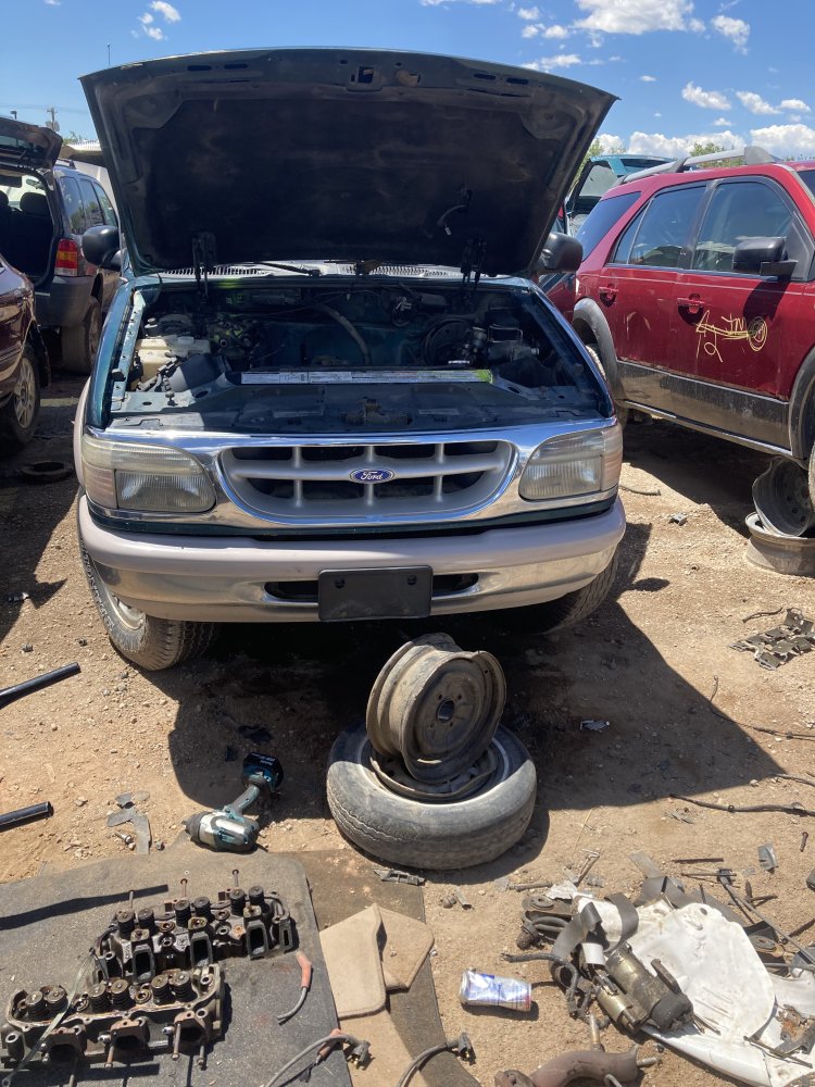

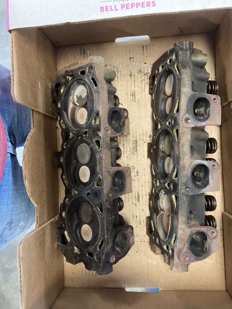

The main obstacle I am facing now is: I purchased some nos heads off of eBay that at 95tm (1995 4.0 versions). Unfortunately, though the heads are nos ford units, they are 93tm (1993 4.0 versions). With the 1998 pistons, I need 95-2000 heads to keep stock compression ratio. However, the exhaust chamber was changed in 98 to a smaller port that won’t be ideal with my 91 computer or manifolds. So I really need 95tm or 97tm heads. The aftermarket only supports 98tm heads. Ford doesn’t sell any parts anymore. So I went to the junk yard and found this 130k mile exploder with 95 tm heads.
I took these to my local machinist for rebuild using the valve parts out of the nos 93tm heads.

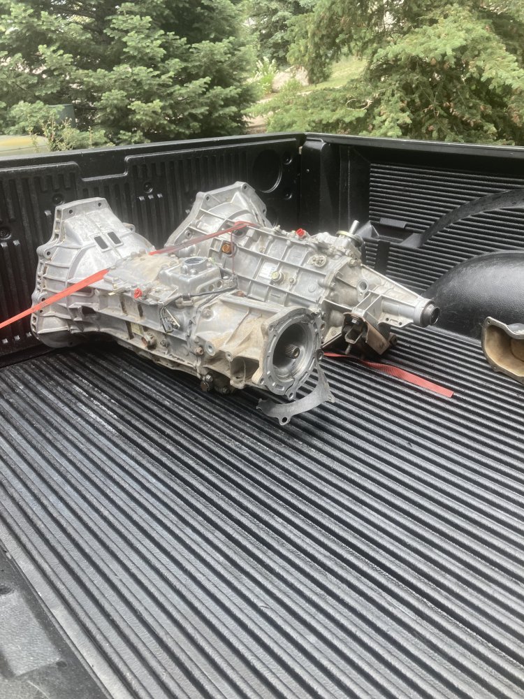

I have been waiting this whole time for the tranny to be done and for the heads. Finally, I got a call on the tranny- so I picked that up. Completely rebuilt with all new soft parts and the 2.4l gears. The rebuilder said both trannys were in exceptional shape when he pulled them apart. Not bad for a 313k mile 4.0 tranny. It was nice of them to paint over the grease that was left on there. Luckily I powerwashed it twice before taking it to them.

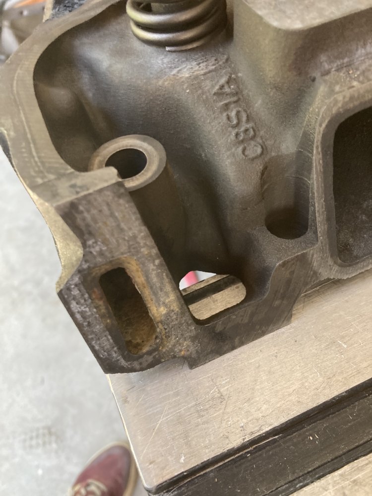

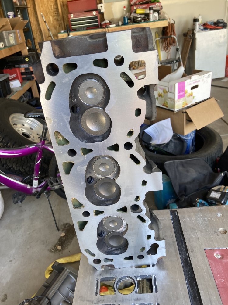

I also decided to swing by the machine shop and check on the heads while I was out. Turns out they have been done for a couple weeks and I had no idea. Thanks for the call....
They ended up not telling me what they decided was best either. But whatever, at least they are done. They put the new valves and springs out of the NOS 93TM heads into the 95 heads. The rebuilder said I need to buy a lottery ticket because the 95tm heads I brought him were not cracked. I told him the 95 variety aren't that prone to cracking.
They supposedly boiled them, but they didn't come back that clean.
maybe it is normal- but I was disappointed. The intake runners were full of carbon and oil. I spent a whole evening with a brush and some cleaner trying to get everything clean. I wish I would have done it before I took them to the place.
They also decked them .009. That should increase my compression a little bit. Also did a multi angle valve job- so that should increase performance. They had to do 12 new valve seals and 6 seats. I dont know why just 6 seats. The guy I picked them up from was about 97 years old and the tech didn't remember anything. I need to call and talk it over.
I started to install the heads on Monday- but then I realized I was missing 4 dowel pins on the new block. So I tried to get them out on the old. That worked not at all. I called ford and they had 4 in stock so I was able to pick them up yesterday.
Last night I got the new heads on and the lower intake. The valley needs SO much RTV to seal. I am hoping it does seal! probably 1/4" in the back. The gasket didn't have anything for the valleys.

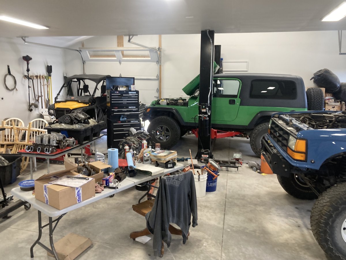

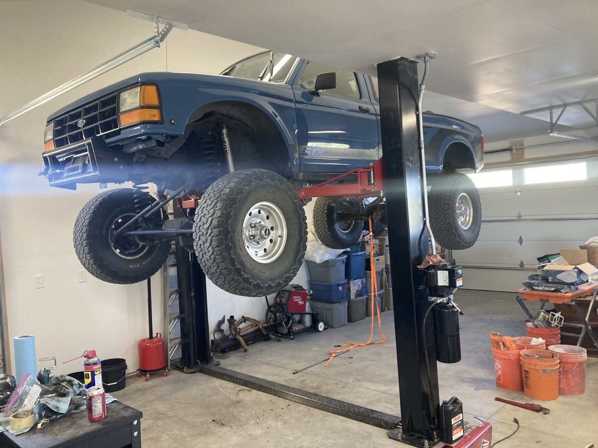

Here is my lab. Its been fun to work with my dad on this. He is 72. I won't have his help long.

Your stuff is way fancier than what I've done in the past... I've rebuilt my turbo 2.3L twice in a driveway (2 different driveways...) and just inside the garage door...
The reason you got 6 valve seats is only the exhaust seats are prone to wear since they're the hot ones... the intake just wear out the valves over time usually...
I have done plenty jobs under the shade tree. My dad was a mechanic in his 20s and ran a dyno. He has been wanting a good shop and a lift since then. I am way blessed now that he has gotten it. We bolt that house together over the last 2 years. We hired the big stuff but all the finishes we did. A bunch of electrical and most of the plumbing. So I get to use it and I am really thankful to do so.
