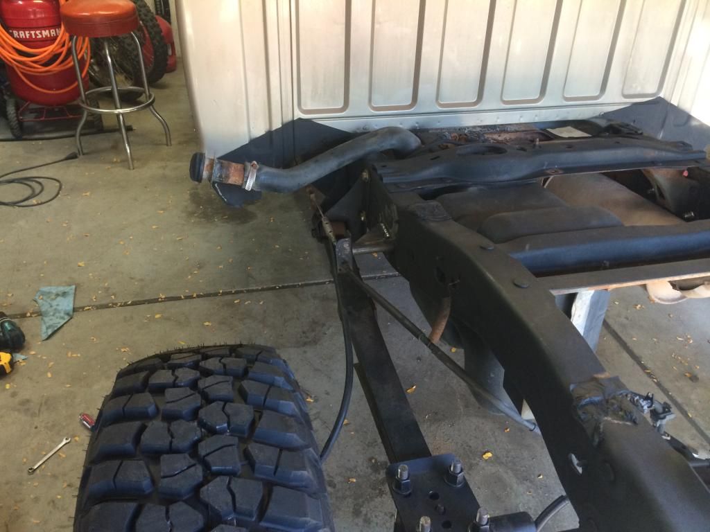

I torched out all the rivets, then I removed the crossmember, a little has tank skid and the carrier bearing. Then out came the shaft.

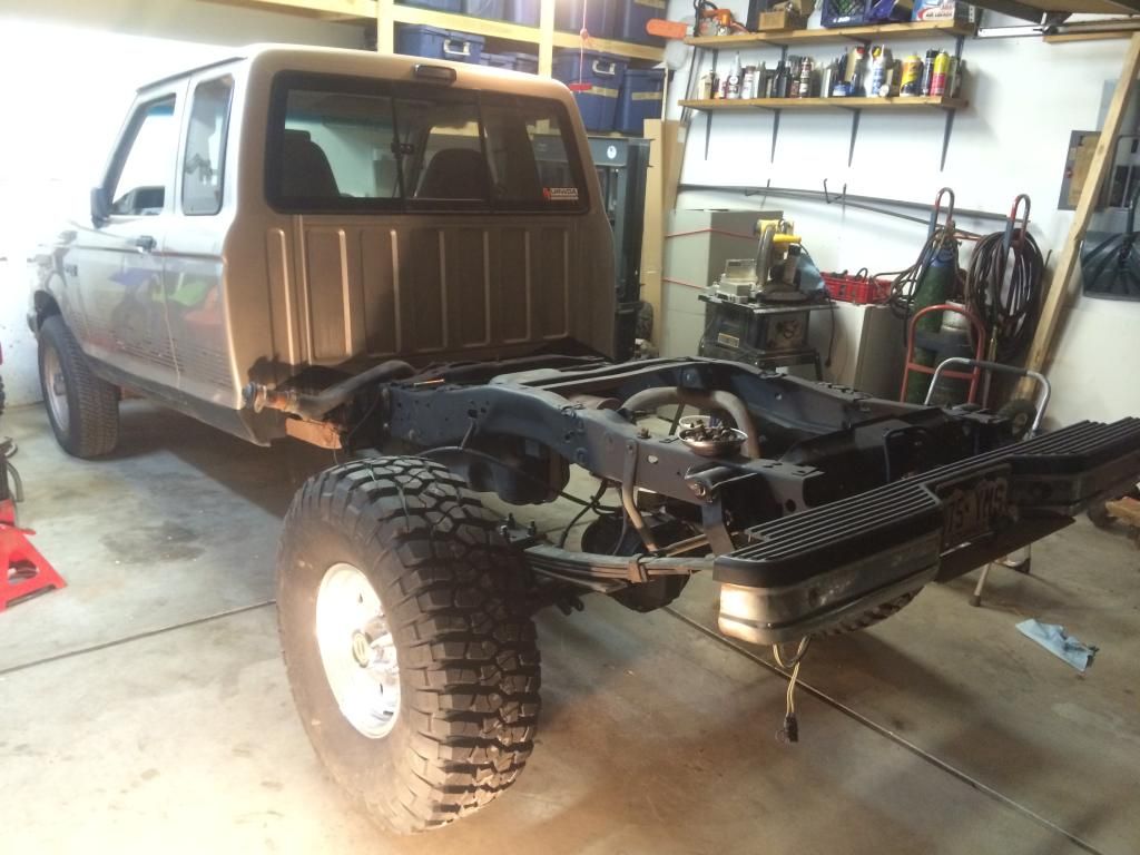

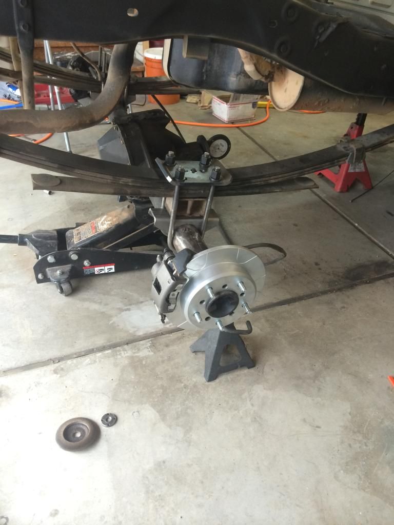

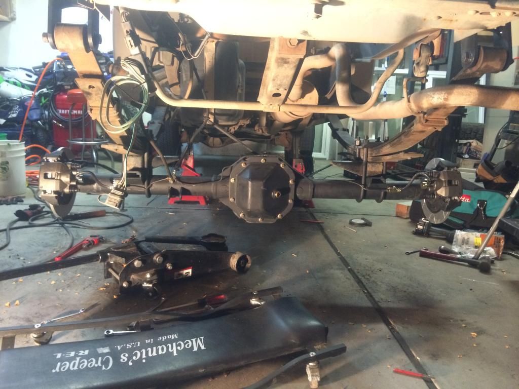

Then I bolted everything up and set the pinion angle. And located the spring mounts, and
Kirbys 1991 Ranger Build Up and Solid Axle Swap

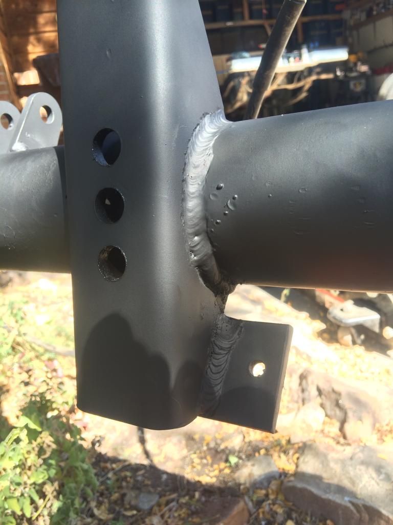

Then I burned in all the brackets and while I was there I welded the tubes to the center section.

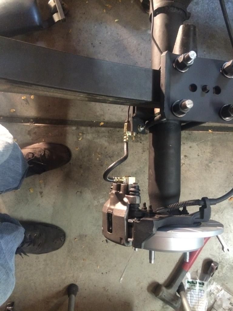

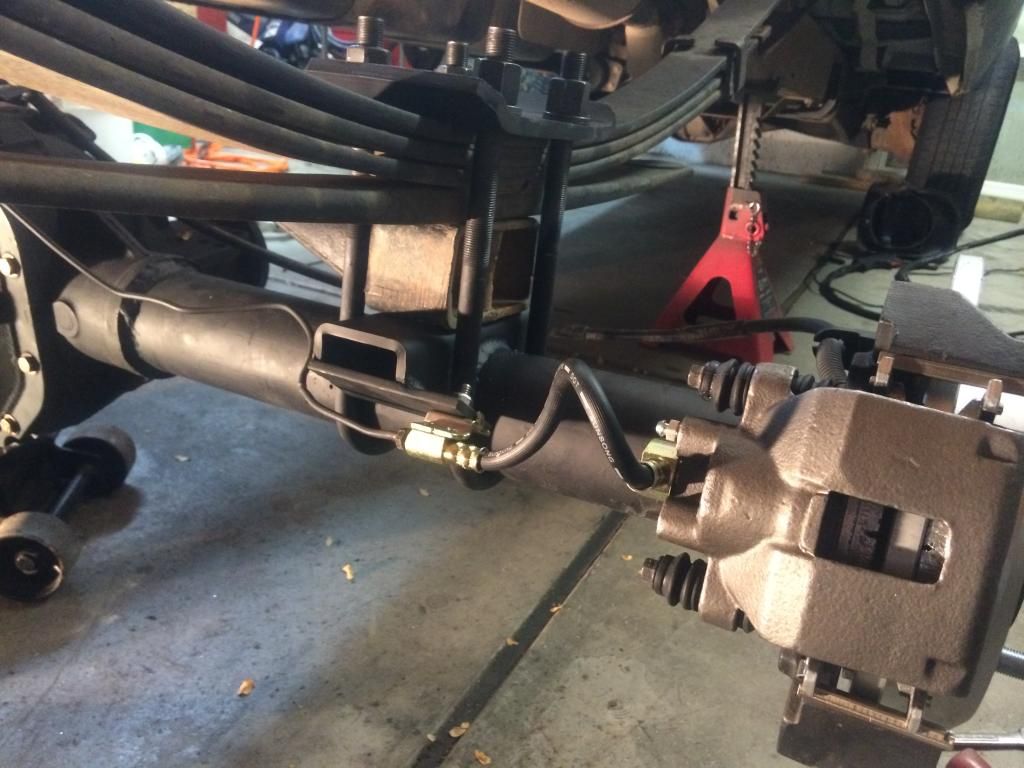

I also built some brackets out of 2" strap to hold the short brake hoses for the calipers and plumbed the brakes.

I had a few bad experiences with stainless braided lines (like almost died when I was pulling a trailer and one burst) so when it became apparent I needed a longer rear brake line I started looking for oem solutions. I read a thread where stic-o used a 96 f350 rear line for an extended line. I got one and it was only about an inch longer than the ranger one. 2 inches longer than the f150 one. So I found another solution on trs. It is off a 1989 dodge w150 truck. Part number BH38744.
Perfect. Plenty of length. I used the f150 brake lines. It comes down on the drivers side, then splits from there. I had to switch out an end because where the sides come into the hose in the block for the 150, one is larger. I was having to shorten them anyway so no prob. A little flaring and life is good.

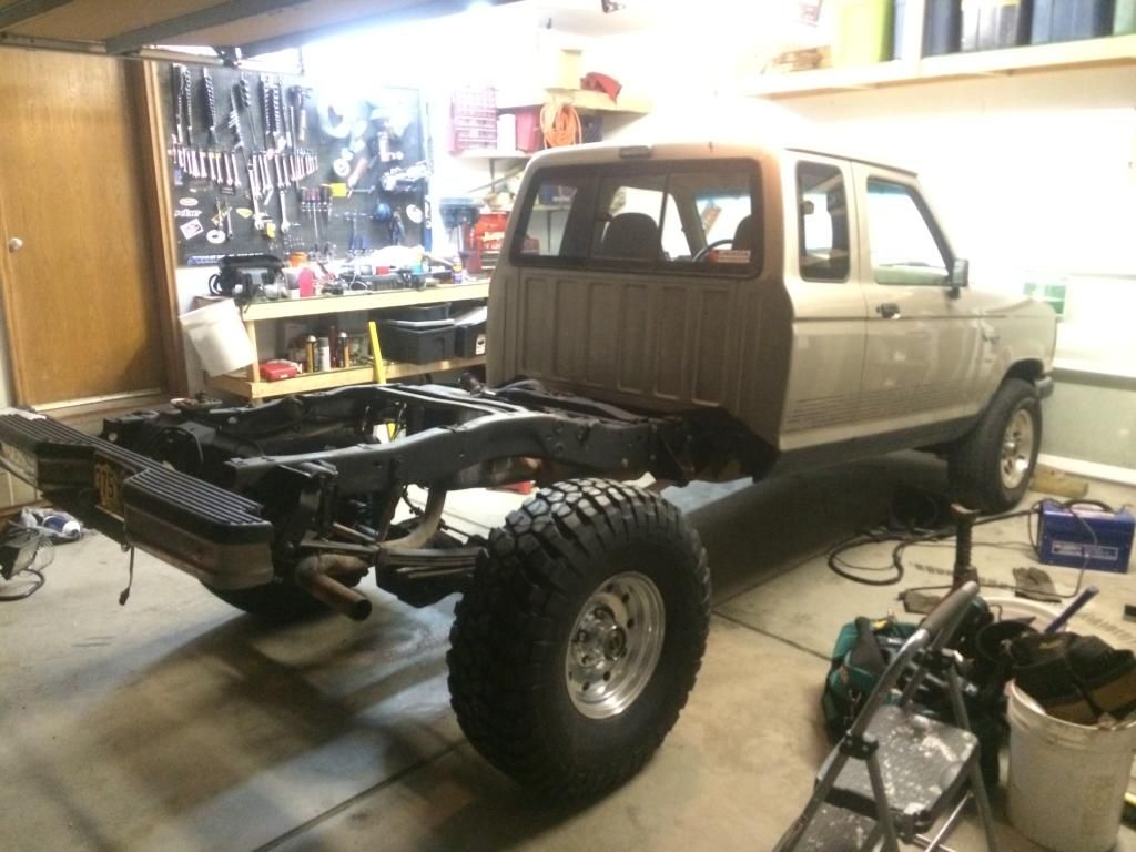

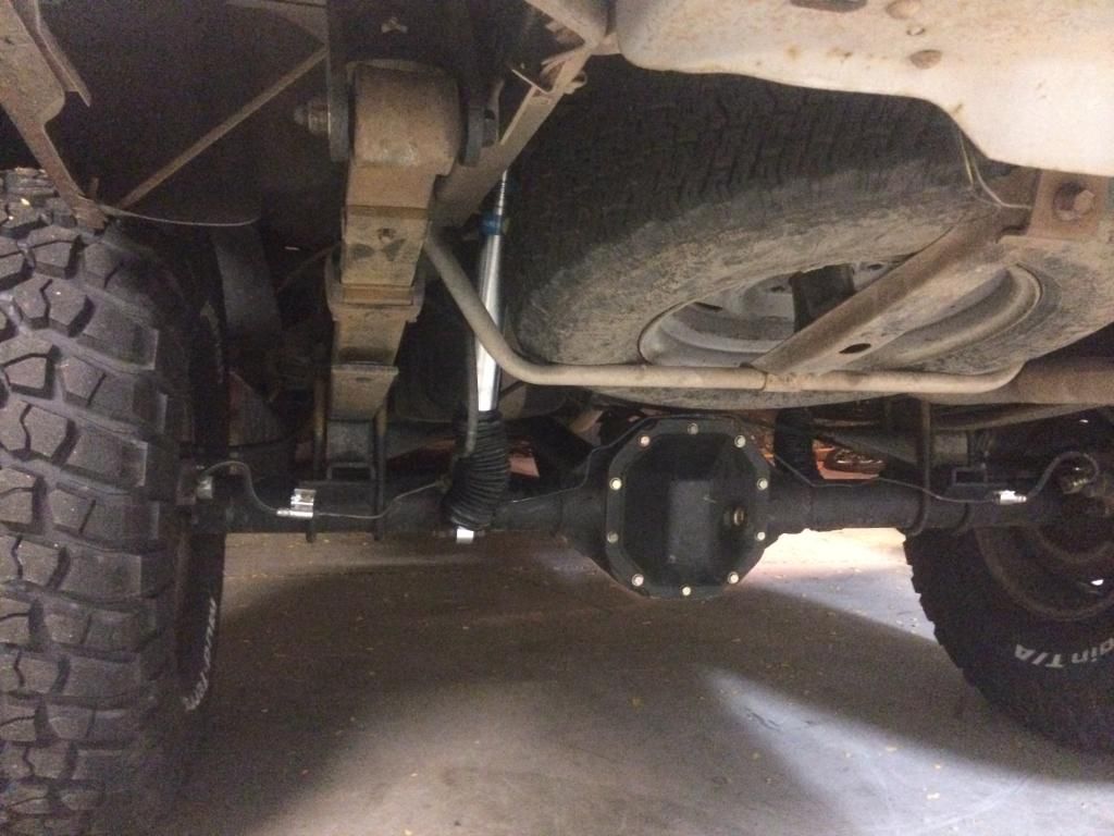

Then I filled the diff, got a game plan for the ebrake,- then I mounted the tires and tightened the spring mount bolts with weight on them. Also tightened lugs! Forgot that on the explorer build and noticed a bad vibe on the way home before I lost a wheel! That would have sucked!
Kirbys 1991 Ranger Build Up and Solid Axle Swap Kirbys 1991 Ranger Build Up and Solid Axle Swap
Tomorrow I get to make an ebrake bracket, drop off the driveshaft and get one made at 63 3/8" ride height, mount the bed and bleed the brakes. Giddy up!

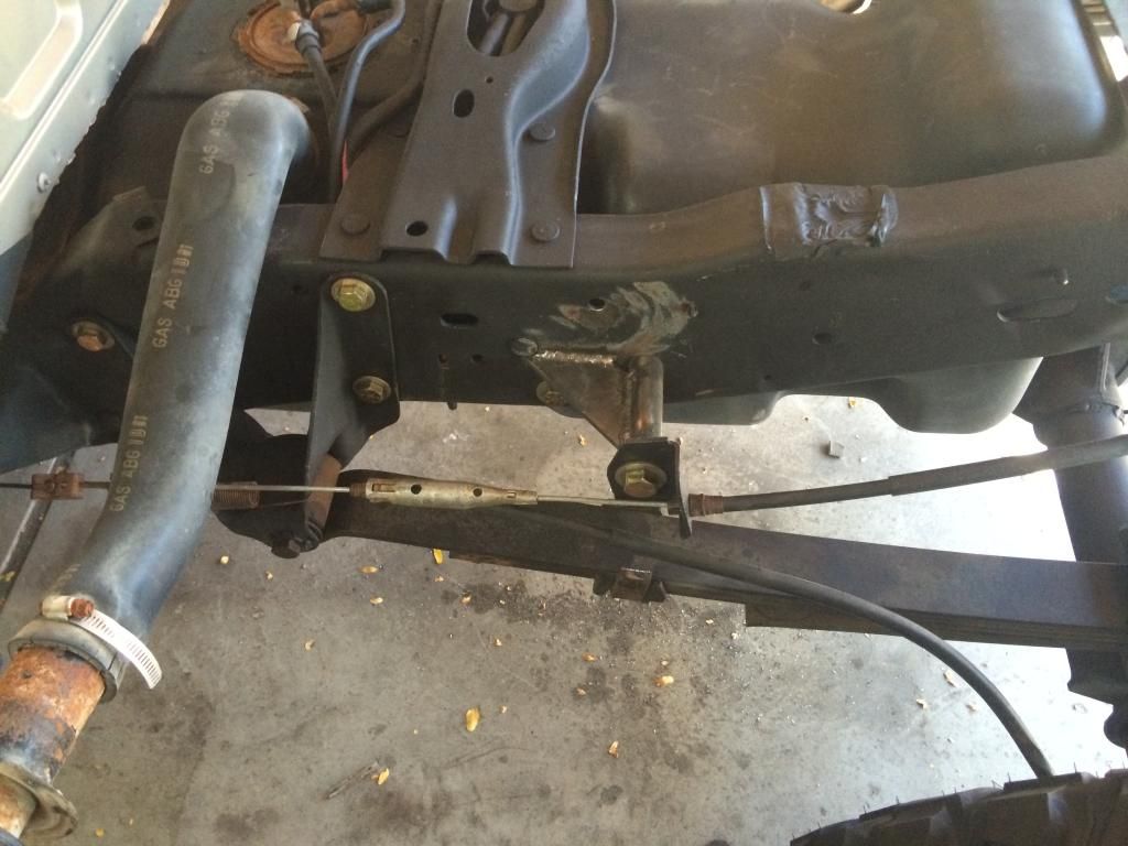

I got the ebrake cable bracket built kinda temporary to see how it works. It almost makes contact with the spring when the tire stuffs. Probably would if it was really stuffed. Adjusted the ebrake and it works excellent. Bled the brakes and they grab great.

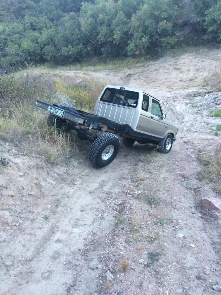

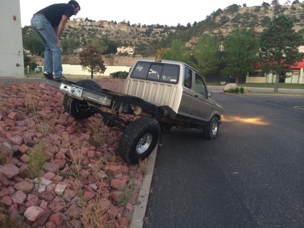

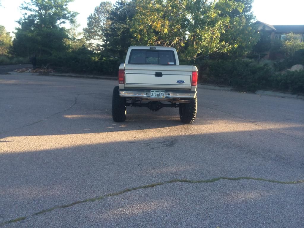

I ended up with about 6" of lift. That's. 64" Chevy leaves with overload left in and the stock ranger blocks. The rear wheel wells on the rangers are tiny! I am worried about butchering my fenders to fit these tires. I front wheel drove it to some spots to check travel and measure for shocks. Almost got stuck !
I am happy about the travel. A little bummed about the fenders. I need to figure out how to cut them and fold them under nice.

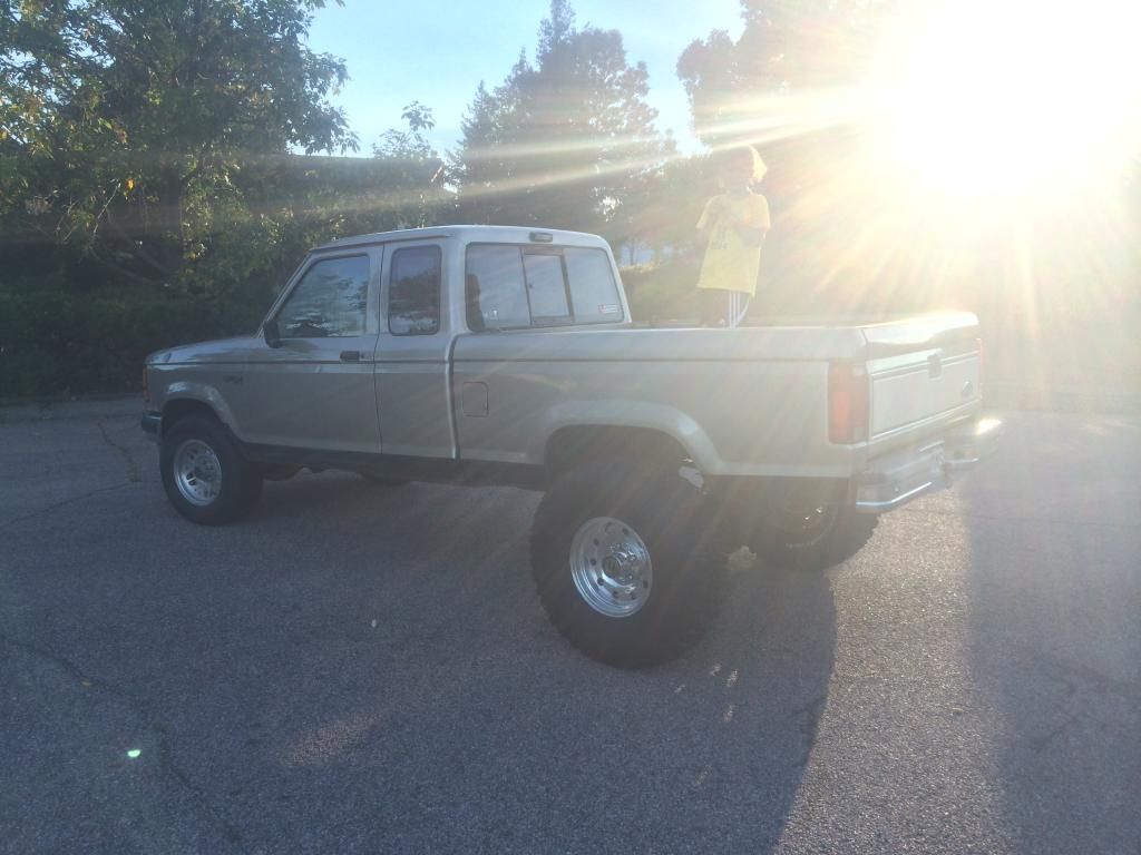

With the help of my buddy Phil (the bronco owner) we got the bed on late last night. I am really pleased with how everything tucks up under the bed. The ebrake mount, the relocated spring mounts, the shackles. I am really bummed how the tires do not tuck up under there though!! I need to trim the rear of the rear wheel wells some how.
On to the pics:

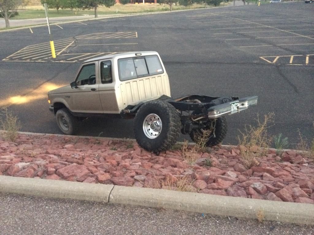

I also got the driveshaft in today! Woot woot! I was excited to drive it with the 5.13s. To cycle the suspension yesterday I was rolling in front wheel drive.
First impressions: I have to pay attention driving a stink bug on the hwy at 75 with no rear shocks, but it is wrapped pretty tight. Good bye 20 mpgs!

I got my shocks and my speedo gear. The speedo reads abou 4 mph over at 75, which is probably a good thing. I will try to forget it.
I keep getting thumbs up and complements on the ranger. I always laugh! It's not done yet! It drives nice now and will be tolerable until I can do the front. It even keeps the tires out of the fenders on normal driving.
I like the way the bilstiens look.

I have been driving the truck a few weeks and everything is working great. I even decided the gears were broke in so I changed the rear diff fluid.

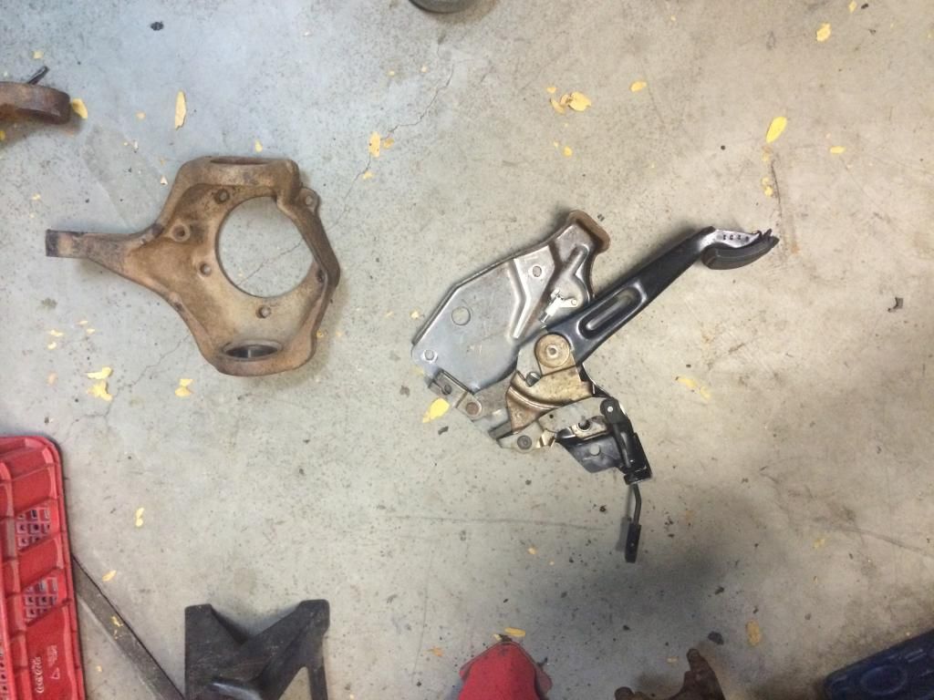

I installed a junk yard (found an auto so it would be rarely used) ebrake pedal assembly. The spring on my old one was toast and it would just pop off of engaged. I had to re adjust the ebrake shoes also, in the process. I found the best way to do it is to engage the pedal about 1/3 of the way and tighten the adjusters until they are tight. Then both are set even and hold well with the brake fully engaged. It was a nightmare to change this bugger out.

I also changed out the drivers side door hinges. I found a gold 91 ranger at the junk yard. The passenger hinges were tight. They looked the same as the drivers. I had to pull the fender off to get them off, but I got them off. So I got them home and installed the upper without drama, but the lowers are different. So I robbed the bushings out of the passenger one I pulled and used the piece that bolts to the tub so I could have a stopper again. I had to grind the studs head and then weld it in when I was done. Door shuts easy again.

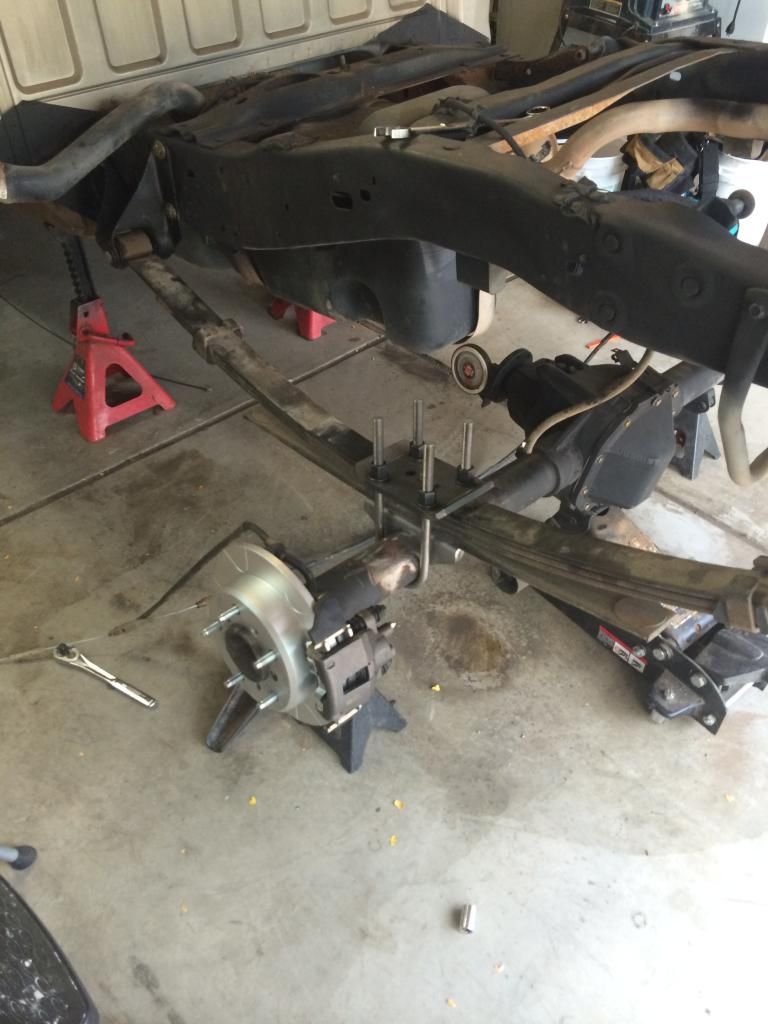

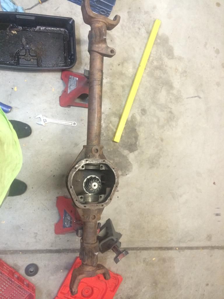

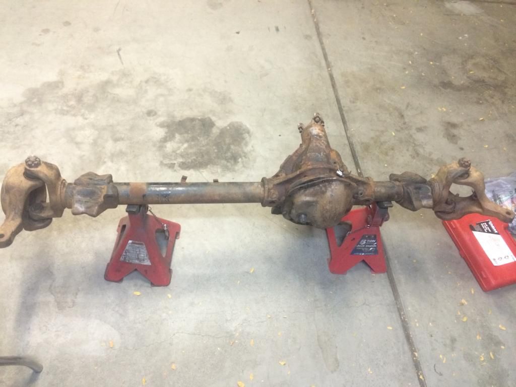

I also got started on the front axle. It was filthy, so I took it to the car wash with hot water and some engine degreaser. It became good and clean.
Then I pulled the cover off and the knuckles off and realized the inside was filthy too. The seals have been leaking forever too. The tubes were full of dirty old diff oil. So I took it back to the car wash, stood it on end and washed the tubes and center section out with steam. It came out nice and clean!

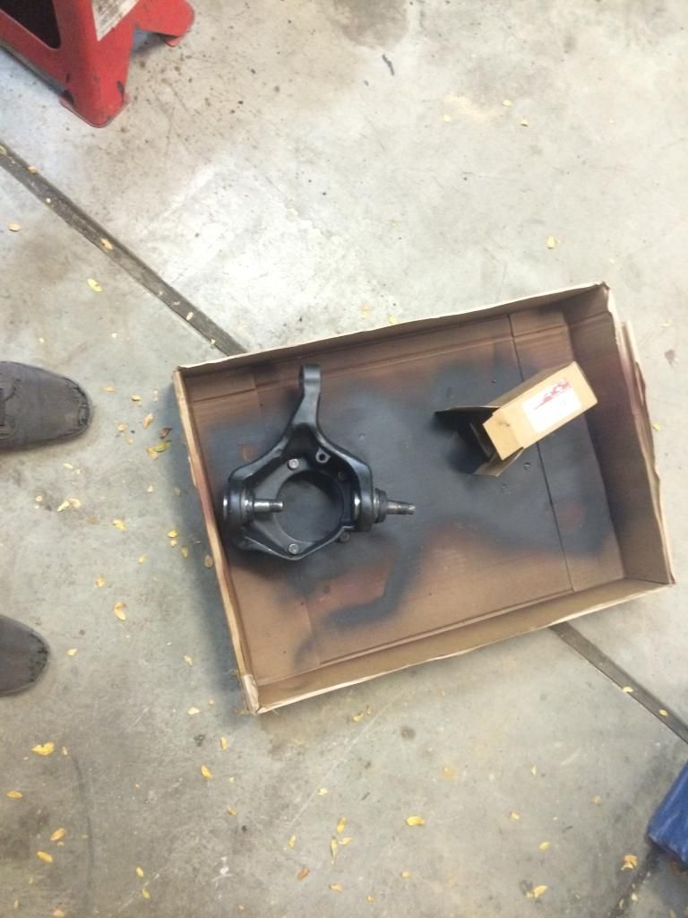

I pressed the ball joints out and went looking for some spicer replacements. Napa was the only place carrying dana/spicer and they wanted $50 a piece. $200 in ball joints? I only paid $50 for the housing! Rock auto has Moogs for about $45 a side, so half. Jeff's bronco graveyard has spiders for $55.
I need to decide on one and order. I also need 10 studs for the spindles. Mine came with only 2! The only place I can locate them is Jeff's bronco graveyard.
