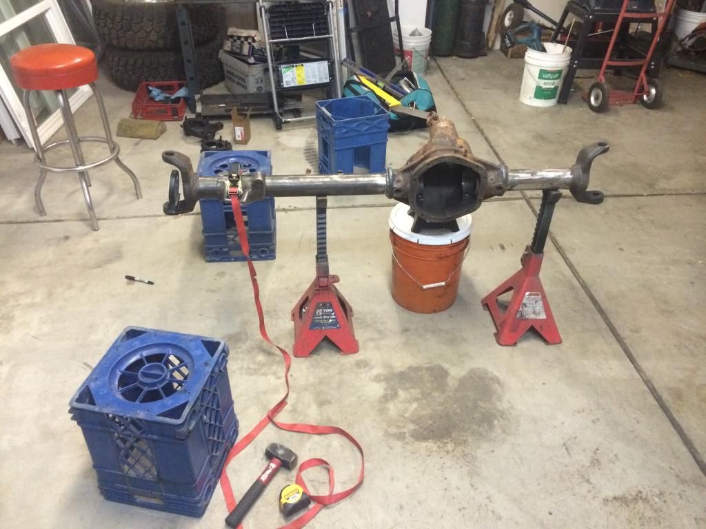

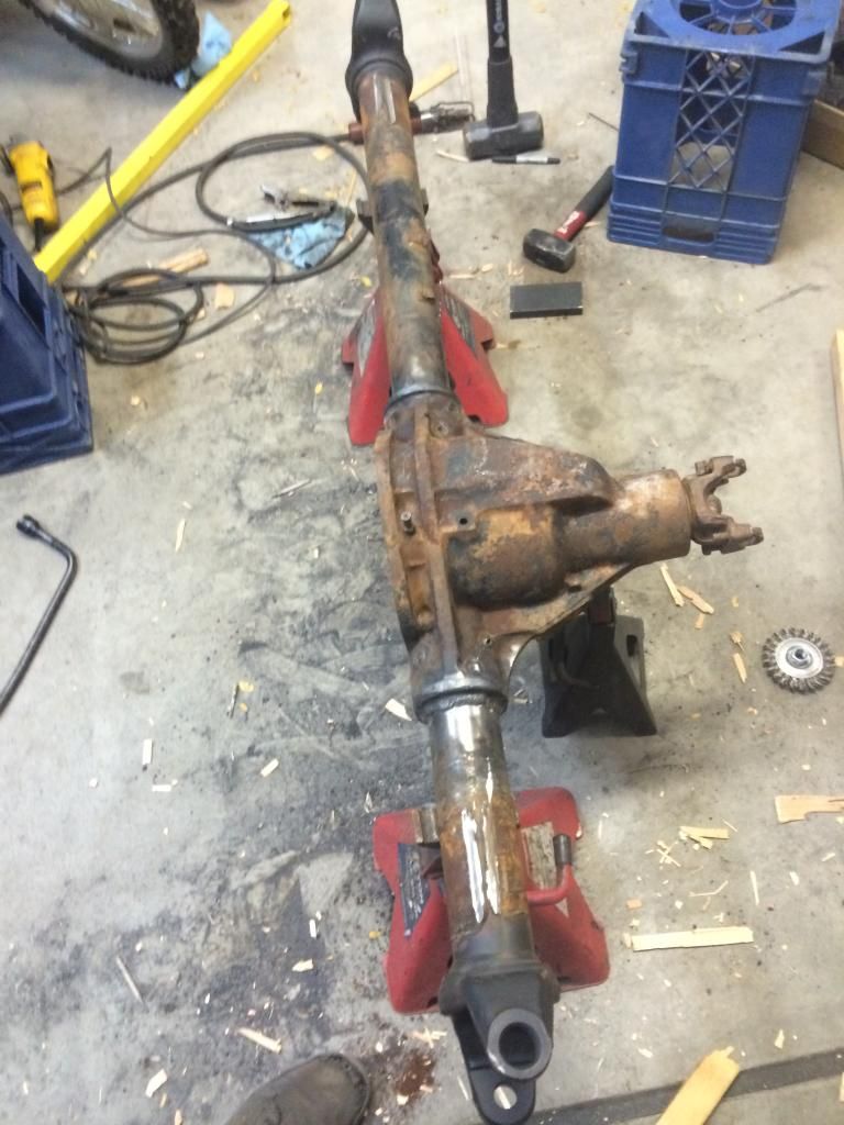

I cut all the mounts off. First I measured how far each bushing was from the outer "c".
Kirbys 1991 Ranger Build Up and Solid Axle Swap
Then I put the lower outer "c's" (where the lower ball joint mounts up) at 0 degrees. Then I measured each bushing's angle and marked it down.
Then I wrote everything down carefully on the trusty garage dry erase board and marked each bushing with a "top" which side it goes on and if it is front or back.
Then I cut each weld with a grinder and cut off wheel and drove them off with a big hammer and a piece of solid stock.

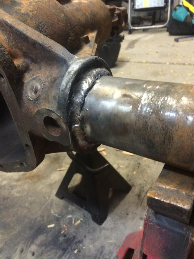

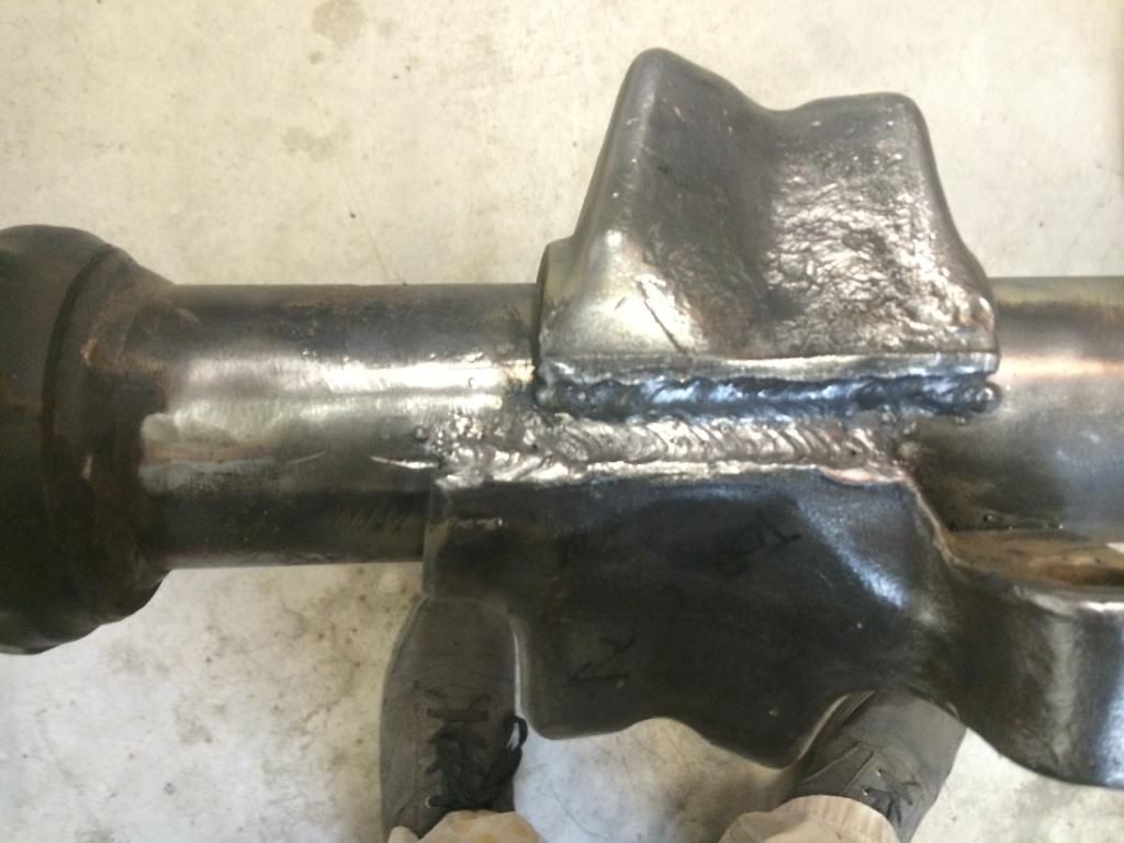

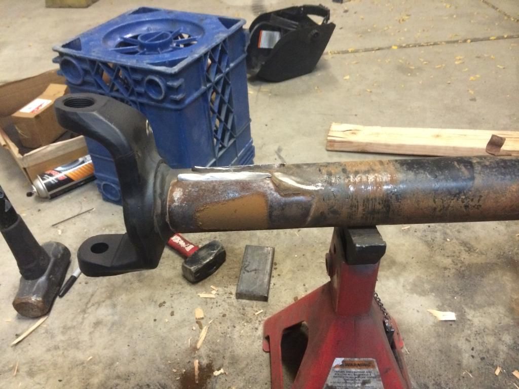

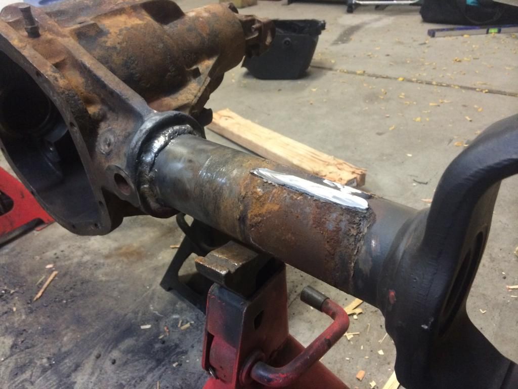

I also welded the tubes to the center section. I had some moist spots on my other housing around where the tubes go in from time to time, making me think welding the tubes even on a 1/2" tubes housing like this was even a good idea. After two passes last night, it was still cracking due to different cooling speeds of the cast center and tubes. In the past 2 passes got everything very warm and I let it cool slow in the open air and got away with it. This time I wasn't so lucky- maybe it's the thick tubes? Anyway, applied some pre and post heat with the trusted oxy acetylene torch and did another pass and she is good to go. Welded with my 220 buzz box turned up hot and 7018 rod.

Tada! All ready to clean up and tack the mounts back on!

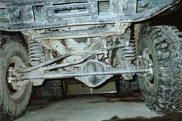

One thing I am thinking over is that on my Navajo I had a single sheer lower trac at mount utilizing the stock mount and a 3/4" heim. If you look closely you can see the mount here:
Hiems suck for daily driving in the weather, so I would like to use a double sheer lower mount, with a poly upper and a "super joint" type of joint- spherical joint with Teflon inserts on the other end. We learned this lesson on my buddies bronco. However, we left the stock mount and welded to it. This cost an inch or so of potential trac bar length. You can see it here:
I am considering cutting off most of the stock mount and welding the double sheer to it. It will have to be kept low profile, however to clear the spring cups.

Ok, I think I decided on 2 degrees extra caster as I weld on the mounts. I started taking measurements and tacking them up tonight.
When I got to the drivers side I realized how close that arm will be to the pinion and driveshaft. Hope there is enough room with duff arms or I might be running stockers again!
When I built my explorer I pushed the axle as far forward (3.5") as possible without moving the steering box and it helped approach angle, tire/ cab clearance and I was able to run a stock front driveshaft until I doubled the tcase. I really don't need any wheel base on the ranger, but I think I will take it for the clearance, approach angle and driveshaft reasons.

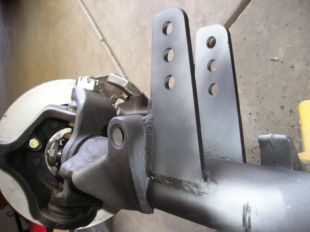

I got the axle all welded up with the mounts moved in 2 7/16" and 2 degrees more caster built in.

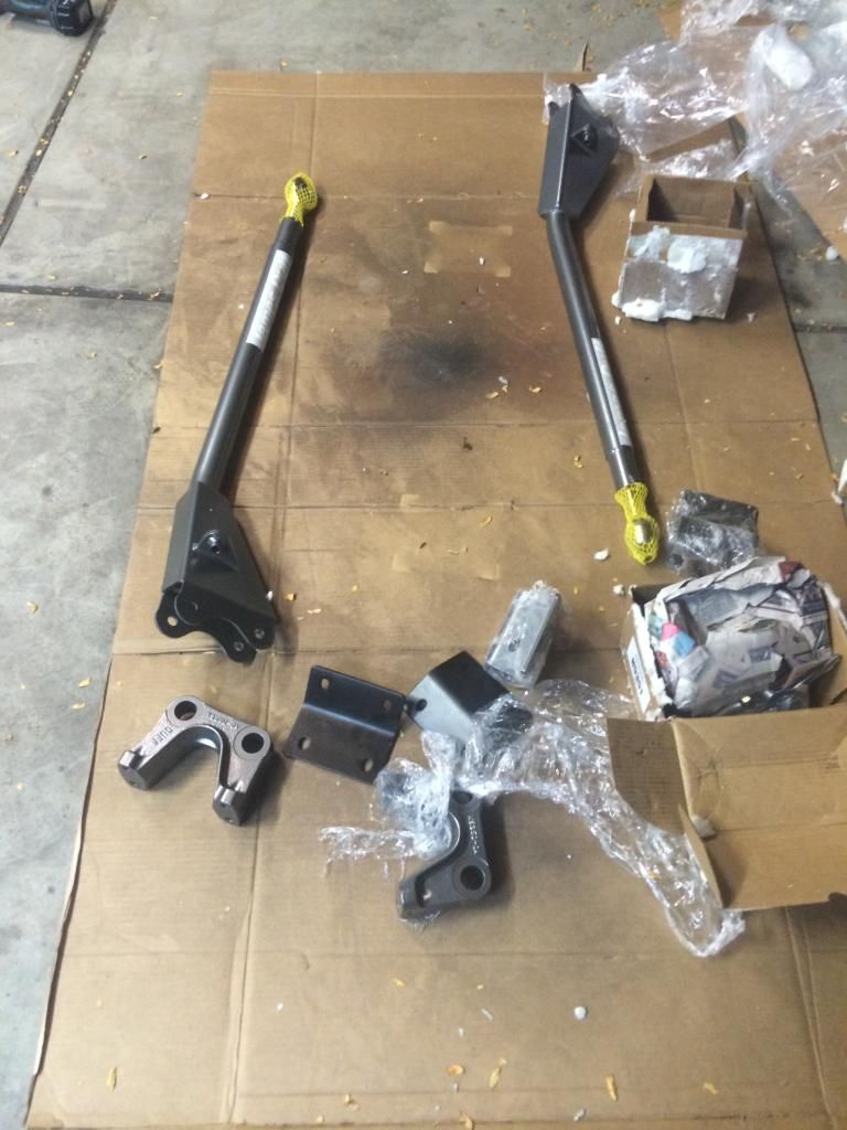

Mounts are moved in and a fresh coat of paint. I ordered duff arms yesterday in the vein grey color and 5.13s for the front.
Some good news! I got a shipment from James duff!
They are pretty! I also got my yukon 5.13s for the front and an install kit from crazyedsperformance.com

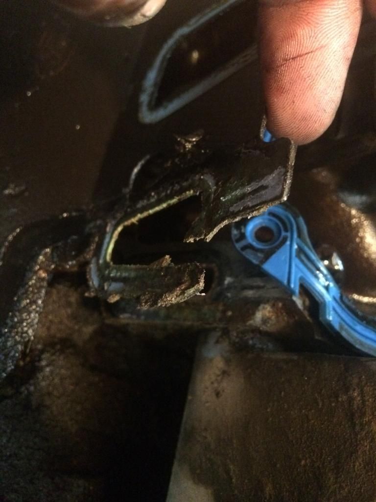

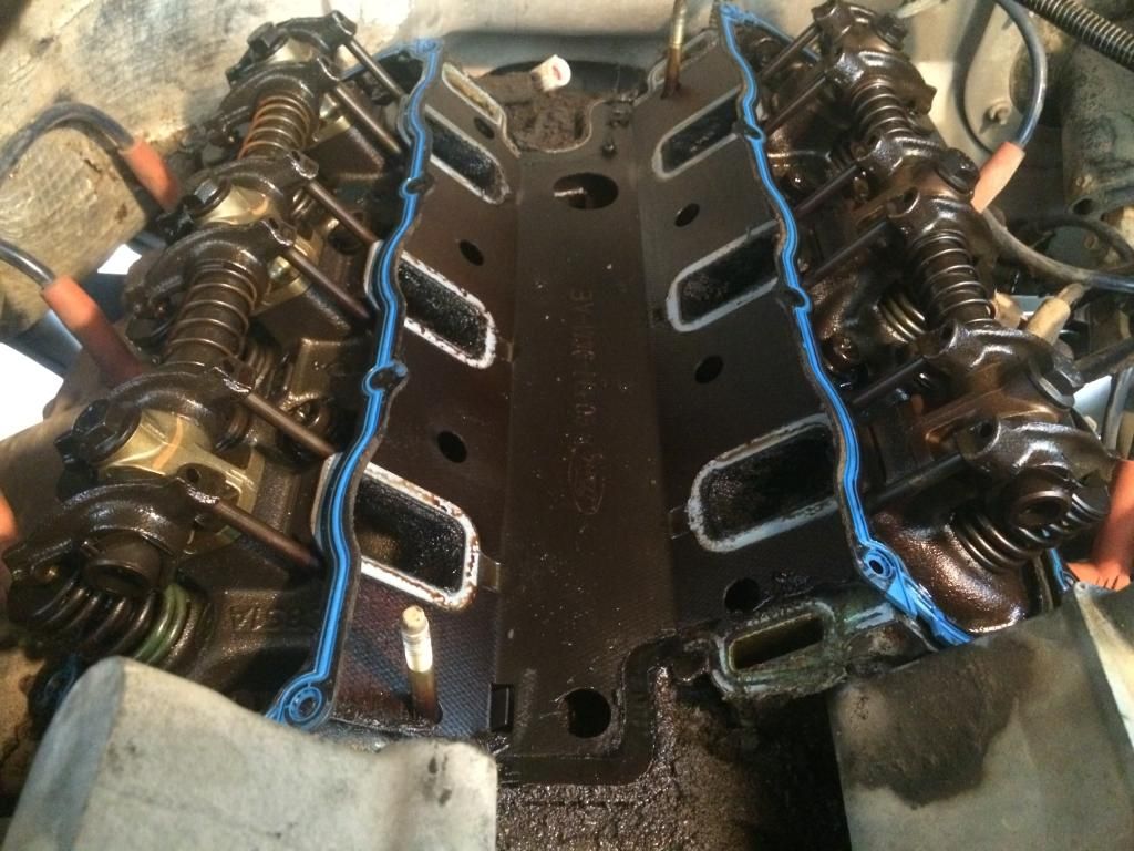

Now for the bad news. Last Sunday I got home from church and the ranger was hissing and blowing antifreeze all over. It looked like it was coming out of the block. I decided it had to be a lower intake gasket, unfortunately.
So off with the intake today.
This looks like the culprit
I am not sure if I should put a new gasket on and reassemble or have a valve job done and have the heads checked. Any suggestions?
depends on the mileage, whats she getting for mpgs?
a valve job never hurts, as for me id probably slap a new gasket and call her good, maybe give her a good seafoaming while you can, clean up the lifters prelube and reassemble, give the intake a good scrubbing, the more you do the more shell love you.

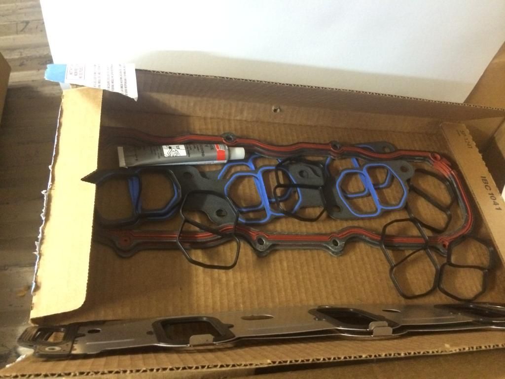

I took the lower intake to a machine shop to be dipped. It has 200k on it and gets up to 20 mpgs. I had a mechanic tell me a fresh valve job can be hard on a tired bottom end, so I am thinking of replacing the gaskets and hoping for the best. I ordered gaskets and sensors and a bunch of new parts from rock auto yesterday. Should be here in a few days.

But I couldn't figure out where these o-rings go that came with the intake set. I have 6 of them.
Turns out later 4.0s had a plastic upper with these orings.

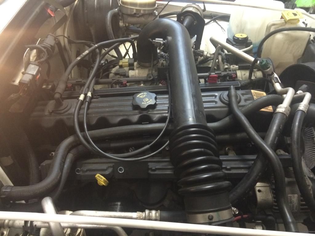

After I got the ranger together, I put new plugs in our 2006 Rubicon Unlimited. It took me 15 minutes flat with a plug socket and an extension. no wobbles or u joints or blind corners. They were all super easy to get to. Then I looked at the intake. Then I got angry at my ranger and ford for a while! That jeep is so easy to work on. I still like my ranger too I guess.
